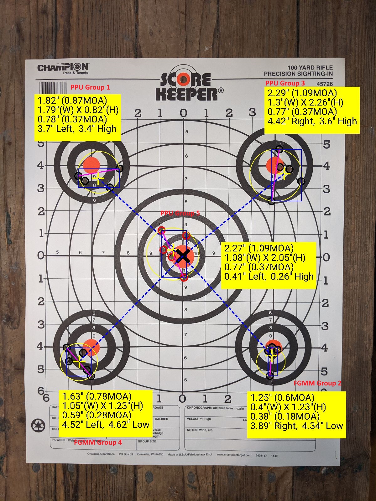

    So I'm a little stumped. I went out today, 25 rounds, 3 x 5 of PPU 168gr. 2x5 of FGMM 168gr. I aimed at the center always, and dialed my scope, .6 mil up/down, .6 mil left/right. Finished at the center. Alternated PPU and FGMM.
    I did notice a few things. 200 yard hash on my parallax was not parallax free at 200, I was rushed yesterday so didn't really pay attn. I made sure to adjust until I was parallax free. I also noticed my hand position was not correct when I was shooting, so trigger finger wasn't parallel straight back, but more like a hunter style grip instead of vertical grip. I adjusted for a straight trigger pull. I also noticed my scope is not perfectly aligned, I forgot my atlas bipod, and luckily had an older bipod that had a no cant feature. I'll fix that tonight... Anyhow I just made sure to shoot consistently. It's only off by maybe .4 degrees.
    Top 3 groups are PPU, and bottom 2 groups are FGMM. I alternated between ammo, always aiming at the center. Not enough grouping to really make a judgement call (and my last 2 groups (bottom left, and center) it got dark, so it was pretty dim). Groups overall are tighter than yesterday, but FGMM is performing very, very well in my rifle I guess?
    Besides SD variation maybe causing some minor vertical shift, what other variances from ammo? Is centerfire ammo matched to rifles similar to how 22LR ammo is finicky between rifle to rifle?
    7117434
    What’s stumping you? S.D. has zero influence at this range.
    I know the sample size isn't very large, so shouldn't my groupings with PPU and FGMM be really similar? I don't know much about how bullets are made, so besides inconsistencies with load (SD) which has no real effect at this range, what other things come in to play? Does my rifle just like FGMM more? Some other measurements that make the ammo shooting through the barrel more consistent? Or maybe it's all just within the normal range of error, I'll keep shooting regardless - 80 more rounds of PPU left. But 75c for PPU vs 85c for FGMM, I'll just pay the 10c more.
    Different barrels like different factory loads. Same when hand loading. Different powder charges and seating depth work with different barrels.
    Your groups appear to be between .6 to 1moa. This is acceptable for training ammo.
    Use the one your barrel likes the best (looks like fgmm) when shooting groups to assess your fundamentals and the cheaper ammo for practice on steel positionally.
    You’re overthinking this a bit.
