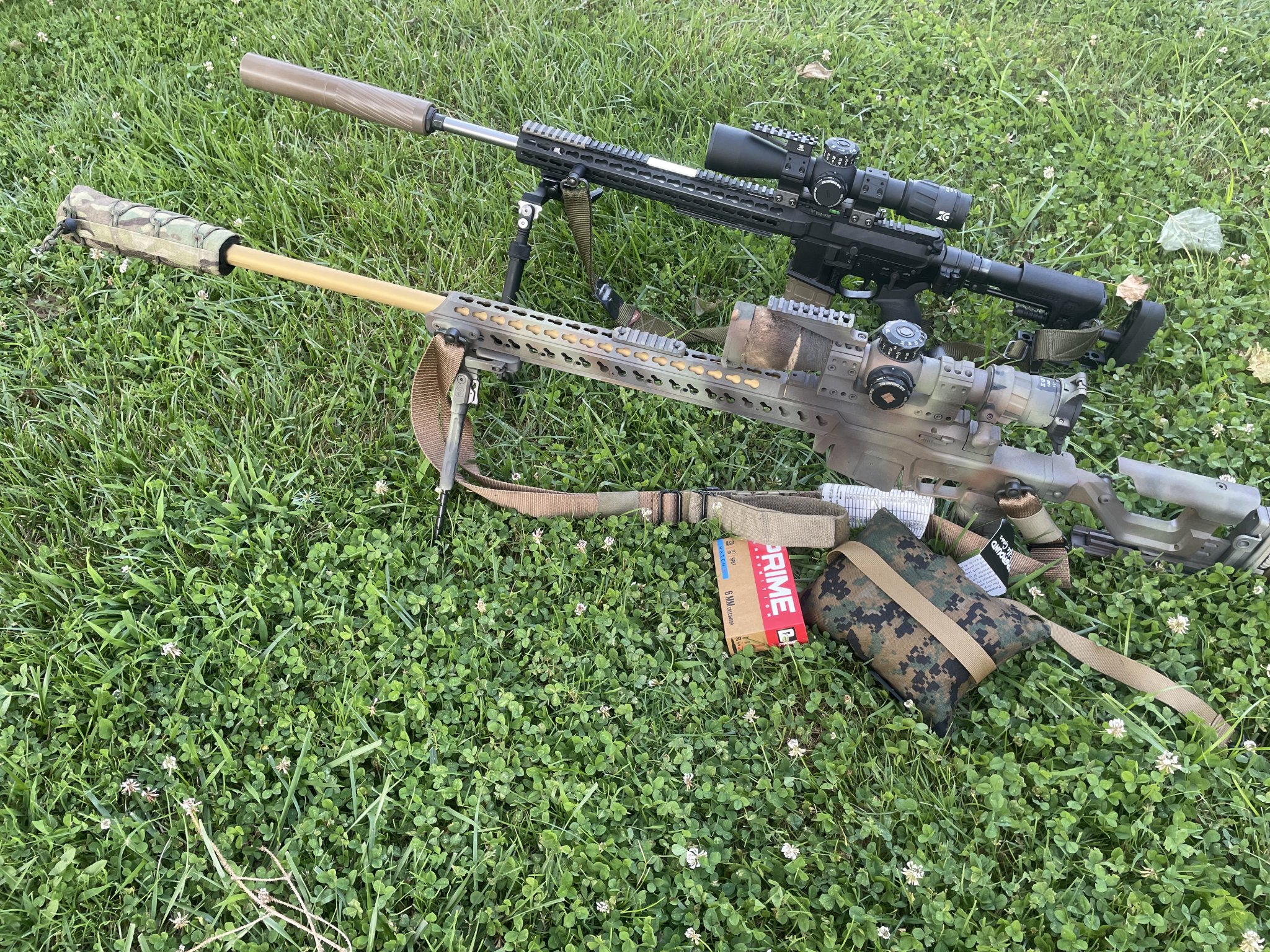

I have a 6-25x 56 on a 22” 6.5 Grendel, and a 1-6x24 on a 16” 5.56. And a couple in between too. Not really concerned about how it looks.
I hear you. Again, it's not just the look of it. Does having an optic that big mess with the balance of the rifle? Does it catch onto things because it has large exposed turrets when you're going into an urban shoot position? It's about performance not about how it looks on your Instagram. I.e. real world application of having a larger magnified optic on a smaller rifle.

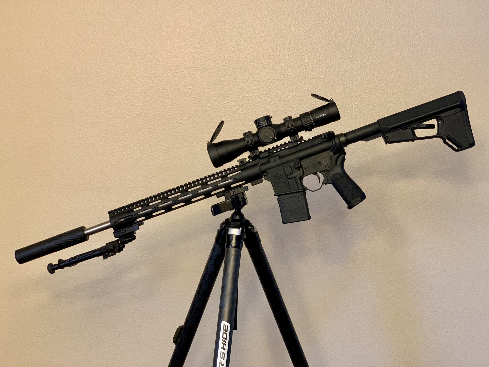

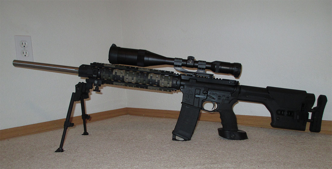

420 and 2.5-20 on small frame ARs:
Never been an issue in PRS comps- at least not more so than any other similarly capable rifle/optic. I humped it through a run and gun once, but the 5.56 with a 1-6 or 1-8 is better for that.

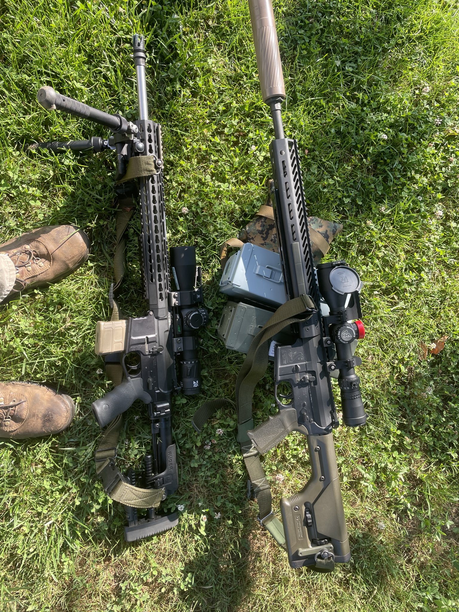

I find my self debating aesthetics and function from time to time. I like things to look good/balanced while still functioning and serving a purpose.

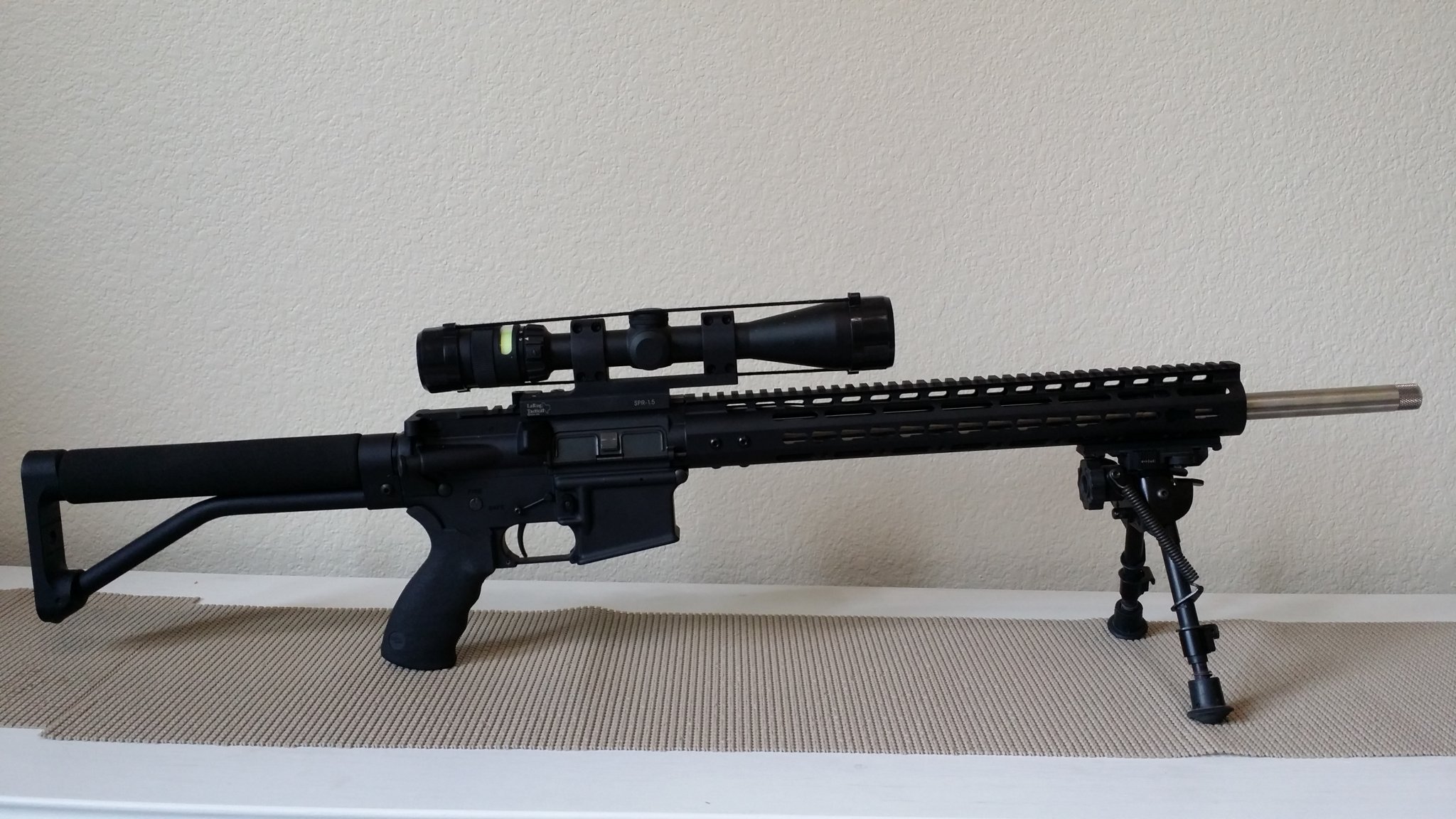

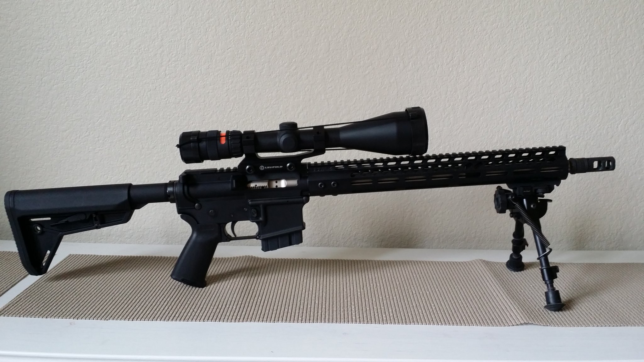

Both rifles are 6.5 Grendel. 20" for stalking, and a 16" for hunting at night from a blind with a suppressor.
20 inch rifle build had a lighter weight, compact 3-9x40 Trijicon. It actually looks a little small in my opinion, but size and weight were the deciding factor.
16 inch rifle has the 2.5-10x56 Trijicon. The objective looks like Hubble on there, especially with the shorter rifle. Again, this was for hunting hogs from a blind, so size and weight didn't matter. What did matter was getting every bit of usable light to my eye.
Both rifles would look more balanced if I switched the optics, but not going to happen.
Reactions: rpoL98 and Flywheel
The lighter scope on the longer rifle is great for walking around. Far more carrying than shooting.
The x56 is a great low light scope. I can see hogs well past sunset. If there is a full moon and clear sky I can hunt throughout the night. Never had an issue with shadows from the blind. Facing towards the setting sun is the biggest issue from time to time.

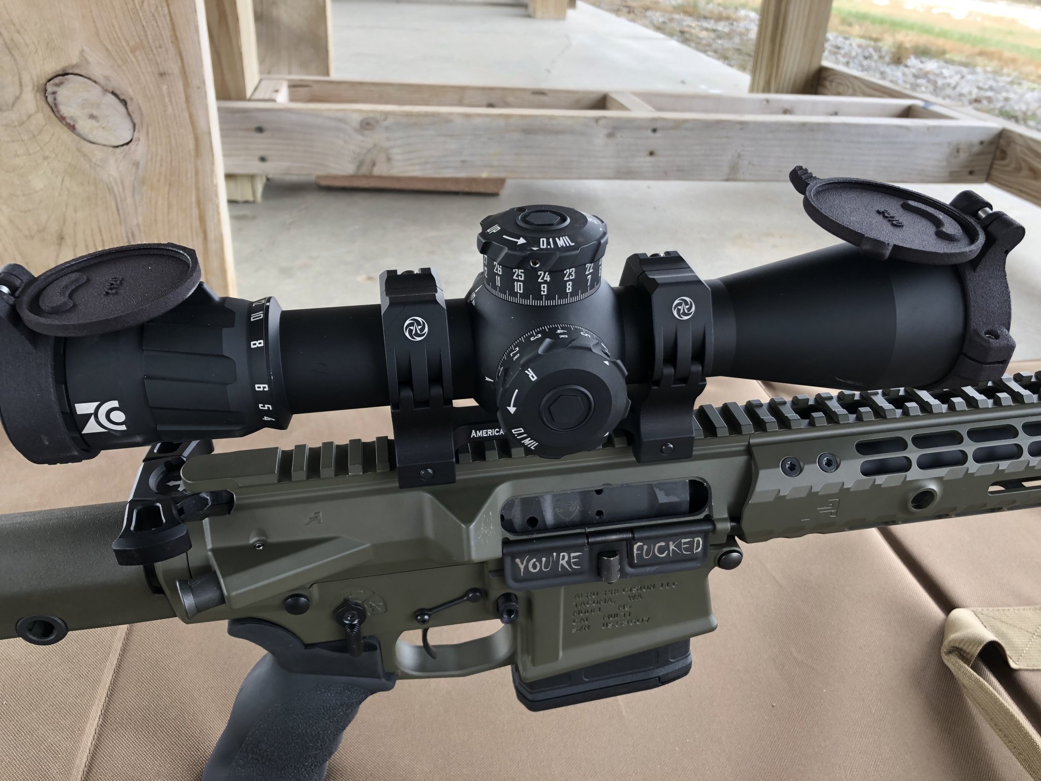

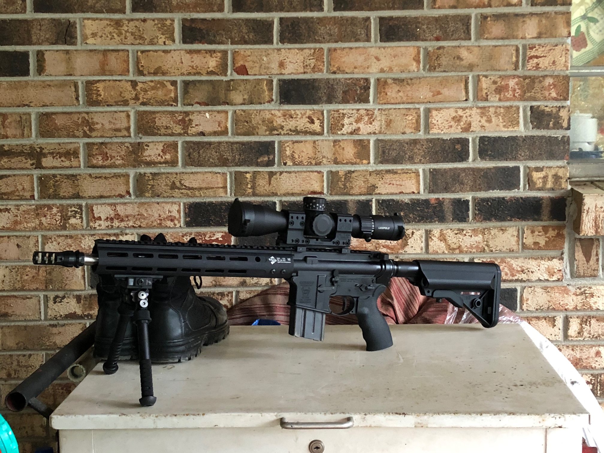

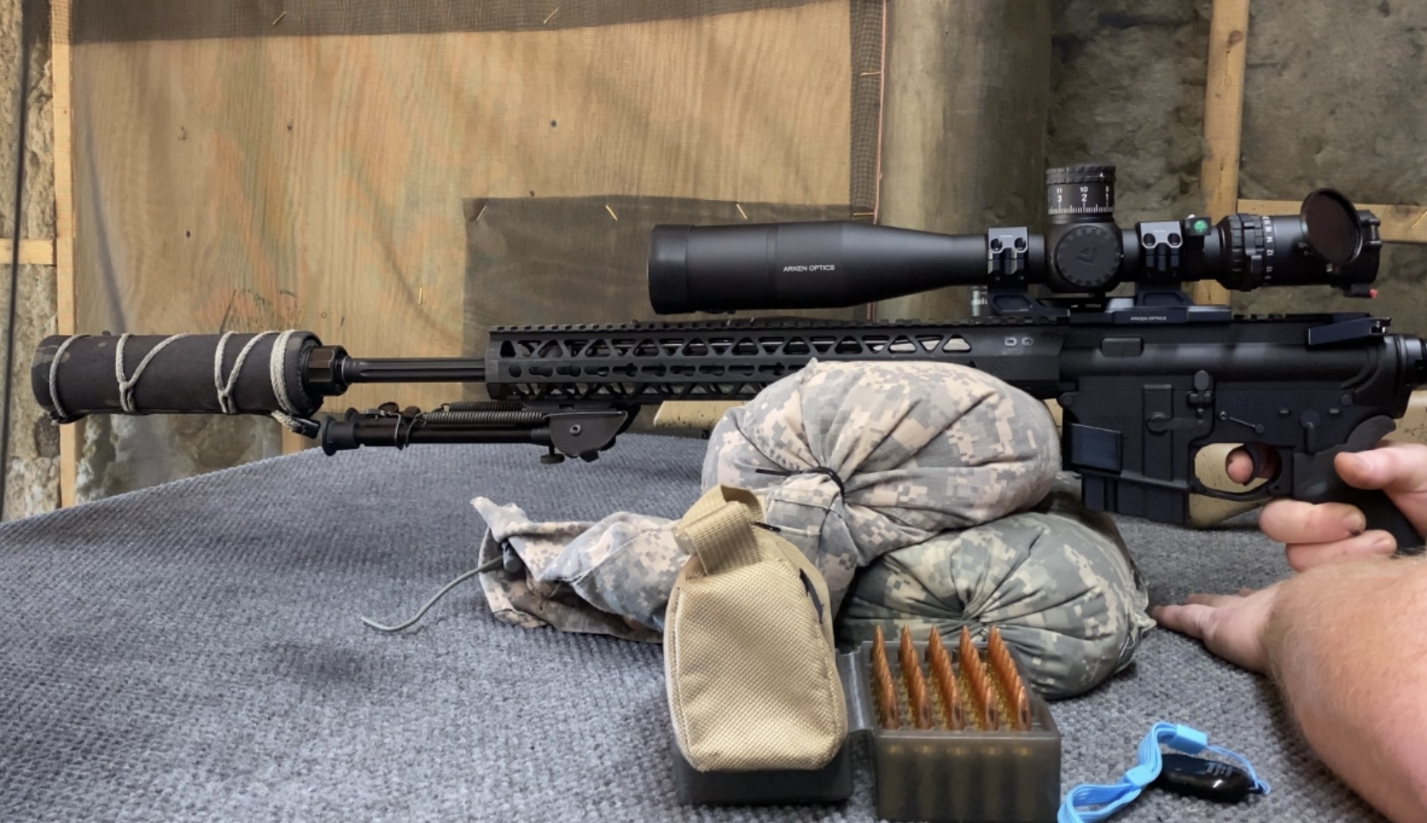

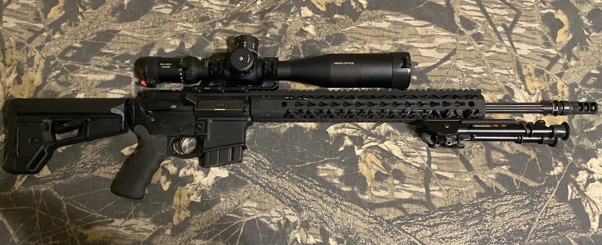

Don't rule out the March FX 4.5-28x52 wide angle. March FX D28HV52WFIML I have one sitting on a large frame AR and have no regrets at all. On par with the S&B Ultra Short and ZCO 420 in both size and weight.
I was between this and the ZCO and ended up choosing March. No regrets.

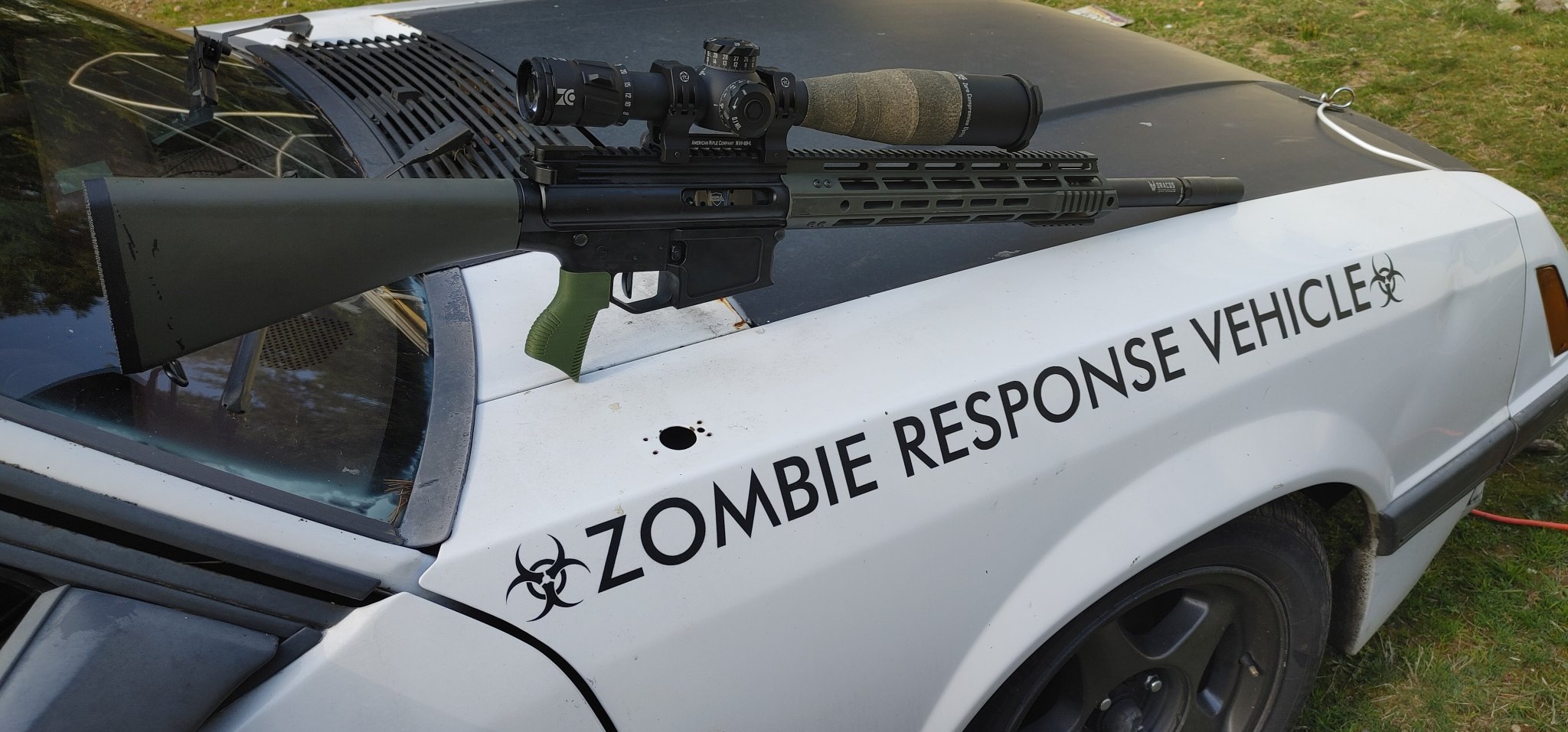

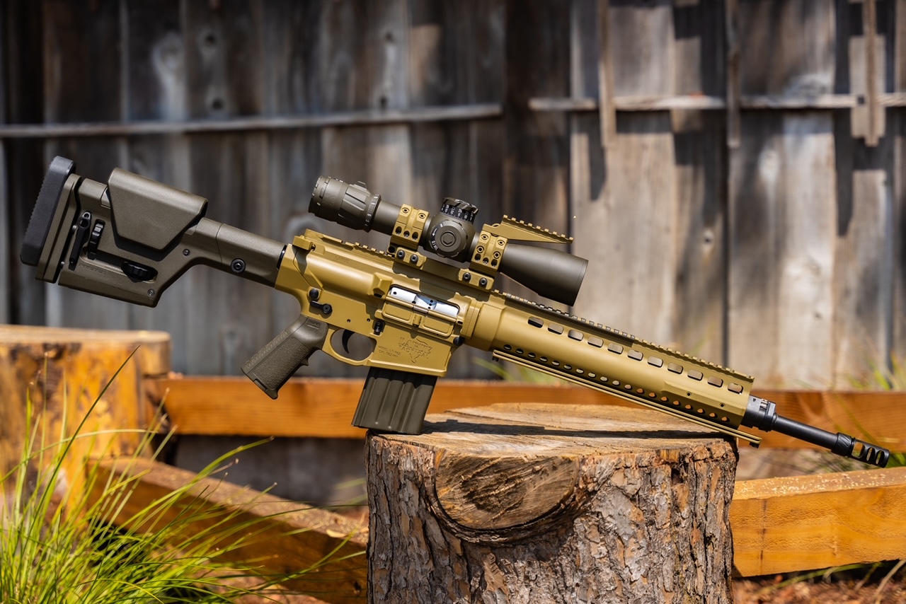

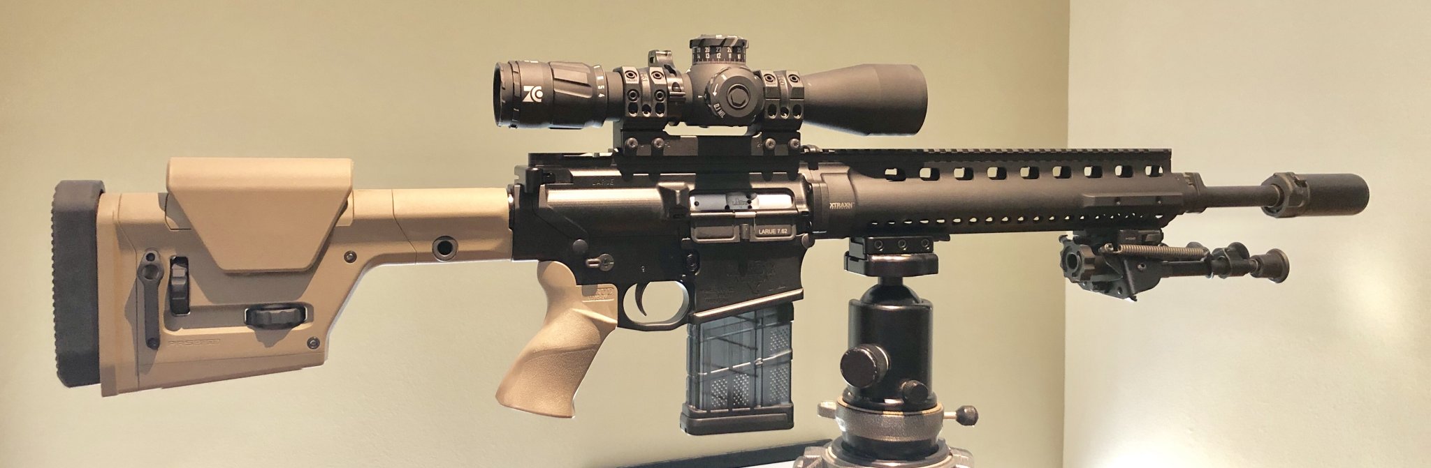

For example, this was my SPR build plan with a Viper PST II 3-15x44mm scope as a stand in:
It's still a build in progress, but here it is IRL with an Athlon Ares BTR 2.5-15x50mm scope:

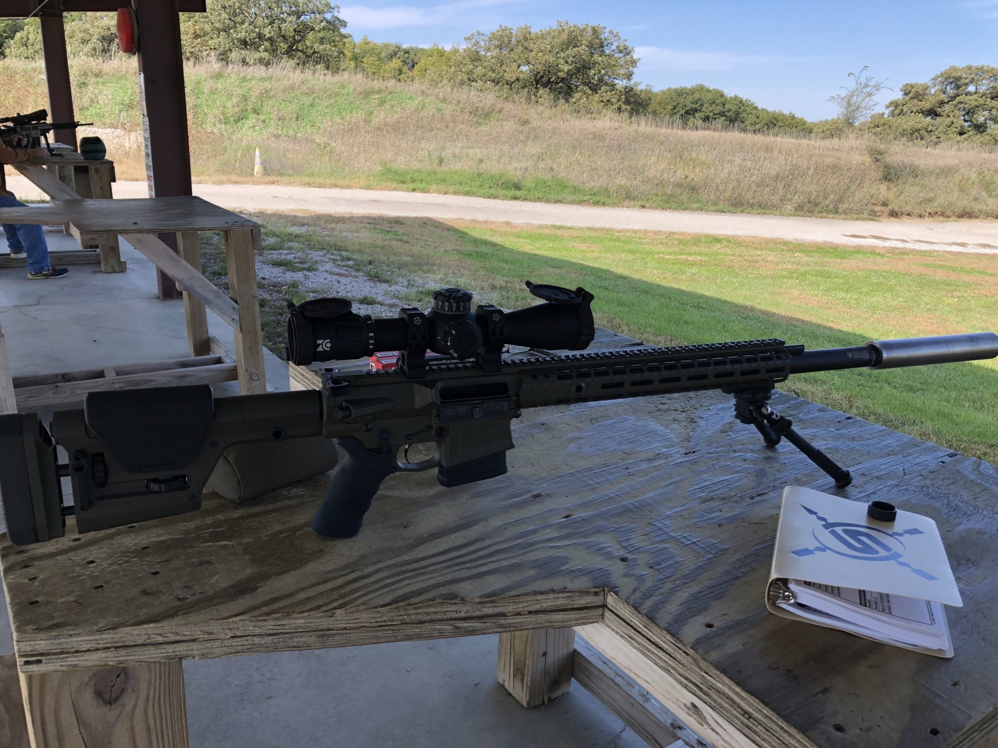

I have these and like them a lot:
18" 556 with ATACR 4-16x42
16" 6.8 with NX8 2.5-20x50
If I was going to build a 20" gun, I might consider something like a 4-20 or 5-20 UltraShort for the variety of it. Still, I don't think I'm missing anything with my current ones.

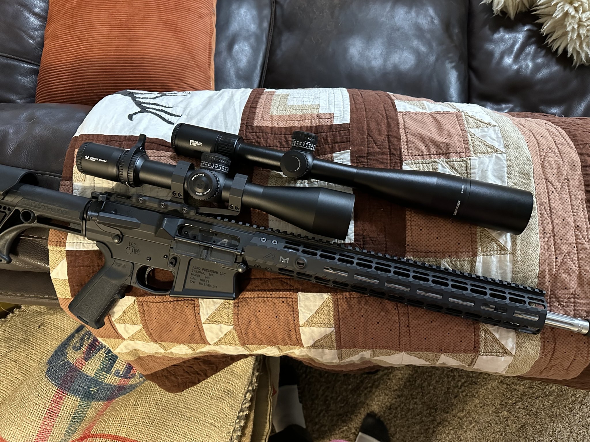

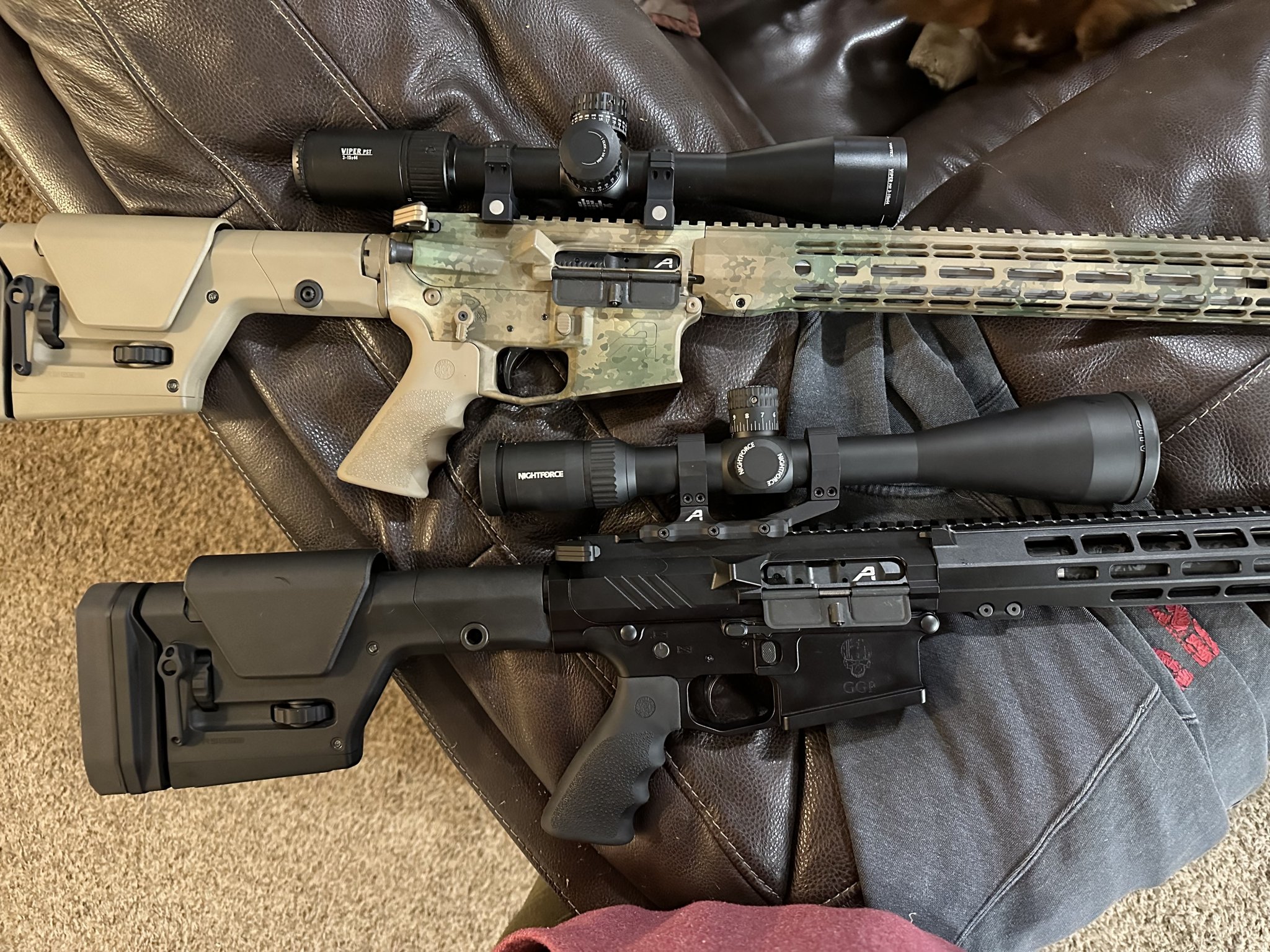

Top firearm, Vortex Viper PST 3-15x44 SFP on a small frame .224V build. I like this for size. This has a Bartlien Barrel in an Aero set, Larue MBT-2S trigger.
Bottom firearm, Nightforce SHV 5-20x56 SFP on a large frame 6.5CM build. Swapping this to my .22 trainer for a Vortex Viper PST Gen 2 5-25x56. This has a Proof CF barrel in a Grey Ghost Precision set, Geissele National Match High Speed Trigger.
Top scope is the before mentioned Viper PST 5-25x50 SFP
Rifle is a Strike Eagle 5-25x56 FFP (my first FFP to try and play with) on a large frame .308 build. This is a 34mm tube which made mourning options interesting. I used an Areo mount. This has a Rainer Arms Ultra Match barrel in a Aero Enhanced set. Has been a solid <1” firearm with a Geissele G2S trigger. It got a Geissele SSA-E tonight from the 6.5 above, that one got a National Match High Speed.
Hope the scope size comparisons help.

What is the rail used to mount these two scopes? I like that it lets you lower the scope to the bore line by using regular rings. Thanks in advance. I couldn't see markings on either one. Nice rigs.
Not sure what is in the pictures but PRI makes very similar riser mounts.

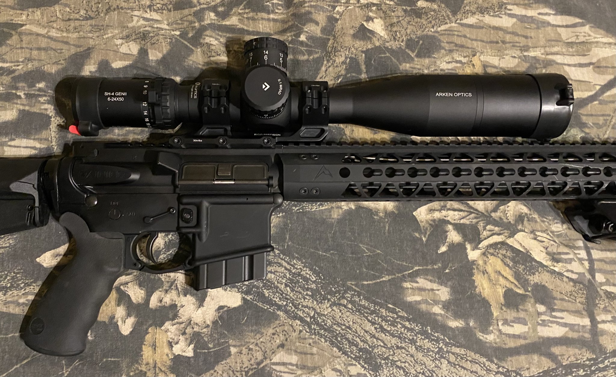

20” 6.5 Grendel custom build… Arken SH4 Gen2 6-24x50 VPR MIL in their 34mm 20MOA AR mount. Works great. It’s a pretty hefty scope, but when mounted it’s not overly heavy or burdensome. Balances well, especially with a Can on the end. The extra magnification is nice, as well as the huge amount of elevation adjustment, thanks to the 34mm tube.
