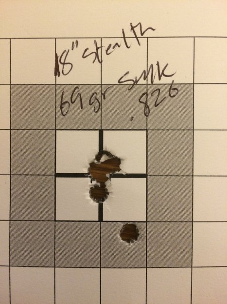

    I had a LaRue 18" Stealth. Loved it! Just replaced it with an 18" Stealth in 6.5 Grendel to fill the SPR role. I'm going with something shorter in 5.56. This group was initial ammo testing to see what it likes. It also liked 77gr FGMM really well. Buy with confidence. It was pretty consistently sub MOA, though I felt I was limited somewhat for group shooting with my 3-9x40 VXR Patrol. Replacing that soon as well...
