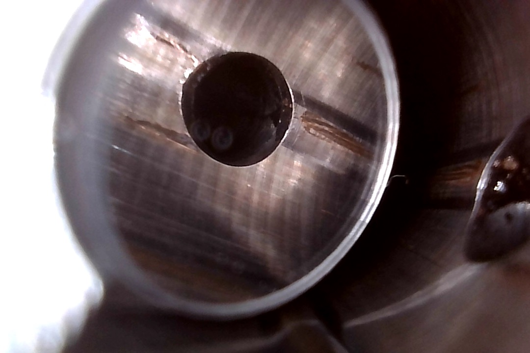

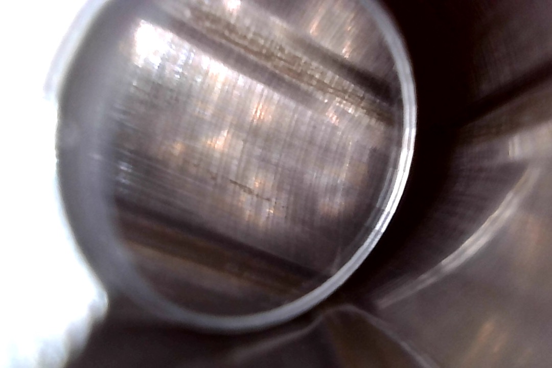

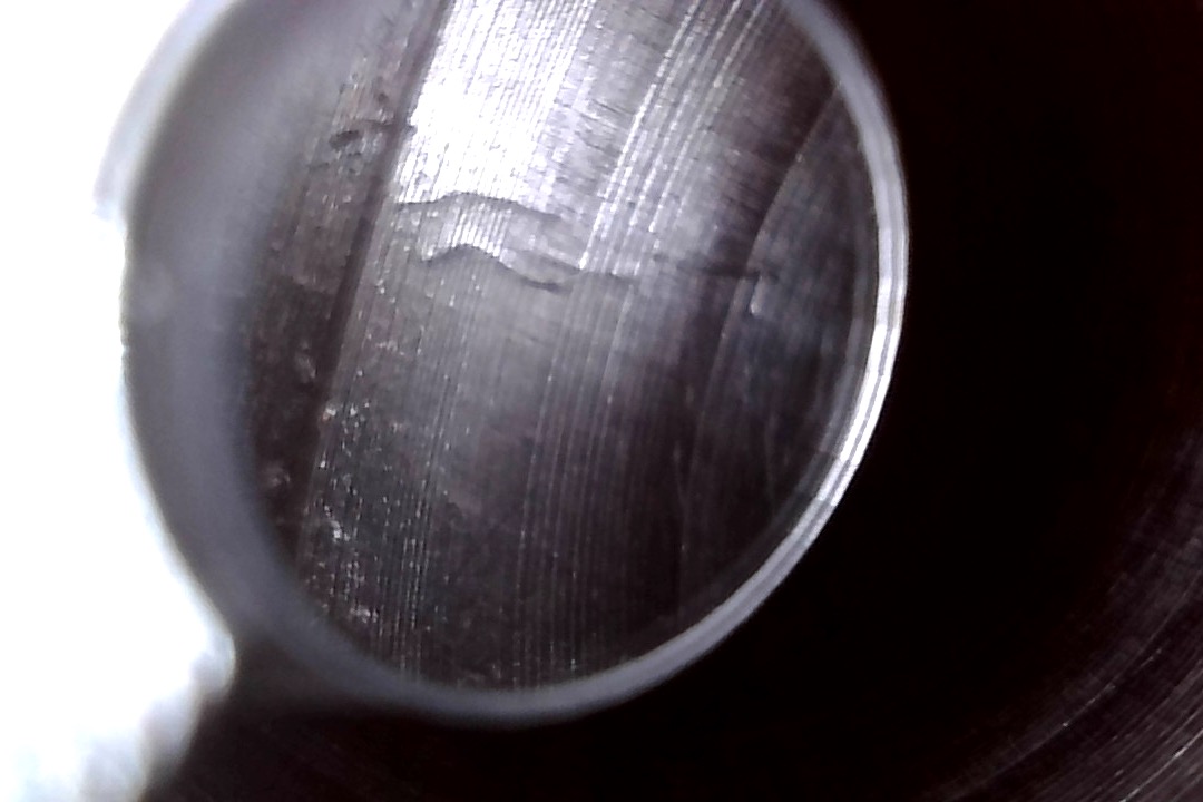

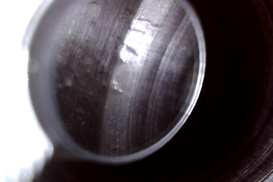

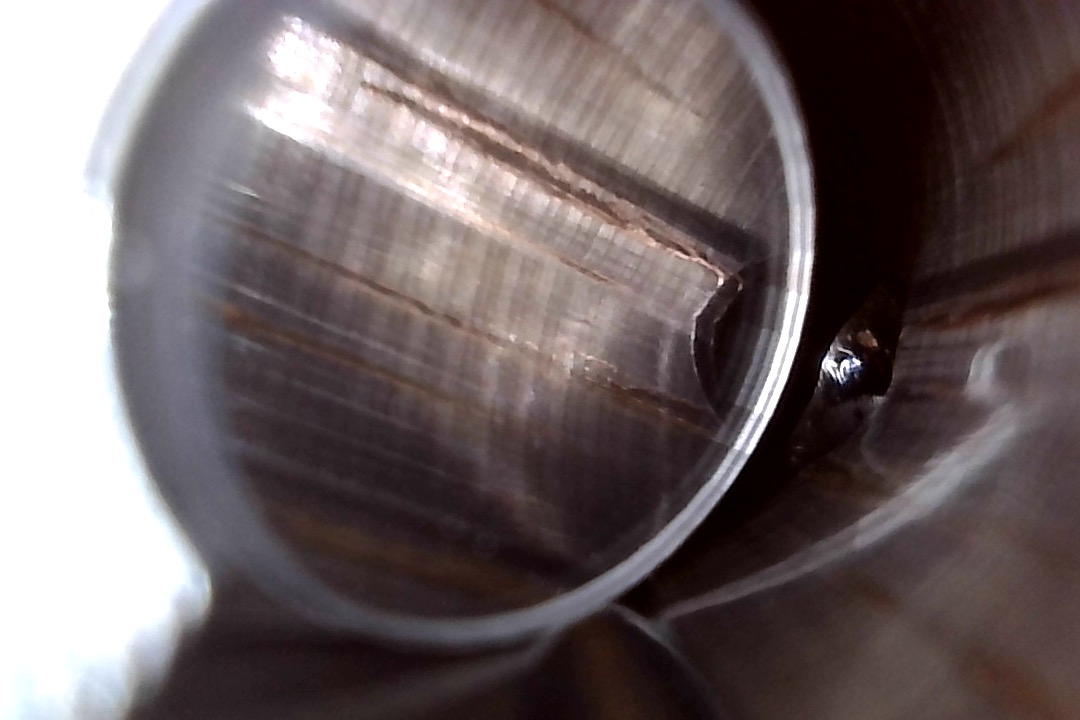

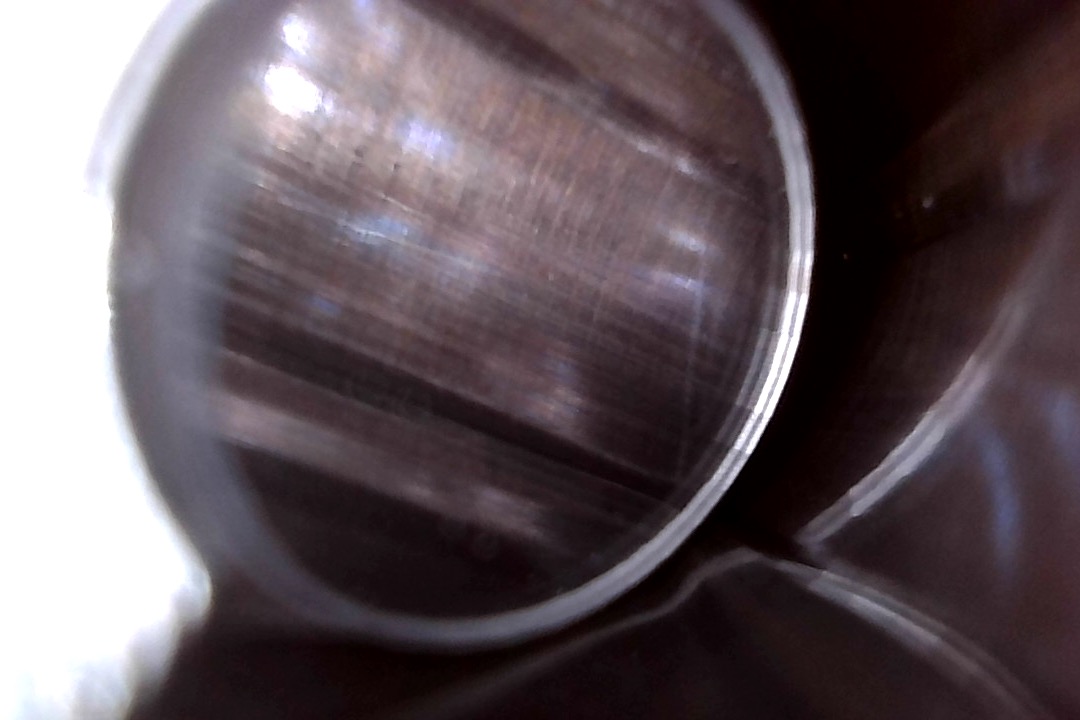

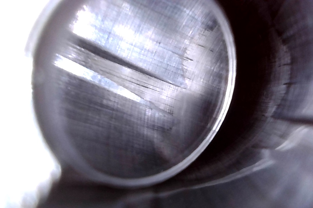

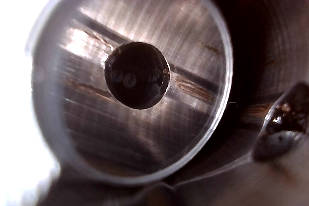

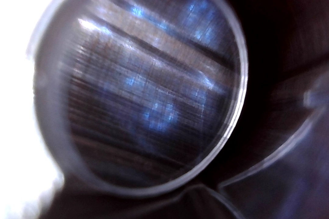

All that being said- I have been listening to those that have been helpful. Here are pics of the cleaned bore of the Seekins SP10 and more closeups of the gas port. Enjoy: (I might brush and clean it out one more time)
It is interesting that some parts of the bore are more silver and some are more brownish or bluish. Why is that?
That’s not clean IMHO. Carbon and copper still present. Iosso!
Yes, agreed. What do you suggest I use? I only used CLP. I do have some Hoppes regular and copper remover.
But as this is supposed to be a factory new barrel, I don't want to "over-clean" it. The manual says nothing about break-in process and I have heard some debate on that.
Most say just shoot it a few hundred rounds, then clean it gently. Then shoot some more...
Iosso. Ha! I just saw Frank Greens post on abrasive after I posted. Proceed with caution if you go that route. I’ve never had an issue using it, nor the folks in my circle, though. But then I’m not a premium barrel maker either.
The discoloration that you're seeing is due to the Heat from test firing the barrel.
Before you start barrel break in remove all excess cleaning solution or oil that's inside your Barrel looks like there's still a pretty thick film, then proceed with barrel break in as follows. Also make sure you're using a bore guide a coated 6mm cleaning rod and a quality and proper sized Bronze Brush. You also want to run the BCG pretty wet.
While conducting barrel break-in you should be dialing in your adjustable gas block.
I recommend using Hoppes #9 Black
Shoot (1) then clean (5) passes
Shoot (3) Clean
Shoot (5) Clean
Shoot (10) Clean
shoot (20) Clean
At this point your barrel is good to go, I wouldn't clean again until after the next 100 rounds.
Make sure to completely remove/patch out any excess cleaning solvent in the bore and chamber in between cleanings.

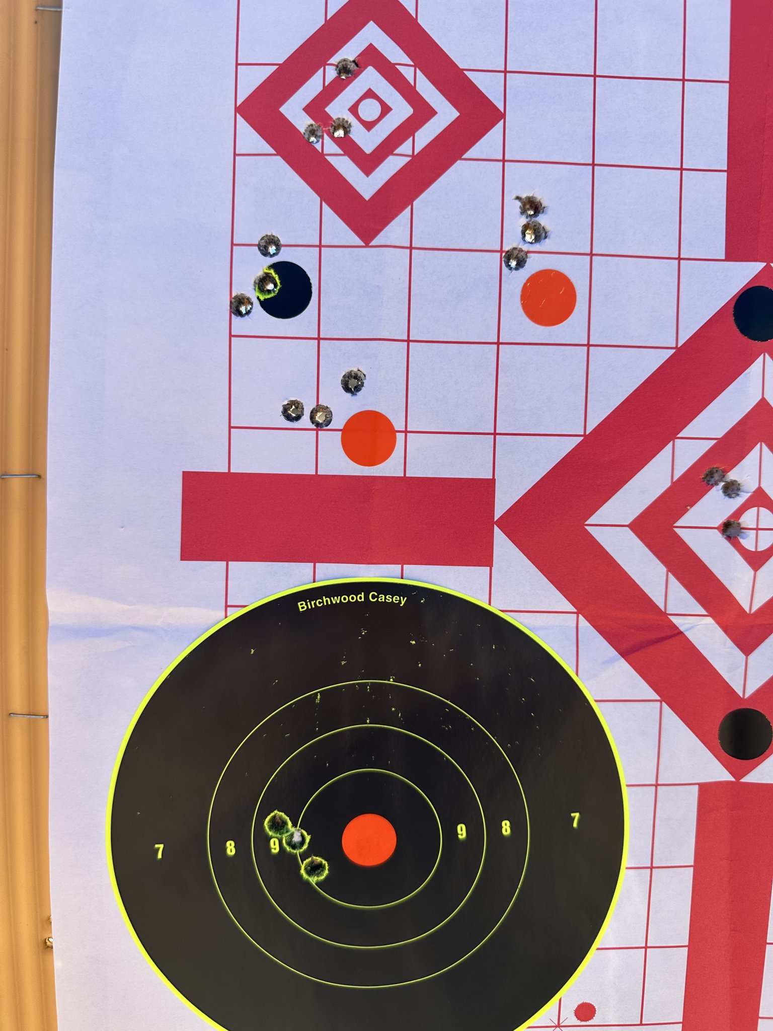

6.5 creed 140 eldm 41.3 r16 Peterson brass mag length. It is easily .5” and I’m not the great shooter.
These groups were shot standing behind a bench back to back in a rush.
Sweet 3 shot "groups". Got any actual groups to show? :)
