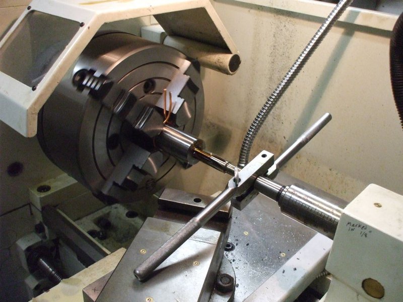

I am on my 4th lathe in gunsmithing, with a PM1236 since 2009.
In 8 years I have done ~ 25 rifle barrel threads and chambers, but mostly other stuff.
With DRO, I have $4k into it.
I have repaired the gearbox. I have repaired the DRO.
My opinion is shared by a few..... Not enough old surplus lathe to go around for all the amateur gunsmiths.... but there are plenty of surplus mills to go around for every wanna be gunsmith.
  • Lathe Lothar Walther barrel 7mmMag reamer held with tap wrench and Sulfered cutting oil on rea...jpg
