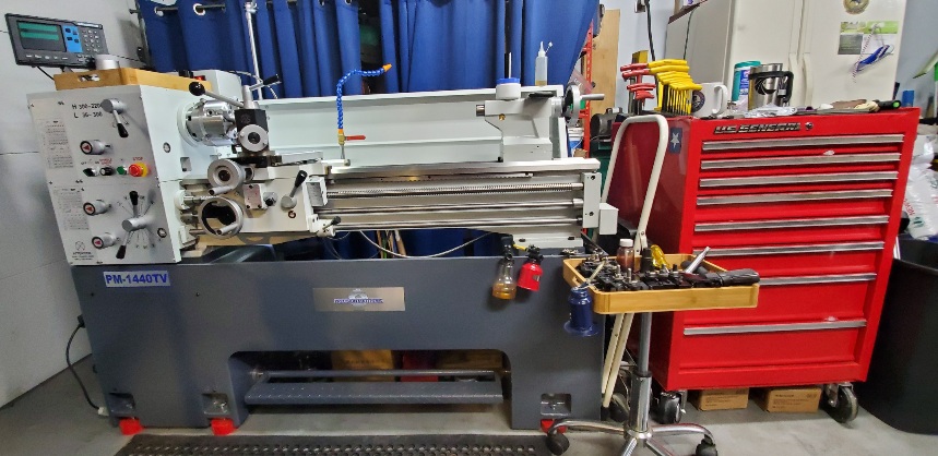

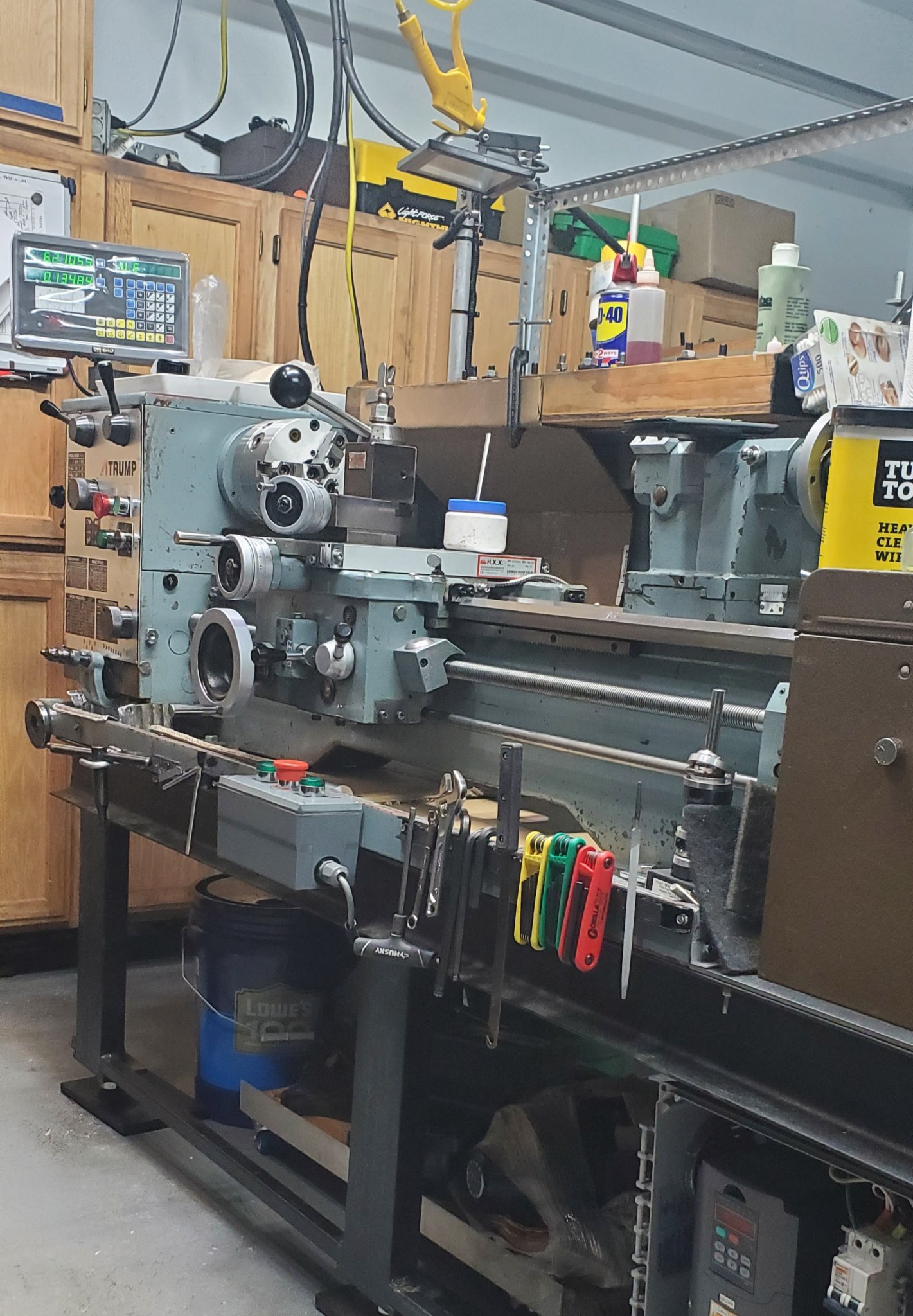

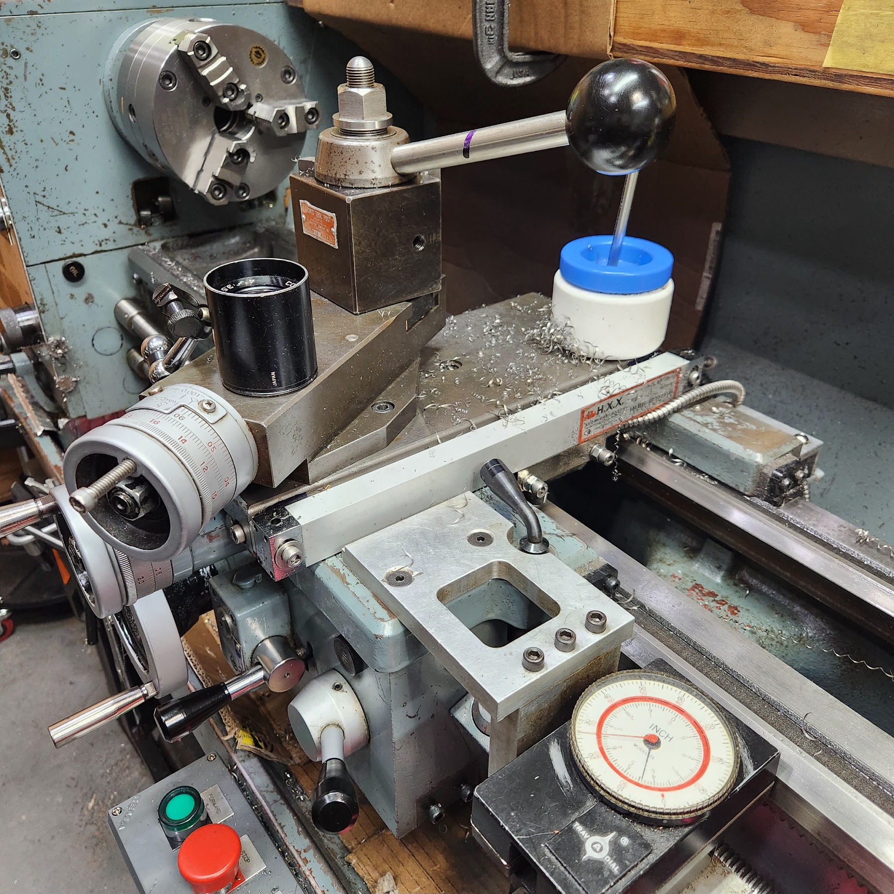

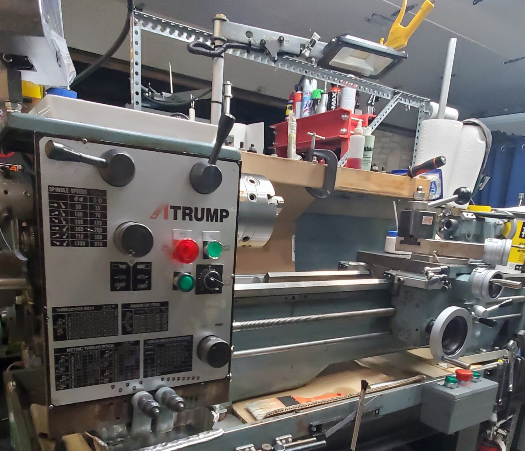

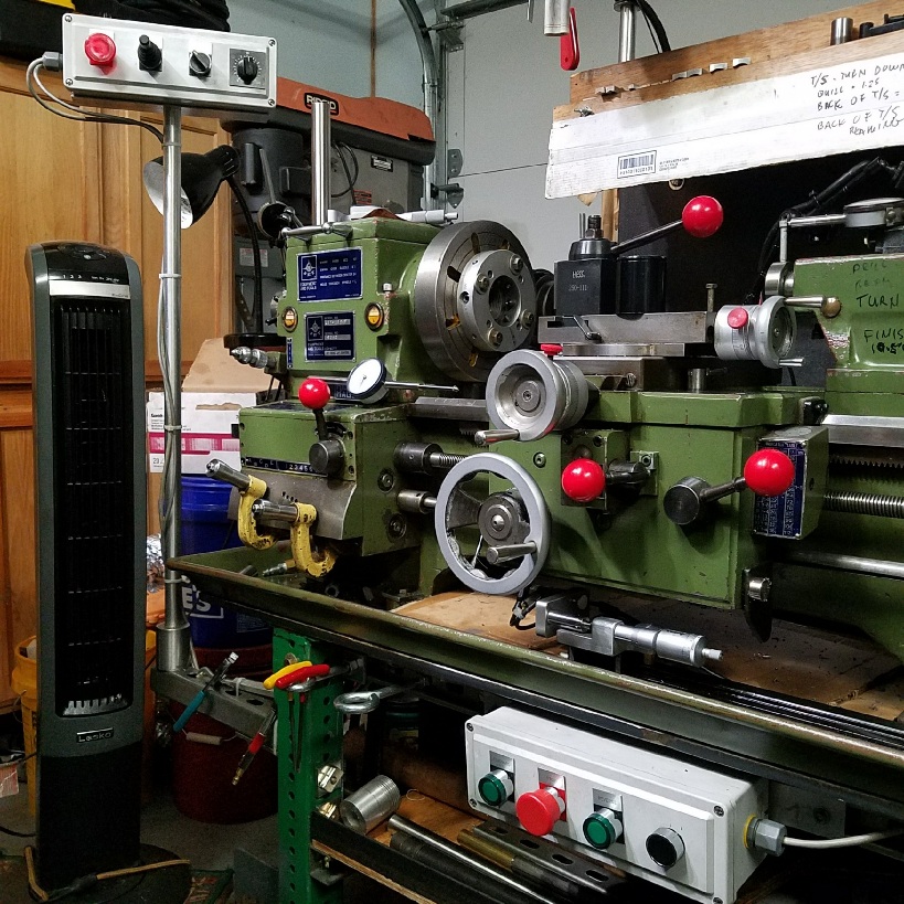

That's the lowest the VFD runs it, 34 rpms. Finish is real nice with carbide for aluminum laydown inserts.
I could run faster, there is really no need with the made for aluminum inserts.
Have VFD on all 3 lathes I use for barrel works. The 1440ev came with a factory installed 7HP VFD feeding the 5HP motor. The 1236 and 1024 VFDs run 2HP motors. All lathes are Taiwanese made.
The DRO on the 1236 died after a year, re-installed the TravADial
View attachment 8087226View attachment 8087227View attachment 8087228View attachment 8087229View attachment 8087230
Nice setups. My Jet 1236 is of the same type as your green 1024, just a slightly bigger drive box around the spindle, and it's gray. (Taiwan made, 1991). It's the belt drive version of course; the gear head version like your 1236 is what a good friend of mine has and its a lot more convenient for speed changes, not having a VFD of course.
Tell me about the micrometer stop piece at the bottom of the apron on that green 1024 - what does it do and what do you use it for? I haven't seen a stop mounted down low like that before.
That 1440 with the VFD is a sweet setup. I'd love to upgrade my 1236 to one like that.

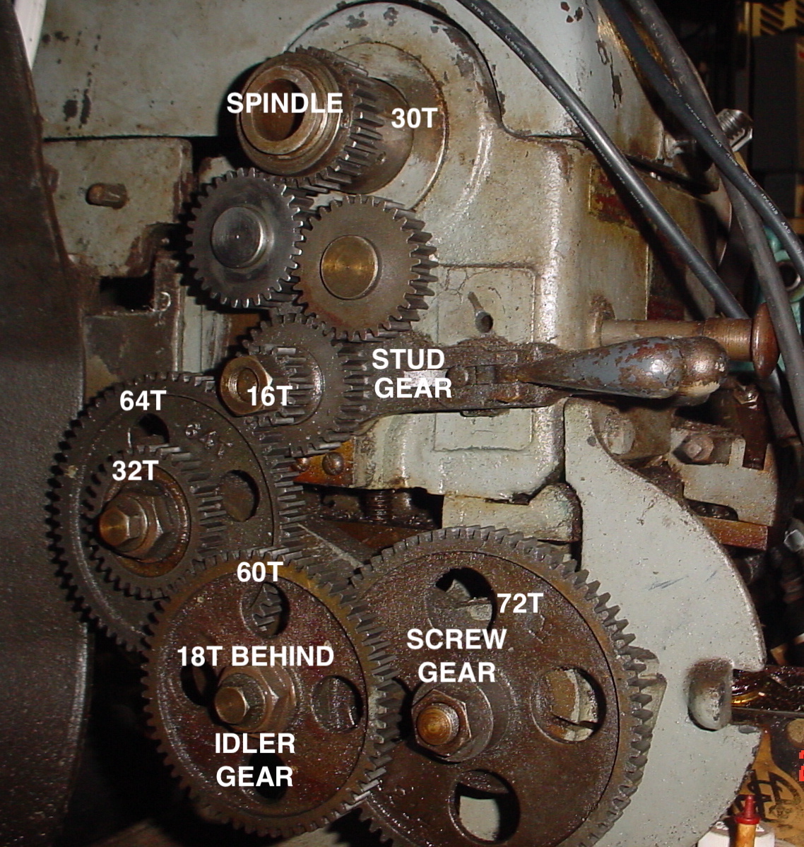

My 1946 Logan 850, threading 6AL4V Titanium, using the AR Warner HSS.
This logan is about as rigid as a wet noodle, so I have not tried carbide.
No gearbox, I have to use the gear chart and manually install/remove/shift gears around.
With patience, it works!!!!!
@Yondering the proximity sensor is attached to the micrometer. I slide the set up on the flat rail, lock it down, then use the micrometer for the final adjustment where I want the carriage to stop at speed. Once the proximity is set, don't want to change the spindle, as stopping point may vary.

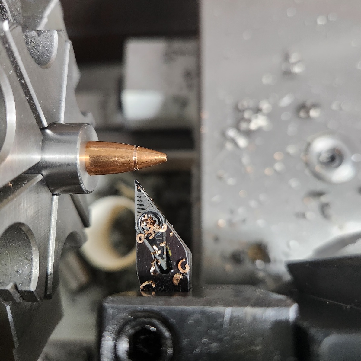

@Yondering you asked about the 34 RPM, reminded me of the plandemic project I did threading at 34 with laydown carbide. 5/8x24.
Jig was chambered like a barrel, the case shoulder bottoms out on the chamber shoulder. The round is held in place by a threaded cap. Sample round is a M118 LR
Reactions: AMGtuned
lol.. about the annular cut? I used the same jig to trim meplat on M118 LR ammo for my hog hunting rifle. Then run #1 center drill to chamfer.
Boiler room behind the shoulder shot never had an exit hole.
What are you doing with the cut in the previous post, so far back from the tip? Is that to make the tip break off in meat, or something else?
Those aluminum cutting inserts certainly are amazing; not your granddaddy's carbide.

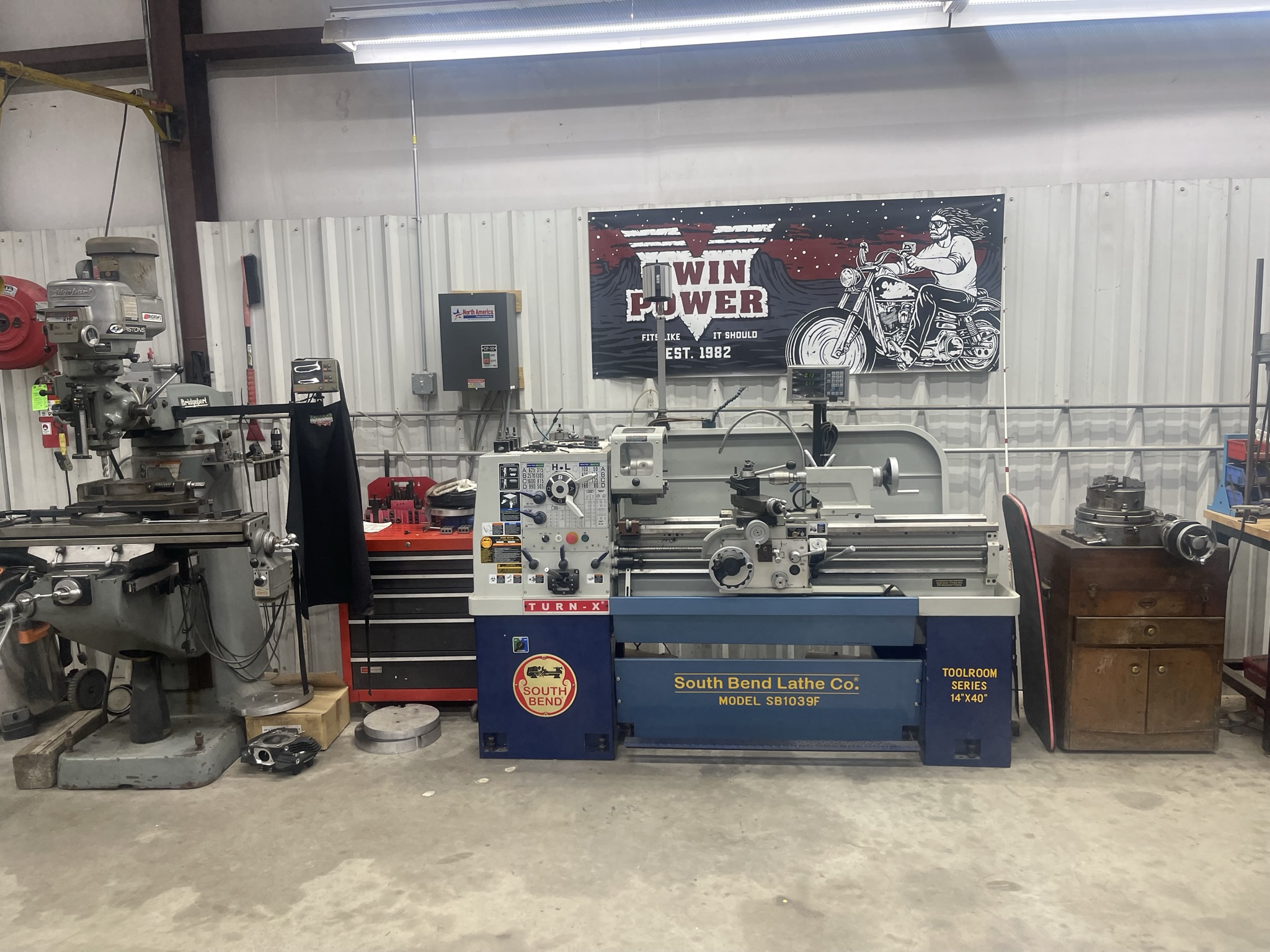

I picked this one up used . Had to make a 2 hour trip from FW into Ok but worth it . I got taper tool 3 heads . ( 3, 4 &6 jaw ) . bunch of extra stuff. I gave $6500 for it it in almost new shape. ( used for 2 months ) I build engines so my use is not working on guns. I am learning to thread ha ha its not very easy that is for sure . For a solid unit that you do not have to take apart for gear ratio changes. Heavy so it does not move around on items that are not balanced. I feel it checks the boxes . My buddy has this version in a Jet . I have used his and vice versa . I would take this over the JET any day of the week .
I picked this one up used . Had to make a 2 hour trip from FW into Ok but worth it . I got taper tool 3 heads . ( 3, 4 &6 jaw ) . bunch of extra stuff. I gave $6500 for it it in almost new shape. ( used for 2 months ) I build engines so my use is not working on guns. I am learning to thread ha ha its not very easy that is for sure . For a solid unit that you do not have to take about for gear ratio changes. Heavy so it does not move around on items that are not balanced. I feel it checks the boxes . My buddy has this version in a Jet . I have used his and vice versa . I would take this over the JET any day of the week .
That is a killer price. Those newer grizzly SB are super nice lathes...we had one in machine class. That's probally a 15-20k lathe new. Good find.
That is a great snag. Made in Taiwan, robust lathe that will serve you for a long time.
