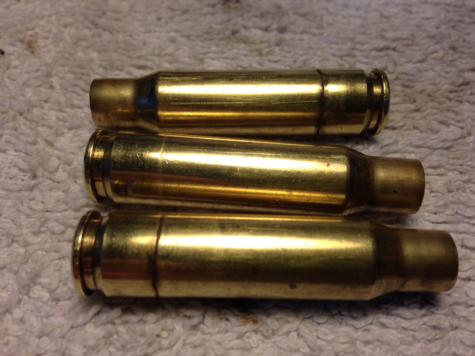

Personally I wouldn't waste my time with it, I have a few thousand rounds of LC that was taken from the M60 range. I deprimed it, cleaned it, sized it with Forster Full Length die and trimmed to length. Loaded it with 41.5 grains of Varget a 175 gr. Sierra Match King and fired it from my 308 Remington 700 one time, and then reloaded after the same prep. At the next firing the brass separated near the base and when I looked really close at the brass that had been shot only two times most of it showed signs of the beginning of cracking in the same place. Reloading takes a pretty good amount of time and I want to get more than one shot from brass that I work that hard on. Just my 2 cents worth

Personally I wouldn't waste my time with it, I have a few thousand rounds of LC that was taken from the M60 range. I deprimed it, cleaned it, sized it with Forster Full Length die and trimmed to length. Loaded it with 41.5 grains of Varget a 175 gr. Sierra Match King and fired it from my 308 Remington 700 one time, and then reloaded after the same prep. At the next firing the brass separated near the base and when I looked really close at the brass that had been shot only two times most of it showed signs of the beginning of cracking in the same place. Reloading takes a pretty good amount of time and I want to get more than one shot from brass that I work that hard on. Just my 2 cents worthView attachment 7096809View attachment 7096809

Die is set according to Forster instructions, I don't change my sizing die setup for different guns, bolt or semi auto and I've never seen this happen with any other brass. I have Lapua brass that's been loaded 10 times (for bolt gun) with no problems in the same die, same setting. Sometimes stuff just get's stretched too far to be reliably usable. Back when brass was in short supply some folks were selling reprocessed machine gun brass, I'm not using that stuff in my guns as long as commercial brass is available. I have given some of this brass to a friend and it did the same thing, so maybe "It wasn't set back too far" and just a case of bad brass

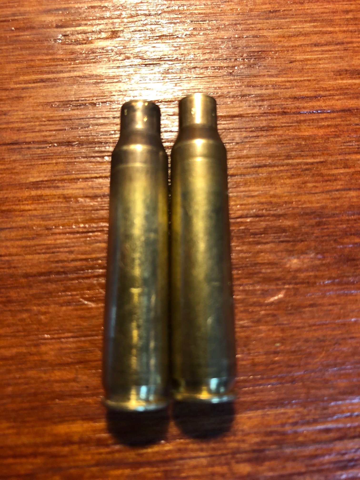

This will be my last back and forth with you (918v), now pay attention; I have been loading precision ammo since the early 1980's and competed in High Power Rifle matches for decades and never had a mishap. Brass from this lot or batch was reloaded by other people also and it did the same thing in their guns, it was fired from a machine gun with probably a very loose chamber and it is not fit for reloading. Get over it Einstein, some brass is just not fit to re-use, the attached pic is of new once fired LC 556 brass picked up at the local range last week. It was new ammo fired from a customer's AR 15. I guess that Lake City pushed the shoulder back too far on that lot of ammo, right! LC brass is not Lapua or anything else commercially available. LC brass is designed to be fired and left on the ground and not re-used. That said; I have used thousands of rounds of fired LC 556 brass with no problems in AR 15's. I still will not use LC 308 in any of my guns because of problems due to over stretching. You sir make snarky comments about my original post about brass splitting and you have no idea of how the brass was prepped or any other details of the matter. No, you just keep the wise cracks coming and guess what, you still know nothing about this matter. I won't be responding to anymore of your nonsense so don't go away mad, just go away! You are also the big reason that I will never and have never fired anyone else's reloads, I value my guns too much for risking them on someone else's hand loads
