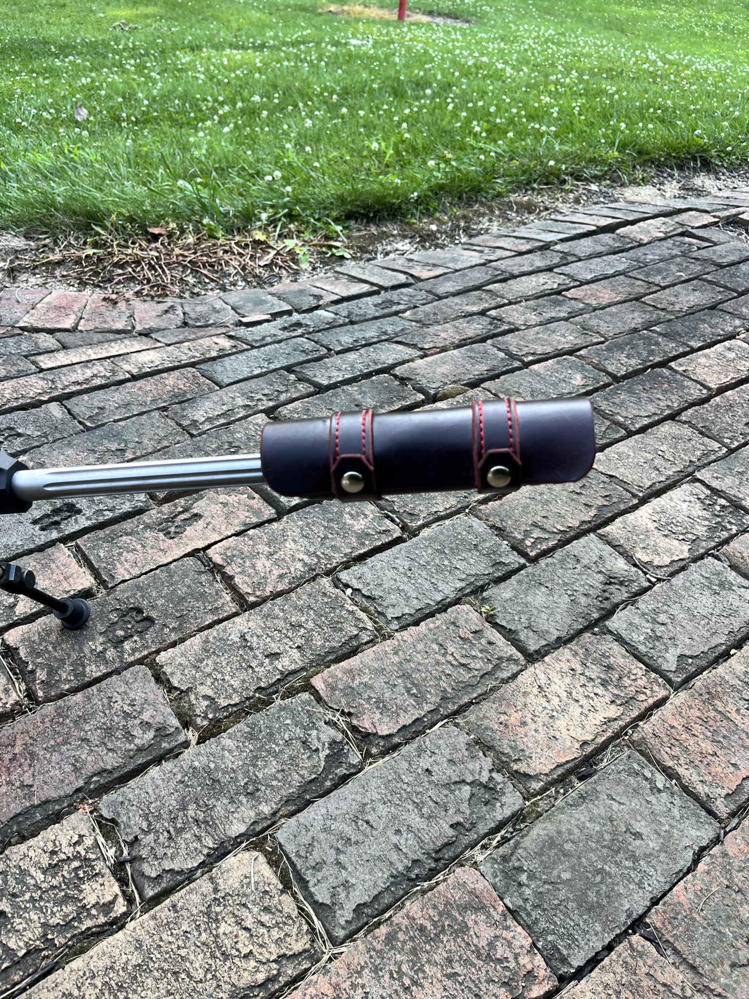

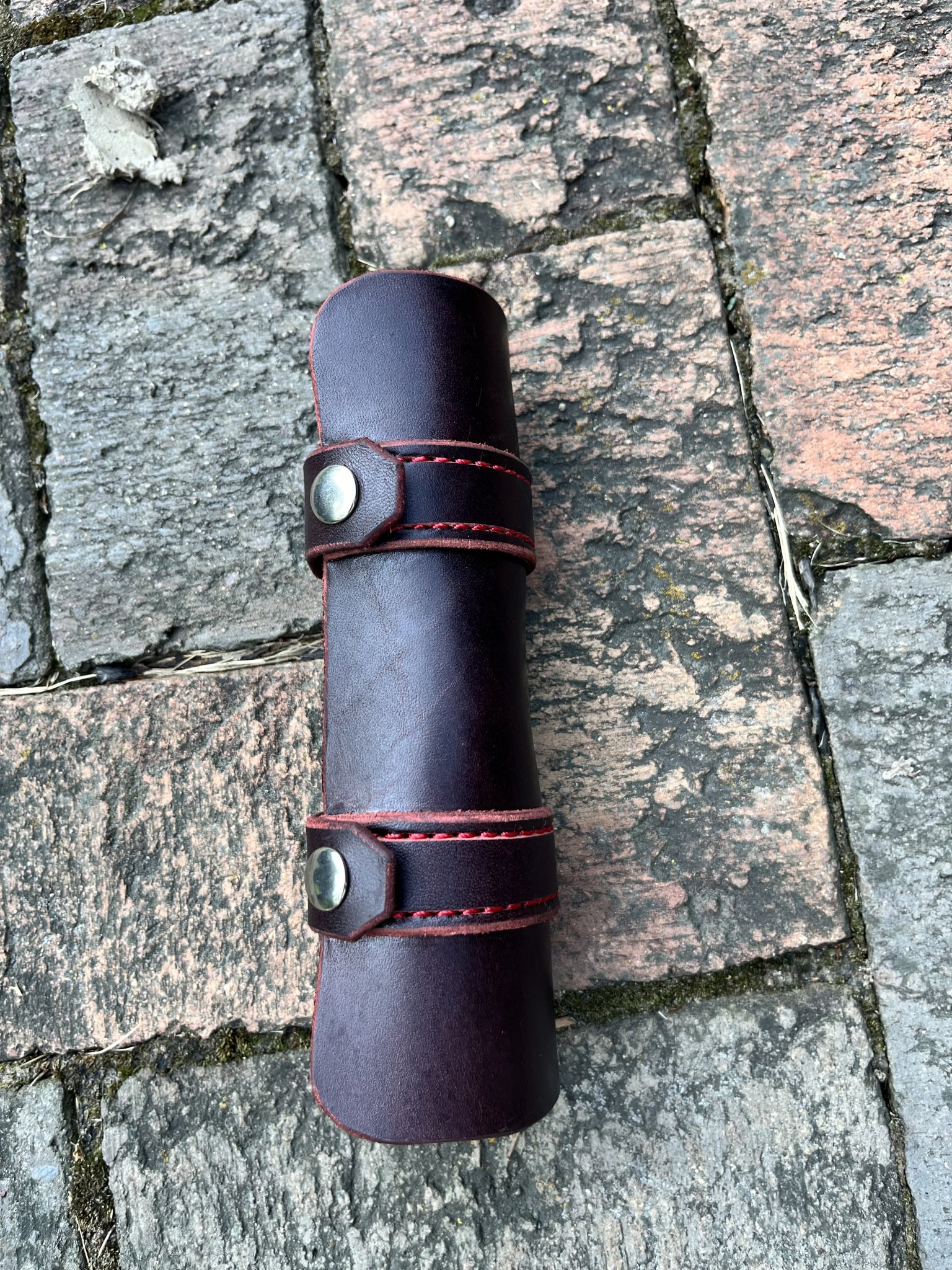

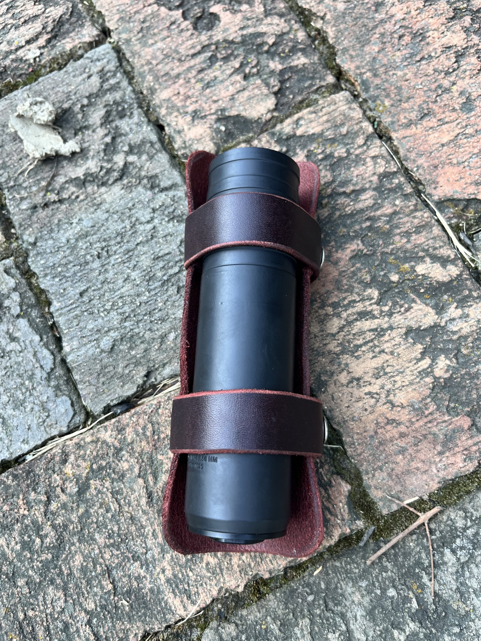

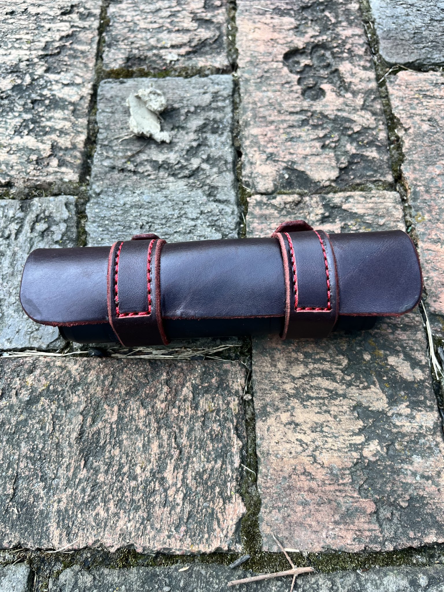

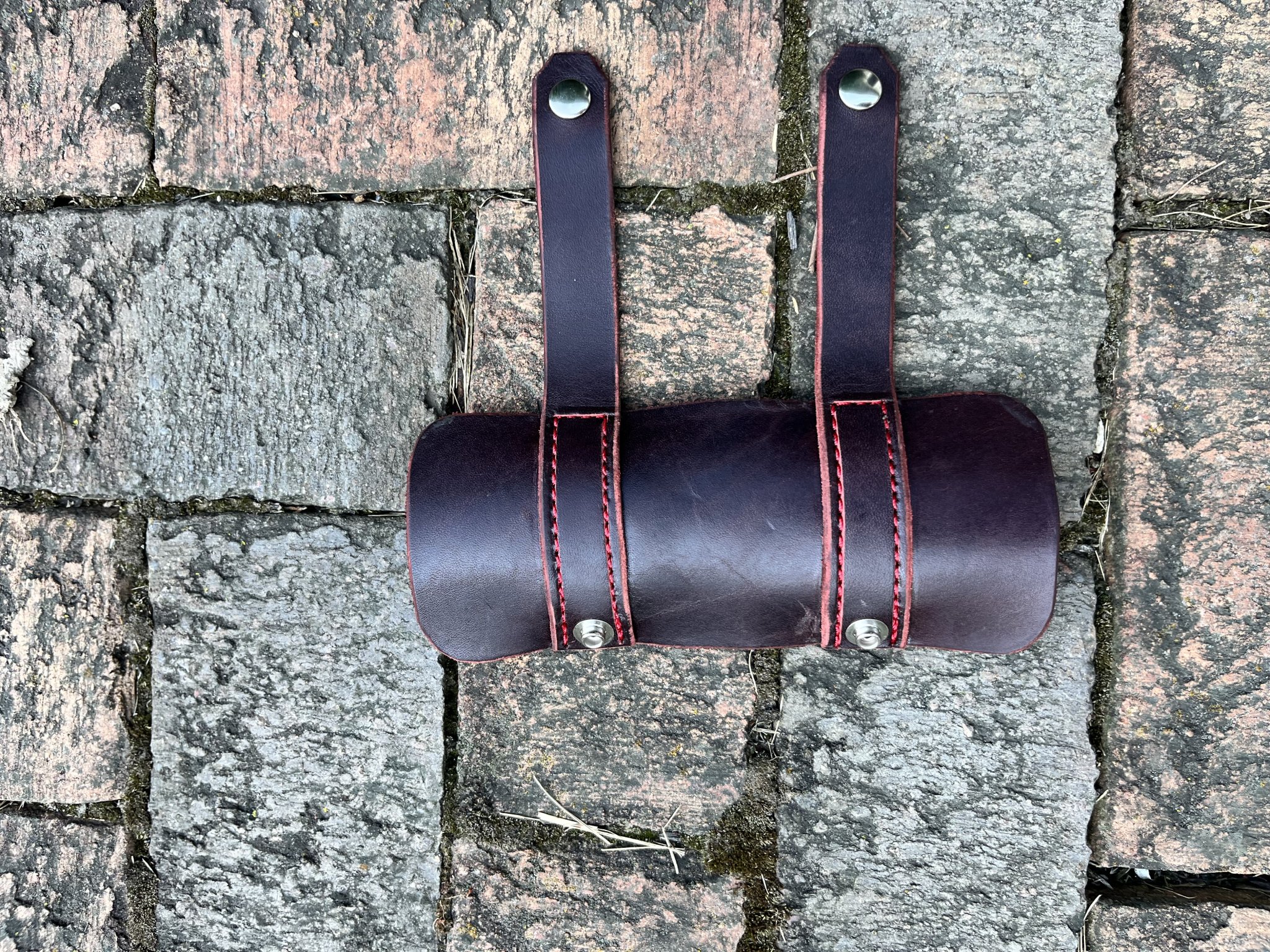

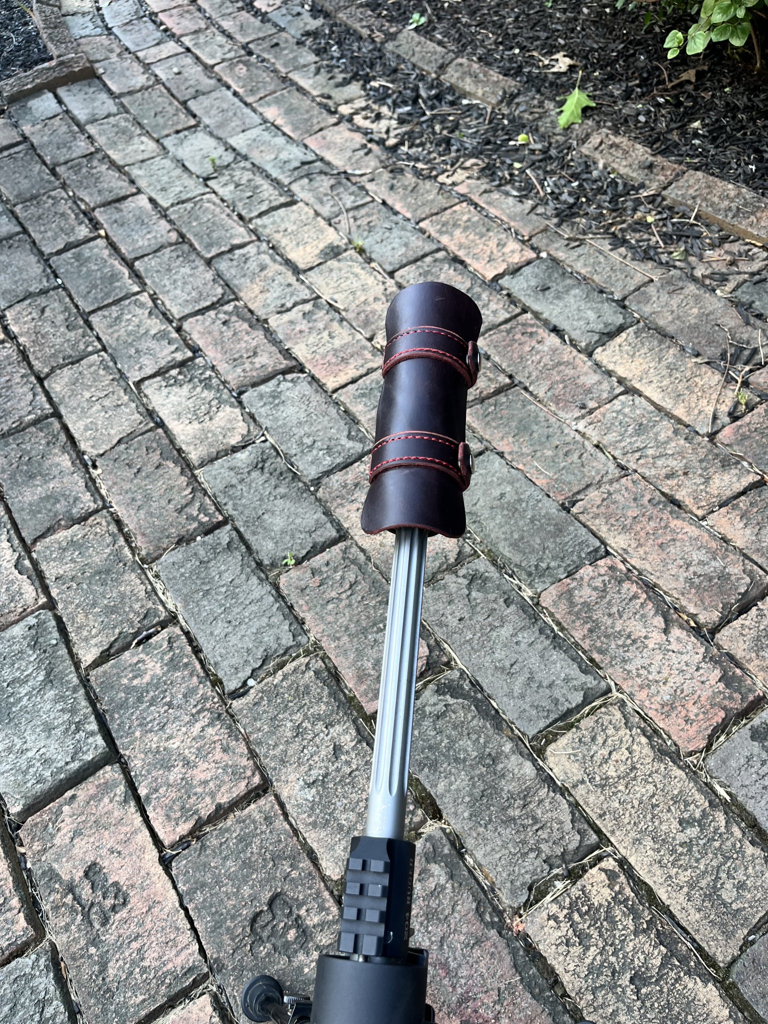

I just got my first suppressor a week ago. As I was sighting in my new scope I discovered the heat mirage you get after even a few shots. I experimented with just laying a piece of leather across the top and it worked good for me. So this evening I made something a little bit nicer. It has the two thick strips of leather that are the only pieces touching the suppressor and it also holds the shield up off the suppressor 3/16” or so. I’m hoping that will help with cooling. I’m happy with it so far for what I’m doing.

Interesting concept... I've also noticed the mirage after just a few shots with my titanium cans, even with a nice Rifles Only Gear HAD cover. I'm curious how much better the leather will work, and I like the fact that the underside is still open so it will help it cool down faster.

Cool idea...but, does it not slip forward under recoil?
I’m careful what leather I get. I use it for knife and ax sheaths so I’ve kinda of learned what to get so it doesn’t make those rust.
As far as it sliding forward I have the straps really tight and for me it’s not a problem because I’m shooting a 204. I don’t know how it would do on heavy recoiling calibers.
