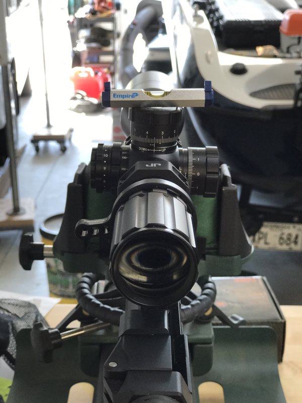

Well just thought I'd share. I have an SWFA 5-20 HD and over the course of approximately 100-200 rounds in a led sled the reticle got canted significantly. I was unaware of any precedent for this until I had the problem. In fact I didn't know it was canted until I replaced the mount and upon leveling it found it was off.
The rifle is an RPR in 6.5 creedmoor. Hardly a recoil beast?‍♂️
I know what your thinking... why use a led sled for a creed?! Well.... load development. I've gotten consistent sub 3/8 moa out of this gun setup like this. With out the sled I couldn't consistently rule out shooter error. With it I'm much more confident in my ammo analysis. So I'm. It looking to start a debate but just share my experience. It seems clear to me that the use of a led sled most likely contributed the degradation of my scope. Which I think is a fairly robust model.

Mildly confused! Are you saying the entire scope rotated on the rings, or that the reticle itself, shifted inside the scope?
The first you can address by mounting with quality rings ensuring all screws are torqued to proper values per manufacturer's recommendations while incorporating the rosin trick suggested by northern50. Easy to do.
The latter will require the scope be returned to SWFA for repair or replacement under their excellent warranty.
From the pictures I'm thinking you experienced the first. In either case, you will be made whole again.

No, your whole scope spun in the rings. So was it cheap rings or improper torque?
Yes. Unless I'm missing something, your reticle didn't move, the whole scope moved in the rings. A reticle moving inside the scope is a failure of the whole scope and needs a return to the manufacturer. That's a whole 'nother issue vs. a scope just slipping in the rings, which you can fix yourself.
I think my plan of attack would be this:
Loosen the rings, align the reticle with a plumb line at say 25 yards or so. Torque to spec. Tighten the cap screws in an alternatiing fashion to 15 in lbs and try again not sure what rings so i can't advise on what to torque the base of them at..... If you still exhibit problems you'll need to invest in better rings or try lapping the ones you have got. They may not be making full contact. Doesn't look like your reticle moved, your entire scope did.

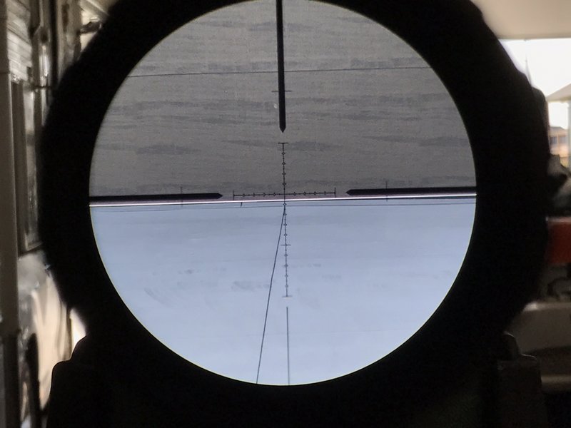

The scope did NOT twist in the mount. As you can see when the reticle and the top of the mount are level (see reticle pic) the turret (and the axis of the wind age/elevation adjustments) are out of level more than 5 degrees. The scope has to be rotated in the mount (a lot) to get the reticle level with the horizon. Or as you see the neighbors garage floor.
Get it?
I conclude the led sled is the culprit based off of the load of info on the internet claiming as much. Otherwise I have no explanation for how a 6.5 creed managed to rotate the reticle INSIDE the scope 5 degrees in 200 rounds.

I am sorry but are you sure you are using the level correctly? Because I see a lot of light between it and the elevation dial where it is "level". Your whole scope is rotated in relation to the rings, and your very first picture shows it clear as day.
P.S.: Yet I will say the reticle isn't tilted in relation to the turret. I don't know what you managed to do here, but my brain is done for the night. I will let the more knowledgeable come sort this one out.
Have you leveled your reticle to a plumb line yet? That is what I would do first. Re- level it, then torque to specifications using blue loctite. it is pretty common that turrets are not a good place to level a scope from, as most can be canted easiily. Also take your gun level from your actions scope rail as opposed to the top scope cap, as the top cap's level is influenced by how you torque the screws.

hey mate I think the guy above me just mentioned this but I found levelling with the turrets for my swfa scope to =FAIL. Depedning on where in the 360 rotation the turret is on mine the level will show either level or completely out of level. This may or may not be your issue just thought id put it out there. I ended up using franks stack of cards under the scope to level it I haven't taken it out to test it yet to see if the reticle is level with a tall target test etc yet but that's what I had to do with my scope as the turrets are no good to level off
"Because I see a lot of light between it and the elevation dial where it is "level".
That's exactly the point. I have a wire wedged under he right side of the level on he turret in order to show y'all in he picture how much it needs to rotate to be even close to level. The scope is loose in the rings. I leveled the reticle (on the garage door) And look through the scope and you'll see that the reticle Is level and plumb. Now observe the turret level. Hence reticle is canted inside the tube.
Sorry this got so confusing. I don't need help. My scope is back at SWFA getting fixed. I just want to warn others that the ledsled may indeed cause scope problems due to the recoil having a greatly reduced recoil absorption distance. "MAYBE"! I don't want to start a fight about it. A friend of mine had the same thing happen to his 6.5 Grendel and leupold..... just beware friends.

Ok, I get it. In the first picture, the reticle is perfectly level, however the turrets are clearly off. I would have helped if he just set the level on the turret instead of holding it to show the gap. In any case, it does not appear to be an issue of the scope twisting in the mount. I've never used a JP mount, but hear they are fairly well regarded.
This is a case of the reticle canting under recoil. It may very well be the lead sled that caused it, especially if its held in tight and weighed down, not allowing it to move under recoil.
Call SWFA and get the scope fixed. Then consider removing some weight from the lead sled.
