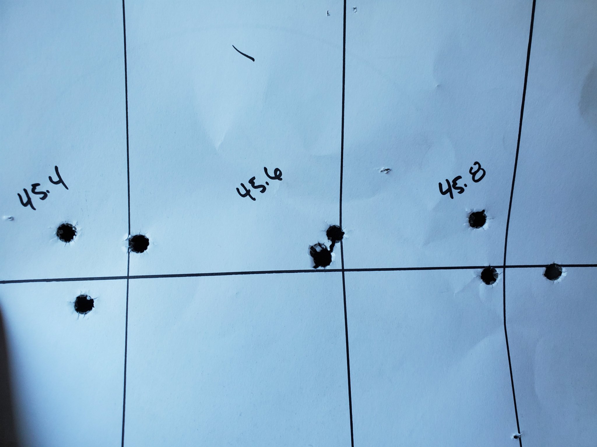

To be honest, I've got like 1 hole groups but that's probably more luck than anything. Consistently its half moa with the right load of 175 smks and IMR4064. But I'm always experimenting.
Those three charges all have a different POI. Not where I would want to be for a long range load. I don't understand the point of removing the expander ball from a lee die. Standard dies are made to drastically oversize the neck, and then expand it back out. The Lee collet dies are made to squeeze the neck back down, not expand it back out.
Those were when I was trying to find the top end of my load. Just a random ass group. The better node for me is 42.8ish
The center to center on em is roughly the same. It's the spread that you're seeing that is bad. But that's 45.6 of IMR4064. The tighter groups are much lower.
That group was a collet only sized group I think. I have stacks of targets that I didnt take good notes on. Mostly because I wasnt goingnto use that load, but kept it anyway. I'm a hoarder I guess.
The collet mandrel seems to be doing alright so far. I am going to get a Sinclair though. I like the carbine mandrel. They pretty much never wear.
