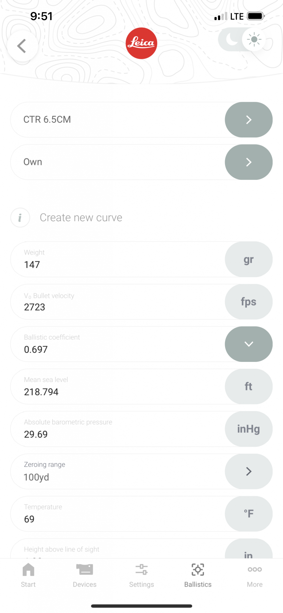

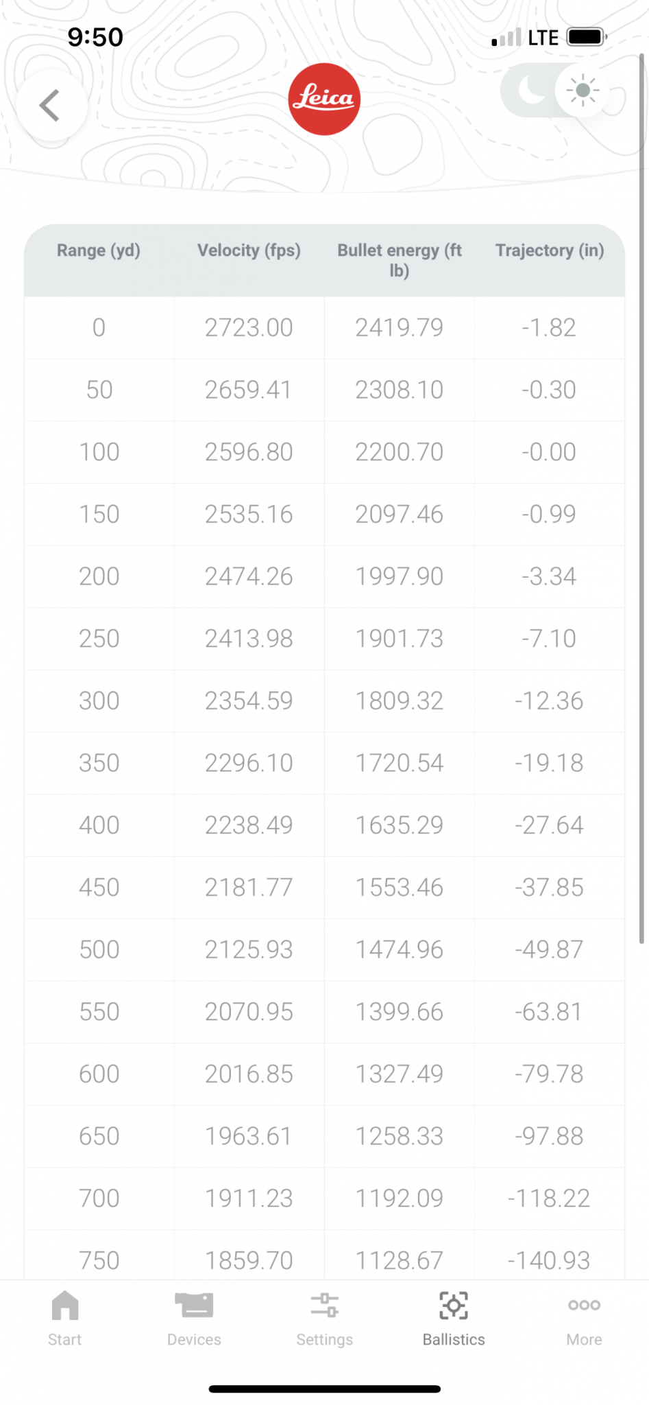

Im hoping you guys can shed some light on my issues with Leicas ballistics...
I created a new thread here > https://www.snipershide.com/shooting/threads/leicas-abc-set-up-problems-vs-ab-elite.7079694/
I’ve got massive tragectory differences between the app and AB.
Are you guys comparing the data shown in leicas app (trajectory) to AB data?
For example my 300 yard drop in real life (and on AB) is around 25”. Leicas trajectory is showing 12”. That’s a huge margin of error.
I feel like I’m banging my head off the wall trying to get Leicas ballistics to even come close to Applied Ballistics.

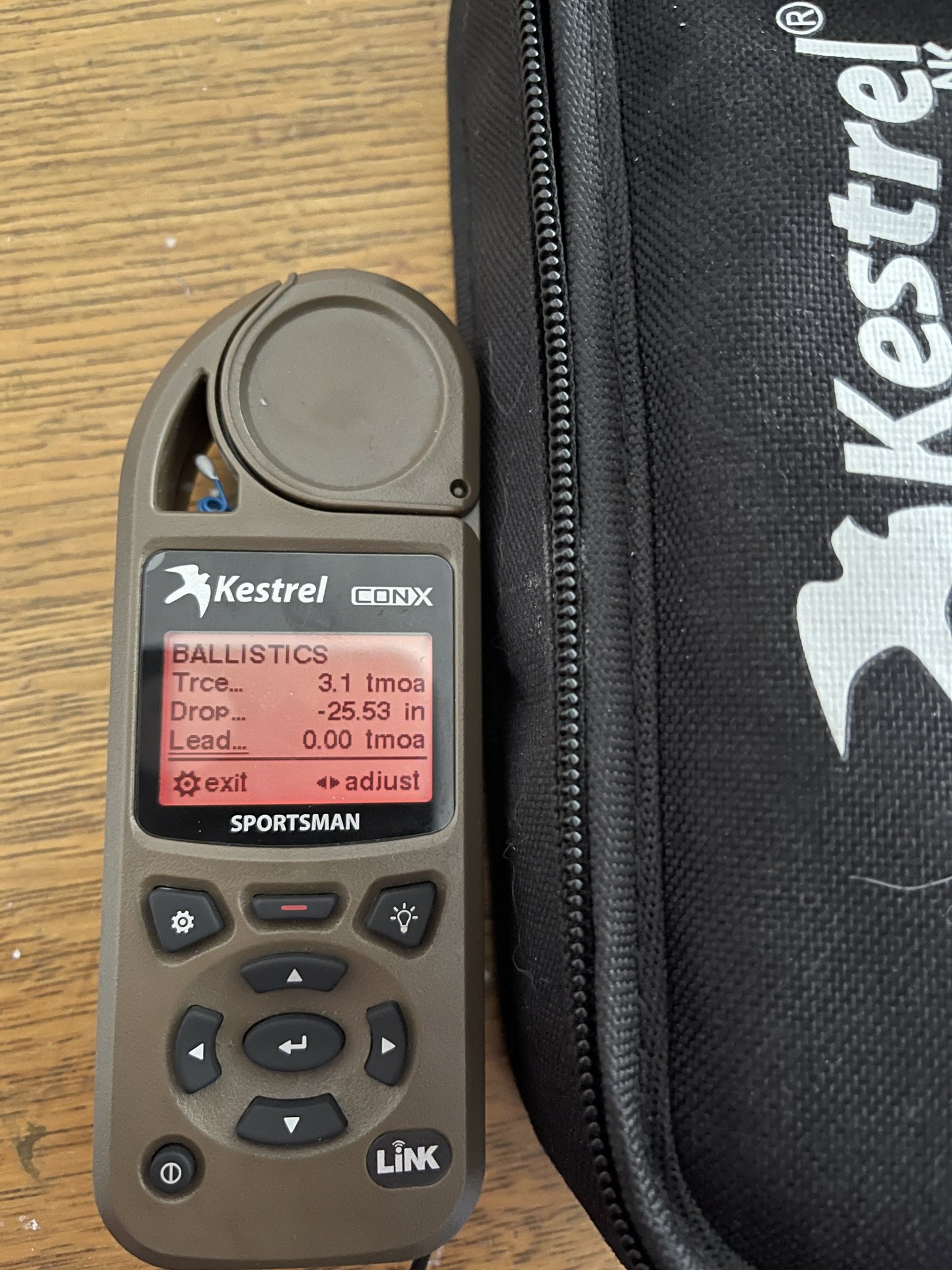

So this is kinda adding to my confusion. My kestrel calls for 4.01moa at 300 yds, but when I go to the “ballistics” menu it says there is 25.53” of drop. 4.01moa at 300yds = approx 12.6”
So why is my kestrel telling me there is 25.53” of drop?

Drop in the ballistics menu is not your holdover. It is the amount it drops from the highest point in it's flight. That is not what you want to dial. The 4.01 MOA is your elevation solution.
So that makes total sense! I had a feeling it was something like that.
So I guess the easiest way to compare Leica data to AB is to change AB output to inches (or cm if you’re metric), as Leica only gives hold over as a measurement in the app.
Thanks again!

In terms of the drops coming from Leica, MOA being 1.047", they are very close. The Leica app is calling for 12.36 inches at 300, whereas 4.01 MOA equates to 12.59". If I am doing my math right (always a big if!), that equates to a .07 MOA difference. That said, yes, I always check my data against my Kestrel data, which I true at the range. AB has always been pretty much spot on for me if I pay attention to the details. Though you are on at 300, I would run the numbers out, as usually disparities show either in the midrange (600-750ish) or at the end of Leica's numbers...1kish. Depending on what you find, you may need to tweak your BC and/or velocity to get them to match....which probably won't be exact but usually .1-.2 MOAish.

Yes, that's the easiest way...AB calls it 'shooters MOA'.
But you also need to make sure of the following....
Coriolis and Aero jump are set to 0...Leica cannot calculate these. Depending on the range, the effect will be small, if you are trying to get to the .1MOA range of agreement out to 1kish, they matter.
Pressure and temp are locked to the same settings as you put in the Leica. Again, could be small difference (or large depending on where you are at the moment), but tolerance stacking is what we are looking at here, which matters when trying to get as close as possible to agreement between your solutions.

AB also has an option for output in inches, as well as SMOA.
Thanks for the held Hide!
After a couple minutes of tinkering I got Leica's app to match AB with less than 1 inch diffence out to 950 yds. Just had to lower BC from .697 to .619.
