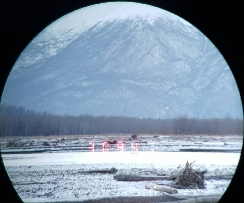

Just got the unit home and went directly outside to try it out.
3094 yards on the tree line no problem.
May do further but the mountain behind the tree line is 6 miles away. I've never been able to get a Sig to touch the tree line.
This sounds awesome. Question for you, once you set up ABC, when you range something, does it first display an uncorrected pure line of site distance followed by a ballistically modified output (either holdover or effective horizontal range)? My 1600b, when set to EHR, first provides the raw LOS range, followed by the EHR taking into account the atmospherics, angle, and (generic) curve. Wondering if the 2700 works the same way with holdover display.
Edit: Another question...I just found some specs on these that suggest the range accuracy from 1000 yards on is +/- .5%....I think the Sigs claim something like 2 or 5 yards to max distance....whereas this would translate to +/- 15 yards at that distance, and even at 1k, +/- 5 yards....not so good. I have a question into Leica on this, but have you been able to verify it's accuracy on long range targets of known distance?
