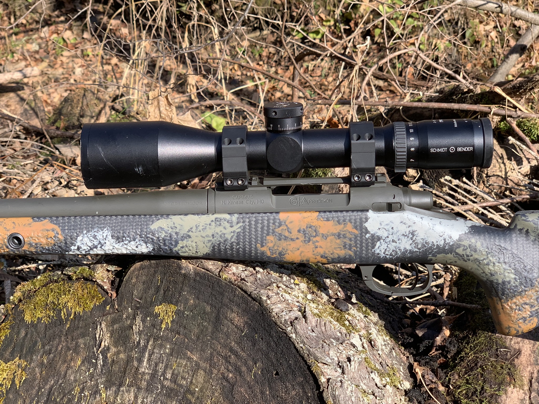

This fits exactly as you described, Schmidt Bender build quality, will tract perfection, exposed turrets, illuminated, and know parallax.

If you make a special order you can get the 3-12x50 klassik s&b with an illuminated p3 mildot and target turrets on both elevations and windage. Me and two friends have them and they’re excellent.
