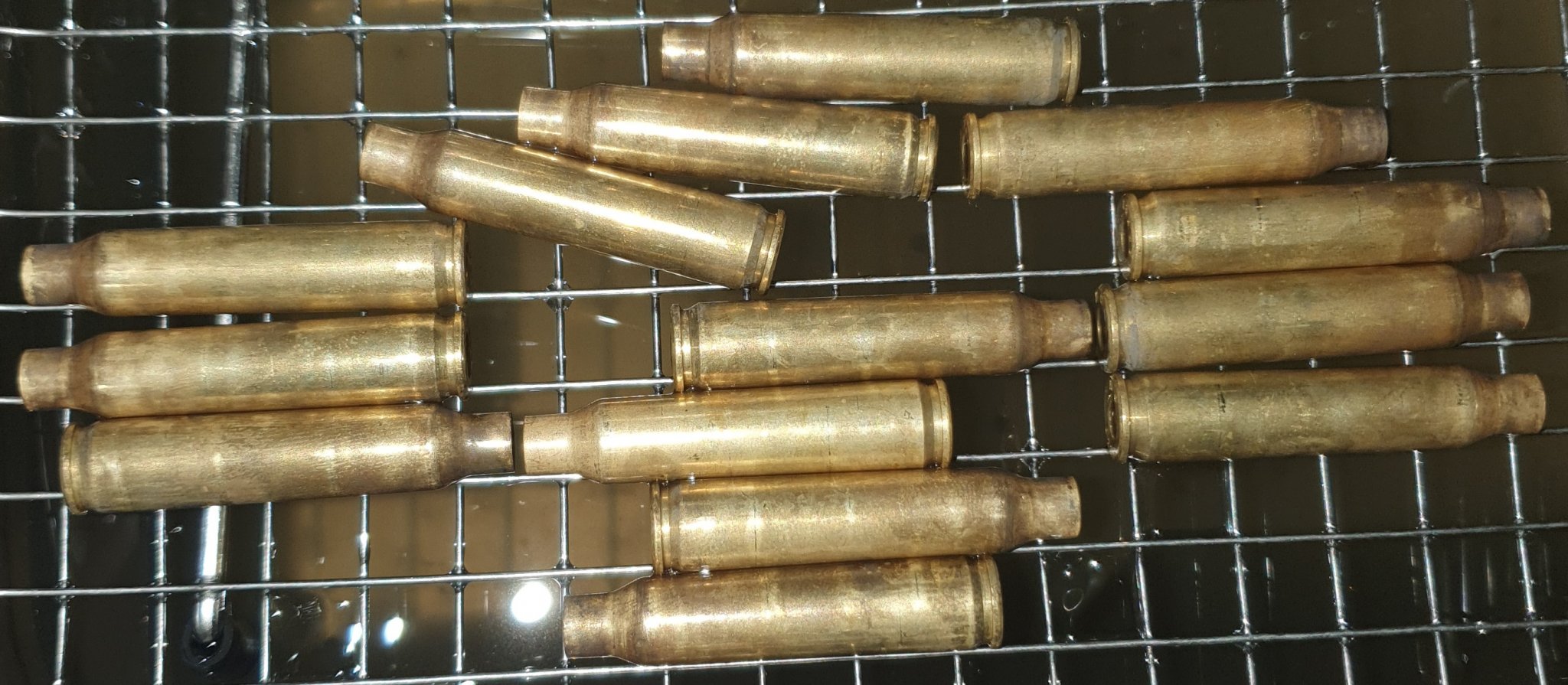

If dish soap is a base and Lemi Shine (Citric Acid) is an acid, then why do people mix the two together to clean their brass? Depending on the ratio, aren't they just neutralizing one or the other, and depending on that ratio, being left with either an acid cleaner or basic cleaner. This makes zero sense to me. Can someone please enlighten me?
Also, the MSDS on RCBS and Hornady cleaner is Citric Acid.
Soap is very mildly basic, but that’s not the reason it’s in there. It also acts as a surfactant, which help things like oils, dirt, and powder residue that normally aren’t particularly friendly with water GET friendly with water so they’ll wash away with the water. This is the purpose of soap which anyone who has taken a shower will recognize.
If you put both together, the LemiShine will override the weak basicity of the soap, and you’ll have low (acidic) pH which helps dissolve brass tarnish (metal oxides). This doesn’t fully inhibit the soap’s surfactant action, so you get both benefits.
It does make soap less effective, but not totally ineffective.

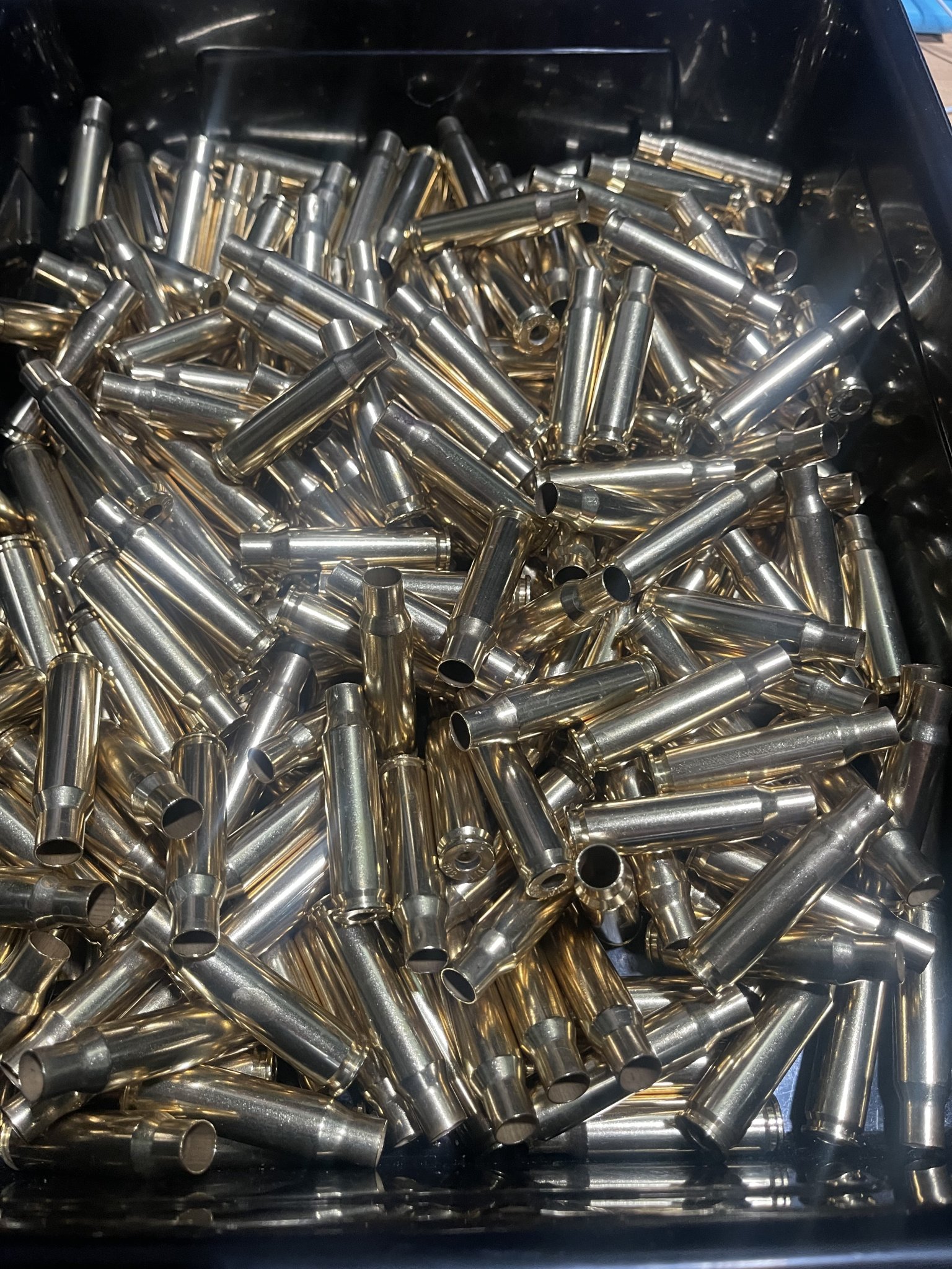

I've used so many different things...probably at least 10 different things mostly through sample packs or whatever. Absolutely all the other stuff I've tried definitely works.
At the end of the day Dawn+Lemishine works more than adequate for just pennies. I don't know exactly how many tumbles I can get out of a bottle of Dawn and a bottle of Lemishine, but for a combined $10 I would venture to say maybe 100 or more for .10 to MAYBE .15 cents each load.
The ONLY thing that is 'need to know' about the use of Lemishine is to not use too much. If you put too much your brass will still be clean but it will turn army green after a while. Less is more in this case. If you have hard water then the use of Lemishine will help prevent hard water spots on everything.

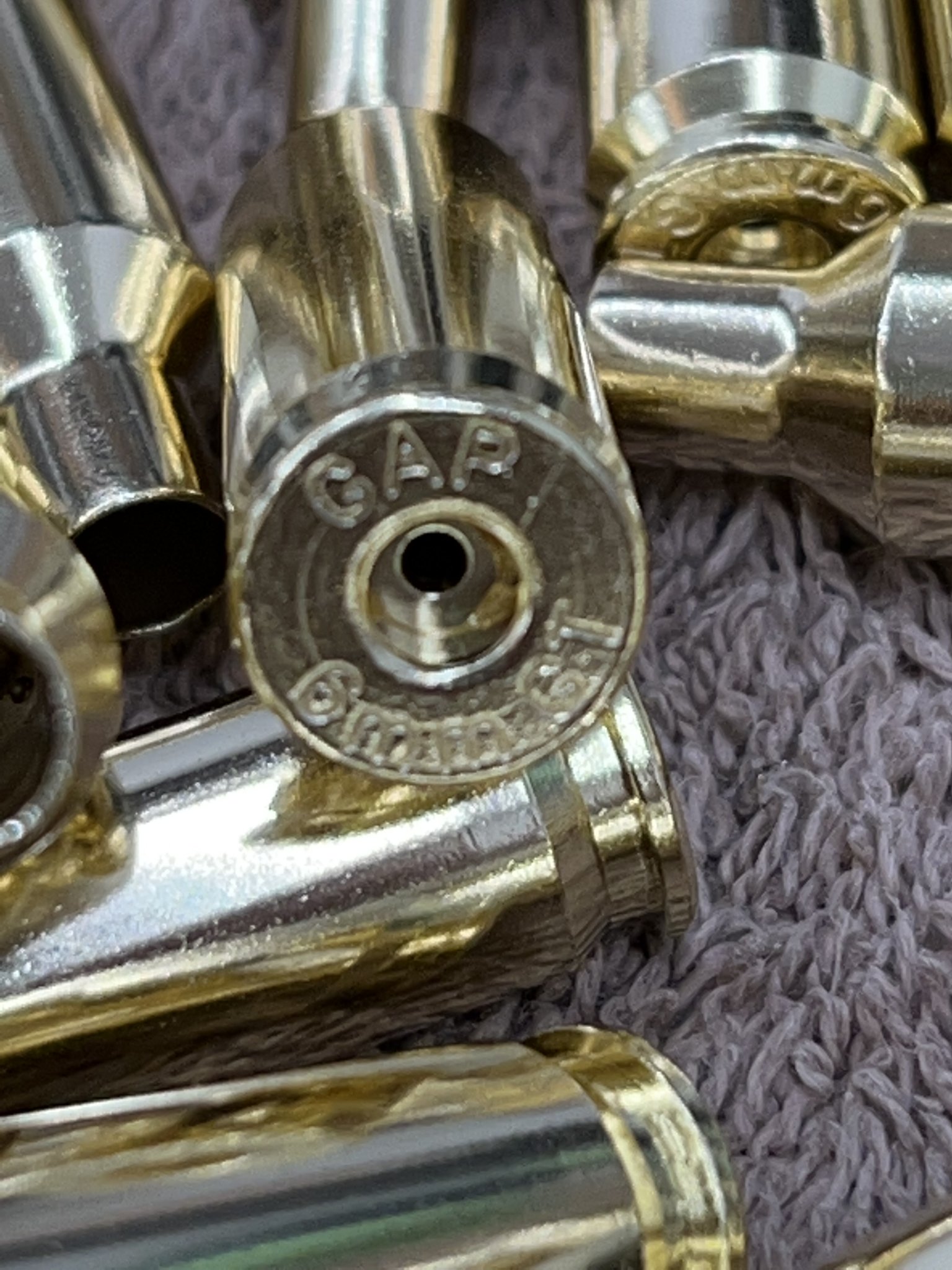

Media:
My preference has been a 50:50 mix of SS pins and Southern Shine SS chips.
If you are inclined to buy solution, I prefer Brass Juice. Small amount does a great job and if the brass is not dirty, you can reuse 2-3 time.

Has anyone tried the little dishwasher looking pods they sell now for cleaning brass? I saw some at the gun store the other day and thought about trying them. I’ll see if I can find a link
Here they are. Better be good for over $1 a cleaning.
I've tried those pods. They actually work pretty good.

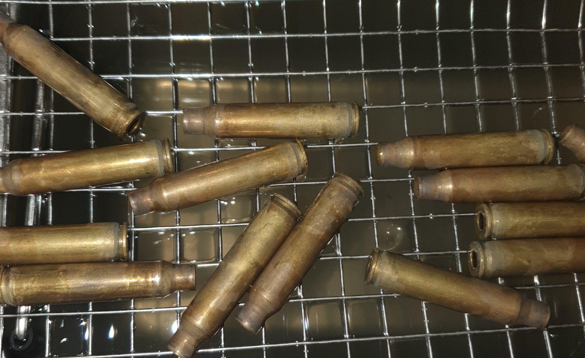

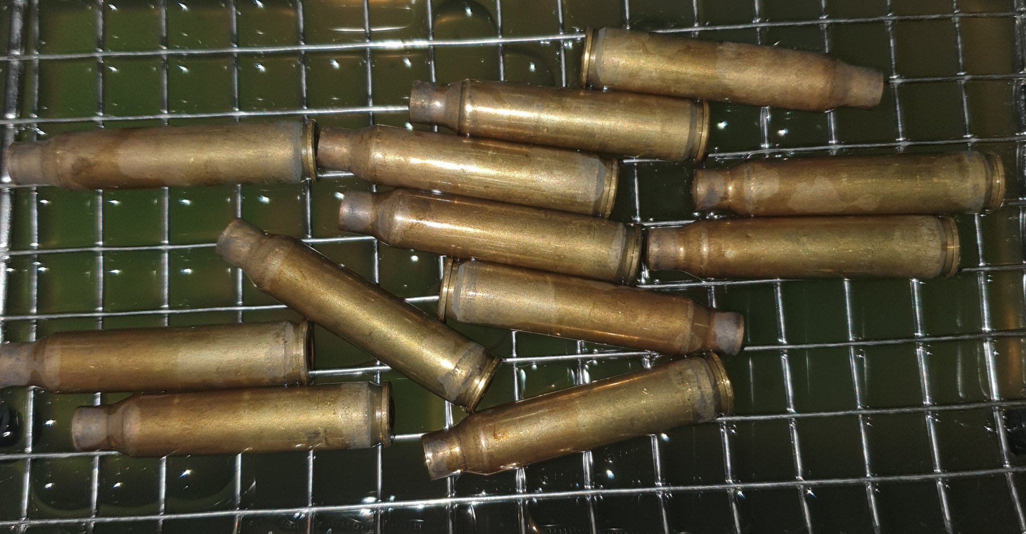

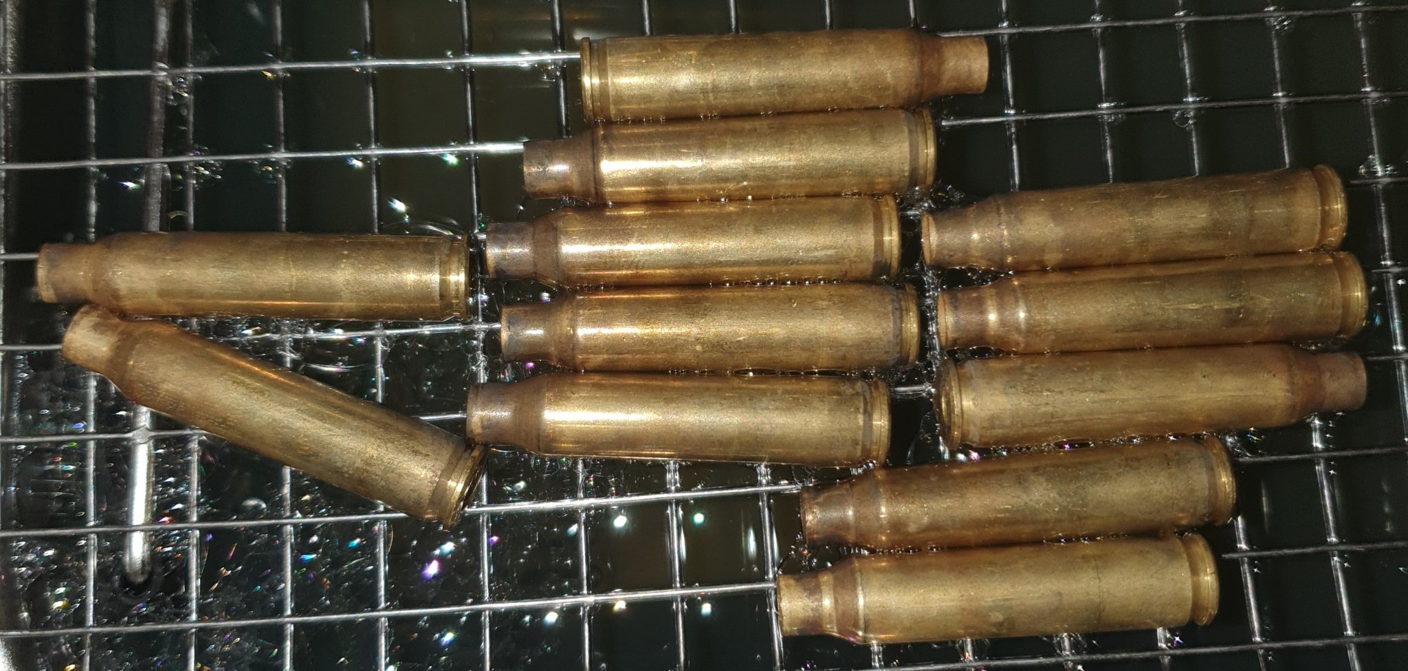

I was reading onto this and decided to do a test:
PMC brass, suppressed, the dirtiest brass I have seen for a while.
Temperature: 70C / 160F
Just citric acid, 5min:
Before:
After, this came out looking brighter than it was.
CA + soap, 5min
Before:
After:
With my bare eyes I could see that added soap reduced spotness and cases were maybe 50% cleaner than with just CA.
I left both cases straight from the cleaner to dry in cardboard boxes and see if there will be any discoloration.
With already quite clean cases just the citric acid did good job getting them cleaned.

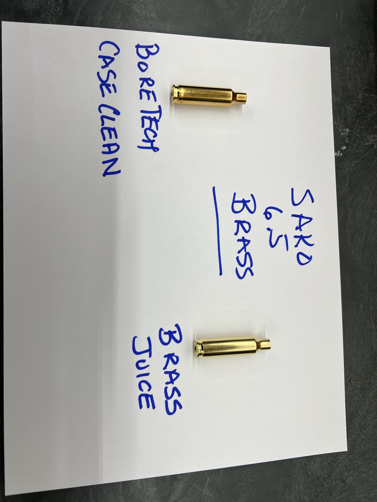

My favorite is BrassJuice. Fast complete cleaning with SS pins. Inside outside and primer pocket as pristine as new.
Recent test of BrassJuice and BoreTech Case Cleaner. See results.
