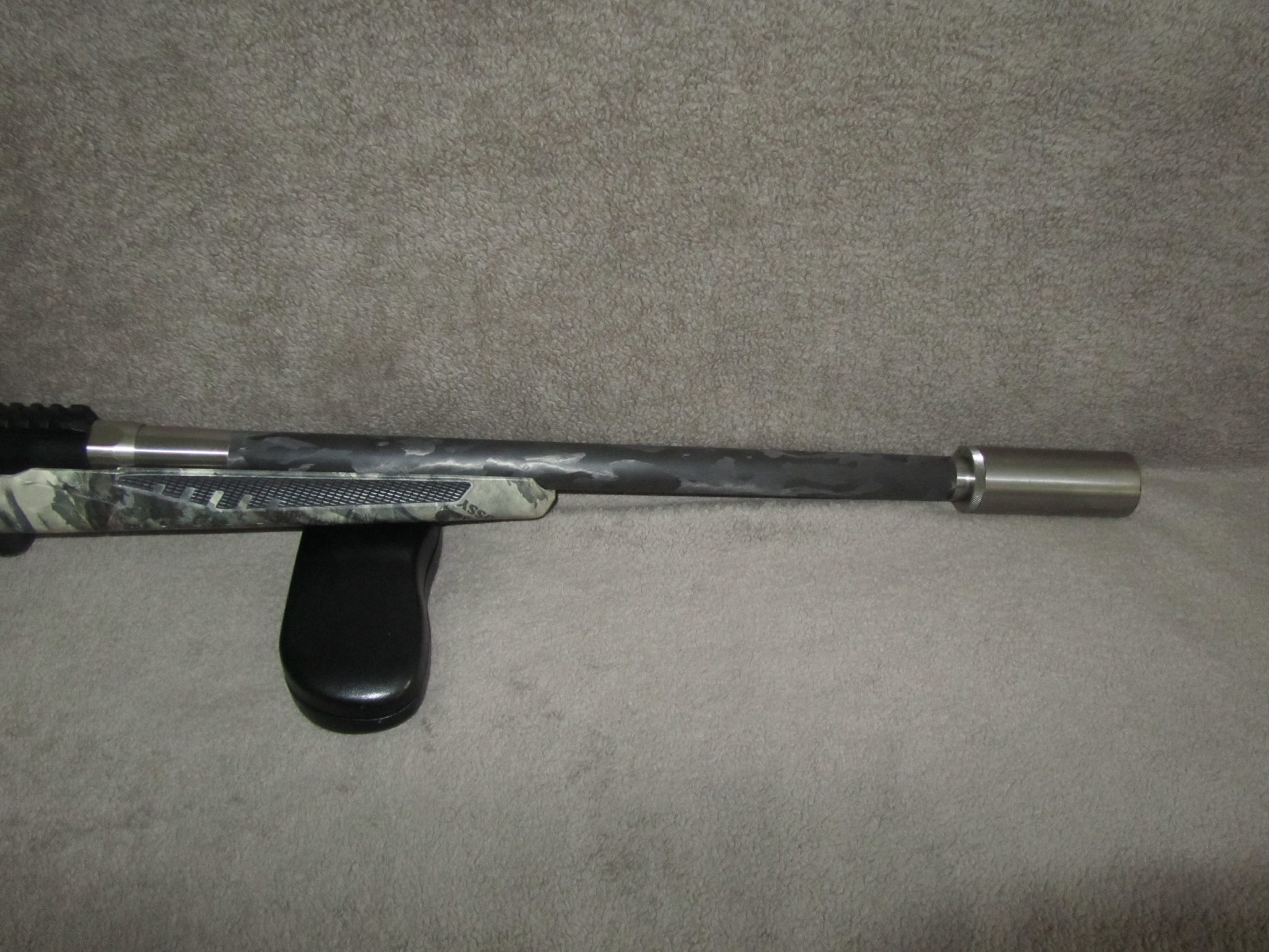

I use a 1-1/2" dia linear compensator in the prison state of NY.
Titanium 5/8-24 gill style brake threaded for a can and then use a 4" long titanium extension with a titanium blast chamber insert.
Besides being super lightweight , it does a great job at diminishing the blast and sound directed rearwards.
Also good for protecting the muzzle.
Only once was I around it with NODs when it was fired and it didn't give me any concern about damaging the tubes, but I haven't tested it thoroughly.

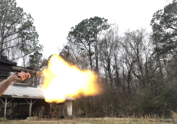

Barrel length and caliber play a huge role. This one is labeled the “hate machine”. Surely guaranteed to blind you at night with a blast can on the end. Never shot it with my NV, but I’d bet money it would have messed with them
