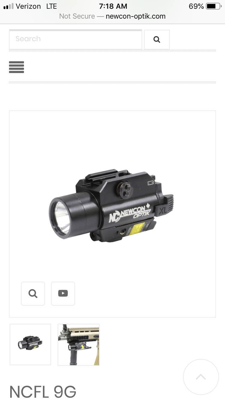

Do you have experience with any Newcon Optik gear? If so, please share! There is interest, but not much is known about them or their gear.
This design looks oddly familiar...
well, you might want to take a look at their offerings like I said.
For example, their LAM 3G is almost a dead ringer for a LA-5 specs wise at a price of $1300.
You are also dealing with a company that is based in Canada instead of Russia. Makes CS a little easier.
You guys might just want to take a look at the Newcon Optik offerings.
Just saying...
