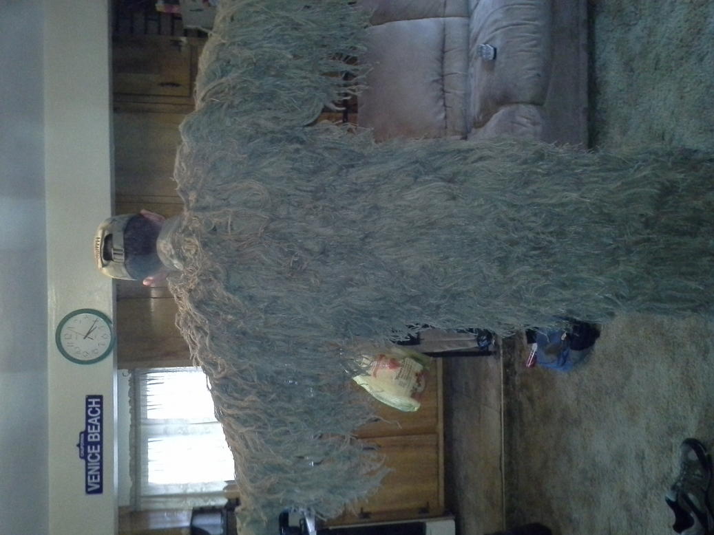

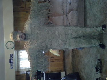

I built it this weekend. Not really knowing what I was doing I am not too upset with the results.
I need to let it fully dry and then try to rough it up a bit more.
1st phase was done, i went and got it wet and muddy let it dry and realized i needed more burlap and less conformity.
2nd phase looked better (pictures)

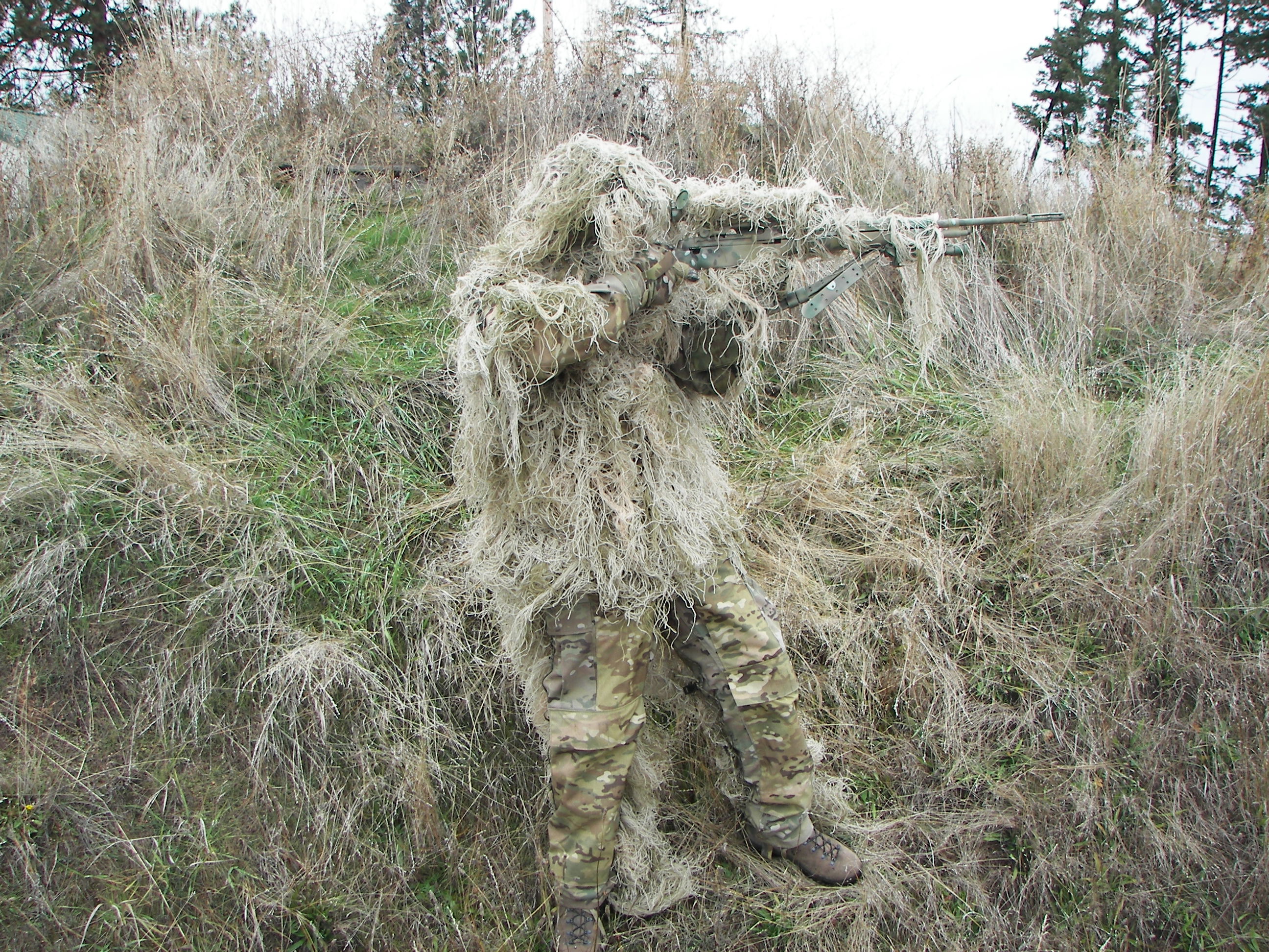

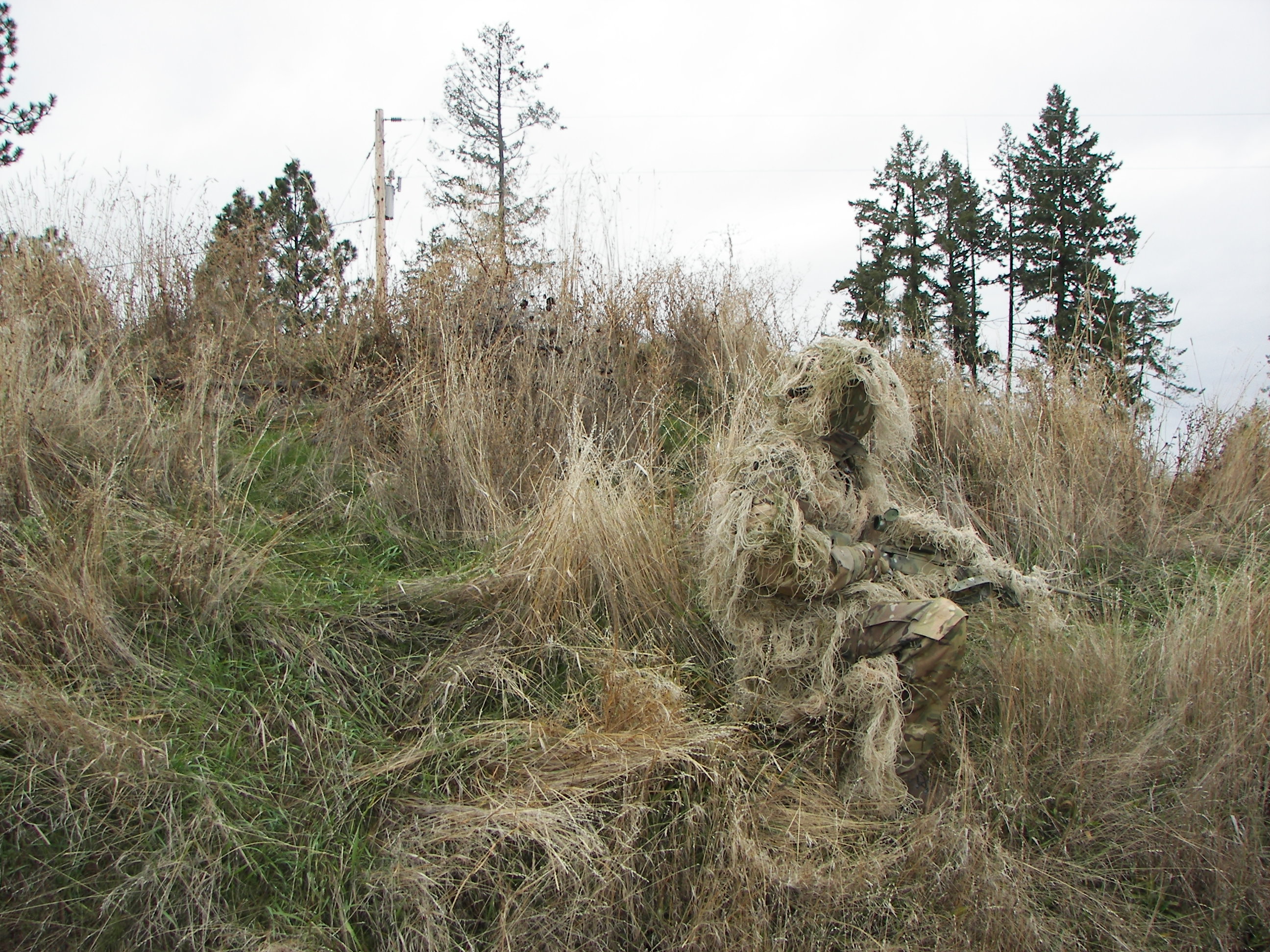

Here's the one I used up at Fort Riley, KS. The vegetation was pretty much all dead grass, so I went with the desert pattern uniform and tan jute. The only thing I didn't like about it was I only had 3 days to make it, so I rushed a lot of it. I didn't think about it until I was done, but all of my knots were on the inside, so after I shoe gooed them it was like wearing a suit of needles.
Surprisingly I only have one photo of me actually in it at Riley. I threw in a multicam top for color reference.

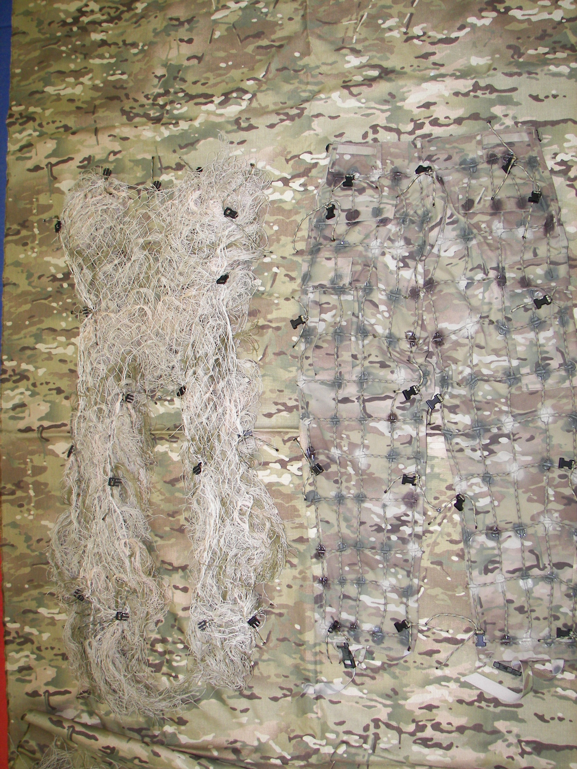

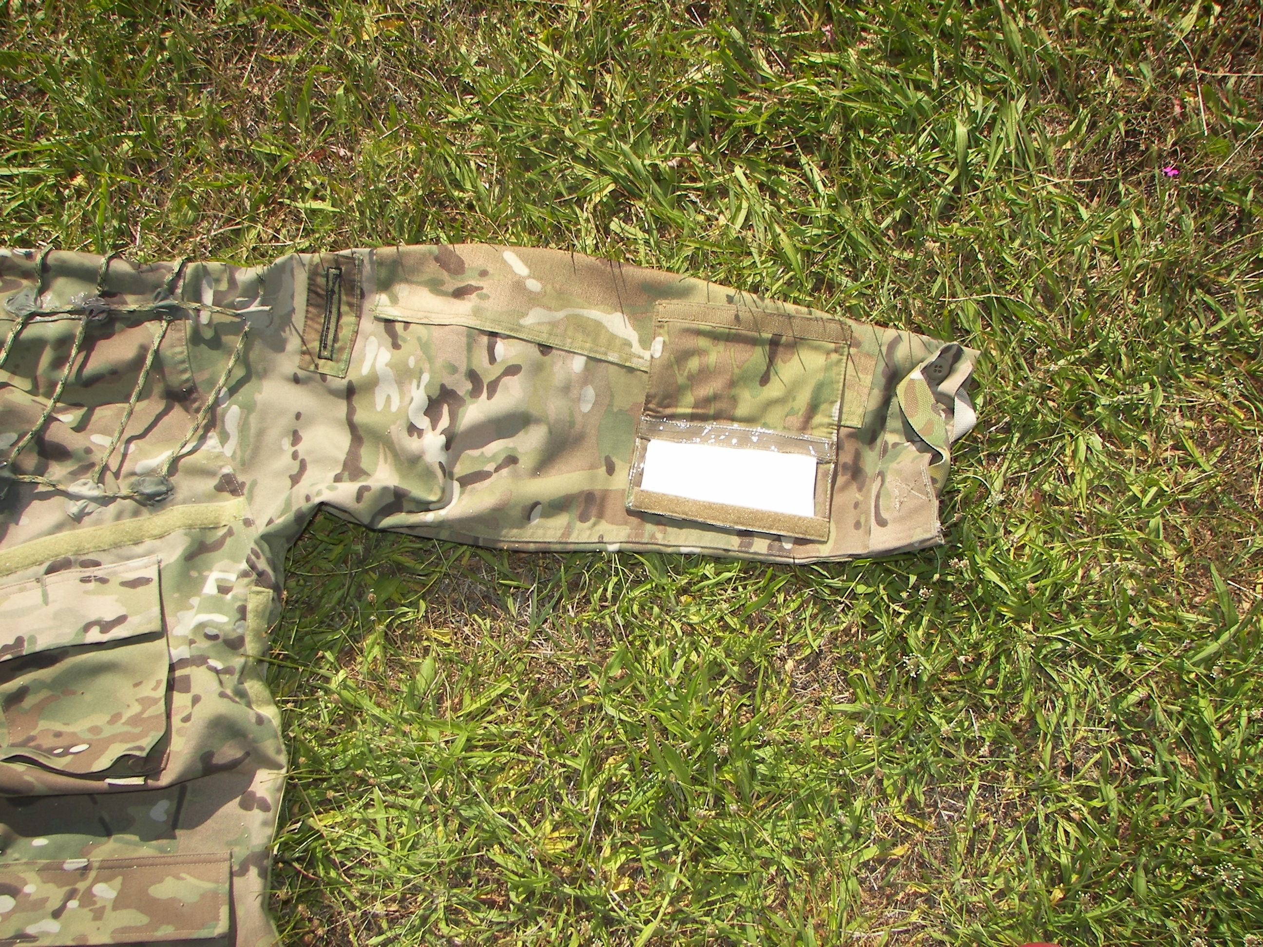

Hey guys this is my first posting on this forum so bear with me if I mess up. A while back I set out to make myself the best ghillie money can buy for my applications. It turned out so well that I’m currently trying to make a business out of making custom ghillies. I thought I’d post it on here to see if you guys had any other suggestions for it and to see if anyone would like me to make one up for them. (Personally I couldn’t be more pleased with mine right now as it is extremely versatile, cool, not too heavy and comfortable)
But besides just making a suit from start to finish I believe I’ve stumbled on an idea that may very well be revolutionary in the area of ghillie suits. The idea is that by using small plastic side release buckles and some paracord I’ve made several ghillie covers, using synthetic thread and fishnet, completely and easily detachable.
Front Back
Ghillie cover off, backside Same pants with different colored cover (Note buckles) In this picture I used black but I’ve switched to green

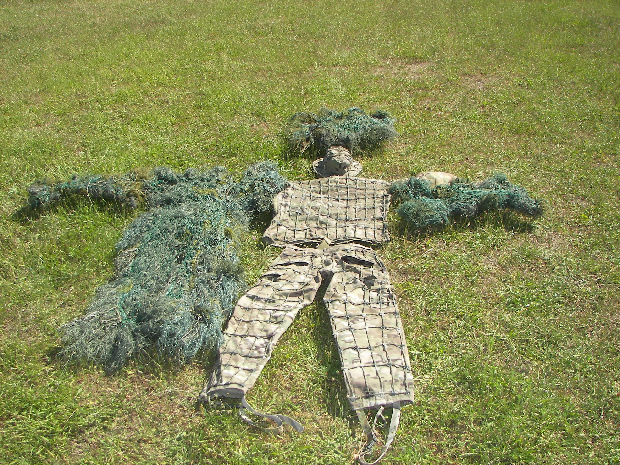

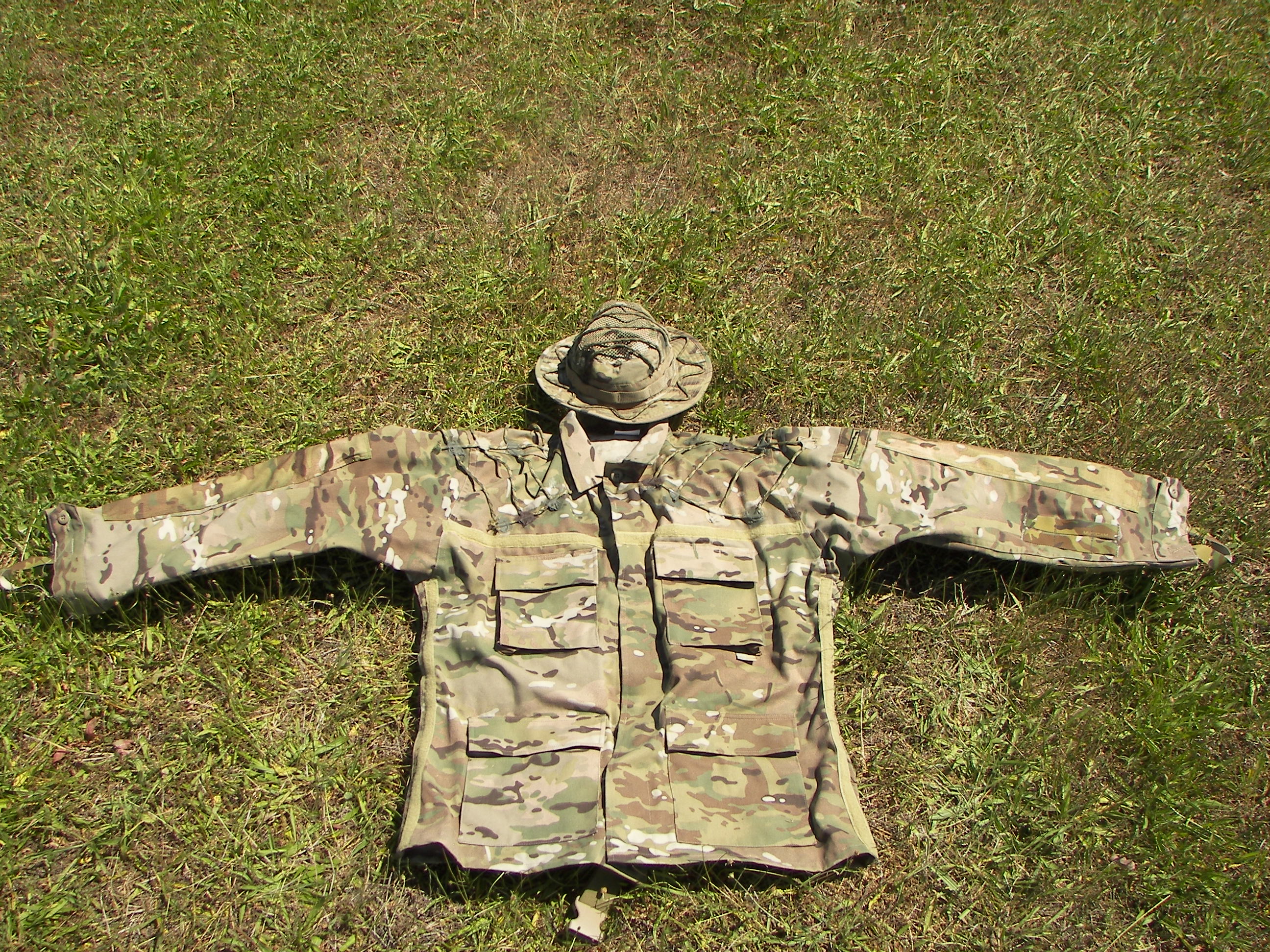

As you can see the ghillie base is a pair of multicam BDU’s with a ton of alterations done to them, which I will show later, these pictures show the same ghillie suit base but with different synthetic thread covers. BTW guys I just want to say right here that just because I’ll be trying to sell these elsewhere doesn’t mean you can’t make one yourself just like mine. With that said I can honestly say that you would not be saving much money if you bought all the materials and made one yourself as opposed to buying one from me. However even if nobody would like to buy one I’d still like any helpful input to improve mine, as this is my own personally ghillie.

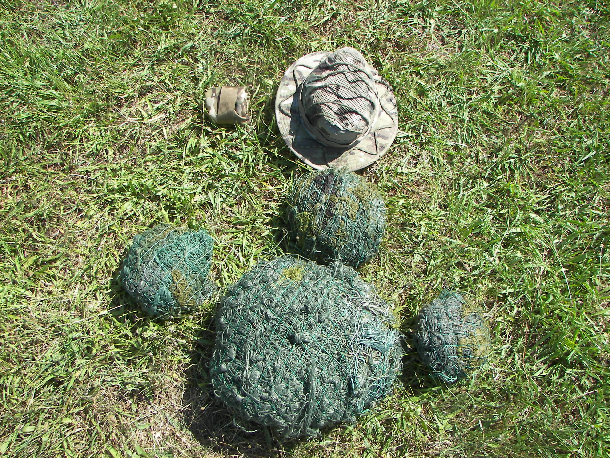

Now the great thing about this is that one or more covers can be tucked away in a ruck or pack until you want to attach one. And it can be attached in about two minutes. You can now have one with light and dark greens and another with dark tan and brown, sort of like I’ve done with mine here. If you have to traverse through a relatively green forest and then through a brown wheat field or just tall dead grass you can now only have to wear one suit and yet be covered for both areas. Or one could also have the same camouflage scheme with different cover designs. For instance you could have one full body outline like mine is and one that is like a Cobra hood. It all depends on one’s needs and stalking grounds.
I’ll have to post three or four times in a row to put all my pictures in because of the five per post limit.
I’ll also include my business email in case anybody would like to order anything.
To be continued…
My Ghillie
(Sorry the pics are so small, just click on them and they will enlarge)

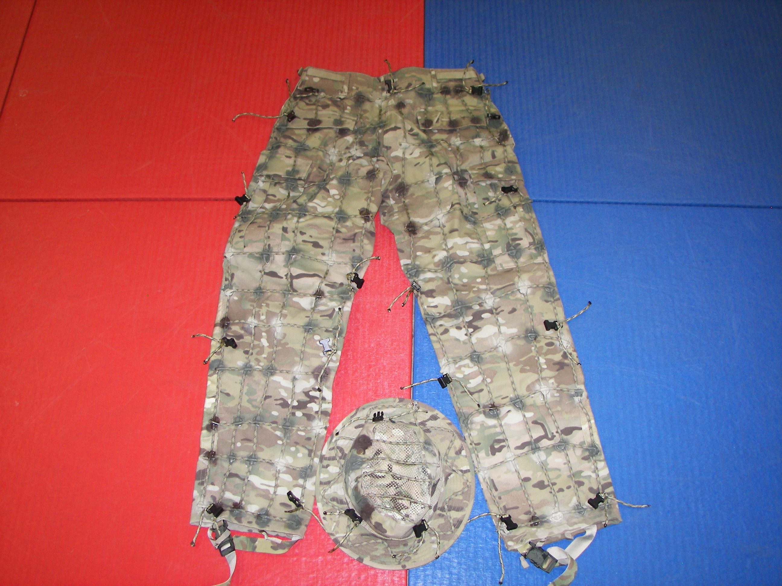

I’ve put the main idea that has differed from all other ghillies that I’ve seen on the first post, but here I’ll try to include those few other things that I’ve added to my ghillie base. I’ve put all the bells and whistles I could think of on this one as I plan on using this one for three out of the four seasons. The features I incorporated are as follows,
1. Coolness and versatility, in that is it feels just like a normal BDU but with a mesh back panel and 1000 denier codura sewn onto the front of the pants and around the elbows.
2. Thumb straps, boot straps and a crotch strap with a short elastic section, all of these to facilitate the low and reverse low crawl.

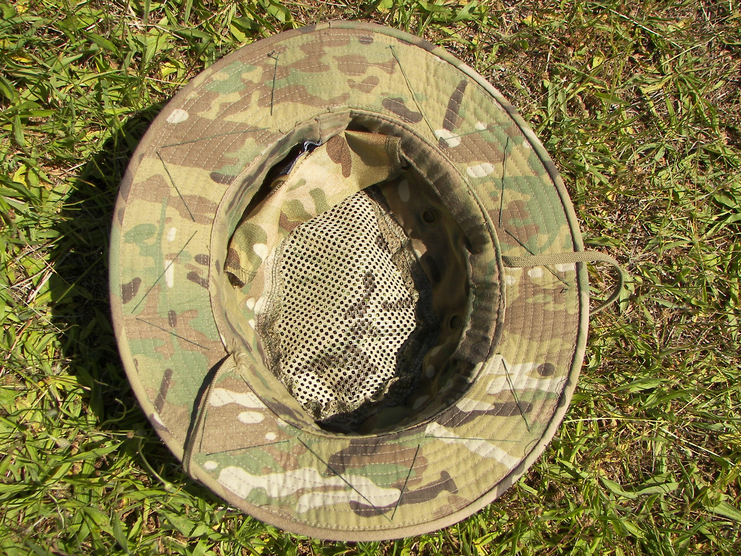

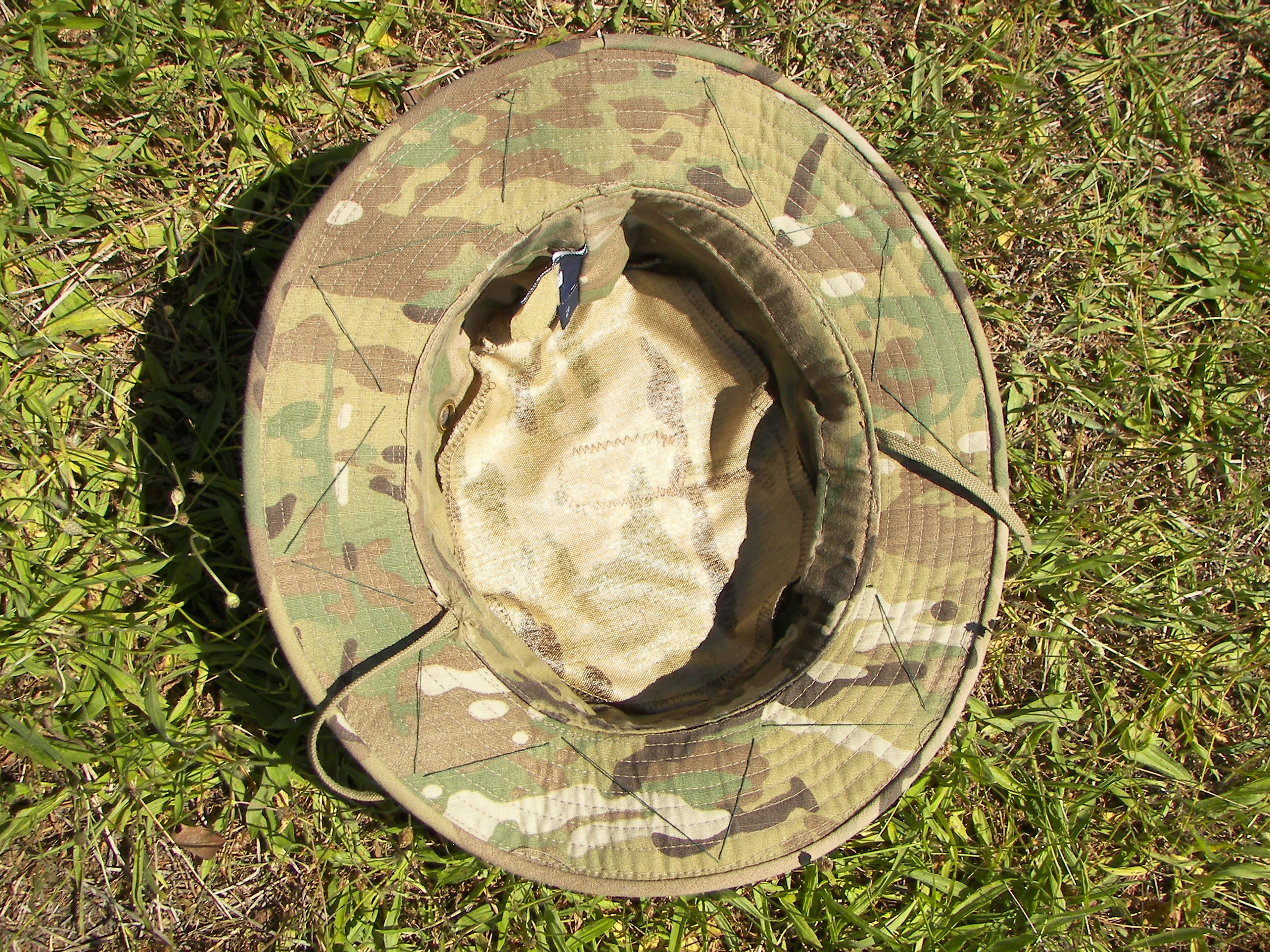

3. The hat not only has 550 parachute cord sewn on brim and shoe gooed onto top but has a mesh top with a 1000 denier codura (Waterproof) flap that can be laid flat for damp weather but can be rolled up in the back and velcroed in place when it is warm. This codura flap does even a better job at keeping the rain off the top of your head then the unmodified cotton topped boonie.

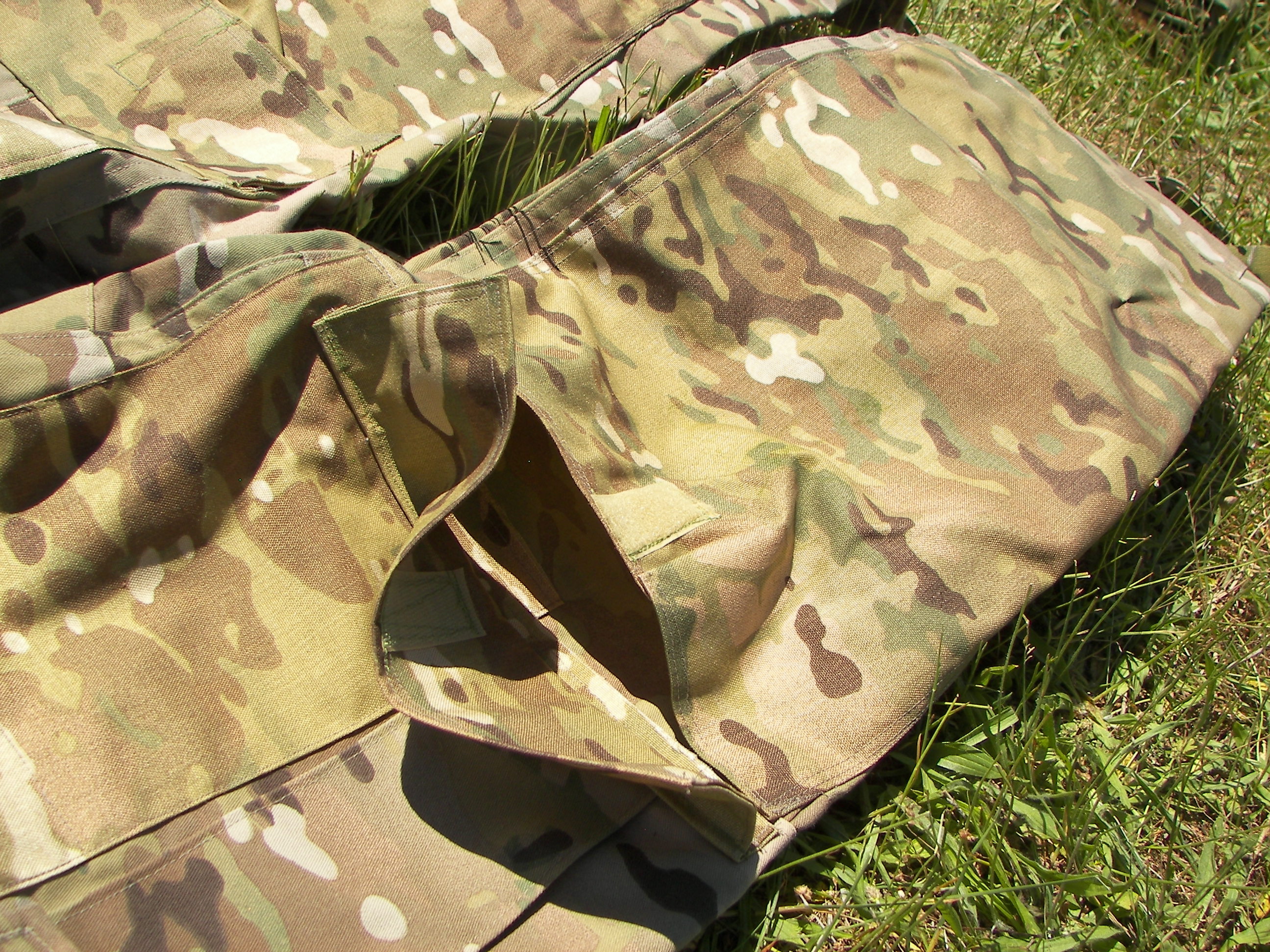

4. Large pockets in pants for knee pad option. And codura reinforcing all the way to the top on the front of them.

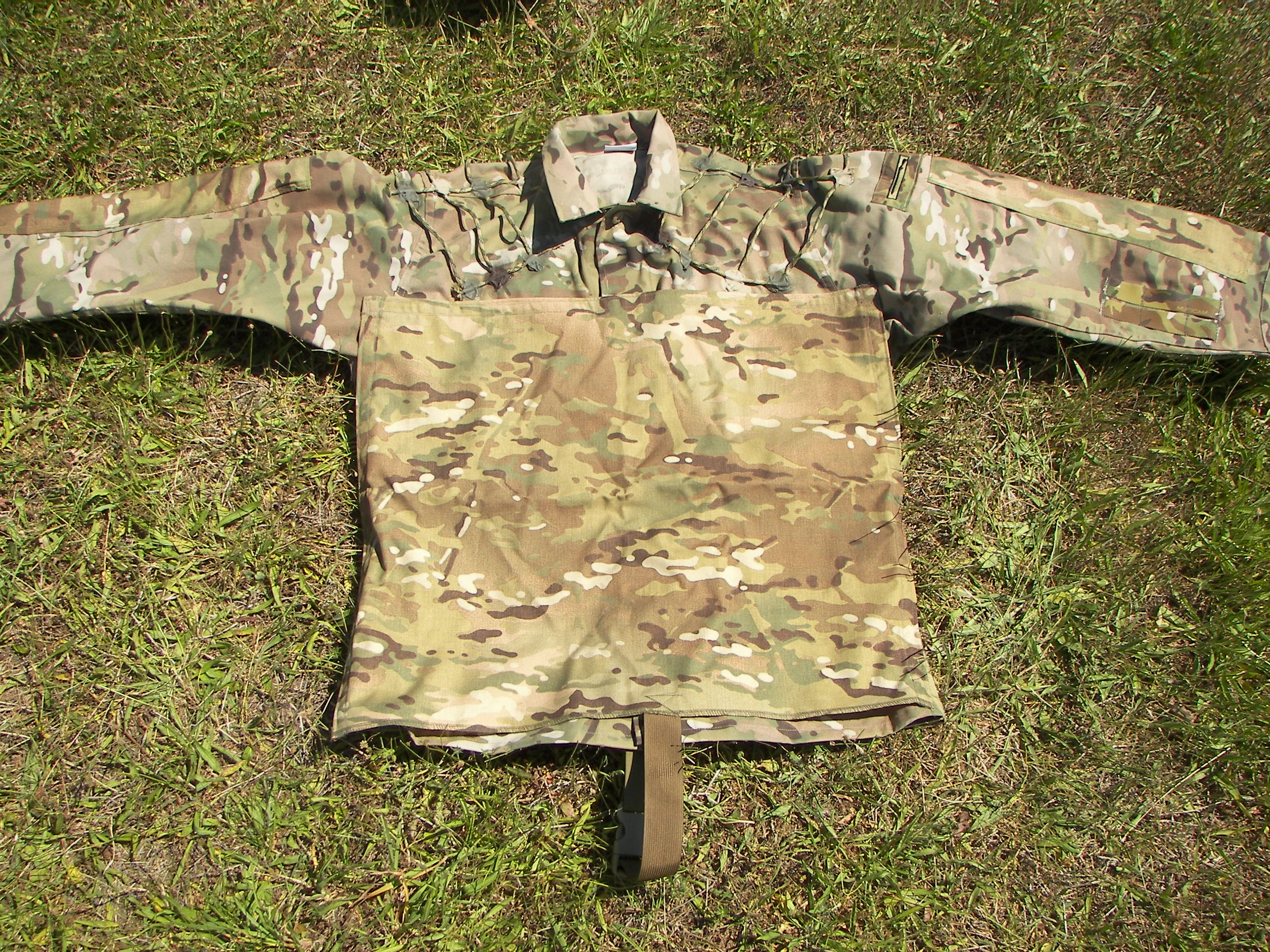

5. Removable 1000 denier codura skid plate on front of jacket.
This attaches on both sides and top with hook and loop. I have already done some low crawling and it has not even started to peel off which I was pleased to find.
Removability is helpful for two reasons, first because 1000 denier codura although arguably the toughest material in multicam it is not very quiet, so when crawling very close to enemies it may be better not to have it attached. Also it can be taken off and placed below your muzzle when shooting in dry environments. And if I need the use of my four pockets I still have them.

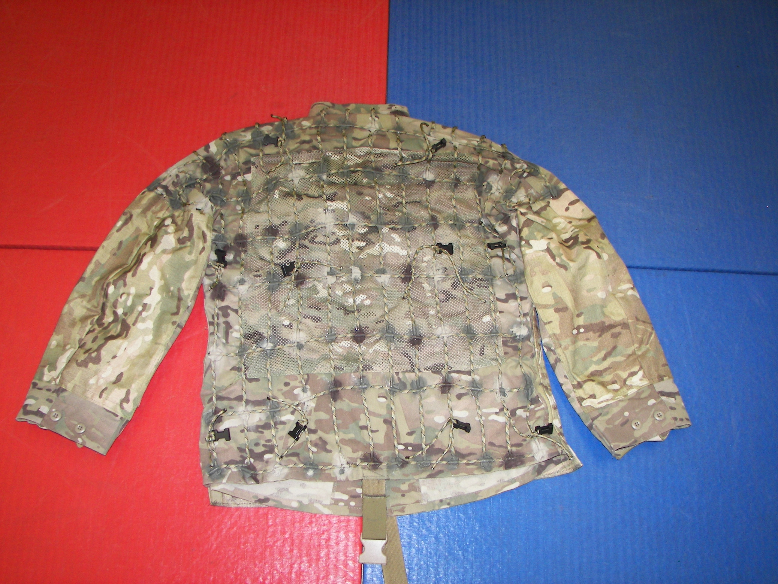

6. Criss/cross grid pattern of the 550 parachute cord is extremely useful when only attaching natural veg to it.

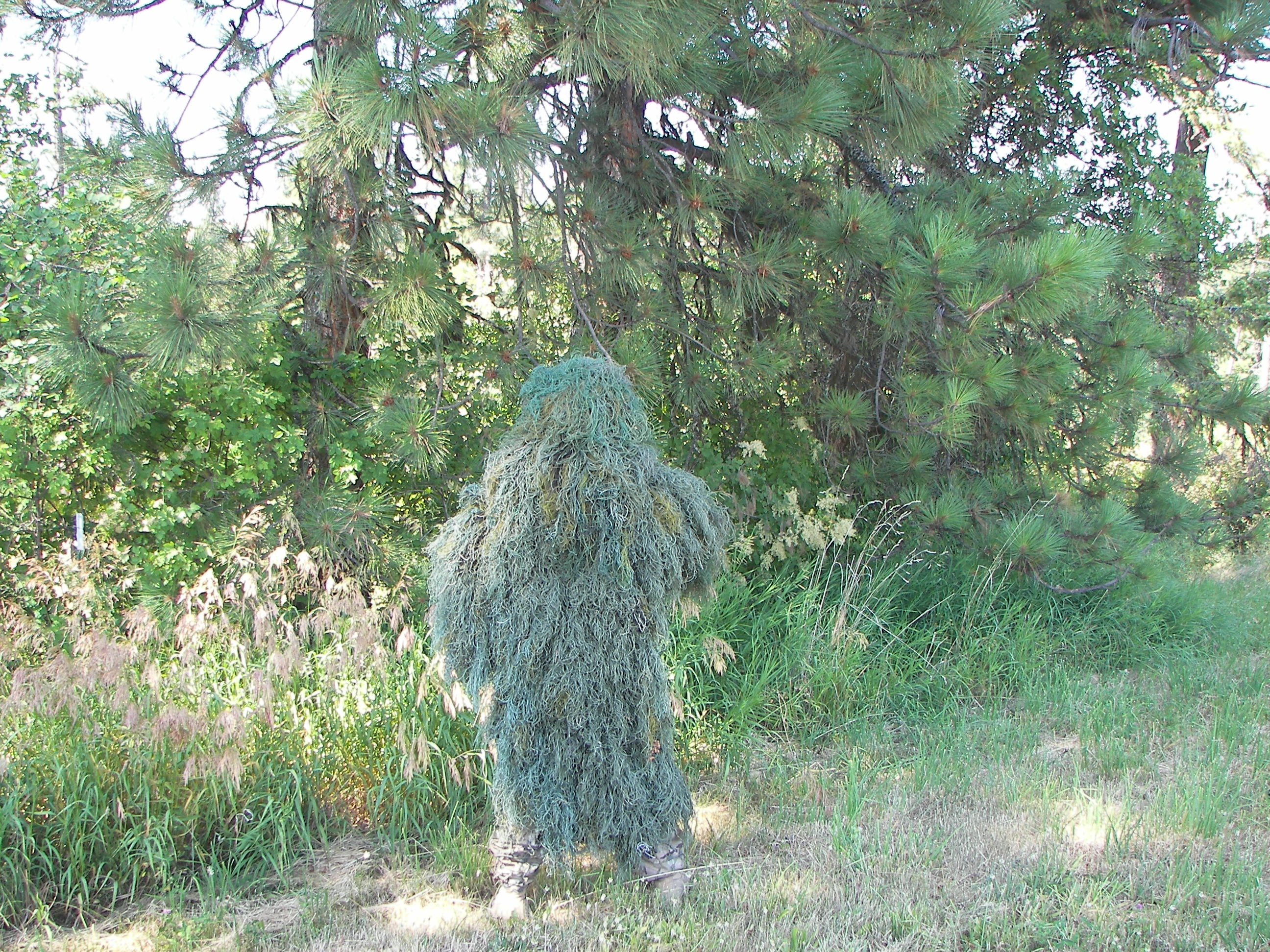

BTW with a bit of grass I got this. Standing, facing away

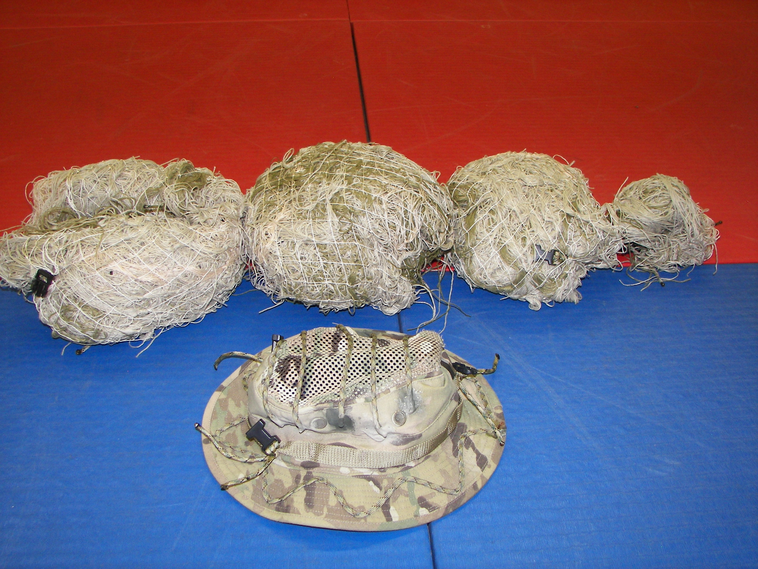

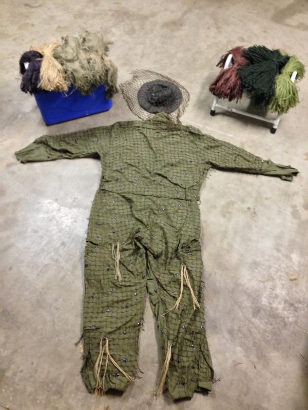

But to better illustrate the main idea of detachability I have a couple more pictures,
The large bundle is the main body that is, the back, top of shoulders, back of legs, and weighs almost 2 lbs. The top bundle is for the hat and weighs 7 ½ oz. the two smaller ones on either side are the optional arm segments that weigh between 4 and 6 oz. (Note, the small square piece of multicam to the left of the hat is the jacket’s skid plate rolled up.)
And my other set,
This design is much better IMO. From left to right, back of pants bundle, back of jacket bundle, front of jacket bundle and hat bundle. Not only is it more convenient to have separate covers for the leg and back but I’ve also made one for the chest that can cover the front or be clipped away in back as shown here.

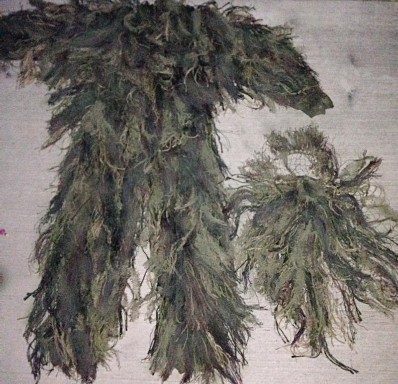

I've been working on mine for the past month, but still haven't gotten around to rolling in the mud or treating the burlap with flame retardant. This one was a research project, trial & error kind of thing -followed instructional chapter in "The Ultimate Sniper" by Major John Plaster. Found the suit base online as a surplus, $20...figured it was a good deal.
I used unwaxed floss on the top of the shoulder/arms and major seams, then hot-glued over the stitches and the rest of the net, hit the glue spots up with OD paint to flatten it all up. Tried tearing the net off of the base, but held tight -hot glue looks like it soaked into the fabric pretty solid. I used jute twine, burlap strips and pulled strands to get a mixture (garden section at Home Depot). Utilized an old military tent half I kept in the attic for the skids on the knees and chest, and had a seamstress sow them down good. Also hit up the knees and elbows with a thick coat of spray on Rustoleum bed-liner and camo'd it all up with Krylon afterwards. The boonie was my old Desert cover from my military days, I dyed it OD to match the base.
Nothing intricate or anything fancy, but I think it'll work out fine... Kept it low budget this time.

Here is my newest one I'm making for my section. Beings as it's my third one, I went all out on it.
Base is a leftover pair of multicams. Cordura 1000 denier on the front:
Tactical Concealment netting on the back:
Moved the pocket to the sleeve and added finger loops:
Clips on the sides to attach top to bottom:
Added a zippered pocket for whatever:
Mosquito netting on the back for ventilation, but with a cover to stop rain from entering, plus zippered armpit vents (similar to Army PT jacket:
-The Truth is Out There-
Lets see your ghillie.
Armpit mesh:
Gave the collar a button:
Reinforced elbows with the Cordura:
Mosquito netting in the boonie with flap for rain/cold weather:
Cordura on the front, netting on the back:
Zippers on pant legs for easy on/off with boots:
Boot stirrups:
All I need to do now if finish shoo gooing over the stitch marks and add the jute. I'll update whenever it's done. I need it for a field op this weekend so it will be done by then.

Post-wash:
I used a lot less jute on this one than my on my last ghillie, but I think it works. I'll need to fan the jute out some once it's dried completely. I have left over to add if I need it.
Btw, never bring a German Shepherd to do a ghillie wash with you. He kept thinking the suit was a toy and tried to grab my leg and drag me off a few times haha.
Greetings.
I'm going to build my first ghillie suit.
Many people recommend to use BDU one size larger.
Is that mean I need it wider AND longer? Or just wider is enough?
Is it really critical what pattern/color I will use for foundation?
I have set of DCU but I live in woodland area. Should I avoid it and find some OD/woodland?
Greetings.
Base uniform doesn't really matter. After the ghillie wash and use it all turns brown anyways, but try to get something that matches your AO i.e. DCU for dead grassy plains, BDU for woodland, UCU for snowy areas, etc.
One size up should be sufficient. Don't worry about long or whatever. The idea is to be able to slip it on comfortably over your service uniform in a hurry without having to change. If you wear a Small Regular, get a Medium Regular, etc.
Here is my attempt.
Multicam tactical concealment viper hood. (Not pictured)
Multicam usgi pant with hand sewn paracord grid.
Multicam material with sewn paracord grid for my rifle and scope
The coyotes don't even stand a chance, once it gets some natural veg in there
Very Nice
Here is my attempt.
I like what you did for your rifle, you just slip that on when in position or do you secure it and move with it?
