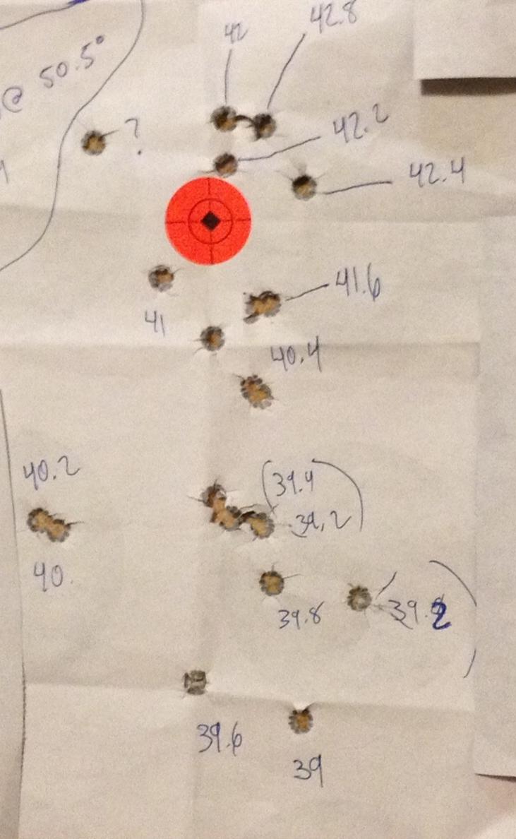

    I shot a ladder at 200 by myself, using my spotter scope...... After about 6 or 7 shots landing closely to each other I had a few holes which were marked with ? because I wasn't smart and I didn't have a spotter.
    I'm thinking I need to concentrate on 42gr and up. This was with IMR4895, 168gr AMAX, CCI 200, and Norma brass.
    Rem700AACSD @ 200 yards.
