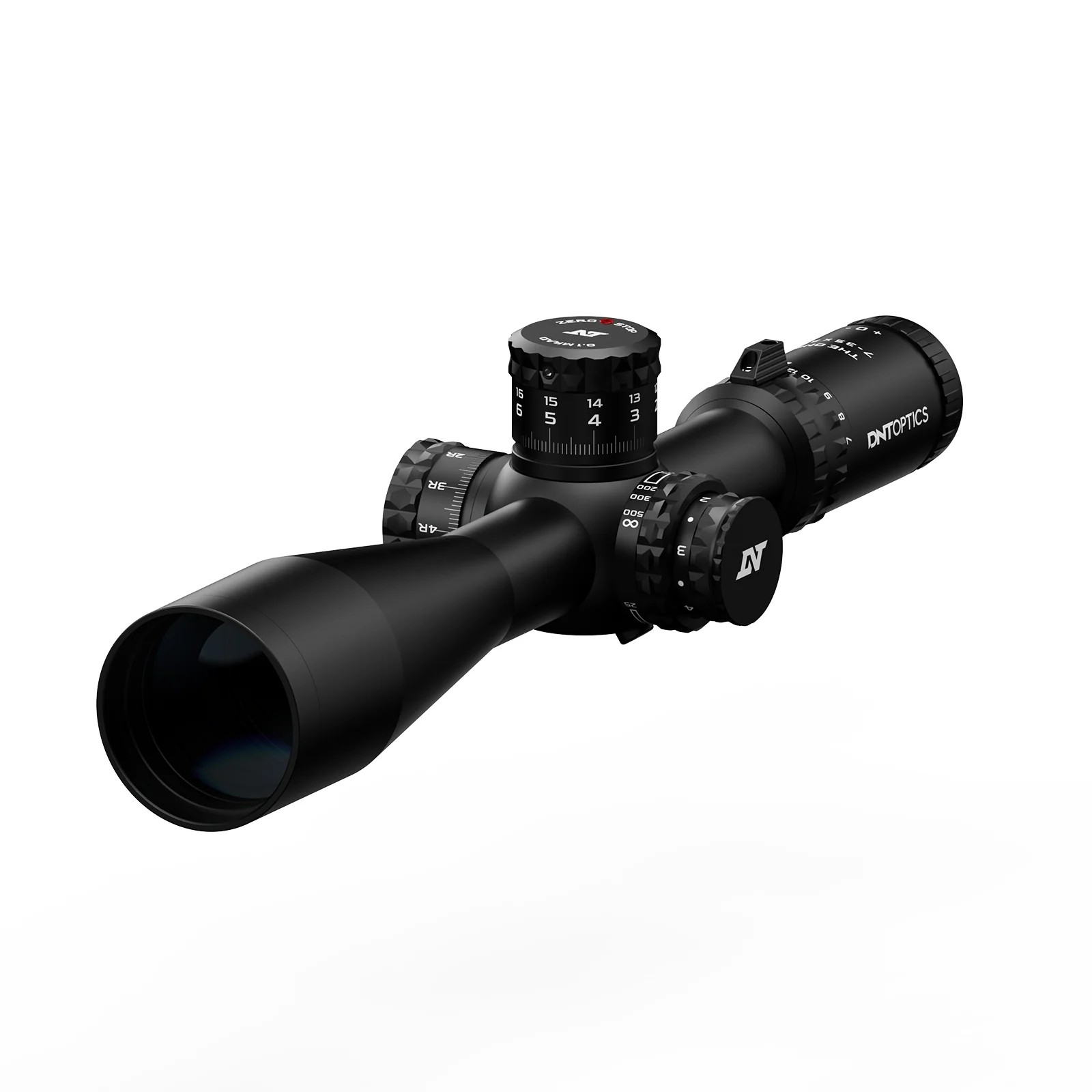

Just thought I would give an update and piggy-back on another question. I sent my scope in to Leupold and they said 8 weeks before I get it back, approximately. I guess their fast turn around days are over. Any suggestions on a budget yet decent scope with comparable specs as a temporary substitute? 1st or 2nd FP, mil based turrets and reticle. I have read a ton of threads here on scopes but looking for a quick suggestion or two. What about this company? Anyone have any experience with them? Thanks for any replies.
I have no hands on with them but have seen a few recommendations lately from other hide members the DNT The One as a budget offering.
There is also a thread going on right now from @Lowlight regarding cooperation with snipershide to design a reticle based on thier scope.
I honestly don't think Frank would be involved if it wasn't a servicable/ capable option.
