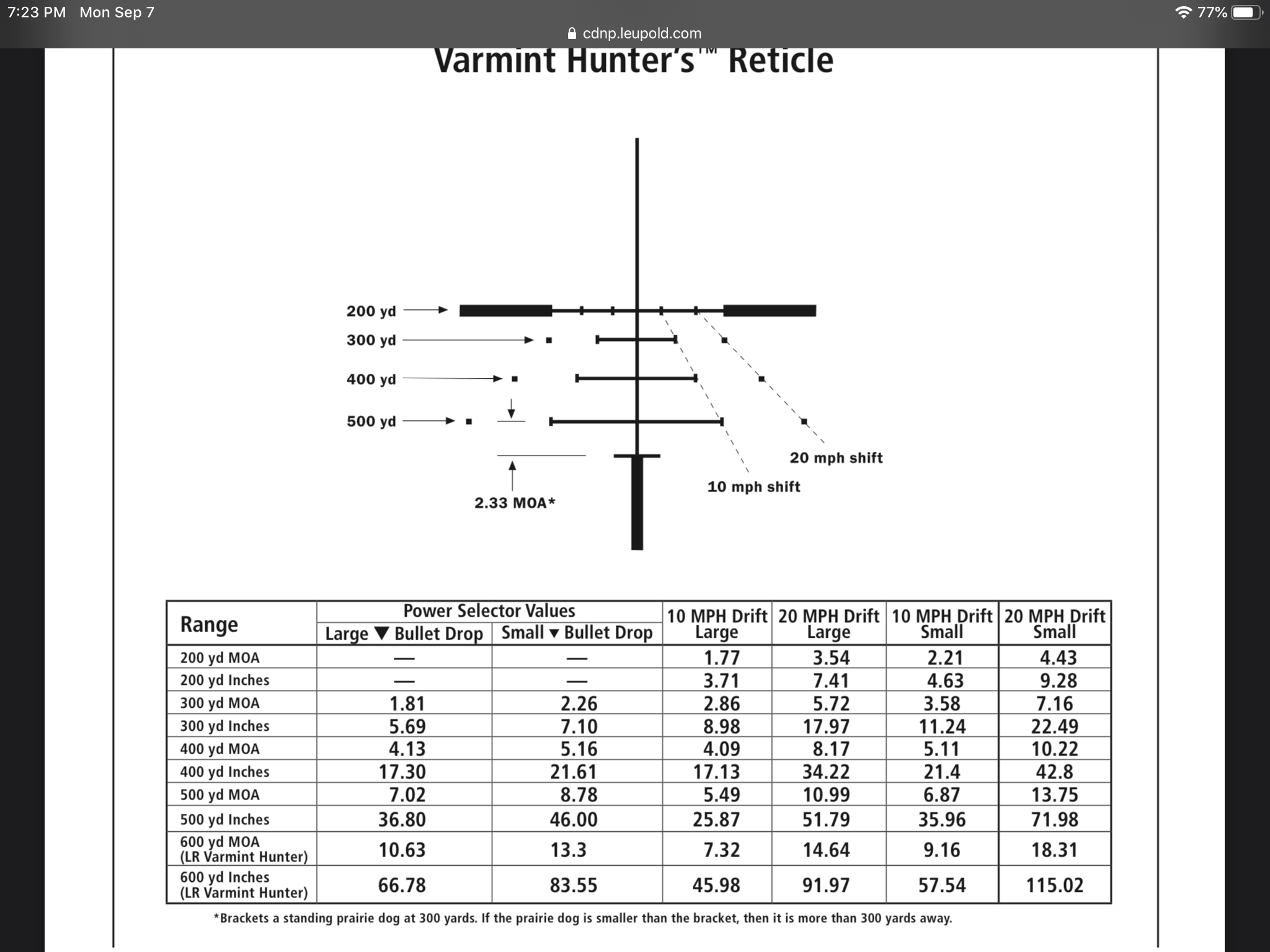

I mounted a VX3-I 6.5-20x scope on my 338-378 weatherby magnum for a hunt out west next month. The reticle is a varmint hunter reticle as seen below. I looked at the manual to get an idea of how many miles/MOA is between each elevation line. Unfortunately the manual is useless and basically lists each line as 200, 300, 400, 500, etc. does anyone know how I can figure out how far apart the lines actually are?
Based on the manual, which is actually quite informative, the subtensions are based power setting you use...
