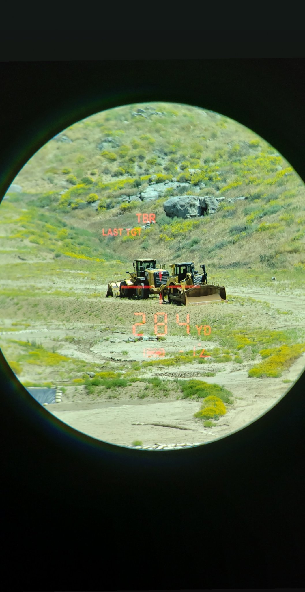

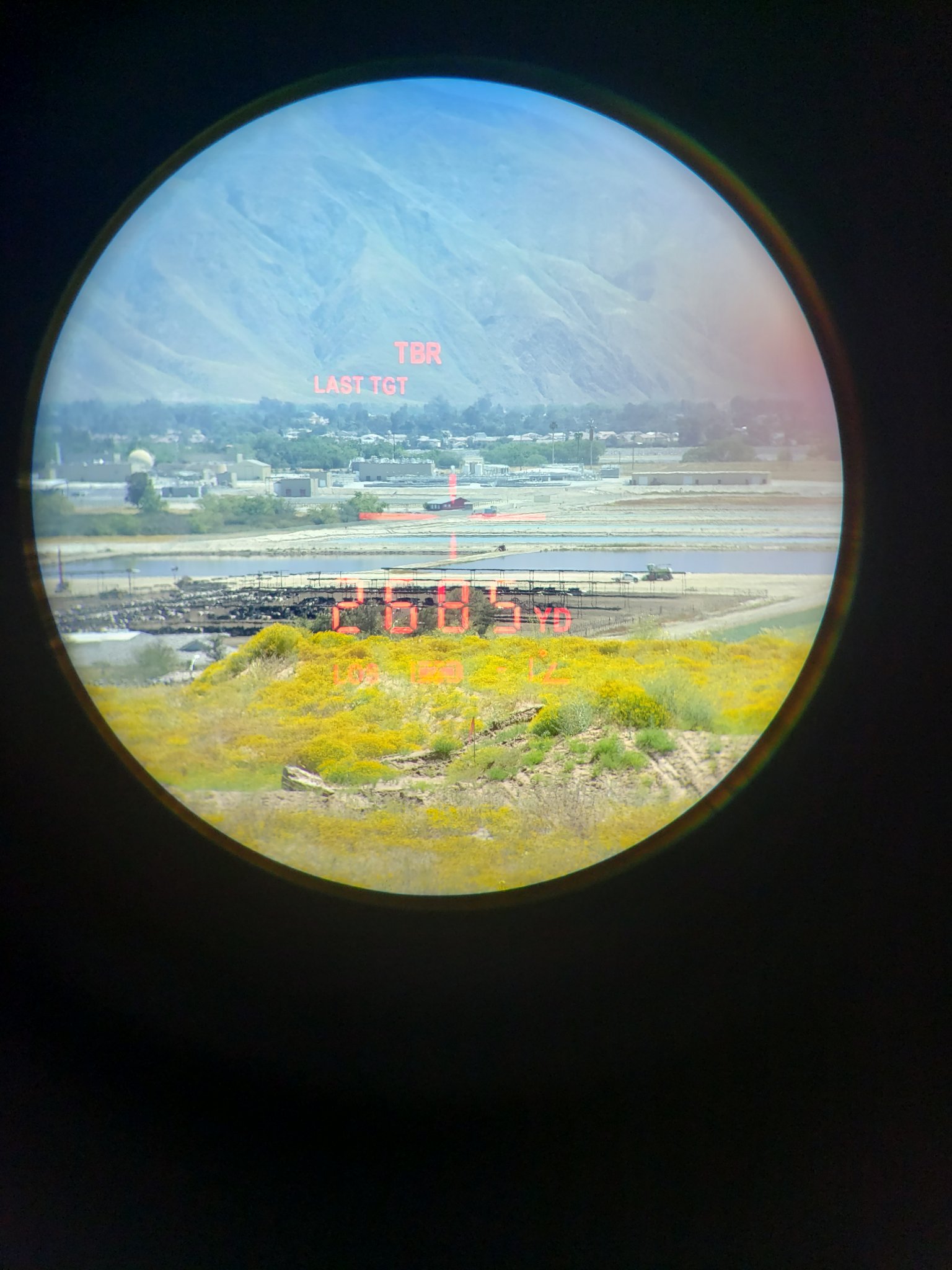

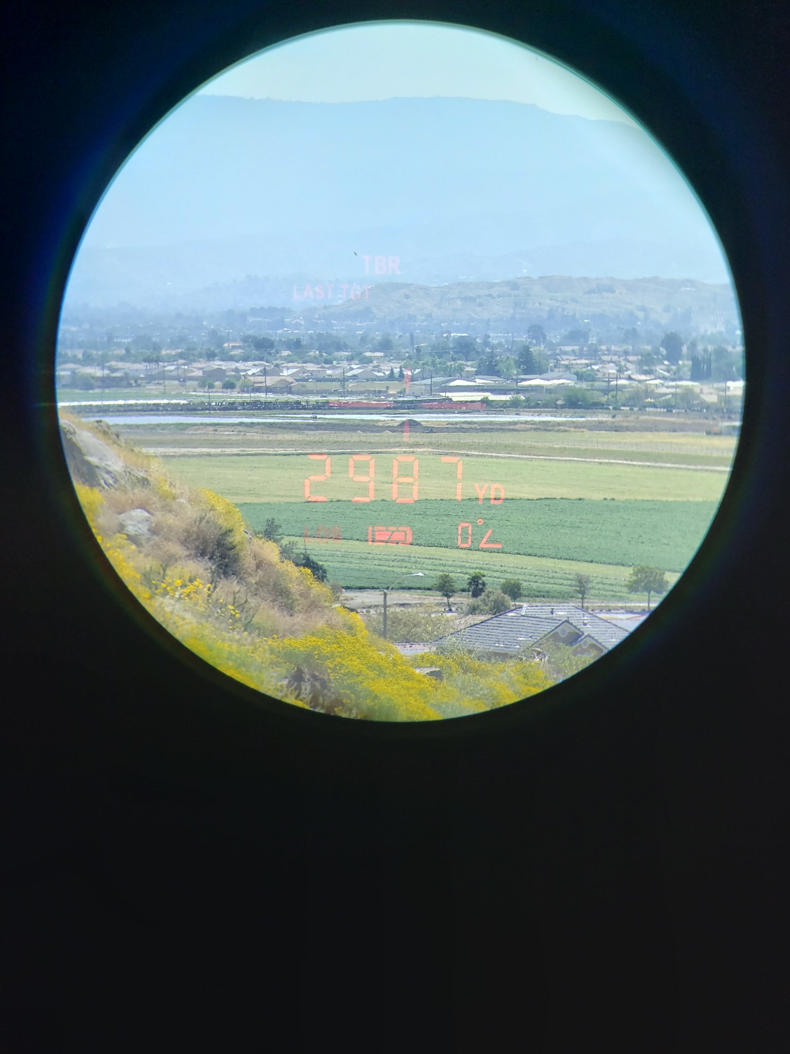

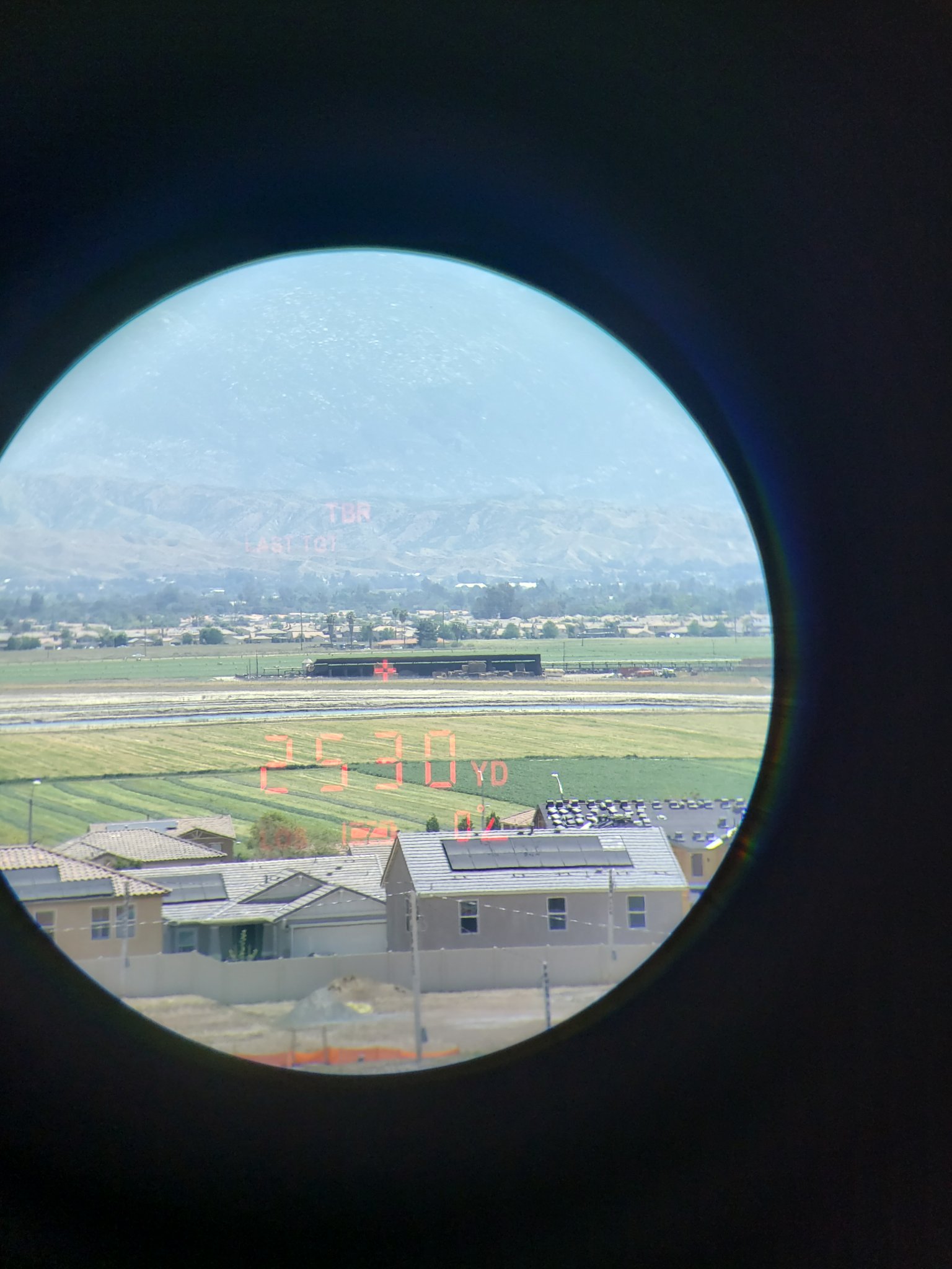

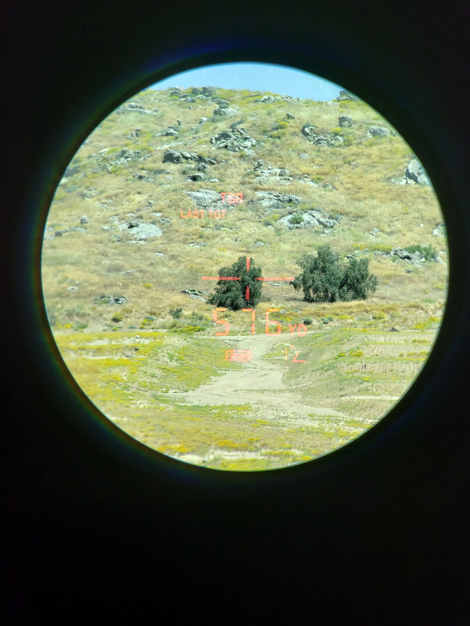

Got my leupold rx-2800 yesterday at bass pro shop. On sale for $449 I almost got the vortex HD4000 but the Leopold glass was better. Here are some pictures on a sunny 82deg day in So Cal.
