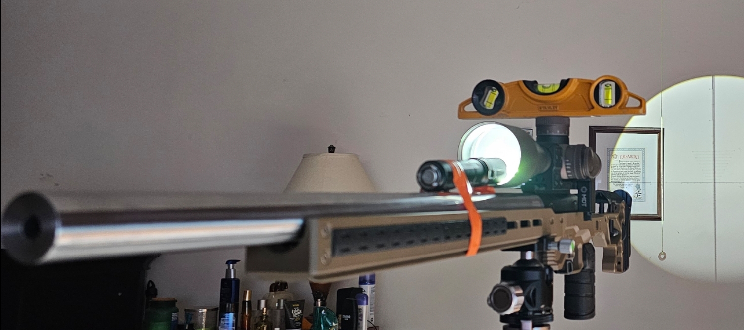

Or maybe its me
OK
RimX action
Spuhr mount with level (lol)
Razor 6x36 G3
MDT send it
Light in objective
Plumb line and shadow on wall
I leveled Spuhr mount with its bubble. Then flashlight in objective to plumb line shadow on wall. Nothing else levels out.
Put level on scope, mount, or gun everything is canted. I am going with plumb line and gravity.
I do some fine tuning trying to get scope, mount or gun level with bubble and MDT send it stays solid green saying its good (😊) the whole time even as plumb line shadow shows me how crooked the scope is.
Why do people make this so hard?

I had not tried the plumb line flash light in objective shadow on a wall before. In the pic you see the plumb line and cross hair shadow on top of one and other. It took a while and several beers yesterday but I think I finally whipped leveling a scope.
