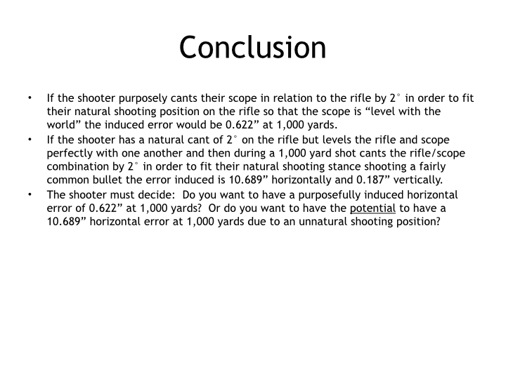

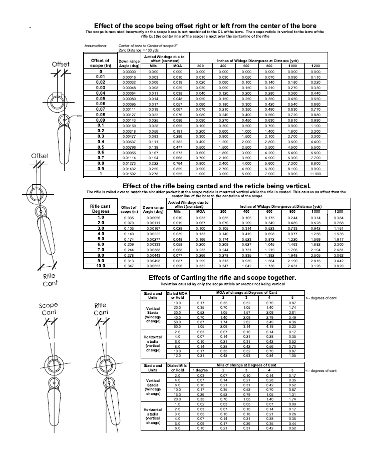

    Well, both the video and @Windrider chart shows a ridiculous cant equal 3” at 1,000 yards …
    I’m not smart enough to reconcile @_Windrider_ ’s chart with @Lowlight ’s cant calcs here:
    But here’s lowlight/Frank’s conclusions (from Frank’s link, directly above):
