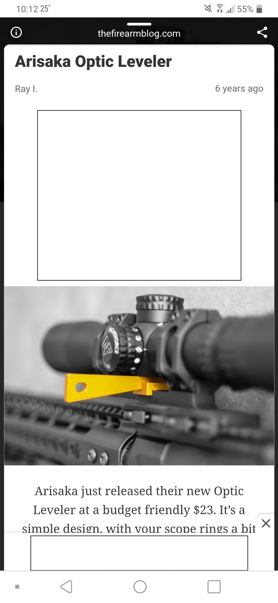

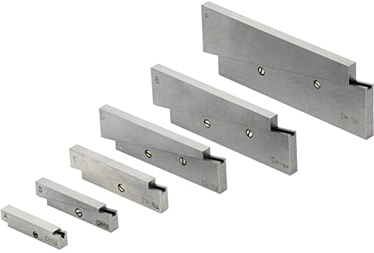

Besides a plumb bob I will use the flat bar of a bolt disassembly tool (Kleinendorst) to gently adjust and hold the flat bottom of the scope and the base. A properly sized Allen wrench for your specific gap can also be used this way.
IMO both of these are more flexible and easier than the wedge tool or playing cards.
