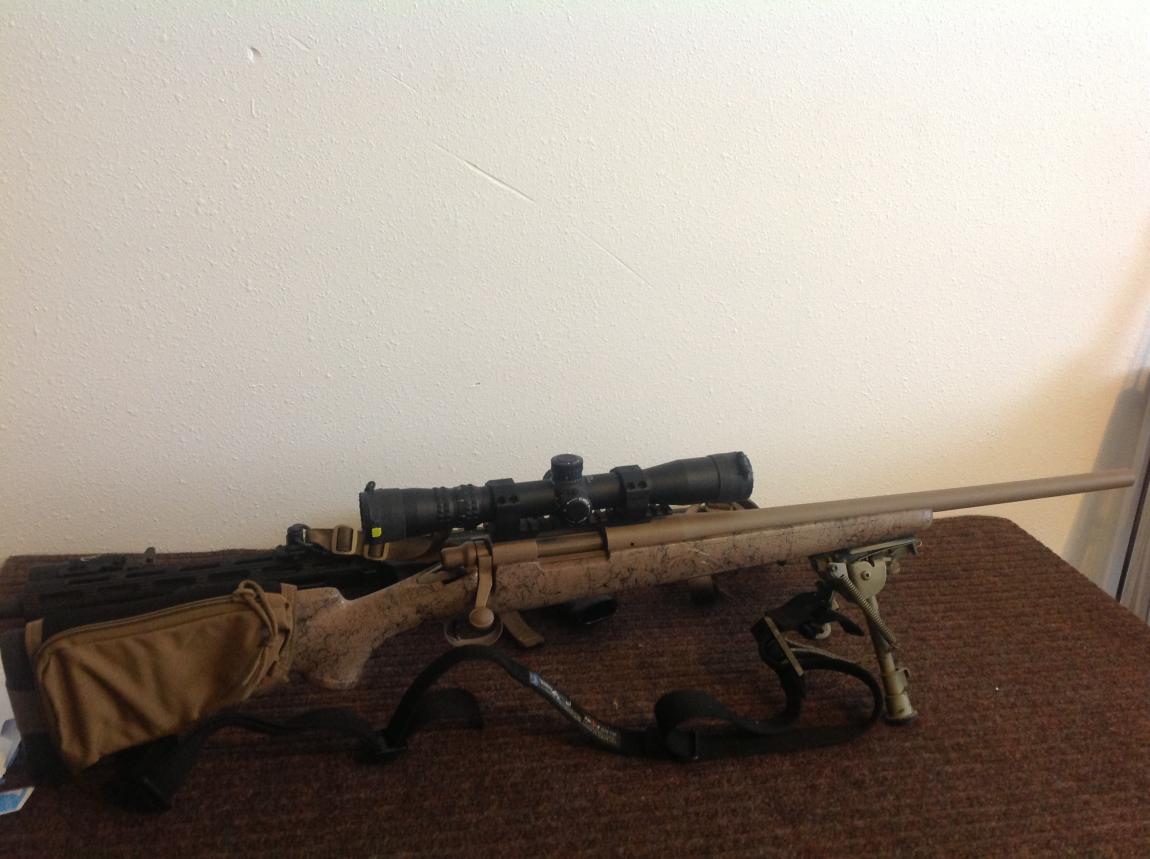

Here is one of my winter projects:
Rem700 receiver w/ PTG one-piece bolt
Manners MCS-T stock (90% carbon fiber)
Surgeon DBM bottom metal with Alpha Type 3 mags
Bartlein #3 barrel chambered in 7mm WSM and finished at 26"
Seekins rail/rings
Please pardon the ugliness, as the metal and stock haven't yet received any finish (still trying to decide on a color scheme).
It's about 10.5lbs "bare" and 12.5lbs with optics/bipod/stock pack as shown in the photo (the scope is just on there for testing purposes - it'll get a smaller optic in the future, which will probably take off a half-pound).
Obviously, such a setup could be chambered in any short-action caliber. Something like a .243 or .260 would be very comfortable to shoot at this weight.
