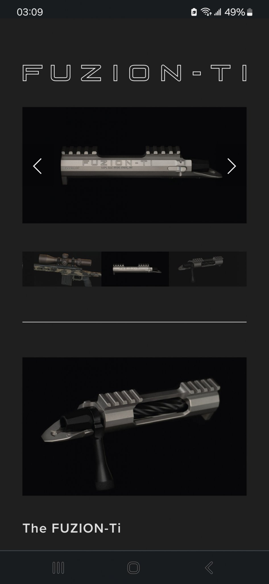

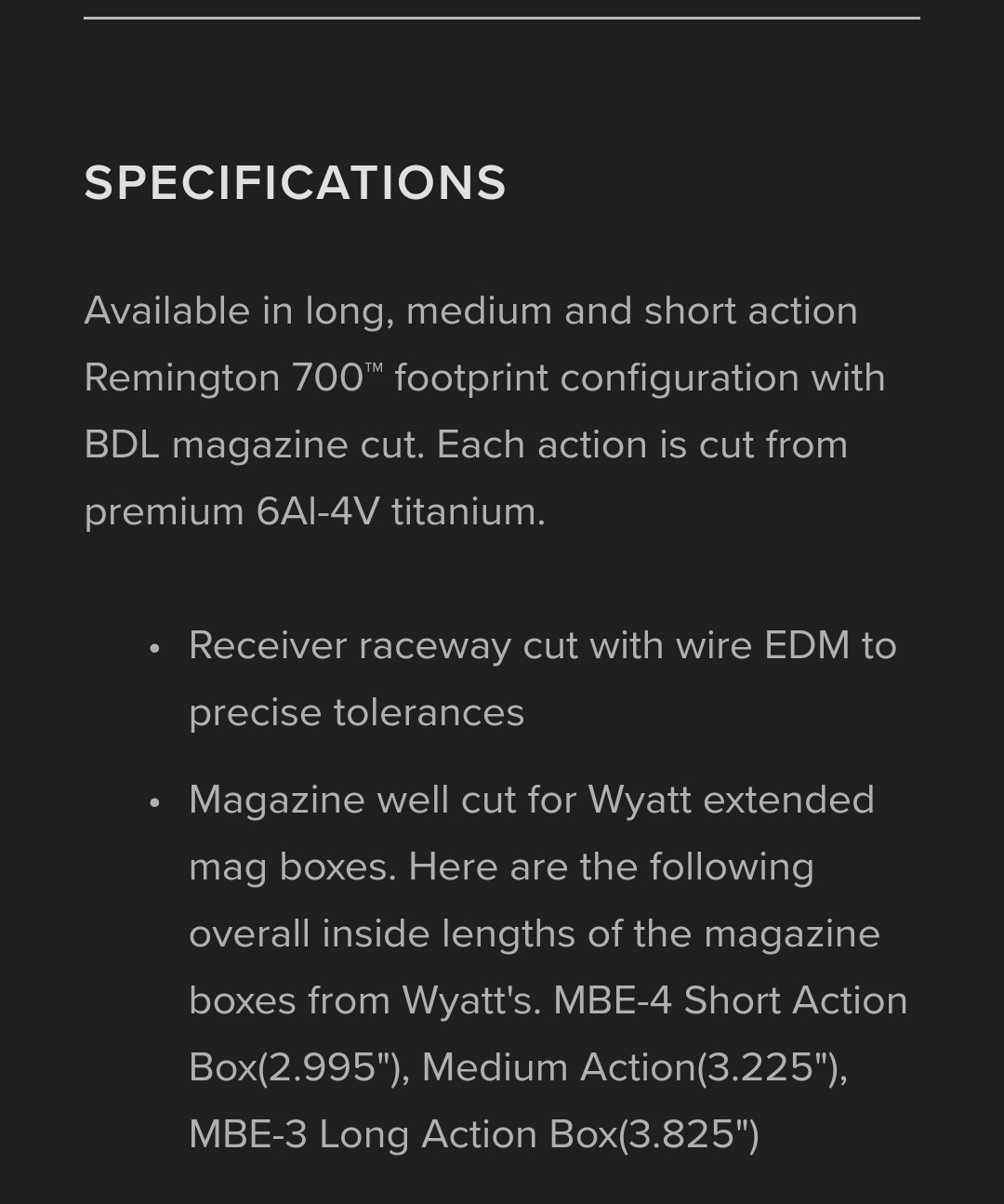

Alpine Cut Fuzion in Ti
They are AWs
They are AWs
All info found, and a talk with them stated only aics/bdl in the alpine cut steel and ti.

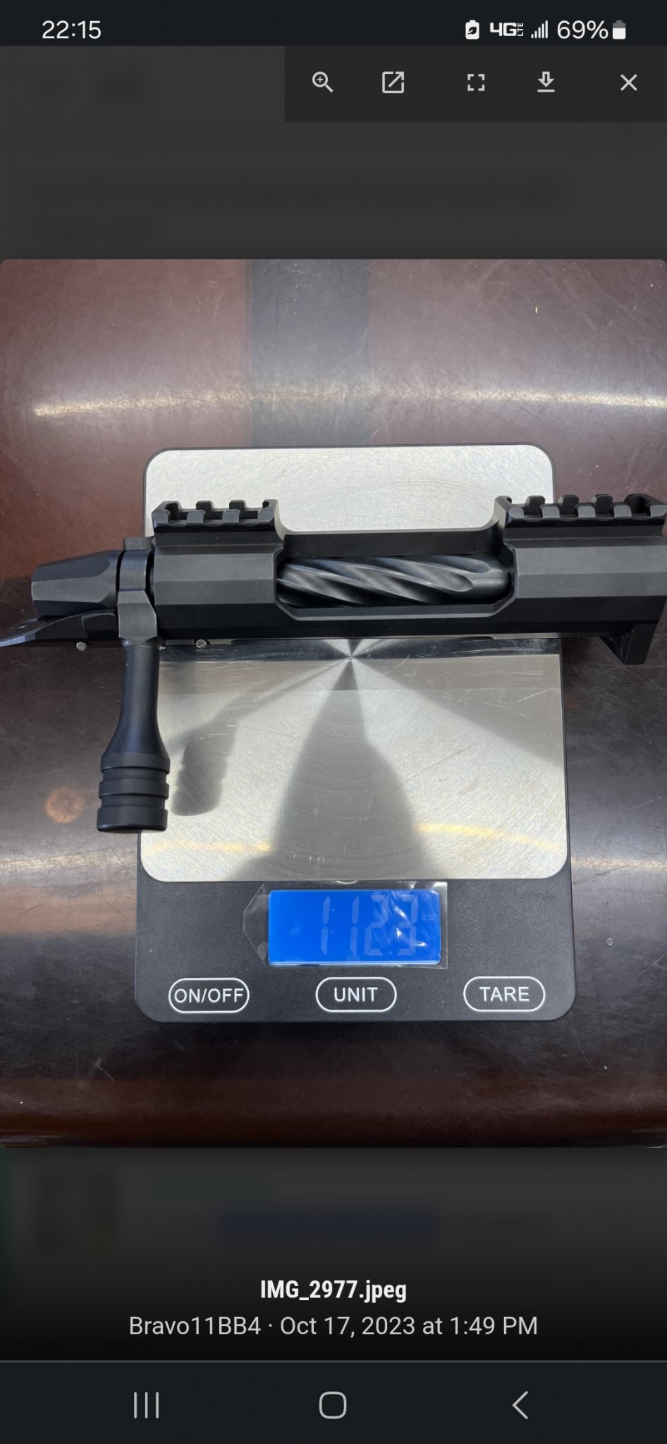

Believe I saw one on a scale at 28.5oz in a thread a while back. Unsure on the material of the bolt knob.
Defiance does cut the AntiX action in aw upon special order, these will land around 23oz I believe. Likely the lightest option.
Found the Pic, don't know how accurate the scale is.
Good option, but I have saw a lot(or any) of these available for a while. I'll have to ask Tate if they were phased out by the NBK.
To my knowledge they were replaced by the NBK. I sold mine actually. I had weird pressure issues with that action. same load in a 737R was water safe. Titan would leave a nasty swipe on it and pop primers when wet. Same speed in both actions obviously, Id look at a AntiX and have it cut for AW. I also thought that LP would make them AW cut... Maybe not?
