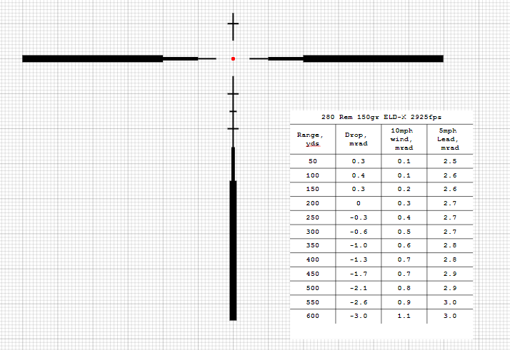

Wow! You designed the G4! I really like that reticle on my HD LH. It's weird that it's not popular here. I'm glad I bought a 3-15 with the G4 while it was still available. If they came out with an illuminated center dot G4 I would buy another one.
My original concept looked something like this or similar. It has been a little while.
7082758
Reactions: Kickin45 and Frankr
Yeah, they did change it a bit and got rid of the vertical line above the dot. It's nice having that line there. They should have kept it. I got a 1.5-8 with the G4 recently because it seemed like a good deal. I have it on my 10/22.
