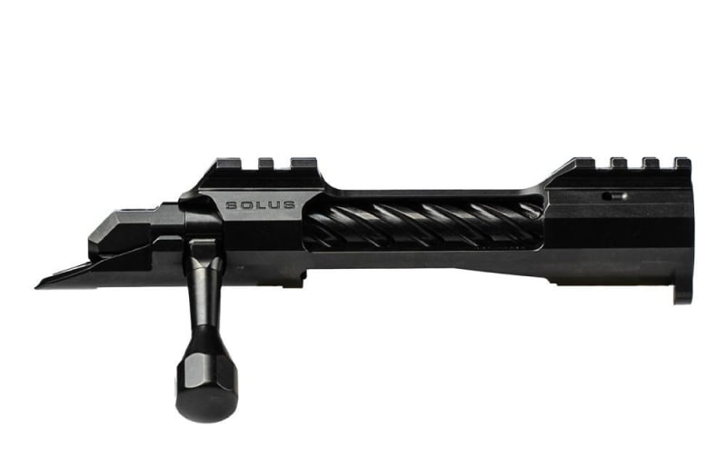

Classic Firearms has ONE Aero Solus Lightweight action left, and it's on sale for $729. It matches every box you had listed...They are even cut for AW mags, integrated lug, 60º bolt, 700 footprint, prefits readily available, etc...
Also, most all barrel manufacturers are making prefits for them (they also use Zermatt Origin prefit barrels).
They also make a magnum .540" bolt face version for short mags...It's on sale, too.

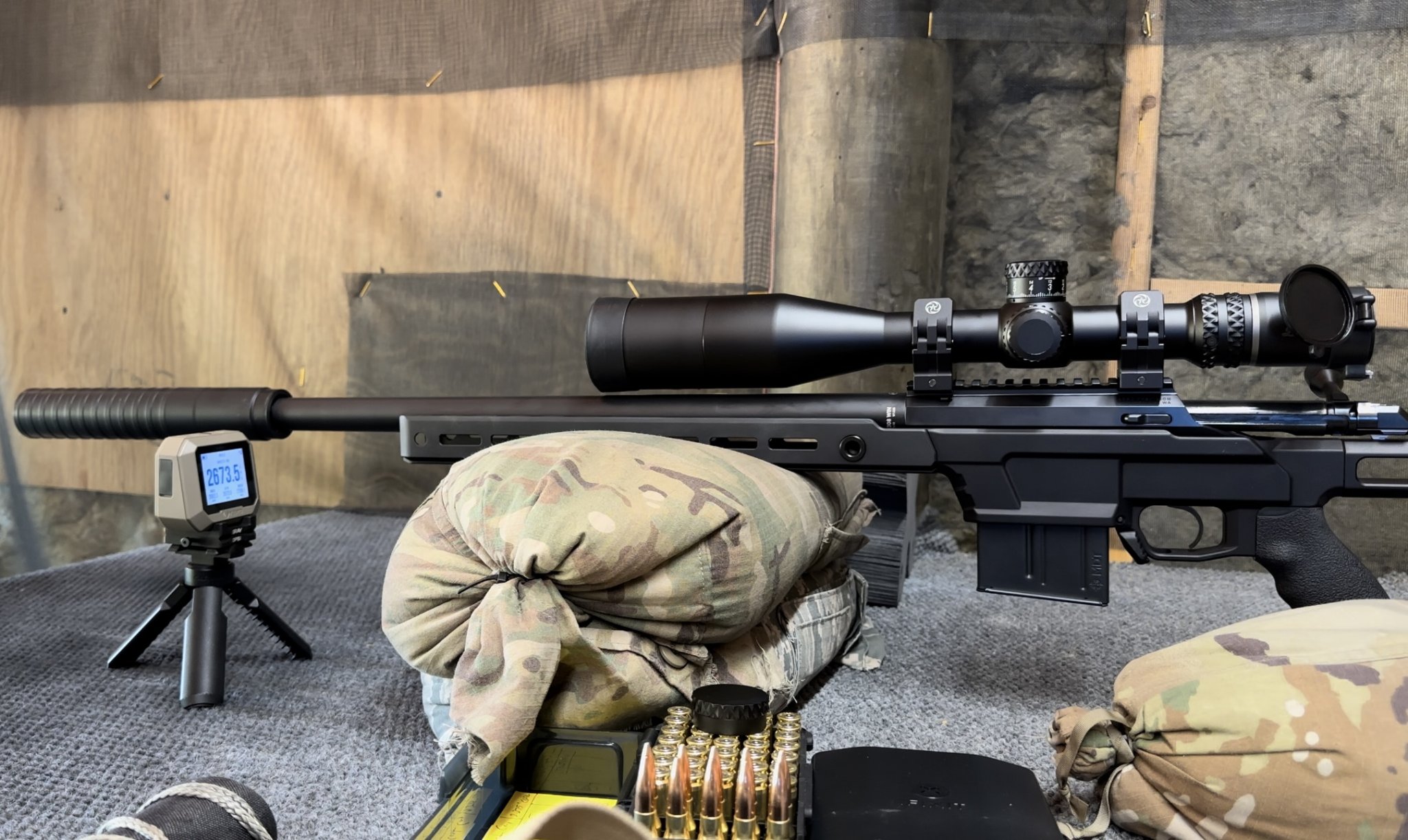

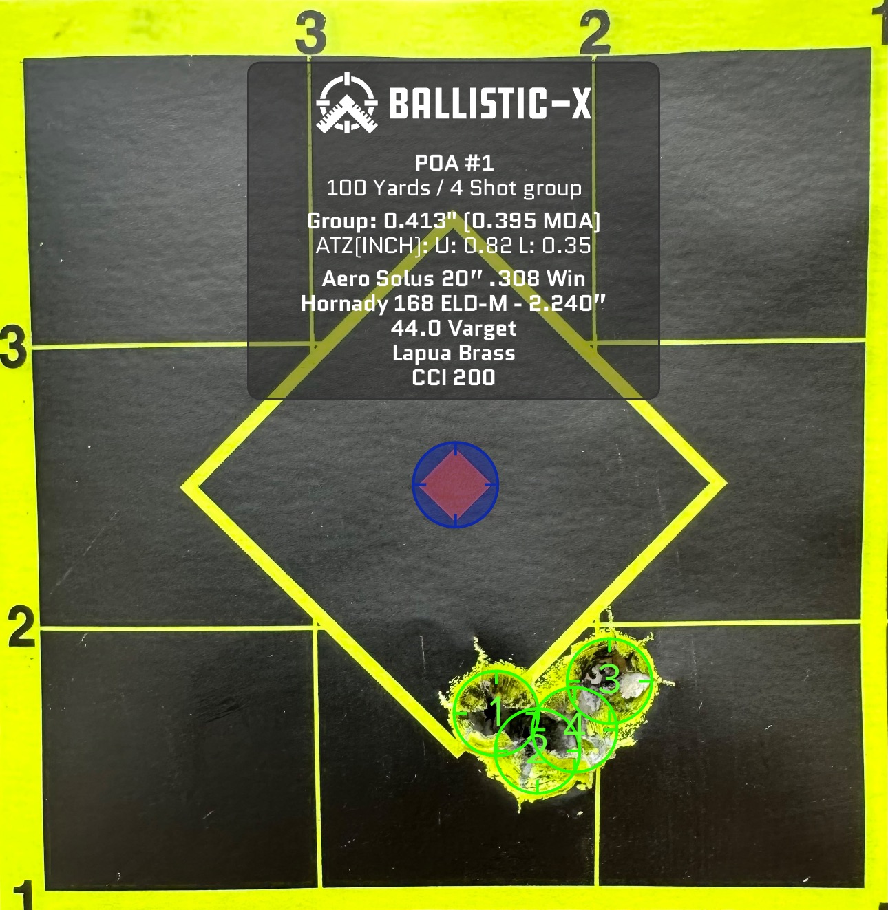

I just ordered my 4th one... They're not junk. People see Aero Precision and immediately think they are. A whole lot of mouths talking shit on here that have never even shot one. I've put close to about 500 rounds downrange through mine combined now, and they're getting smoother and slicker, and better with each range trip. They may not be as slick out of the box as some of the higher priced offerings, but they are built like a tank. They also tick all your boxes on your checklist.
Custom .25 Creedmoor built on a Solus action...
Factory Solus 20" M24 .308 Win...

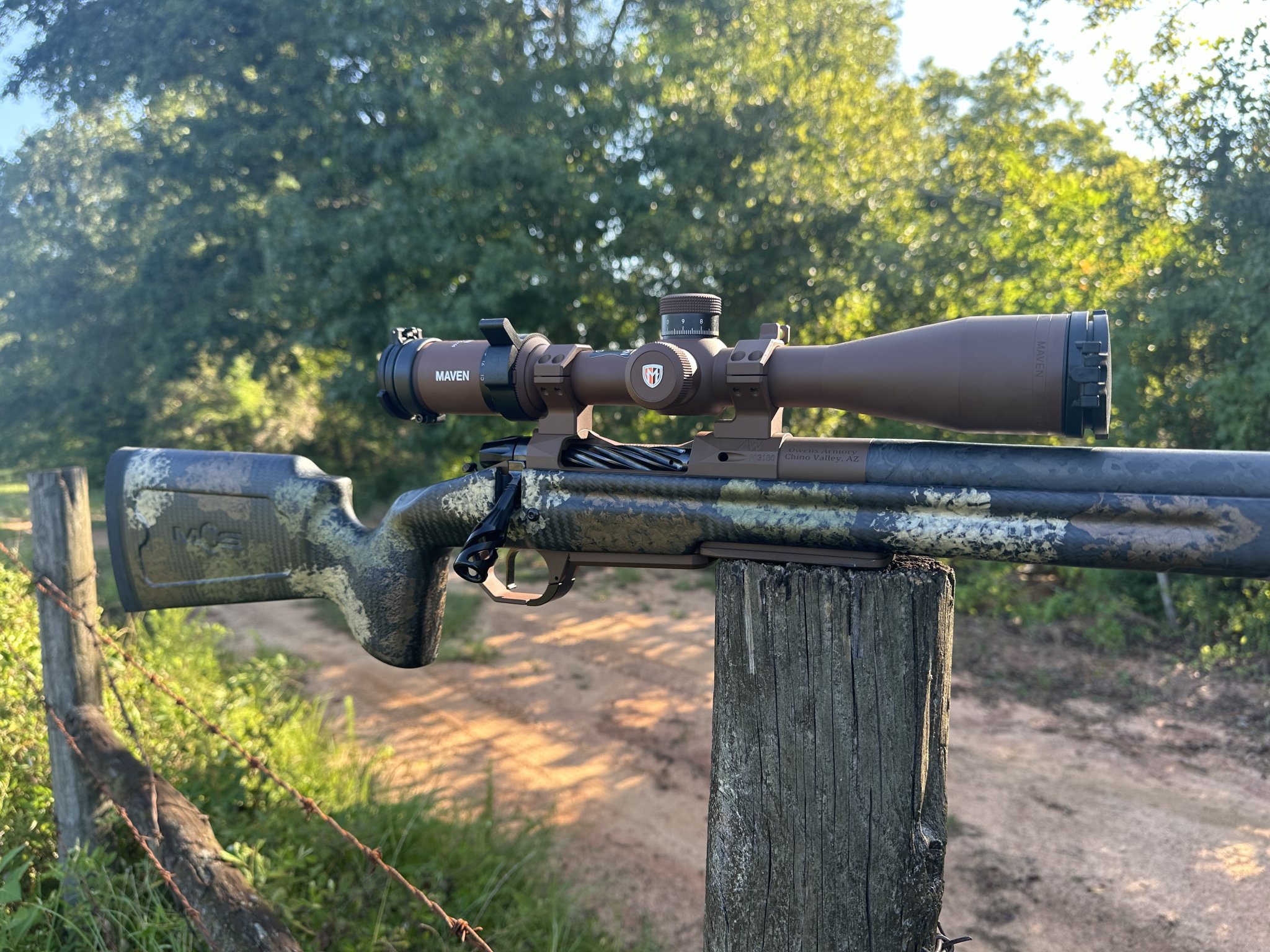

From someone who thought any thing over a 70* bolt throw was hideous, I am absolutely in love with my Falkor LW7 I just used for a lightweight 22CM build. 19.6oz and slick as snot. Feeds so smooth that I often wonder if I picked up a round or not. I'm 122 rounds in and have not put one drop of oil on it. Taking it to Wyoming for mule deer in 3 weeks.

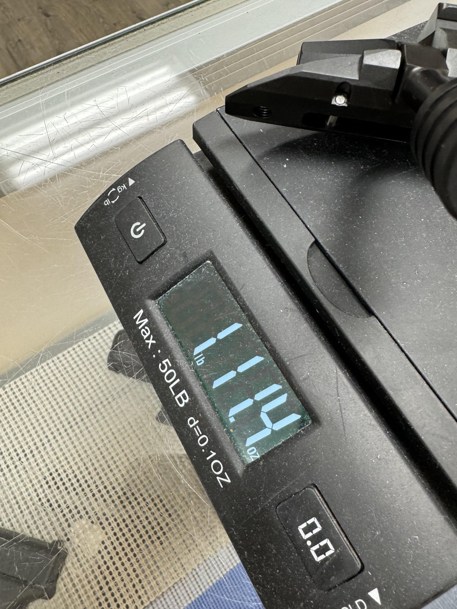

the solus lightweight action would check all your boxes, but i believe there was some recall with them. Hence why they are out of stock on aero's website
Once they work out that kink, i think it would be a real winner. Advertised around 30 oz.
I grabbed one of their "blem" obsidian actions and it is really nice. Lighter than advertised too - 35.2oz all in

My barrel was custom chambered and threaded, proof blank. But I have an ARC CDG and a Terminus Apollo Lite and while I love them all the Falkor is easily the lightest and smoothest.
