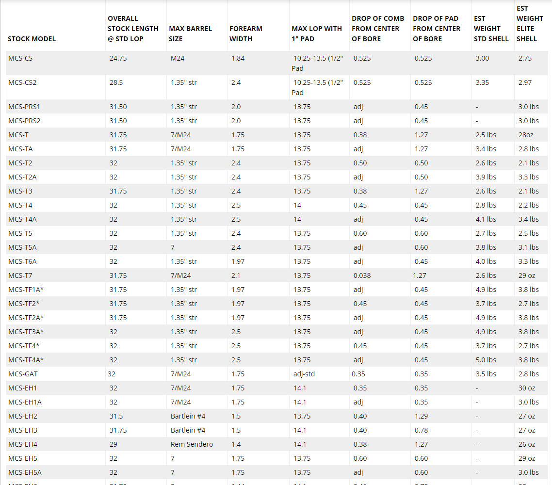

Trying to decide on stock or other suggestions. Wanting a lightweight whitetail hunting rig in 6.5 (I’m not a reloader) and shots will be less than 500yds. Thinking of having TS customs build it and here’s what I have in mind so far.
action: LP Fuzion Ti
18” barrel: Bartlein/Proof/Benchmark CF (Travis has Benchmark CF on shelves)
stock: ?? McMillan A3-5? manners EH? Adjustable cheek preferred

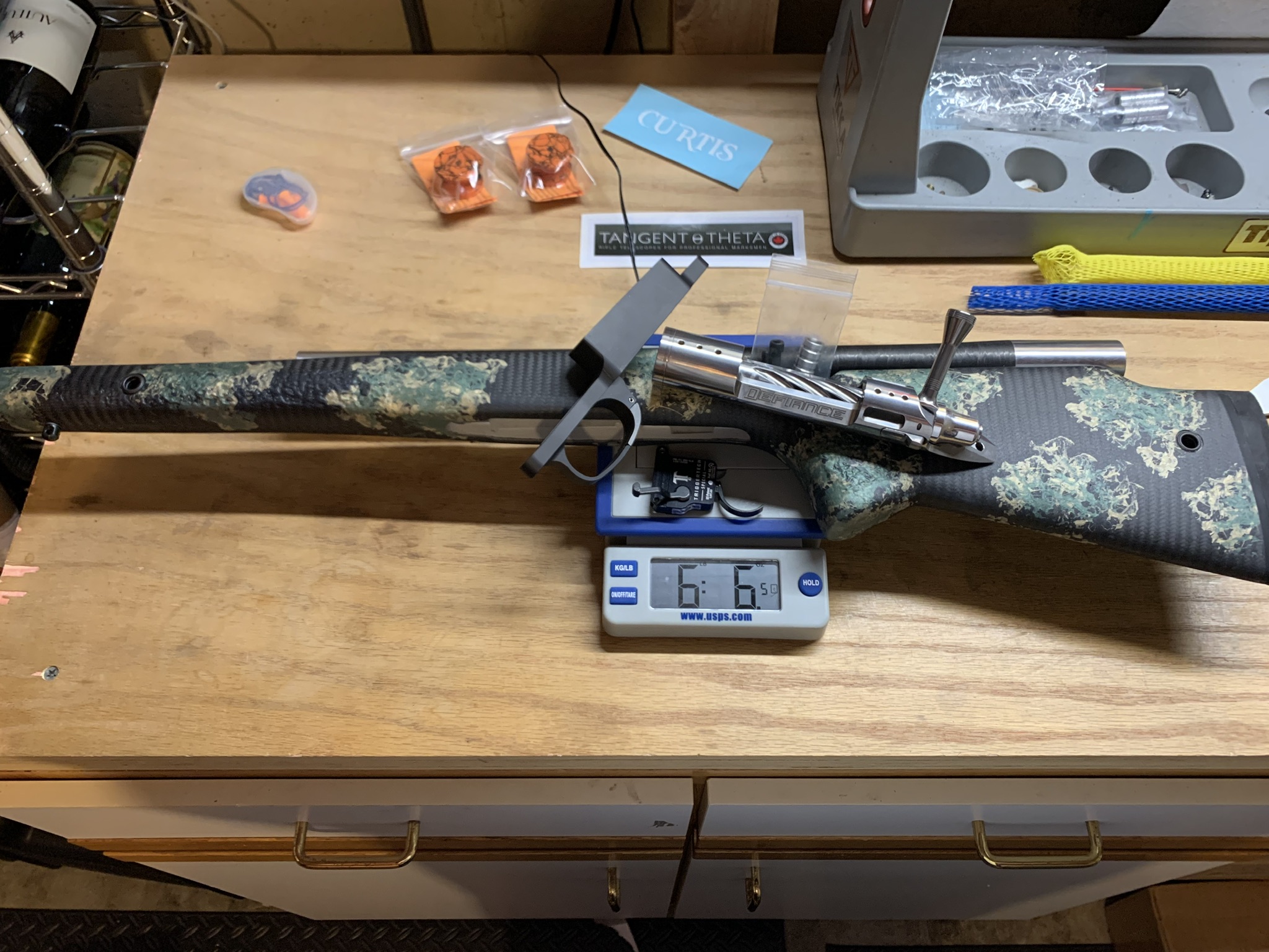

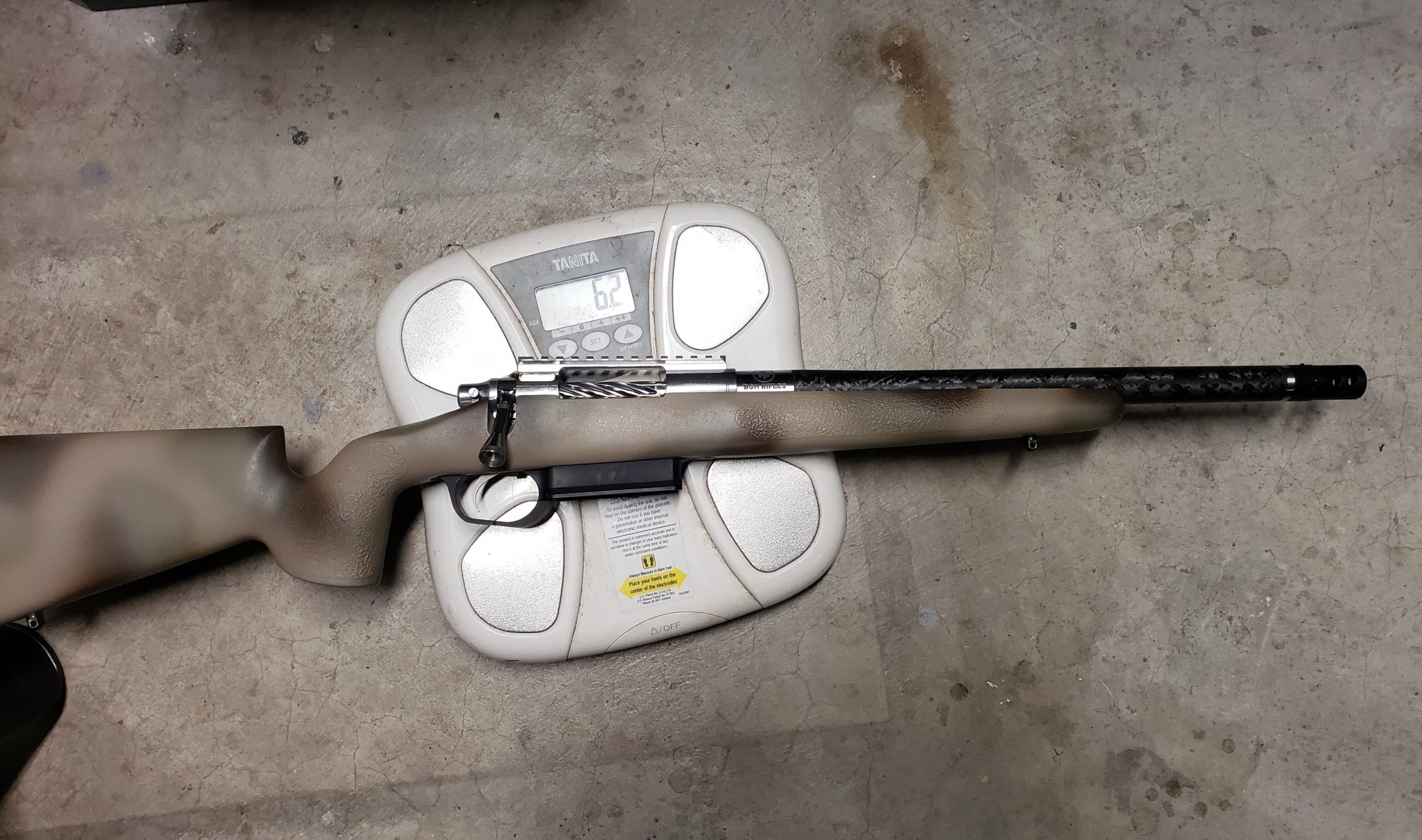

Here's something similar
Mcmillian with adjustable LOP
ANTi X
16.5" proof 6.5 Prc
There's room to make it even lighter

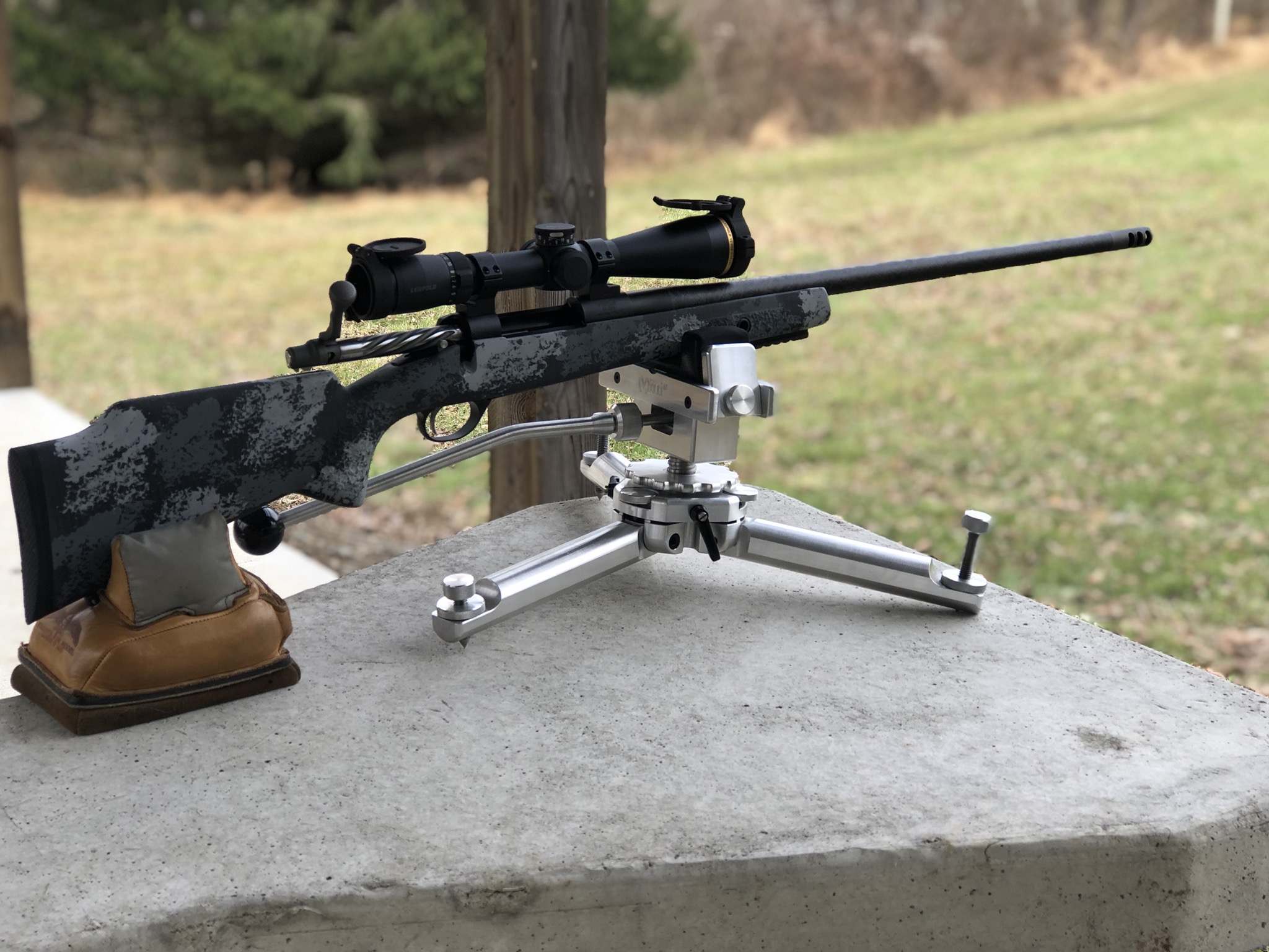

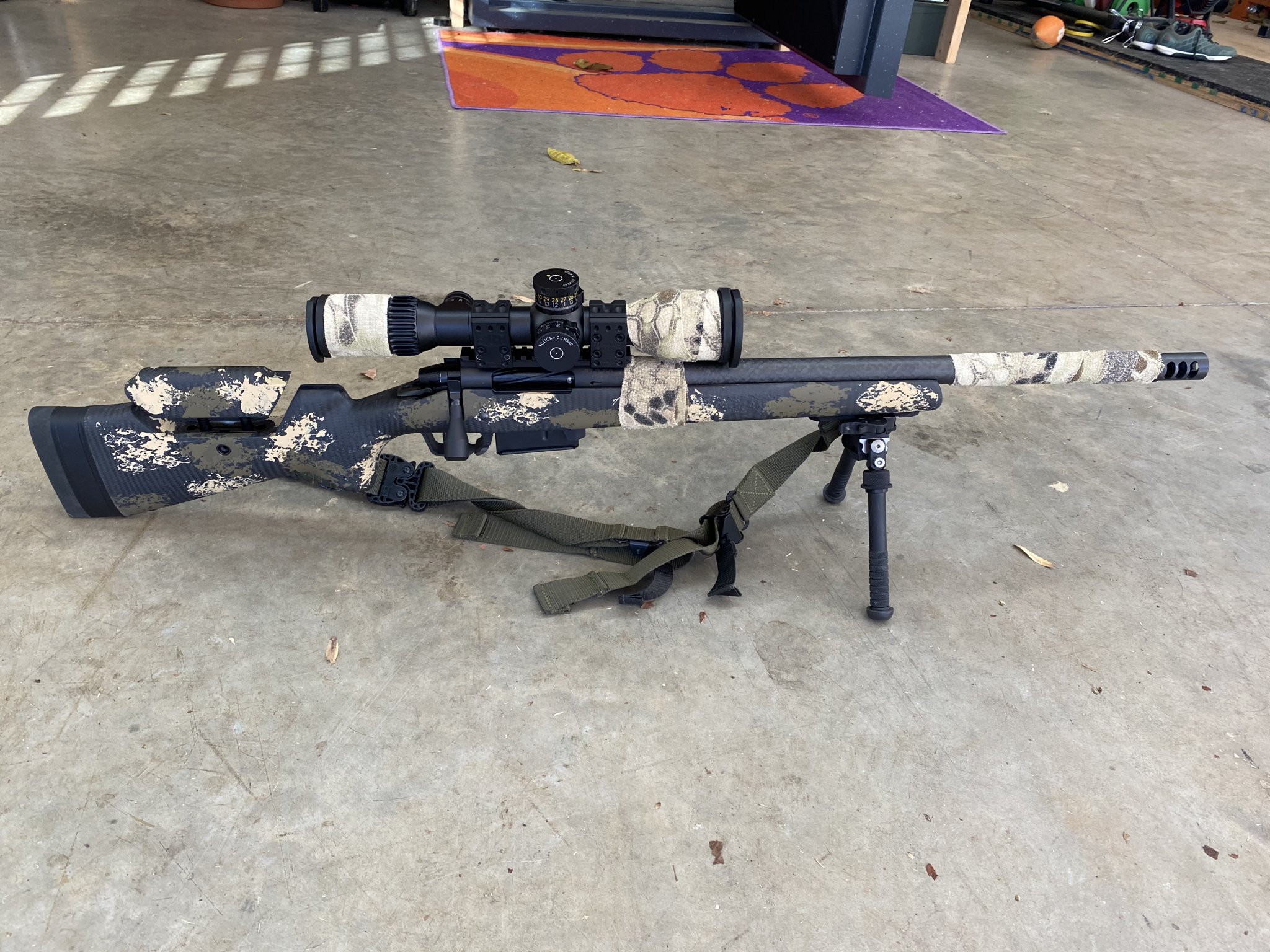

I've posted this in other threads, but here's a recent build I put together with almost exactly your stated intent. Without bipod and scope it's right at 7lbs.
Yes, I know I put a damn 2lb scope on a lightweight rifle... every man has his weaknesses.
Stock - Manners MCS-TA w/ mini-chassis
Action - Zermatt TL-3
Barrel - Proof CF Sendero, 6.5CM 20"
Trigger - Triggertech 2-stage flat
IMO 6.5 Grendel is more work than it's worth in this application, when 6.5 Creedmoor is just plug-and-play.

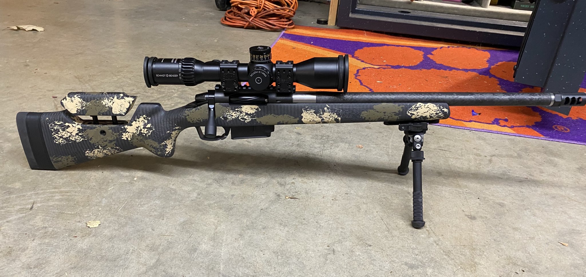

My last build with Travis was titanium lone peak razor long action, 24” proof sendero carbon wrapped barrel, Manners EH-1 with dbm mini chassis, and triggertech.
Those components + 2 flush cups + 20MOA rail + bipod pic rail weighs in at 7 lbs 1oz (no mag).
A s/a Ti Fuzion should be a little lighter or equal in weight with my razor + rail. BDL will be a couple ounces lighter than DBM. You’ll shave weight on a shorter barrel as well. Adjustable cheek piece will add ~1 pound though.

The lightest stock option with an adjustable cheek is the All-Composites A5 at ~20oz with the adjustable hardware, but I haven’t seen one in stock anywhere in a hot minute. It’s also ~$2500.
The second lightest is the XLR Element 3.0 Magnesium/Carbon at 28oz and ~$1100.
The AG Composites and Manners options are closer to 40oz with bottom metal and adjustable cheek.
Beyond that, I would encourage looking at the Defiance AnTi - titanium is fine for a hunting rifle that only gets shot a few hundred times, but it’s super prone to lots of impact-related issues and any surface defects make that worse.
As far as the barrel is concerned, go for a left hand gain twist carbon from Bartlein, and use the new barrel steel if you don’t want your great grandkids to need to rebarrel the rifle during their lifetimes =D
I don’t think there’s any reason to go for 6.5G over 6.5CM in a platform other than the AR-15, especially for a hunting rifle. In an AR-15, the grendel is probably the best option for a deer rifle, but once you step into a true short action the creedmoor is not too big for deer and is big enough that elk and black bear are feasible. If you’re lucky enough to get a sheep tag Creedmoor gives you more options for distance at the reduced velocity from temperature.

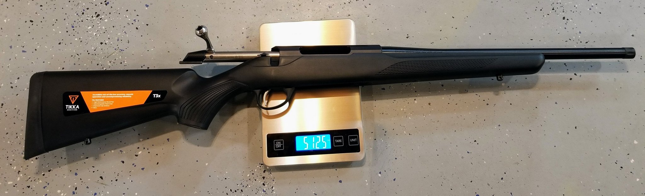

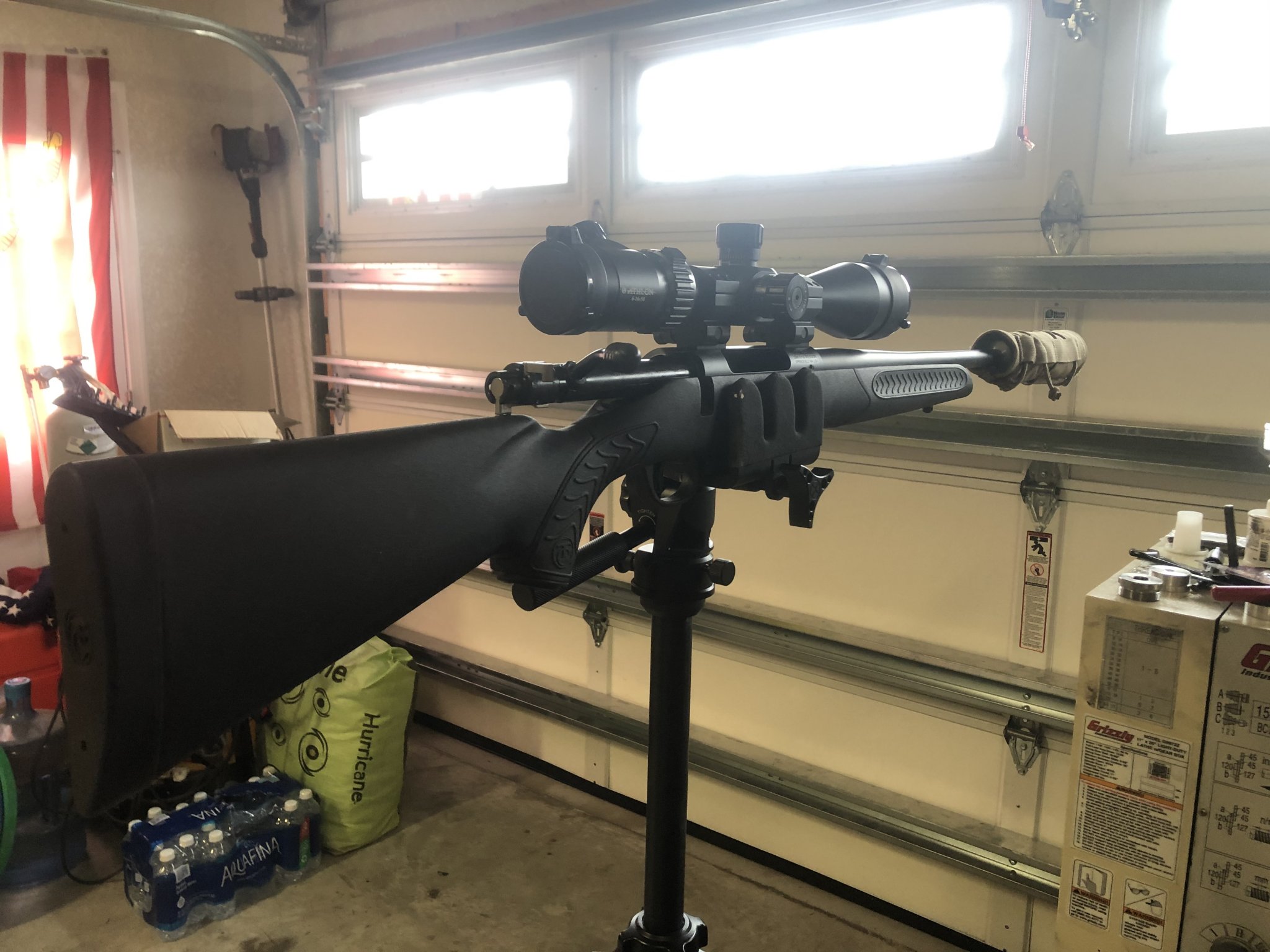

Here’s a TC I tried the action cut the barrel to 16.085” and shoots well! Scope and all in this gun less then $500... minus can.

I'd avoid an adjustable peice if possible. To balance it out you need a heavier barrel. Look at the stocks with high combs instead and then low mounts like arcm10, apas or seekins or leupold backcountry mediums are similiar to talley lows from my understanding

I love the carbon cheek, I have it on two manners stocks as well as two jcs composites stocks(pics of jcs attached). I have sold 3 of 4 my rifles built on ti actions, and the 4th will be going down the road soon. Lone peak runs pretty light springs, that's why they have such light bolt lift. Plus they don't bush their pins on the razor which leads to sharp pins and pierced primers. If I build another true lightweight it'll be on a defiance antiX. Here are a few pics of the carbon cheek. Super easy install.
View attachment 7517620View attachment 7517621
I like!
LP Fuzion Ti
Bart 2b 7mm-08 with short shank at 22”
PTG stealth in a McMillan Mountaineer gel coat.
Weighed just north of 6lbs.

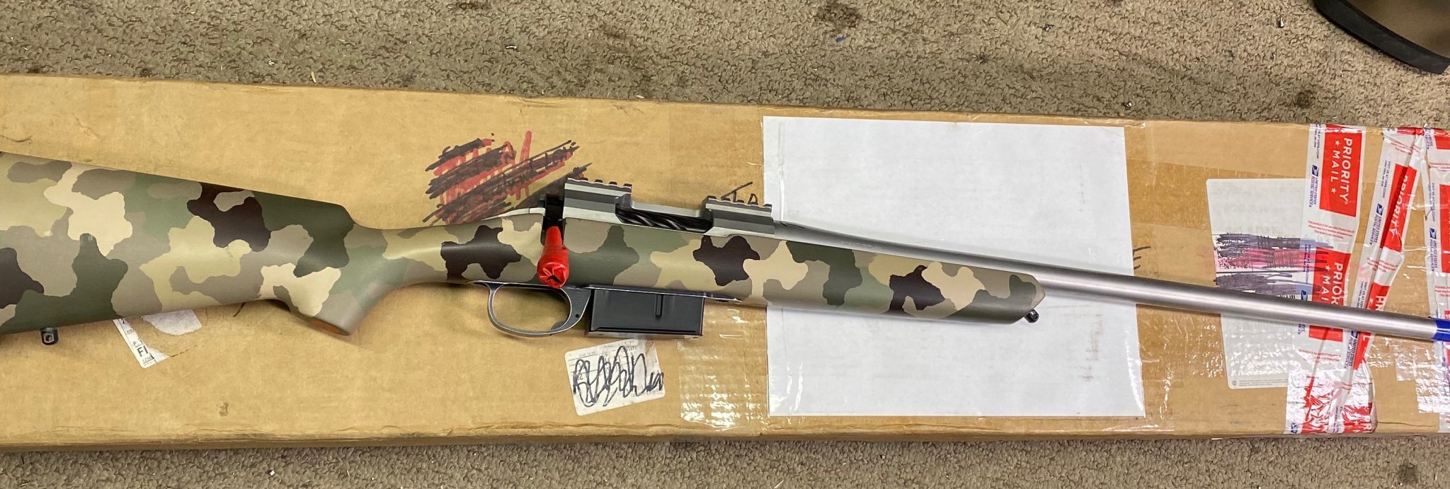

Well..... I went custom route. Decided on my realistic intentions, that I didn’t need ultra light weight like I was originally planning so gave up some in the action and stock. Still should be a handy little whitetail slayer and range plinker.
Having Travis at TS Customs cook me up:
• 18” 6.5cm benchmark CF 1:8 tw
• Lone Peak Fuzion SS
• Manners EH1A highland camo
• Hawkins hunter dbm
• TT Special Pro Curve 2-stage

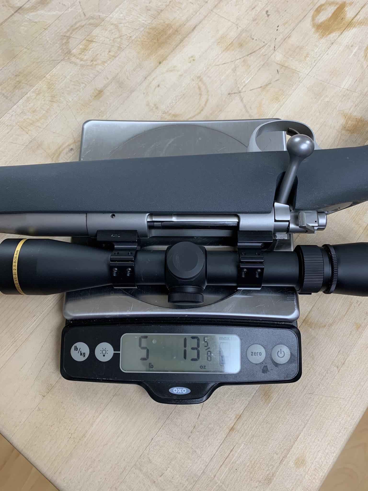

Kimber Montana .308
21" barrel + brake
Leupold VX3i 2.5-8x36mm
Talley Lightweight rings
Sure is nice to carry in the mountains, but I have a hard time keeping under 2 MOA past 300 yard. Doesn't really matter though, I don't really want to shoot past 300 yards with an 8x scope with a duplex reticle and capped turrets.

Well, I don't know what they are doing to account for the other 12 oz.
Cheers
the stocks are hollow so they have to fill the voids and then they epoxy the loggerhead in. I installed one in a standard weight HS precision stock and found myself adding basically the same weight that you see from the manners install so I believe it.
I filled the cavity with open cell foam(closed would've been nicer but that doesn't come in a rattle can) then epoxied the loggerhead in with plenty of microballoons to make the epoxy lighter and thicker to keep it only where i wanted it. After all was said and done I think it would take a very practiced installer to have a finished install at the advertised weight on the lighter weight stocks because of the thinner wall and larger void to fill.
