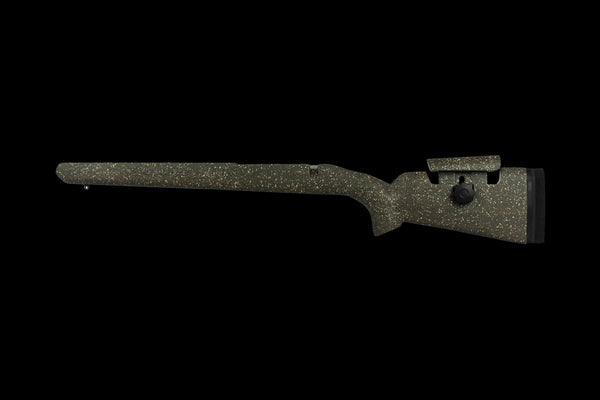

Trying to decide on stock or other suggestions. Wanting a lightweight whitetail hunting rig in 6.5 (I’m not a reloader) and shots will be less than 500yds. Thinking of having TS customs build it and here’s what I have in mind so far.
action: LP Fuzion Ti
18” barrel: Bartlein/Proof/Benchmark CF (Travis has Benchmark CF on shelves)
stock: ?? McMillan A3-5? manners EH? Adjustable cheek preferred

@Secant damn!! 1lb for an adjustable cheek piece. That does not seem worth it to me. That’s a lot to sacrifice. How’re you liking the Fuzion Ti action?

The lightest stock option with an adjustable cheek is the All-Composites A5 at ~20oz with the adjustable hardware, but I haven’t seen one in stock anywhere in a hot minute. It’s also ~$2500.
The second lightest is the XLR Element 3.0 Magnesium/Carbon at 28oz and ~$1100.
The AG Composites and Manners options are closer to 40oz with bottom metal and adjustable cheek.
Beyond that, I would encourage looking at the Defiance AnTi - titanium is fine for a hunting rifle that only gets shot a few hundred times, but it’s super prone to lots of impact-related issues and any surface defects make that worse.
As far as the barrel is concerned, go for a left hand gain twist carbon from Bartlein, and use the new barrel steel if you don’t want your great grandkids to need to rebarrel the rifle during their lifetimes =D

I love the carbon cheek, I have it on two manners stocks as well as two jcs composites stocks(pics of jcs attached). I have sold 3 of 4 my rifles built on ti actions, and the 4th will be going down the road soon. Lone peak runs pretty light springs, that's why they have such light bolt lift. Plus they don't bush their pins on the razor which leads to sharp pins and pierced primers. If I build another true lightweight it'll be on a defiance antiX. Here are a few pics of the carbon cheek. Super easy install.

Well..... I went custom route. Decided on my realistic intentions, that I didn’t need ultra light weight like I was originally planning so gave up some in the action and stock. Still should be a handy little whitetail slayer and range plinker.
Having Travis at TS Customs cook me up:
• 18” 6.5cm benchmark CF 1:8 tw
• Lone Peak Fuzion SS
• Manners EH1A highland camo
• Hawkins hunter dbm
• TT Special Pro Curve 2-stage

Adjustable cheek piece will add ~1 pound though.
Why? KMW's Loggerhead hdwr used in Manners and which can be put into most composite stocks by Joe Ducos comes in at 5.6 ounces. Remove a bit of the stock, add a bit of Marine-tex and I can't see this feature adding any more than...well, 6 ounces or so.

Well, I don't know what they are doing to account for the other 12 oz.
Cheers
the stocks are hollow so they have to fill the voids and then they epoxy the loggerhead in. I installed one in a standard weight HS precision stock and found myself adding basically the same weight that you see from the manners install so I believe it.
I filled the cavity with open cell foam(closed would've been nicer but that doesn't come in a rattle can) then epoxied the loggerhead in with plenty of microballoons to make the epoxy lighter and thicker to keep it only where i wanted it. After all was said and done I think it would take a very practiced installer to have a finished install at the advertised weight on the lighter weight stocks because of the thinner wall and larger void to fill.
