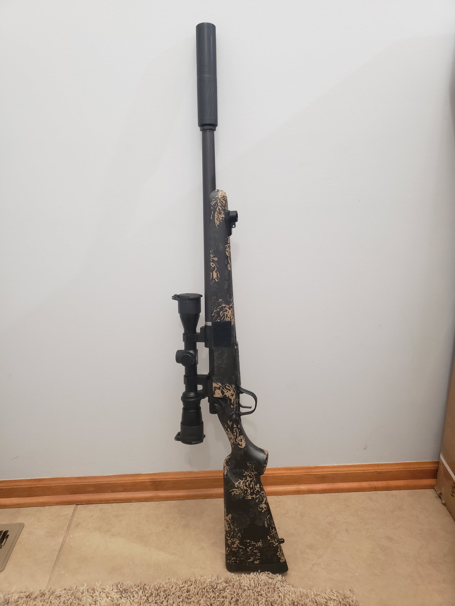

The stock itself is nice. Its surprisingly rigid for how light it is.
This is a 16" 6.5 Creedmoor. As seen with suppressor and optic, is 6.25lbs
Other is a 22" 6 Creedmoor. Weighs right at 6.7lbs with suppressor and optic. Looks the same but a bigger scope and longer barrel.
