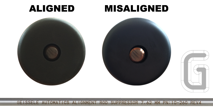

I use appropriate sized alignment rods to check clearance with the suppressor installed. On every rifle regardless of where it came from. The can alignment has to be concentric with the bore or you could have a baffle strike. Seen more than a few factory threaded barrels that had to be chopped and redone and a few smith built guns that had to be done. After spending that much on the can and stamp and waiting that long, cheap insurance.

They're just inserted in bore and visually inspected for alignment at suppressor cap. You can also tell a lot just by looking down the bore from breech end w/ suppressor mounted.
I Should’ve taken pics and posted that earlier. Thanks for doing that @Waorani .
And if you have different length cans measure them all. I have one rifle that will pass on a 5inch can,(not as much clearance as I’d like) but if I put my 9 in can on it looks like the 2nd pic above. Definitely into baffle strike territory. And I know the rods aren’t cheap, but considering the cost of your cans, tax stamp and transfer, It’s cheap Insurance that you only have to buy once as long as you take care of them.
