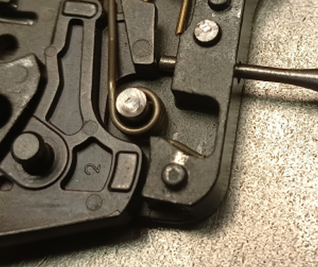

I often recommend that people use finger nail polish ( enamel ) to keep the pins in place after doing trigger jobs. IE: CZ457
I often feel like people think that FP is somehow a bad idea. I also use it on polymer magazine housings. The don't like being staked.
The other option is to stake the housing. I have staked the devil out of the second photo so that it will be clear in the photo.
The smallest amount of pin prick is all that is needed.
I'm sure I've read that Anschutz position on Loc-tite is not to use it do to the possibility of wicking.

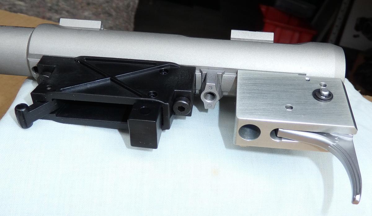

Great looking trigger mod ! I get the feeling that he also turned it into a single shot gun. Looks like a aftermarket bbl
and a zero MOA base as well..

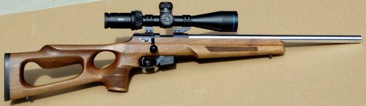

I think Jason's skills are only limited by his imagination - Here is his LA101 creation.

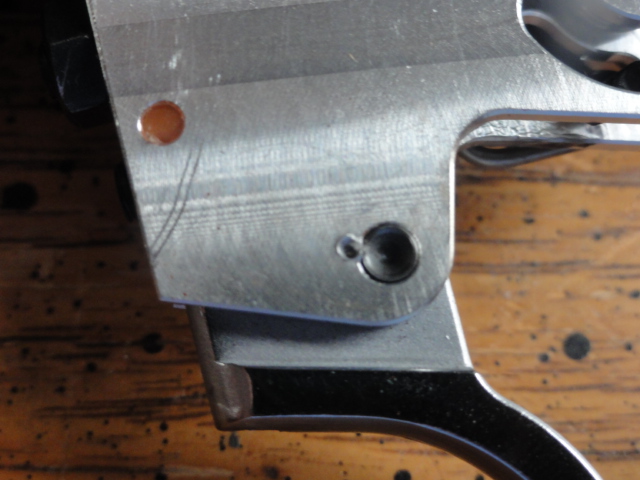

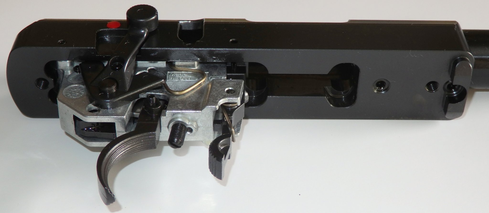

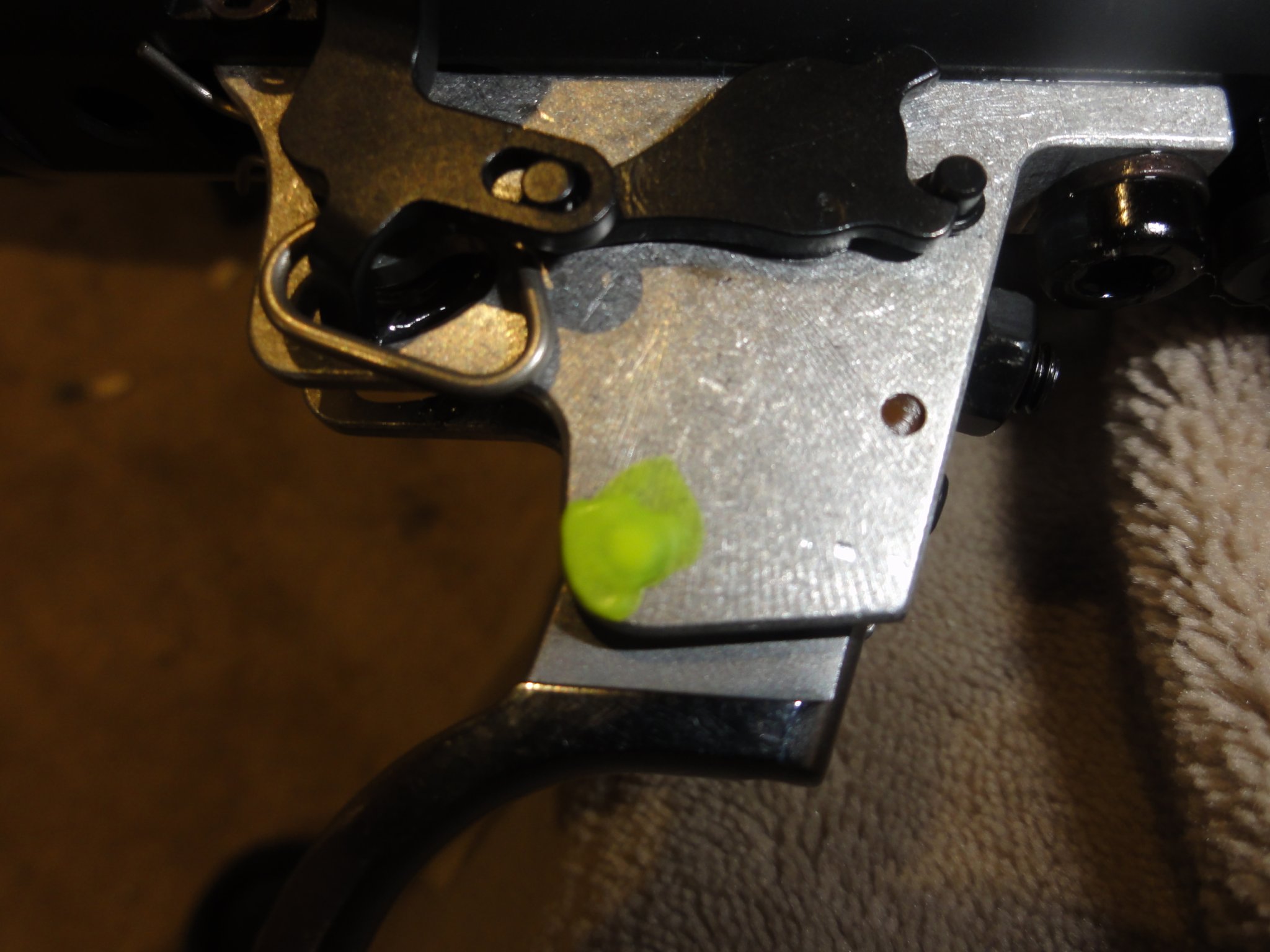

The Lithgow trigger can also be fitted with a sear adjustment screw similar to the Bergara mod you fellows came up with - The procedure is a little more complicated though. With this mod plus spring changes, the LA101 will come down to around a pound. I have mine set up the same as the 5096 triggers on my Anschutz 1710's.
Here in Aus, it's possible to build a Lithgow with after market barrel, all the tuning mods etc for roughly half the price of a Vudoo. I have a Gen 2 V22 & a 360 - Neither will perform any better than my LA101 build. BUT...The Vudoo is a class act as received - bolt on a scope and go out and play! If it came time to dispose of these rifles, the Vudoo would be hands down the easier rifle to sell for a decent return!!!
Reactions: Spartan67
There is a Bergara trigger mod post thread the last time I looked at it, everybody was of the mindset to simply use
a 4-40 set screw to function as a sear adjustment only. In the thread I said that I thought people were missing a great opportunity
to have an adjustable sear but also reduce the trigger pull weight. But they said "4-40 works perfect" I didn't think they ever
understood how a #6-32 long nose spring plunger would be any better. The spring plunger nose counter acts the majority of
the factory torsion spring load. McMaster Carr #8495A11 w/thread locker. Currently mine is breaking at 11 oz. and I have the next size
plunger in hand to try out as I find the time.
I tried very hard to explain that the nose of the body of the long nose spring plunger did the same thing the setscrew does to adjust the sear
but it's spring-loaded nose has the same effect as changing out the internal springs. In the case of the B14R that would be a big bonus because it's housing is riveted in seven places. To take advantage of the spring plunger you have to drill and tap for a #6-32 because they don't make a #4-40 plunger. The cost of my mod was $20.00 and 20 minutes of time. My B14R mod is completed with the trigger unit
in tact. The Bergara trigger has existing holes that need to be chased out and then tapped. I choose the #6-32 #4.5 plunger but
my go up to the #8-32 #7.3 plunger. They are only 5.00 each The spring plunger goes where the pin punch is pointing.
I put in another limiter in the second photo where the pin punch is located.
In the trigger area photo, the trigger limiter screw is mod is crystal clear. What I can't tell is if it is a set screw or spring plunger.

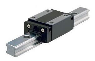

Jason has a large yellow block that appears to clamp his barrel. That looks like a perfect opportunity to add a lower guide block and
rail so that the entire barreled assembly recoils rearward independently of the stock. The rail would be mounted into the stock and the guide block could move down it's length by a small amount. Jasons yellow block could mount directly on top of the rail / block assembly.
It's total movement would be about .375" Only his bolt channel leads me to believe that he has yet to incorporate some
linier guide blocks.
The net effect would be a gun that recoiled straight reward while the bullet was zipping down the barrel. At some point the rifle

Allen, is Jasons gun a single shot at this point? Allen, can you confirm what type of gun Jason has? Single or repeater?
She's a beautiful gun!

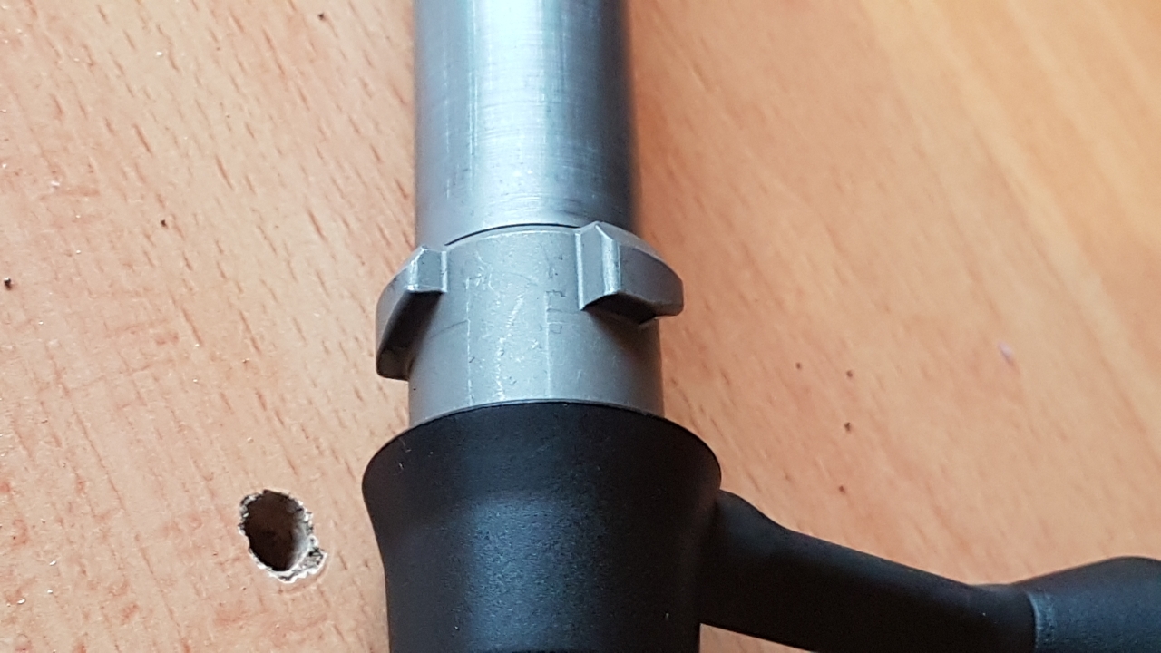

I’ve handled and fired a Lithgow.
I was impressed with the accuracy, ok with the ergonomics, but didn’t care for being able to lower the bolt handle when it was retracted.

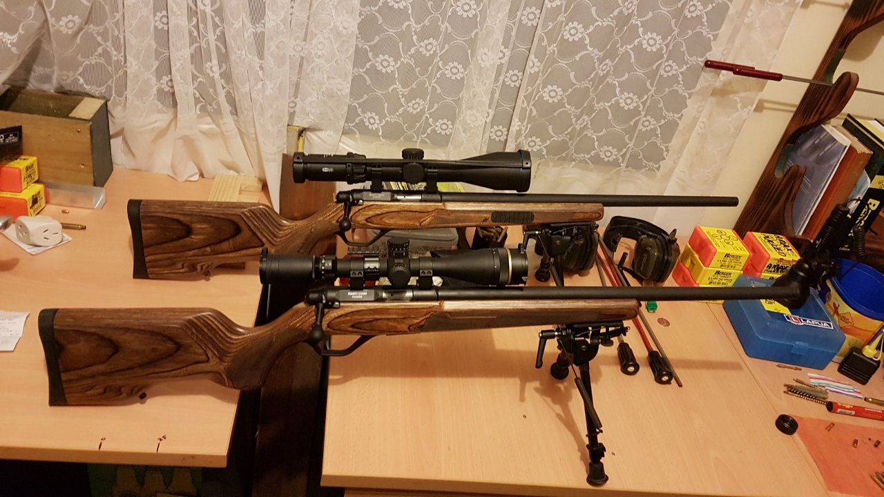

Well I have a pair of these both of them shoot exceptionally well the 17 hmr shoots around 1.2 in at 200 yards in Dead still conditions and with a 3 lug like lock up like this I'm not surprised
Not much comes out of my country in the shooting trade but by god they got this one right for your information the 17 HMR barrels are a cut barrel not hammer forged .

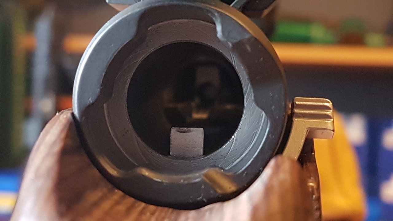

The bolt handle rotation when retracted is a "quirk" of these actions, I only discovered it the first time I shot my LA101 in a PRS match, nerves and all that of the first stage, I thought I must have "short stroked" the bolt. After the stage had completed and I figured out what I'd done, it was never a problem again. I did query Lithgow as to whether it was actually a "quirk of the design" and they confirmed that it was.
I've now fired several bricks through mine in both practise and competition and it never been a issue again. I have a couple of "older but nicer" 22's and the bolt lift and smoothness of the LA 101 is superior to all.
As I look at all of the factory machining on the underside of the receiver and there are some great starting points. It's flat receiver and the raised key-way feature.
The sear adjustment is a set screw.
That block is a barrel bedding block. I've seen the same set up used down here on BRNO & ANSCHUTZ rim fire builds.

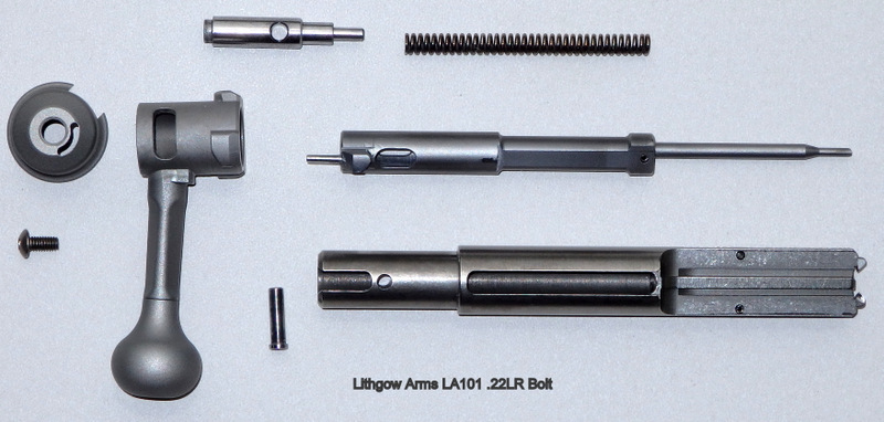

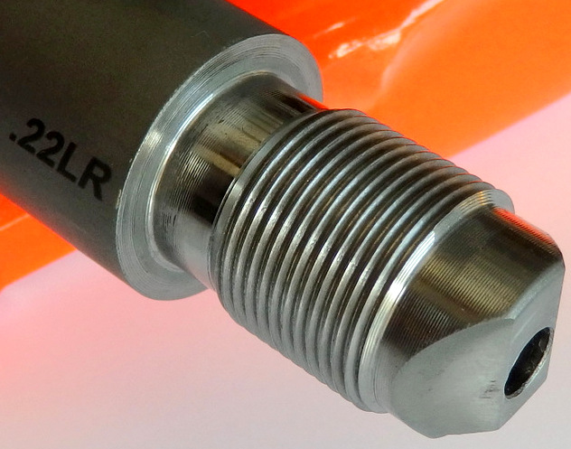

I've attached a couple of images of the Lithgow receiver and bolt. The Anschutz 1761 is another interesting 3 lug design and I like both.
All LA101's are repeaters but Lowey Products do market single shot adaptors for many makes. I'd have to confirm it with Jason but I'd bet that he has a purpose built loading tray in his rifle.
Allan.
LA101 Reciever.jpgLA101 Bolt.jpgLA101 Barrel Tenon.jpg1761 Receiver.jpgAnschutz 1761 Build.JPG

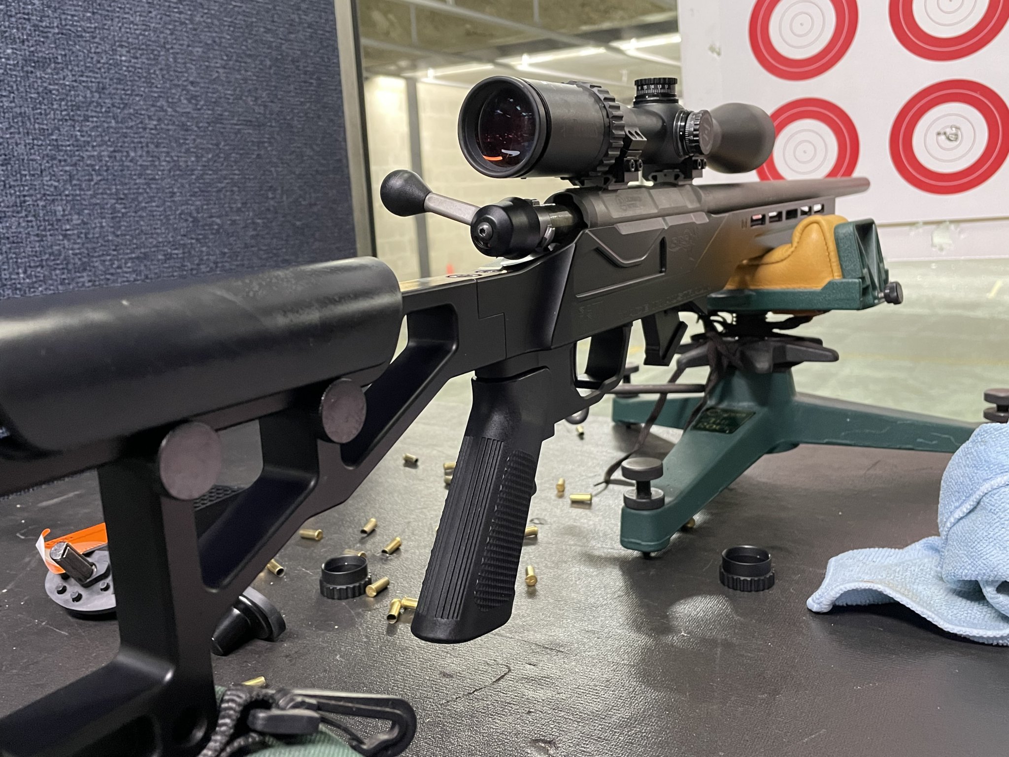

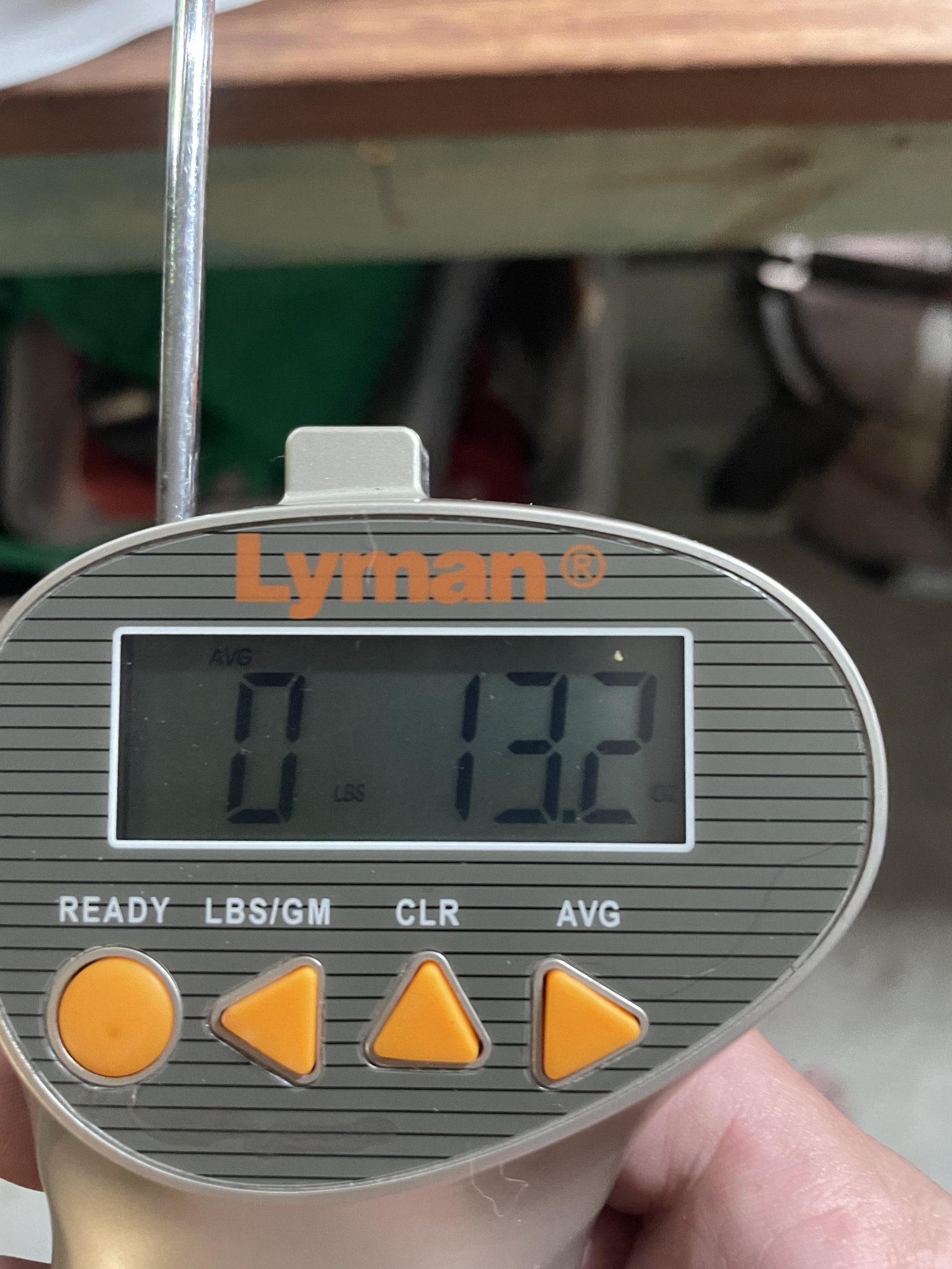

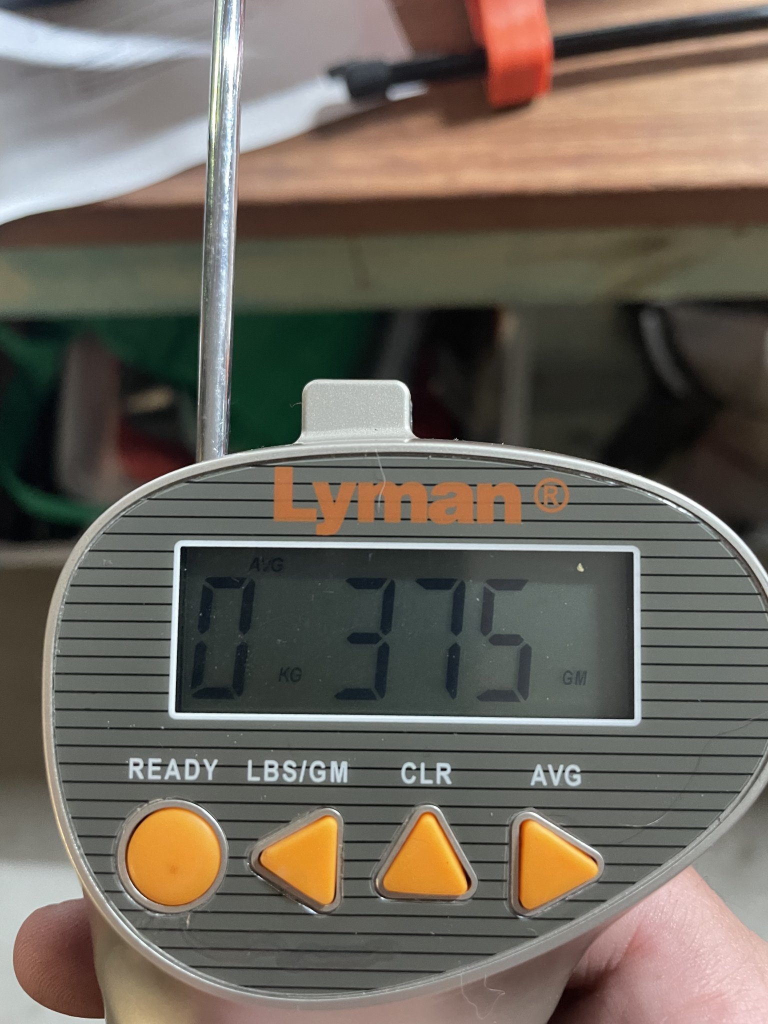

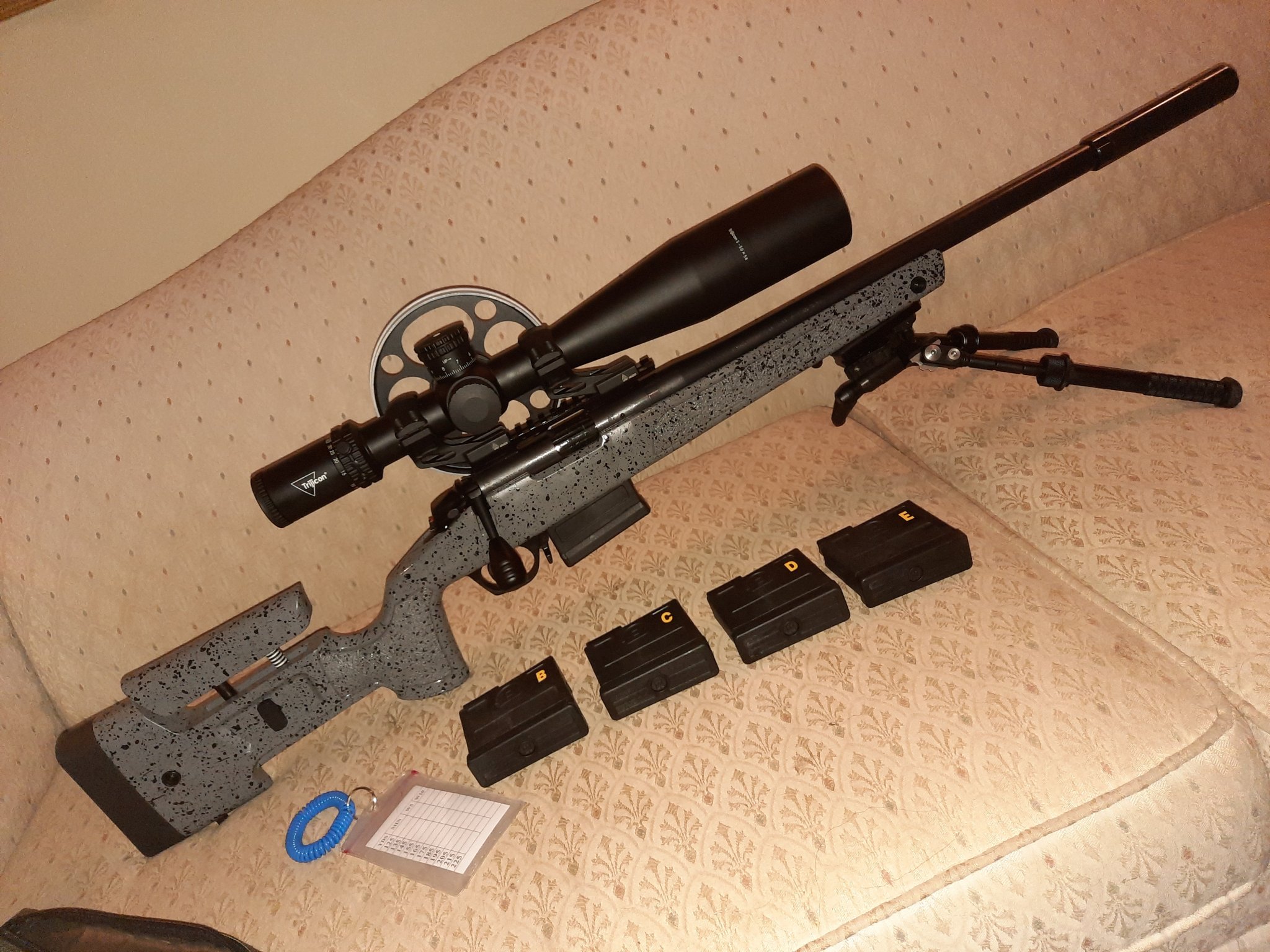

I am from Sydney Australia and I have owned my la101 since 2016. It is one of those left hand configs and I owned mine before Lithgowarms started threading the barrel. I have countless thousands of rounds through it at the farm or at the range. it will shoot quarter inch groups at 50 all day long!.
I recently purchased a chassis for it, The southern cross small arms TSP-X and took it for a spin last night and I have to say it has made me fall in love with it all over again.
a Few years ago I swapped out th3 springs and had A trigger job done by the “eBay guy” aussies will know him.. here are 5 shot average with the Lyman trigger gauge both in pounds and kg.
still getting use to the weight changes and figuring out what ammo it likes now as the chassis seems to have changed what it likes
