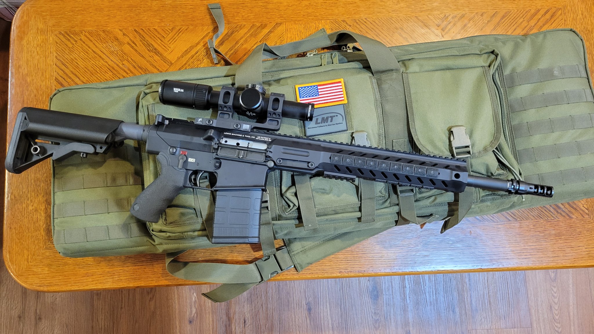

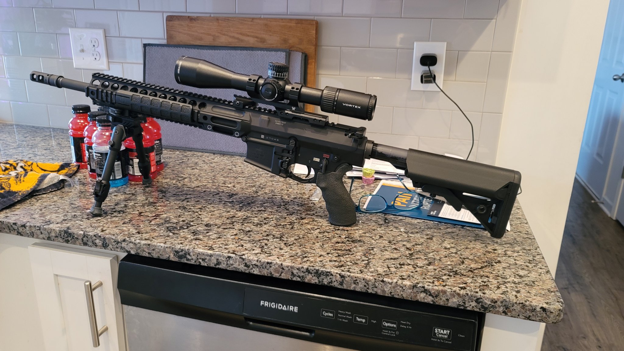

LMT .308 MWS
I love my mws
Just put an 18 ss 5r on it
S3g trigger
Socom brake
She is almost there..
I'd love to land a 6.5 barrel
But im not gonna pay what people are wanting!

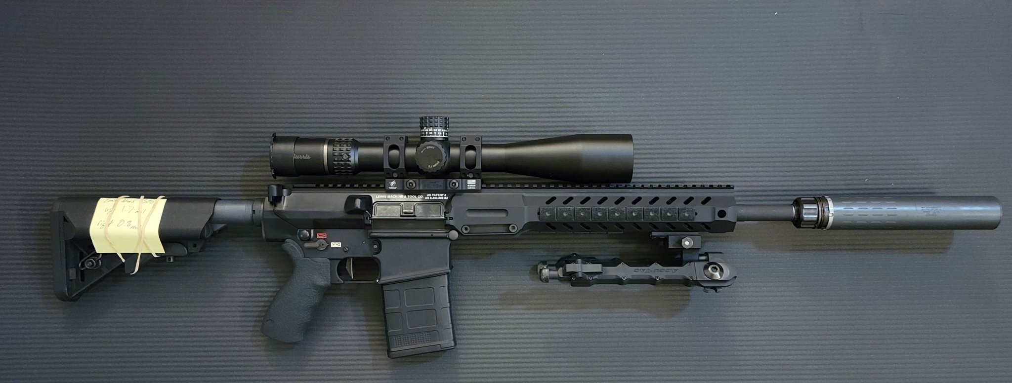

So, I've seen more than a few people on here running a Geissele Super 3gun triggers in their MWSs. Is there any reason why? I had a sd3g in a hog rifle and liked it for close stuff but found it a poor longer distance trigger compared to my SD-E or other more traditional good 2 stage triggers. I could not get consistent shots on running animals and would tend to jerk it under stress (obviously this is still my fault and not the system).
I am extremely happy with my MWS, just wanted to see if you or anyone else had a reason for this.
(rail placement is for a tripod)
Reactions: Snapper314
The s3g is the best for rapid engagement close quarter stuff
Faster than any other trigger I know of
But....long range not so great
Hard to get used to know when she breaks...
Cannot feel the first stage..lol
I'm building my rig for near and far...so to speak...
]I'm seriously thinking about trading out to a nice 2 stage
I just got my 18 5r on
So I'm gonna do some longer stuff hopefully this weekend and see how I do with the s3g with that

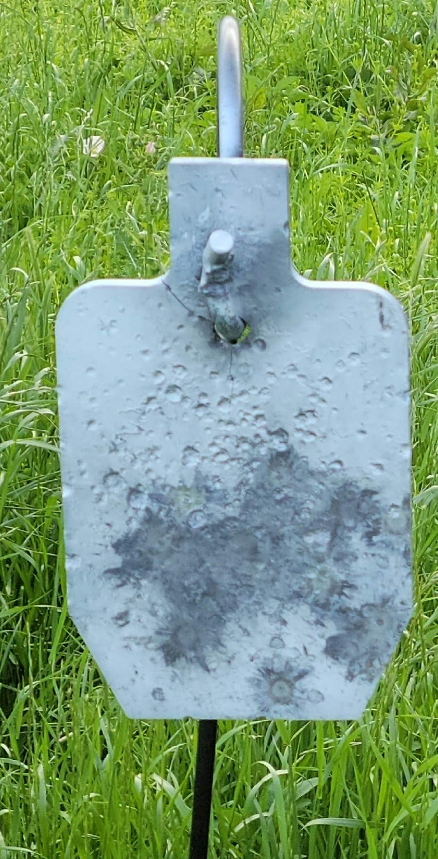

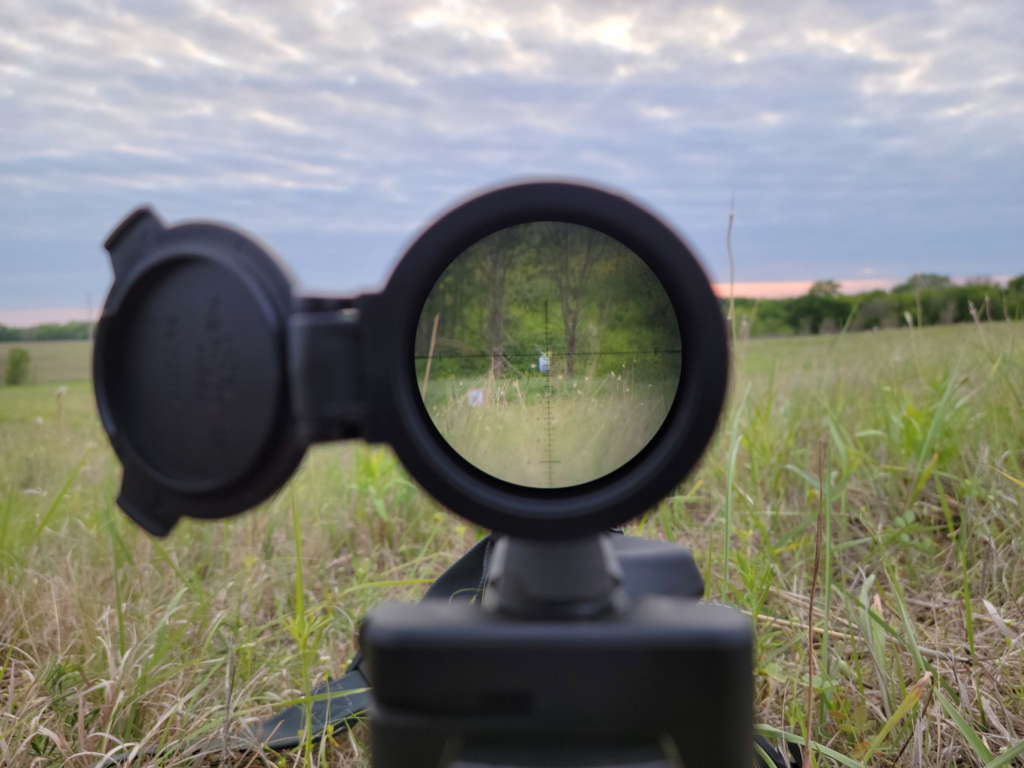

Let me know how that ends up working out for you when you make it out to shoot. I'm not sure how near "near" is but you have quite a bit of scope on there for close shooting. My experience was with the sd3g is that its a fantastic trigger but that was not ideal for shooting past 50 yards. If I could've made it fit in my B&T APC9 I think it would've been amazing there. (I'm not trying to dump on your build, btw)
I moved some other parts around and shot mine at 260m the other day and got some good results with sh*t Tula 150gr (because its 45 cents a piece in nearly unlimited stock near me). I think I'm probably going to end up putting a 3-15x ish optic onto this rifle eventually but will use the lpvo with the pinned 13.5 barrel I have now. The 20moa ADM mount+XTRii has like 1.5mm of clearance at the objective lense.

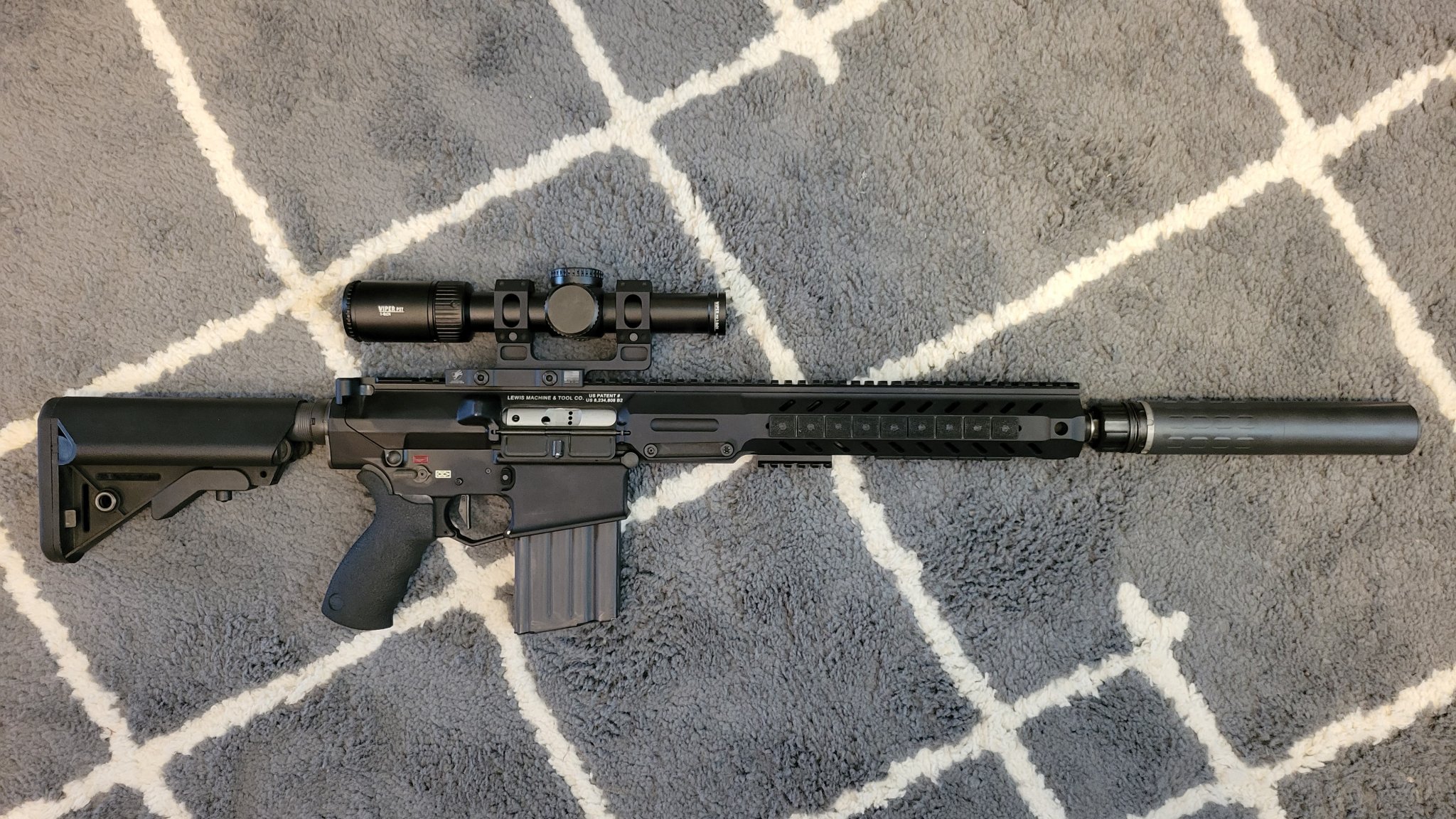

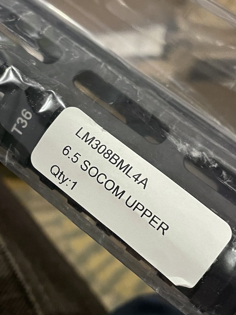

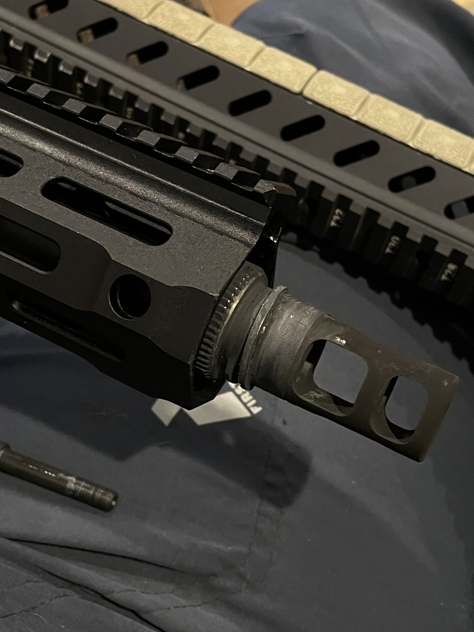

Snagged one of the 15.5" M-LOK stripped uppers off the LMT store and it just showed up today with a fancy sticker on it. Mocked it up with the 16" 308 barrel I have on hand. Definitely needs a spacer on the muzzle device if you have a QD-attach suppressor and want to do a 16 inch barrel - very tight fit.
View attachment 7605442View attachment 7605445
Very nice.
I was not sure if it would take a 16 inch barrel and run a can.
Could you take a closer look at the gap between the can and the rail, and also a close up of what mount and rail?
I am wondering if a a dead air and combo would work here. Part of me would like to cut back my 20 inch 6.5CM barrel to 16 and run this upper.

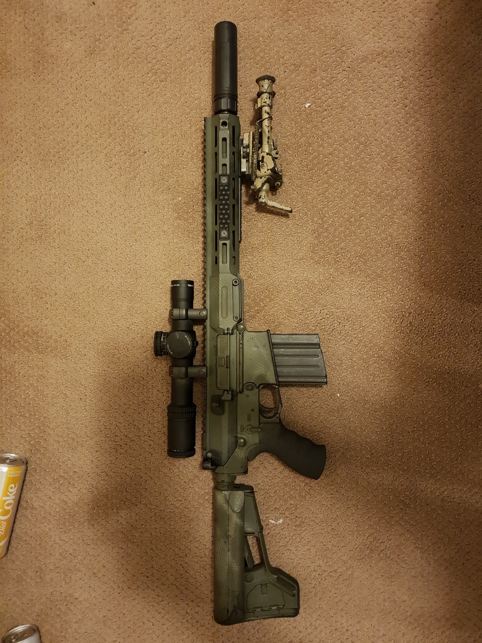

Something like my 13.5 308,
Very nice.
If you’re cutting, I’d just go 16.5. With a 16 you definitely would need a spacer behind the muzzle device. Here it is without one:

It's fairly tight. There's space but it takes some wiggling to get it out if there are mlok sections installed in front of it
See above post where my AAC muzzle device is recessed inside the rail. You need a good 1/4-3/8 of shims to get it out far enough for that can. Direct thread probably wouldn't be as bad.
I was just trying to decide if I wanted a 15.5” MPR upper. This is a real bummer to see. Really wish they would’ve made this 15”. Damn
So the threads started inside the handguard on your 16”?
God damn... that sucks. Not well thought out. Not willing to shim that much and don’t want to shave the rail. 12.5” it is I guess
Well it was clearly made for a 6.5 system with a longer than 16" barrel, so I wouldn't say it wasn't well thought out. Just not quite matching whatever you have in mind for a build.
I’d agree with you if the MRP wasn’t a switch barrel platform for which they make the very popular size 16” barrel...

It was also an easy fix for me to mill off a fraction of an inch from the front and rock on 😎

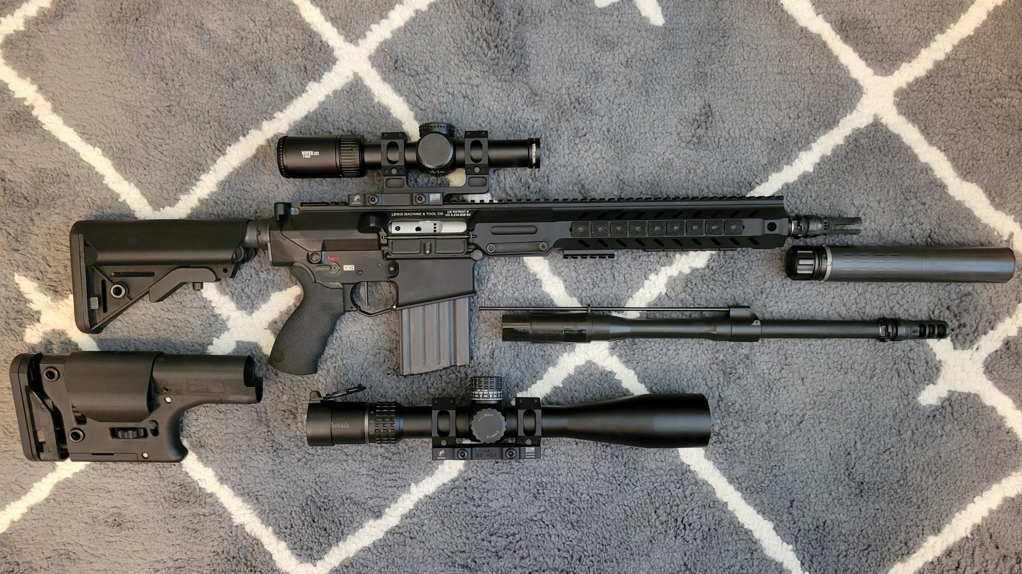

I just purchased a LMT Mars H with a 13.5" barrel it has the Surefire Warcomp muzzle device pinned and welded, and LAW Folder. I'd like to see some pics of other 13.5 barreled LMT's with or without cans and scopes. Thinking about a vortex 1-10 for scope? Any issues with throwing a 7.62 Socom can on this setup, anything I should watch for, overgassing?

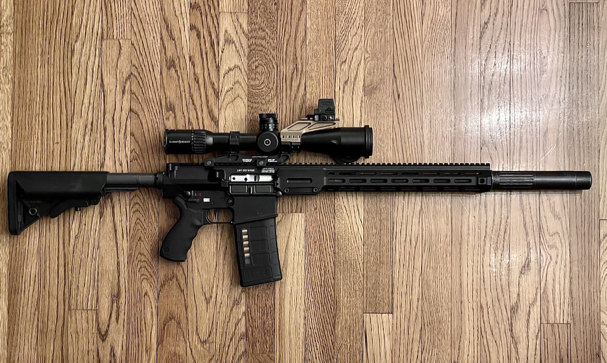

The SureFire SOCOM is an excellent choice for LMT.
I run one on my MWS. Smooth and reliable. Gun is stone stock otherwise. No heavy buffer, adjustable bolt carrier, or other fuckery.

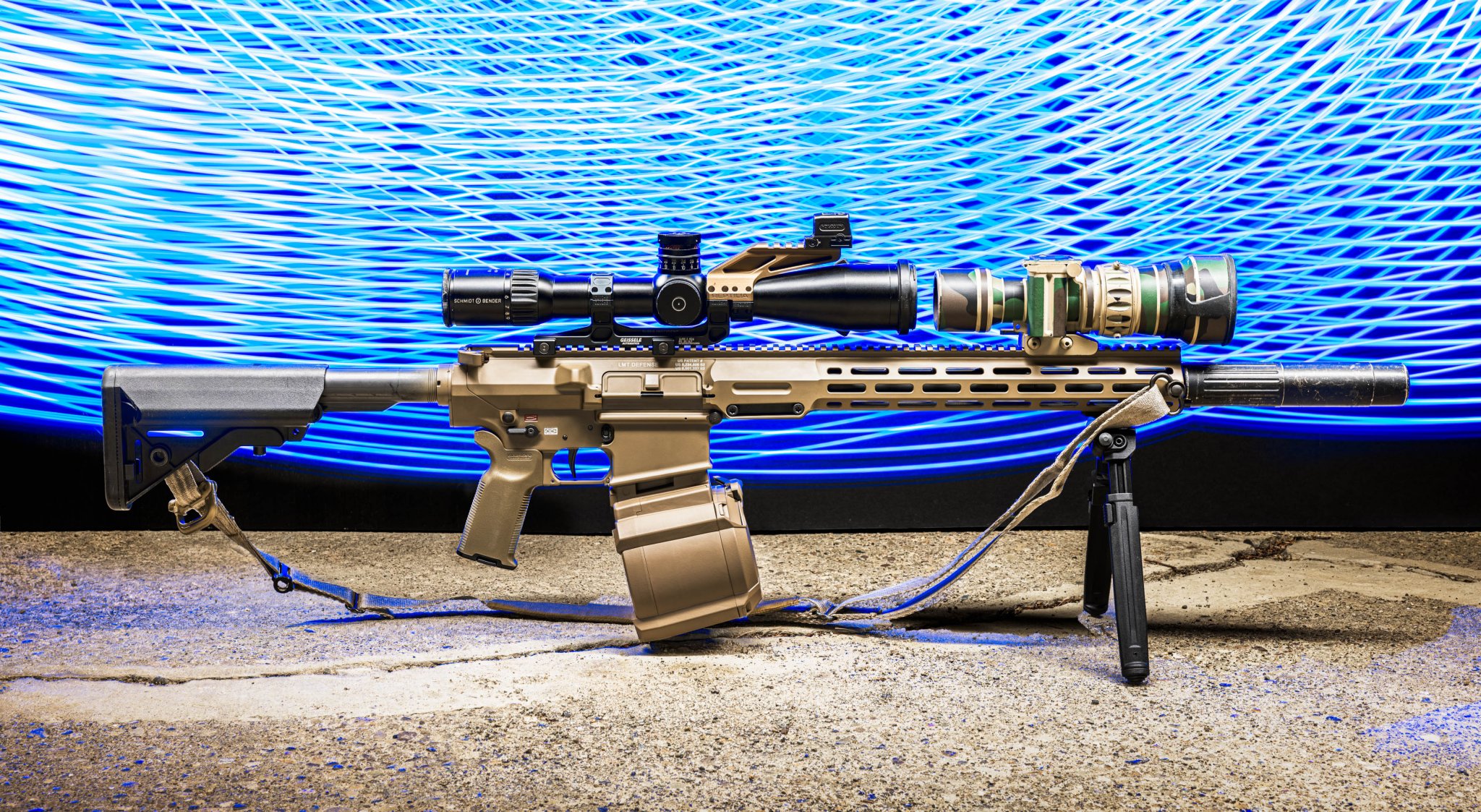

The Dead Air Sandman Series works really well with the 13.5 Barrel. My Gem-tech GMT-300WM was violently over gassing the system. Honestly, I have zero gas issues while running the K can
