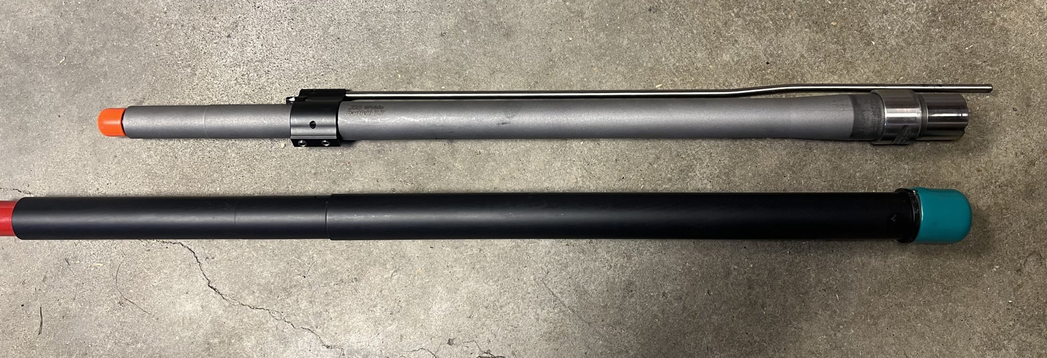

Word of caution: don’t try to get a heavy profile barrel converted. The barrel extension has to be pressed into the barrel with some profile limitations. I tried to have a CLE Varmint profile (1” straight for the most part) and it would have had to be turned down near the chamber to fit the extension. An SPR profile worked fine though.
For reference, top is SPR contour and fine for conversion. Bottom is CLE Varmint contour and no bueno for conversion.

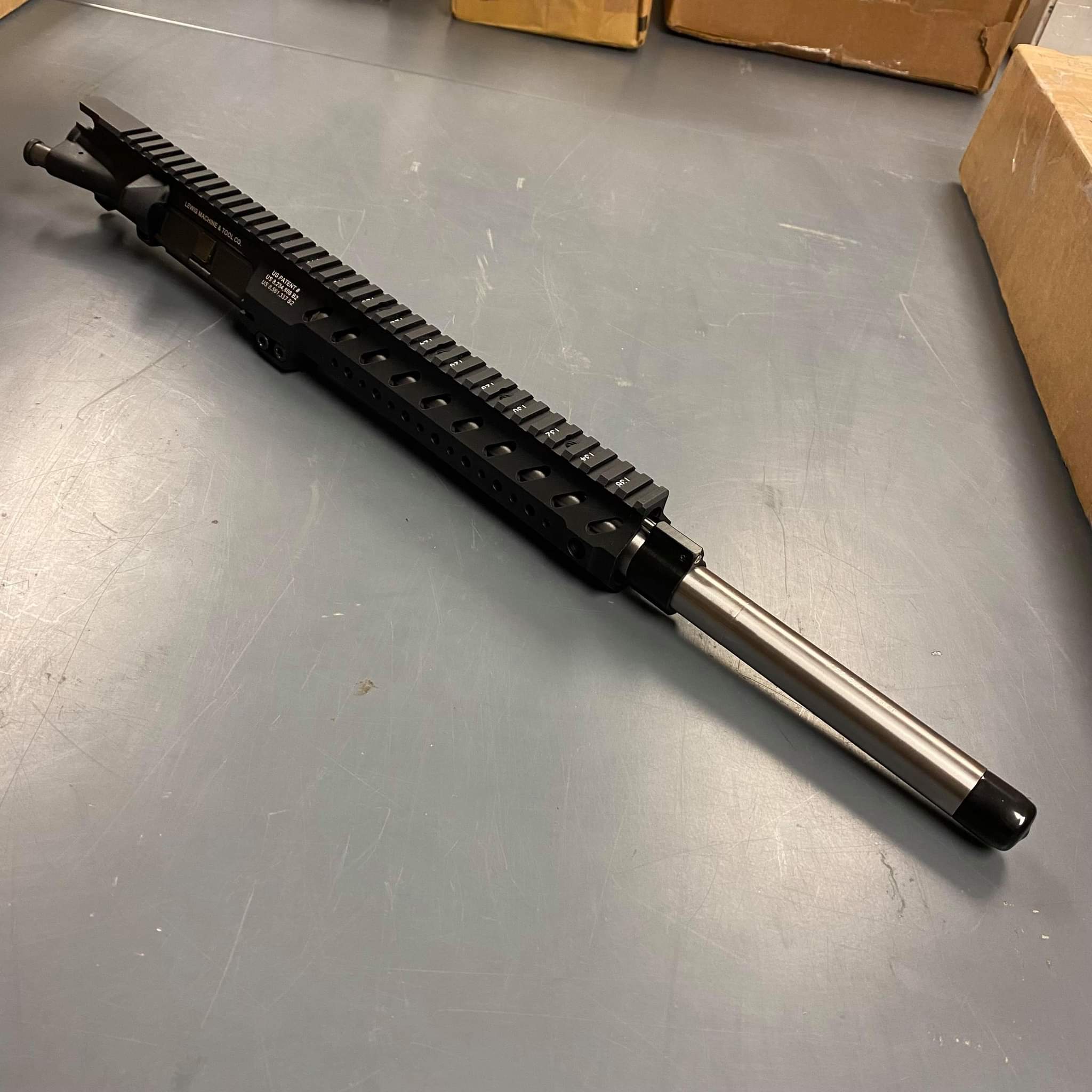

Had D. Wilson convert a 450 barrel for my MRP. Ohio is a straight walled cartridge state for deer. It runs flawlessly and shoots as well as I can run a semi auto. Turnaround was super fast.

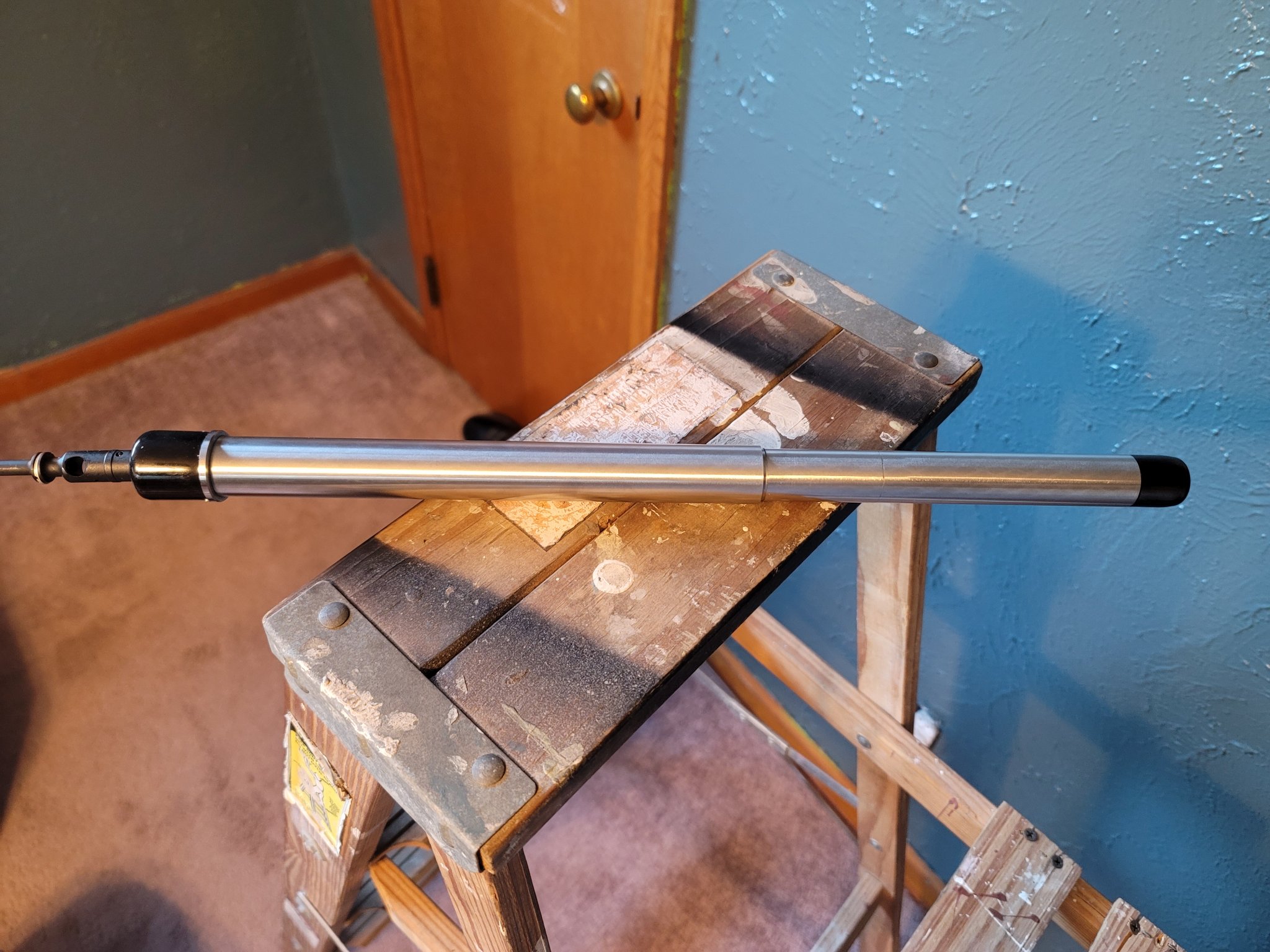

A question for you guys who had sent barrel to D Wilson- what does his conversion involved? Is it limited to the "clamped" portion of the barrel, or does it also include gas block/tube installation? How's the gas tube fixed in the rear end, similar to LMT factory barrel with a metal plate (brace?) to fixate the gas tube?
No brace for the gas tube, so it’s a little different than the factory setup from my experience. It still shoots great so that difference doesn’t effect accuracy or reliability. The only potential issue I could see is if you’re regularly swapping barrels - you’d just have to be a little more gentle when seating it.
