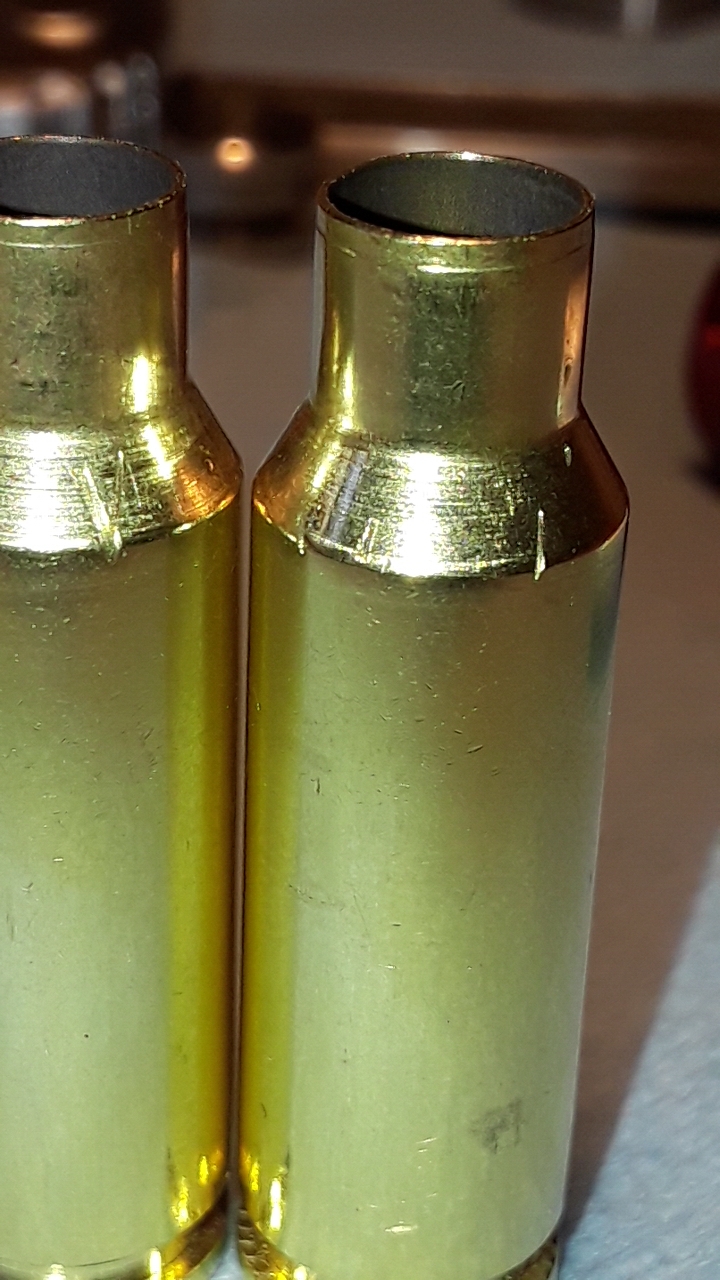

I installed a new LMT 20” 6.5mm Creedmoor barrel on my LMT MWS and took it out to the range today. No malfunctions, but I noticed groves being cut in the case necks. These are appearing on the extractor side of the case. I am guessing these are coming from the inside of the barrel extension on the extractor side. The bolt has duel extractors and I believe the extracted fired cases are being pulled hard against the inside of the barrel extension and there must be sharp edges cutting into the necks. Has anyone seen this before? I am wondering if the cases are not suitable for reloading. I have not noticed this on cases ejected from my 308 MWS.
NOTE: I did cycle several unfired cartridges through the rifle. No marks were left. On the bullets or cases.
Ammo: Hornady American Gunner 6.5 Creedmoor 140 gr HPBT
I measured ten random cases with a RCBS Case Gauge
Measurements Before Firing
Four at +0.001
Three at 0.000
One at -0.001
Two at -0.002
Three at -0.003
Measurements After Firing
Four at +0.005
Four at +0.007
Two at +0.008
I don’t have a No Go gauge for 6.5 mm Creedmoor and I am wondering if +0.007 and above is heading in the No Go area.

Sharp feed ramps on mine looked like that. Would have been able to gut a pig with them and still have more polishing to do.
100 rounds of ruined brass.
Hand feed one in and fire, see what you get. Maybe the same barrel extension vendor I got on my 6.5g.
  • Wow
Reactions: Fire4EffectCA
Is it possible polish the interior edges in the barrel extention?
Those marks are from the locking lugs on the barrel extension. When the gases propel the BCG rearward and rips the case from the chamber the force of your extractor scraping the case across the barrel extension lugs right before it slings it out the ejection port.
You can polish them and it will help, I always ask for this to be done when I have a new barrel spun up, the design of the bolt also has some influence on this phenomenon as well. It's honestly not a big deal, large frame AR are just harder on brass.
223 and 6 arc... Every AR I've owned has done it. 223, grendel, 308, 6.5 cm... Can ID what weapon fired range pick up brass from it.
I have brass bagged identifying which rifles it was fired from. Both of the SR-25's I have shot did not have the marks. I did find some brass from my 308 MWS and it had the marks, but they were very small and light. It was difficult to find any 223 brass with the marks, but the ones I did find were very small and light.
Sounds like I need to find a good way to polish the backside of the lugs in the barrel extension. I do have a new 308 MWS barrel and the backside of the lugs inside that barrel extension feel smooth. I will compare to the 6.5 mm creedmoor barrel extension tomorrow.
My bad, these marks are on the shoulder and nearly 100% sure its the razor sharp feed ramp edges.
Going to pull the damn barrel to polish them more. Damn it.

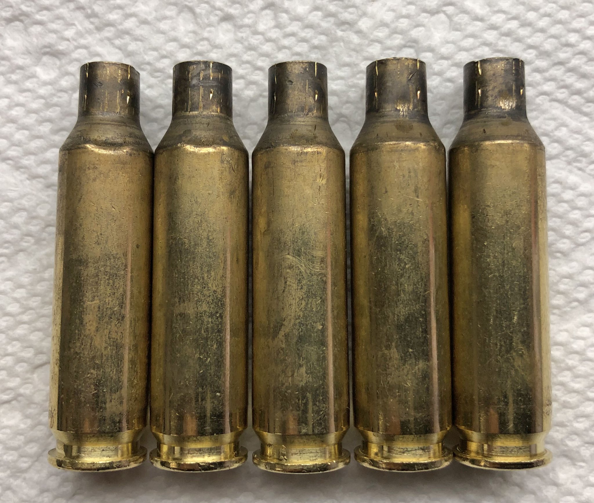

My Larue OBR circa 2010 does not do that.... But it doesn’t really look that bad on those cases.
Those can still be resized and used... i’ll be a little more concerned about the denting of the cases

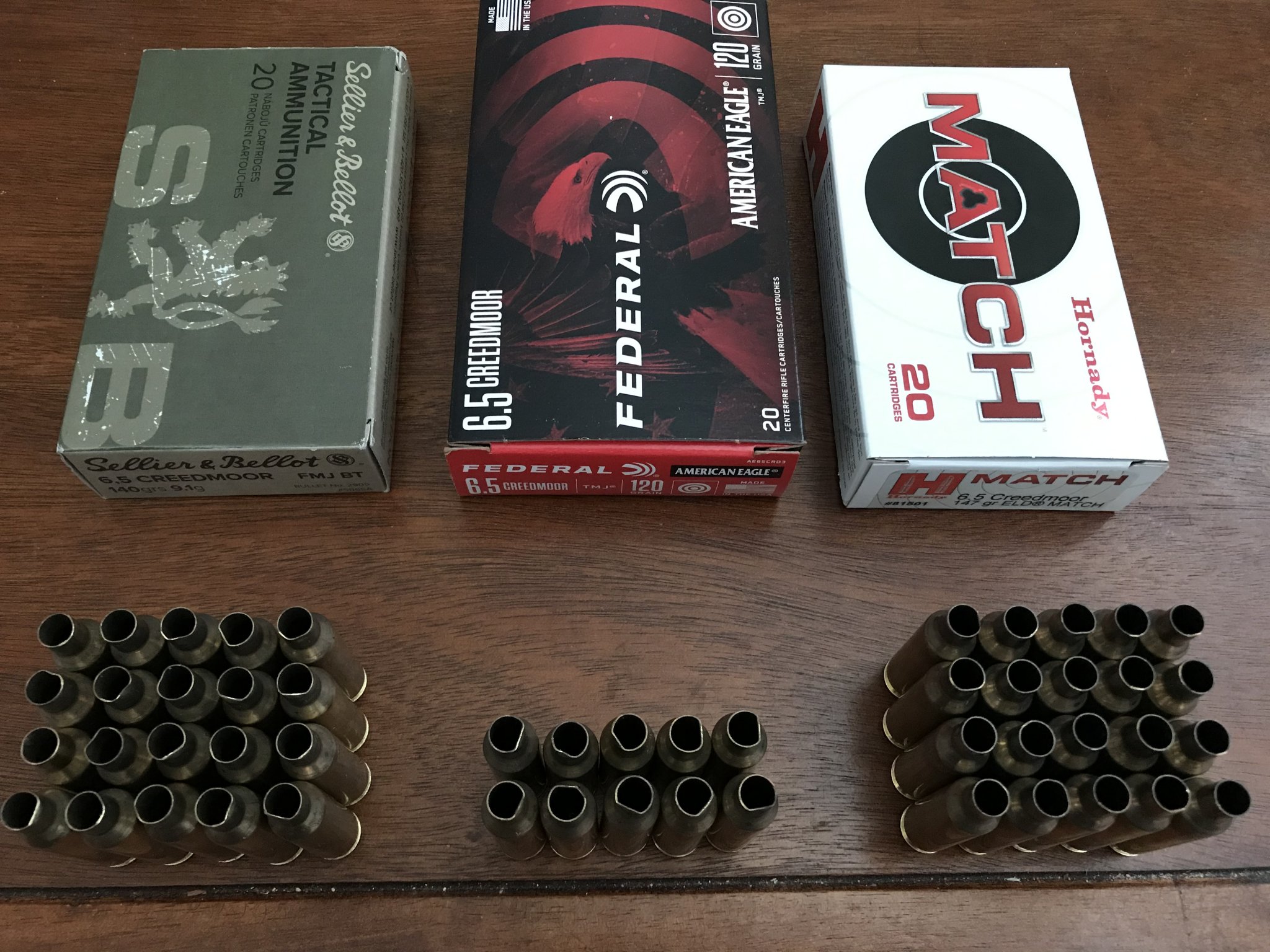

Every one of the 6.5 rounds I fired looked like that to varying degrees, a lot much worse, most were dented as well. This is from one of the Black Friday 22" 6.5 barrels, with three different loads
My dents are further back, but I believe the dents are from the case deflector on the upper receiver too. I am hearing others are using adhesive backed velcro to reduce this. I wonder if reducing the spring tension on the duel ejectors would help. This rifle has a stock H3 buffer installed.

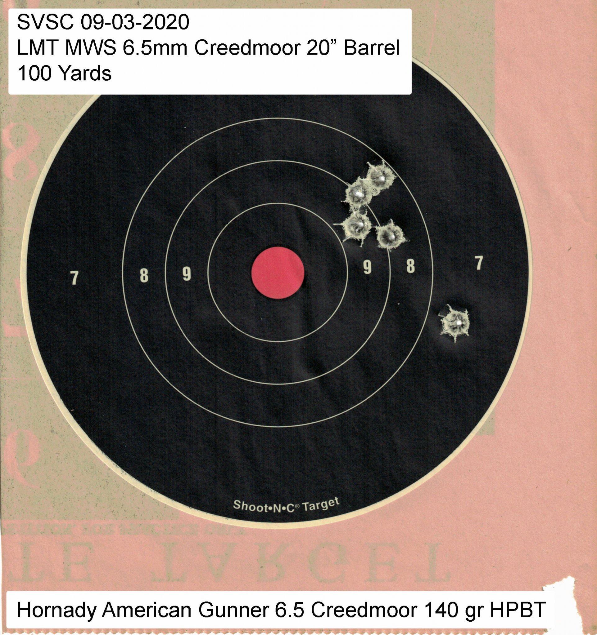

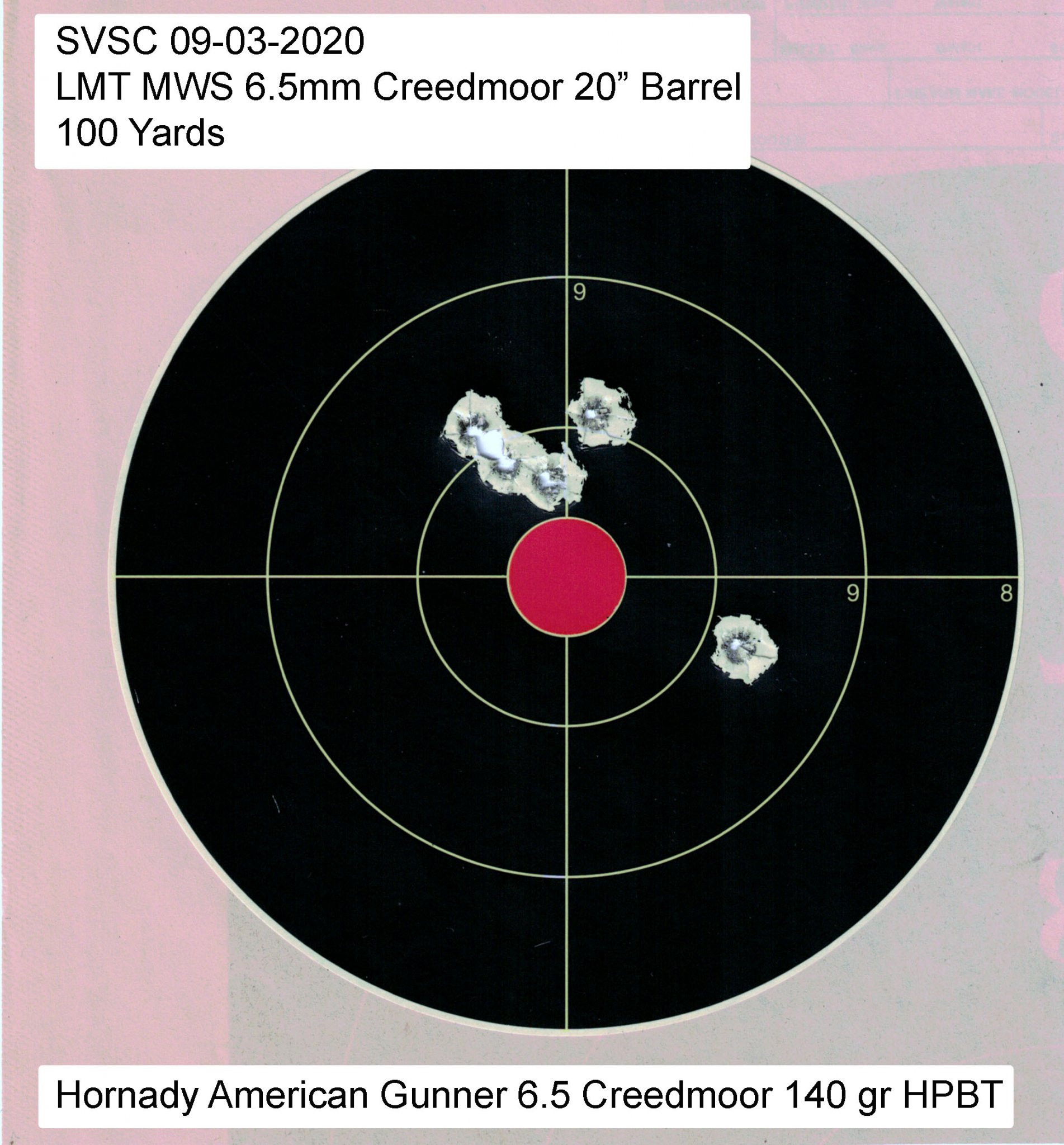

I keep getting three of four tight rounds and then I would throw one or two wide. The powder in the ammo I was shooting was really dirty. The bolt and carrier were caked with carbon. I have never seen so much build up after only 50 rounds. The bolt and carrier also had what looked like copper oxide mixed in with the carbon deposits. I had cleaned the rifle thoroughly before going to the range for the first time and it was spotless before shooting.

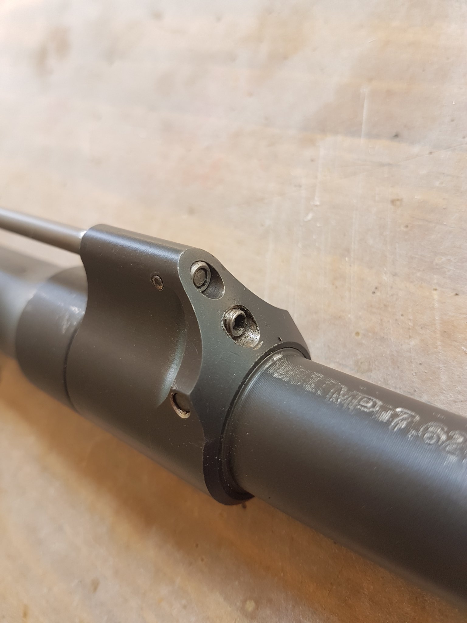

This is what i did to fix overgassing on my 308 barrel.
Remove the gas block (you may need to apply some heat), then drill and tap it for a long grub screw. Now it's adjustable, problem solved.
Adjustable gas blocks won't work as MWS gas ports are drilled at an angle.
