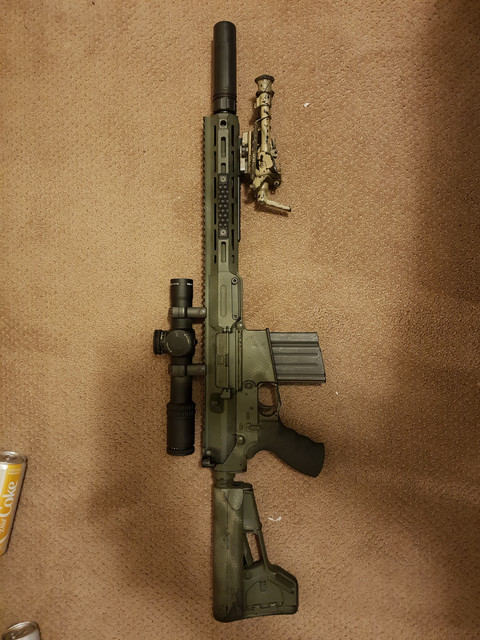

Something to keep in mind if you decide to grab an MWS and run it suppressed is that you really need to think about what can you are going to mount on the rifle. If you grab a modern silencer that was designed to have minimal back pressure, you should not have any issues running or at most, a change to a heavier buffer should be all that's needed.
Ive had a good number of 308 gas guns and currently have an SR25 as well as a Scar, and honestly, I think that i enjoy shooting the LMT the most as its the most flexible of the 3 and can be set as the shooter wants. I like being able to run a 13.5, 308 and less than 2 minutes later, swap out the barrel and be off to the races. As a stand alone, 308, The SR25 is lighter and shoots smoother but will never be a 6.5 without dropping thousands on a spare upper. The scar is light and utilitarian.
This silencer combo works great
LMT's are great guns if you know what you are getting into. They are Mil guns that are incredibly reliable and run a little harder than you average 308 AR. They are also a little heavier than your average 308 AR but unless you are patrolling with it at the ready or humping through the mountains hunting some retarded goat or something, that extra half a pound to a pound is not really going to make or break anything.
This silencer combo works great View attachment 7934383
Is that the 13.5 inch barrel? And what mags are those?
I have an LM8 with .308 and 6.5 creed barrels. Awesome rifle and exceptionally accurate. The stainless steel barrels are a bit more accurate than their chrome lined ones but either will outshoot most users. The LM8 uppers are probably a little heavier than the mlok ones but thats really the only difference. Mounting a silencer can be problematic. From what I've been able to gather, the brits use surefire cans on their L129s and don't have to make any modifications to get them to run. I've run a couple form 1 cans I built on mine and they both have very high backpressure. To get the rifle to run properly, I had to get a buffer from heavybuffers.com and swap it out. Since then I've had no issues cycling with or without the can. Another option you could use is to get a gas tube from black river tactical. They make ones specifically for LMT barrels since the gas tubes are straight due to the barrel switch system. This might be a better option to cut back on gas to the face.

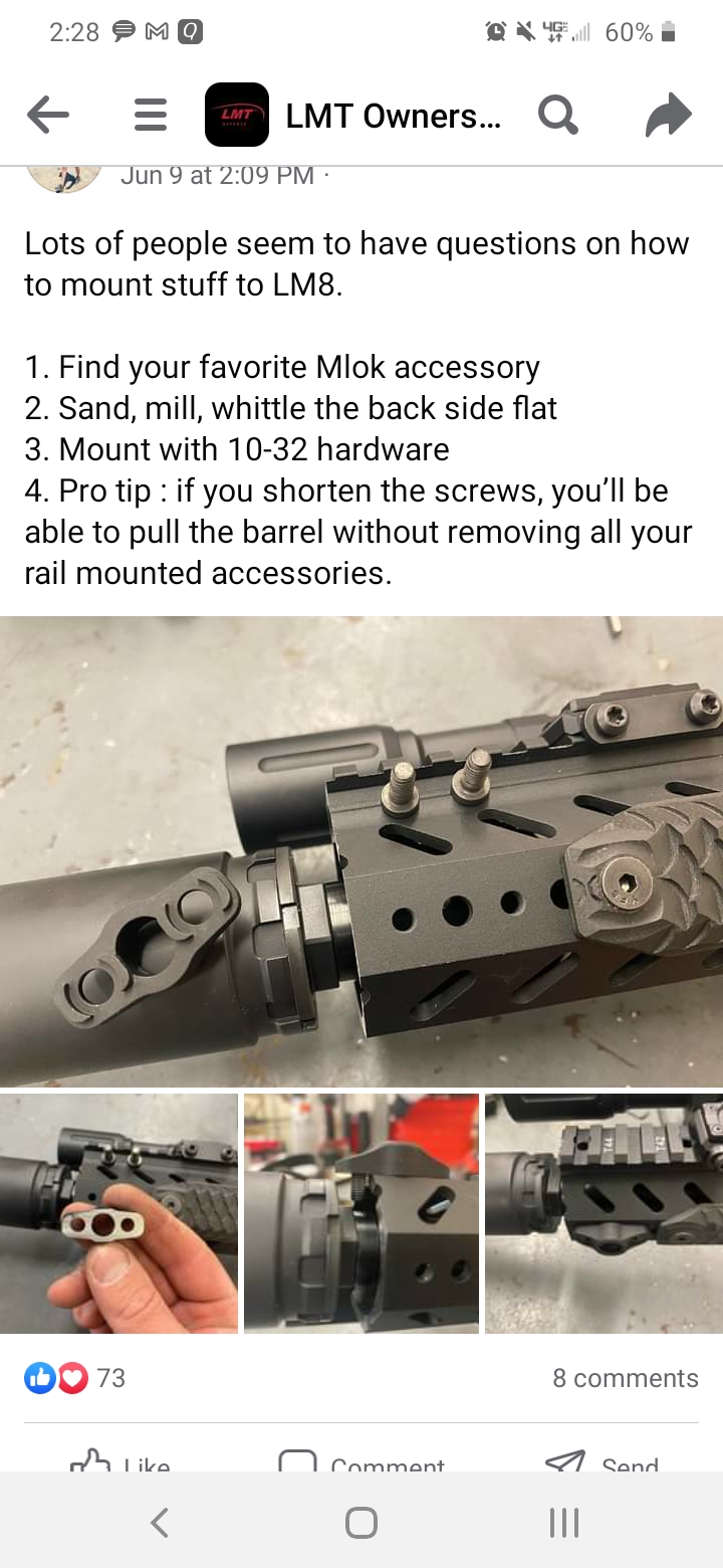

What length screws are you using to get the barrel to come out and do you know how they compare to the LMT recommended length for thread engagement? To be honest this seems like a better way to mount than MLOK, I hate how everything needs to come off for the barrel to come out.
Agreed. I have not tried it myself yet. But will post once i do.
I have trimmed screws for other things in the past, usually requires some clean up.
I guess for the torque levels needed for accessories, steel on aluminum is not a huge concern.
