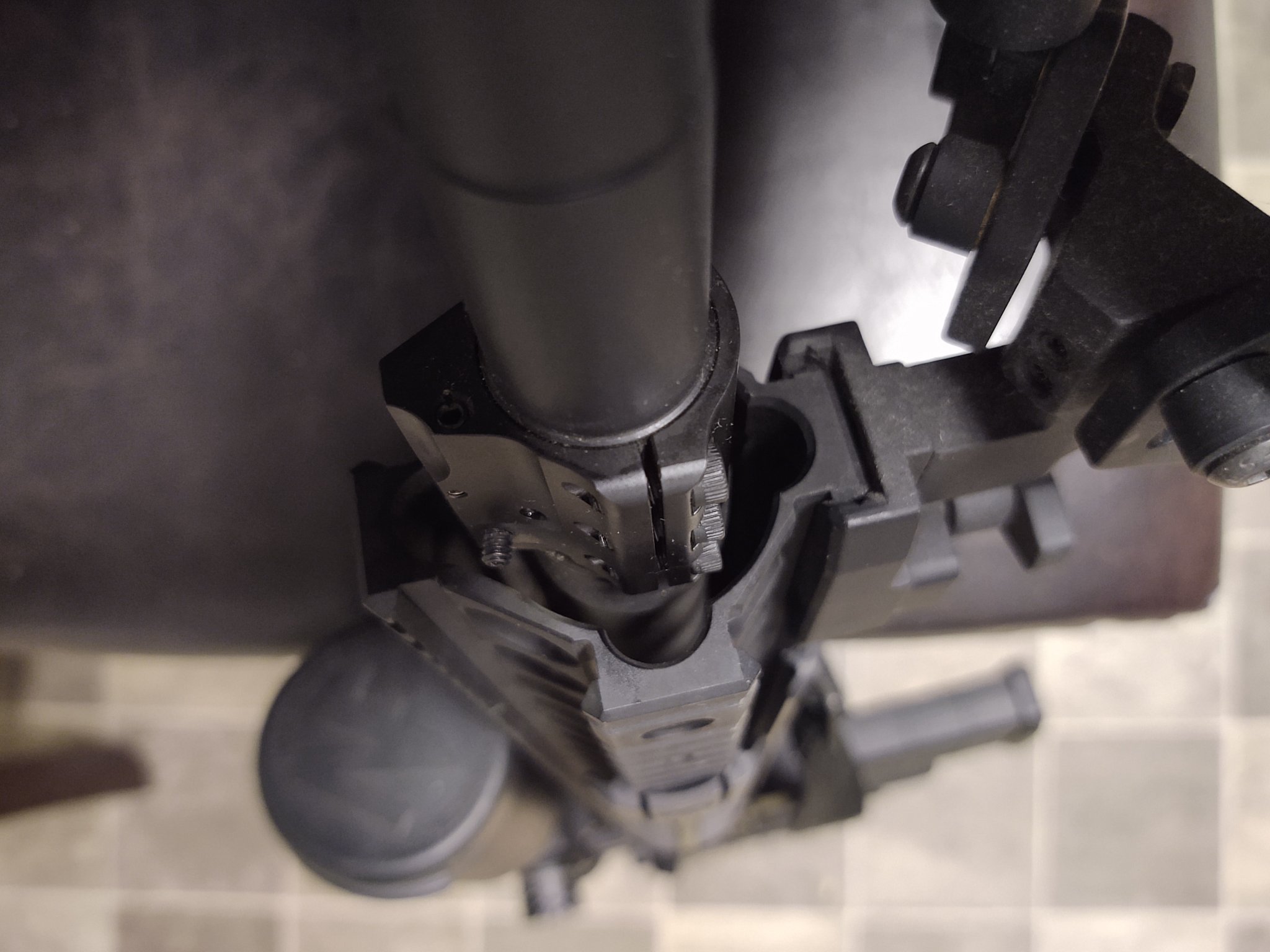

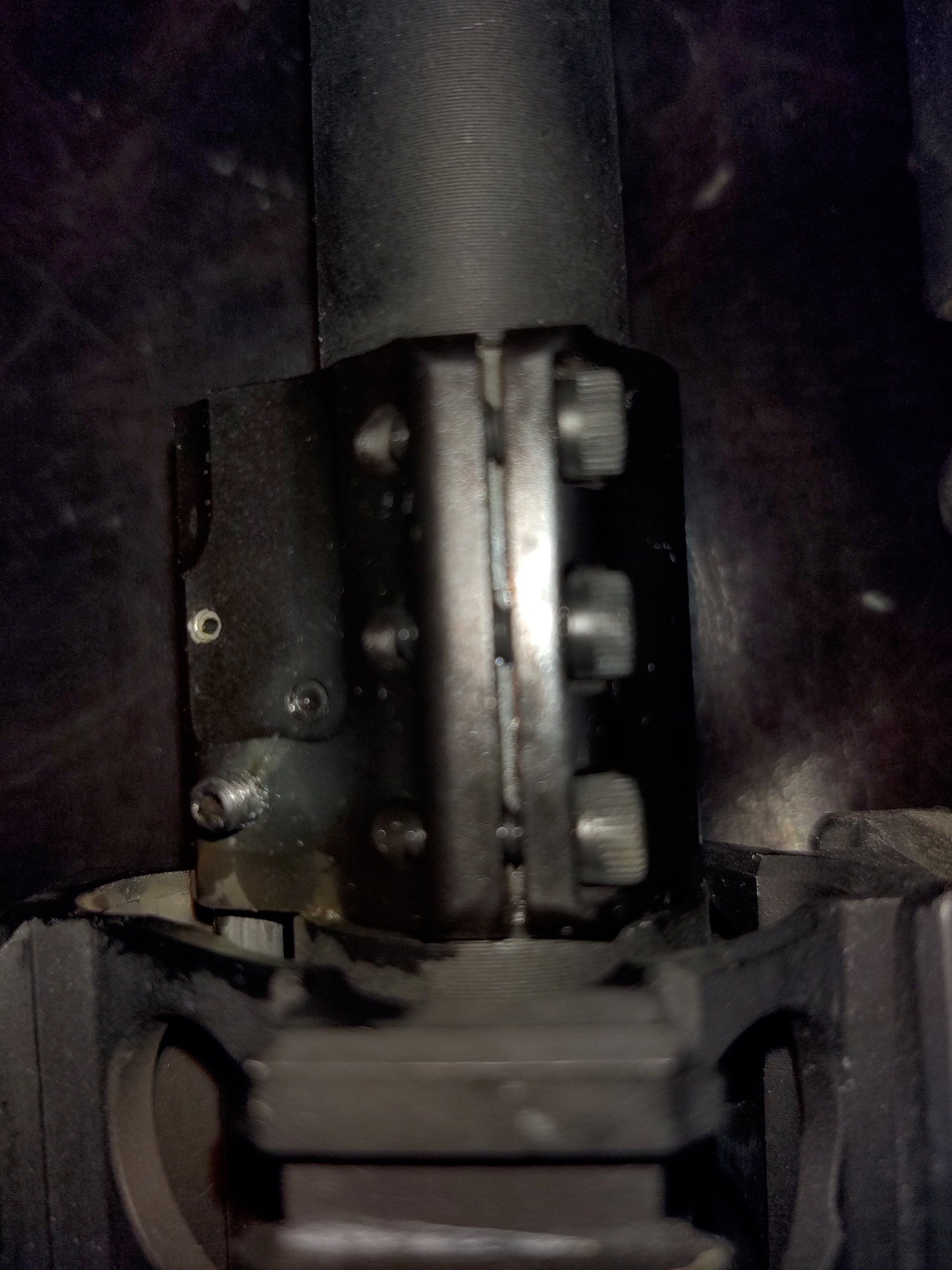

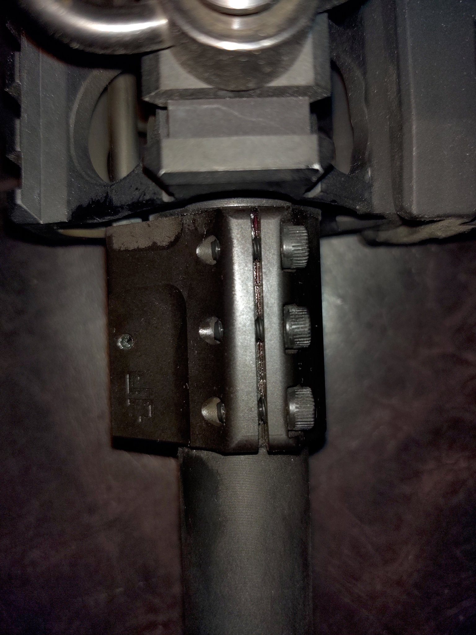

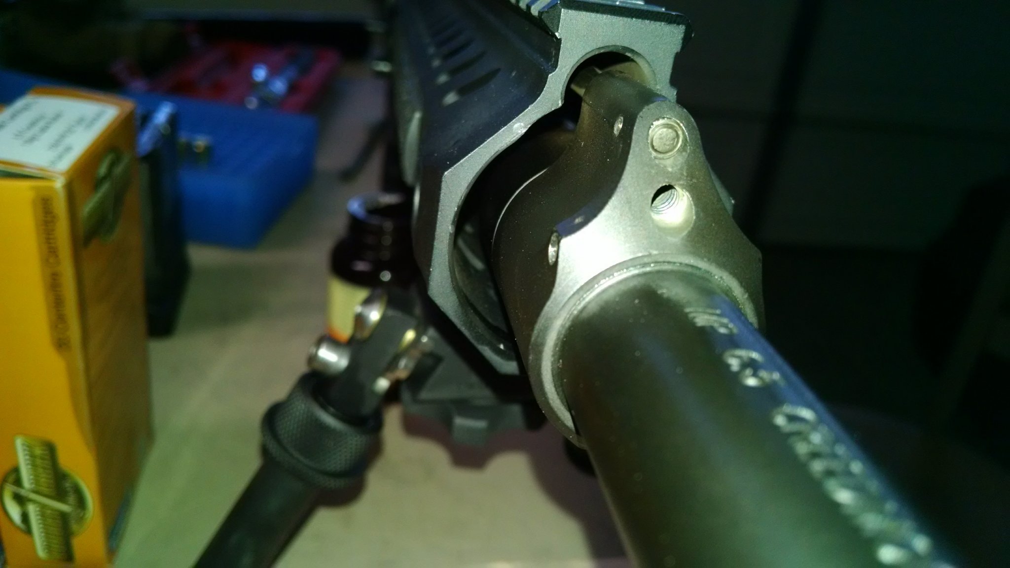

Slash xh buffer should help. Someone here drilled and tapped their factory LMT gas block and made it adjustable.
From my understanding aftermarket blocks won't fit right due to oddball port spacing in relation to the shoulder because of lmt's angled port.
The best solution for me has been having Marvin Pitts sleeve standard barrels to fit my MRP and mws rifles.

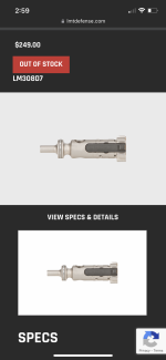

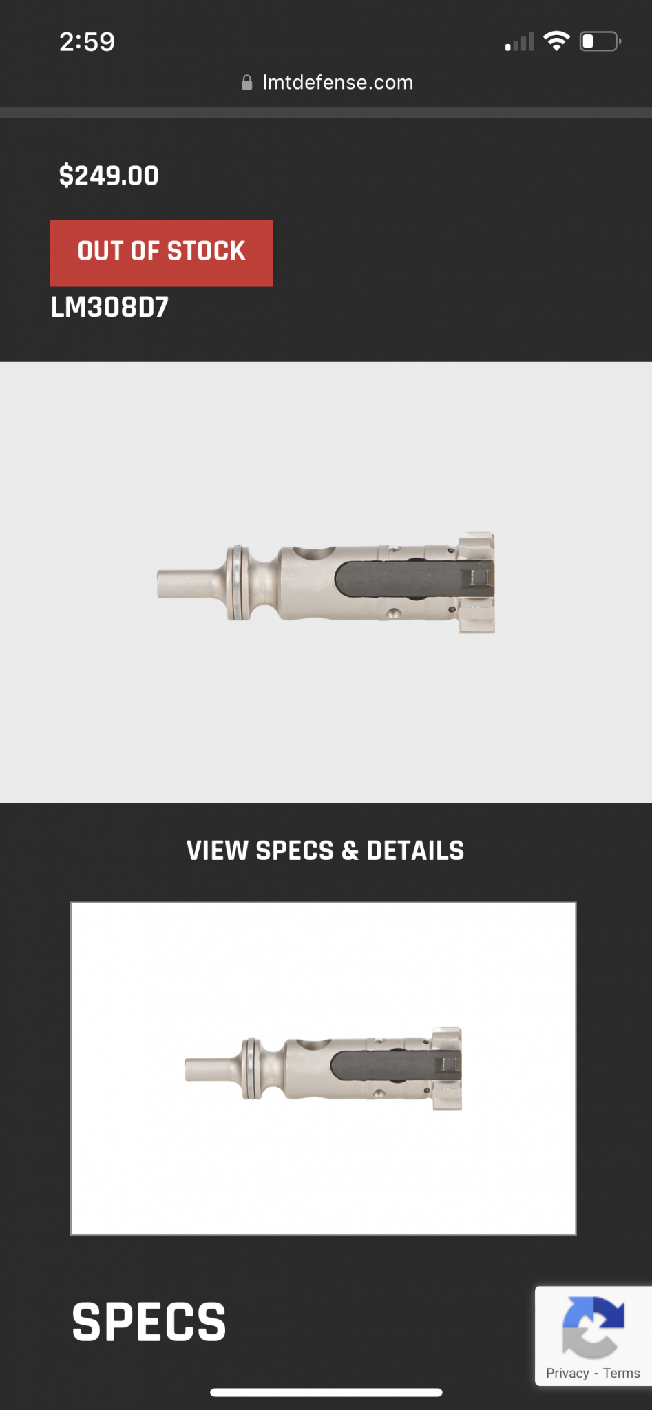

It’s night and day difference with the dual ejector bolt. I want to say mine went from kind of erratic forward ejection to throwing cases 15-30ft straight to 3 o’clock.
I did have some success with the old bolt by installing a jp extractor and changing the spring/o-ring/buffer.

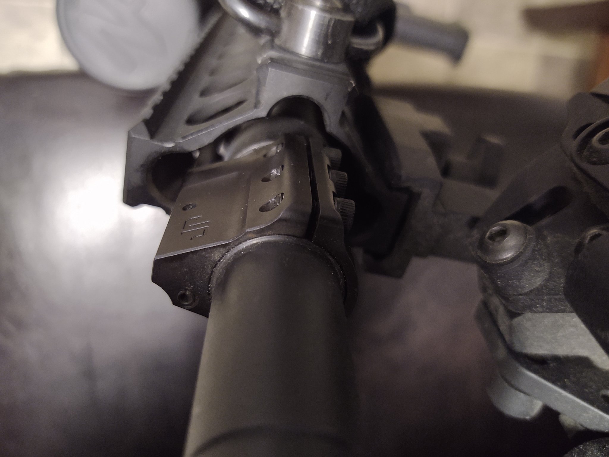

Ouch
