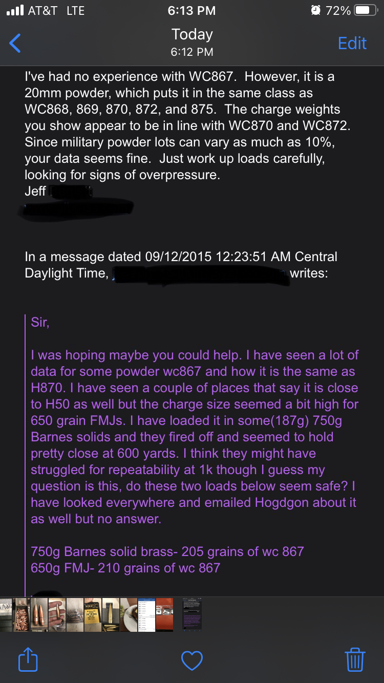

Some odd years ago, I used this powder for 50BMG. Attached is an email I had with a guy who did 50 reloading and owned a reputable shop dealing with 50BMG stuff.
At 205gn for the 750's it is right in line with the data I found for 8700 powder.
Any ideas on 800's?
Sorry never went above 750. I thought there was a thread on some heavyset weight 50BMG on here. I sold my 50 a while back but will look and see what if any data I have laying around.
Any ideas on 800's?
My manual only lists 2 loads, the other one is 642gr so not what you're looking for. I will say after using these powders for quite a few years that they vary quite a bit from lot to lot since they are pull down powders so back off 10% or so and work up.
