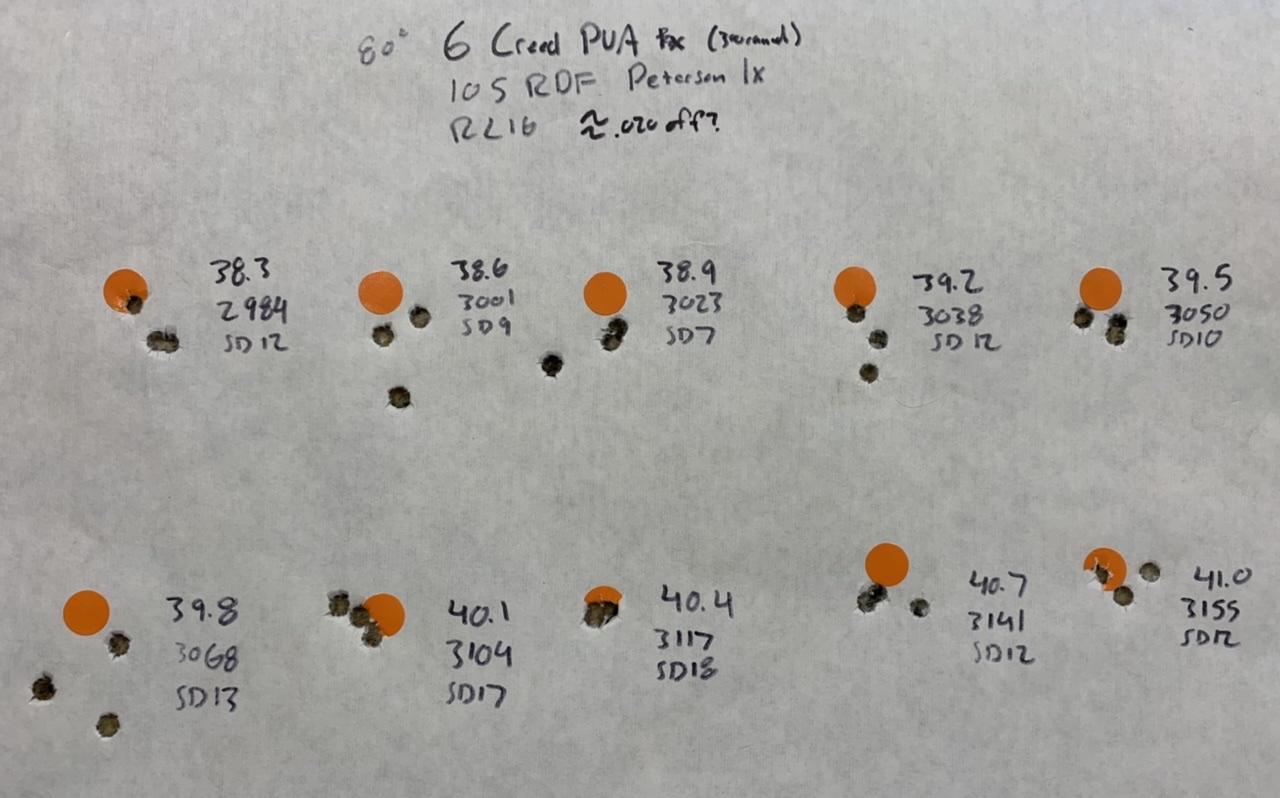

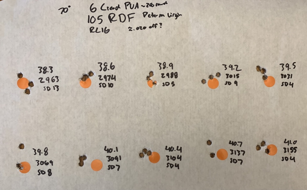

Yeah lots. My issue is that the sample sizes are just sooo small that these ES/SD numbers dont mean anything other than that they are a tiny statistical population. The ES/SD results can swing round, sometimes wildly within the statistical range that they actually exist inside of.
But what shoots good, shoots good. Plain and simple. The numbers are there just for a bit wider perspective. I know that it was going this fast to enter into my calculator etc.
Here is from my initial ocw on the virgin brass. Its basically backing up the above test I shared showing the 40.1-40.4 is a fine shooting area, at least no more egregious than the 38.9 area. But look at the numbers. The ~40.4 is just as good as the 38.9 in this test according to the SD numbers. Small samples sizes.
What Ill do now is actually bracket the charges around 40.4 and shoot 40.2, 40.3, 40.4, 40.5, 40.6 on paper at 500 yards and make sure that there isnt something funky and egregious going on between the lines. If it makes good groups around the size of my 3" target paster at that distance I call it good.

So I know many will tell me I'm wasting my time but well it's my time, gun, and rifle and I figure if anything I still learn from this. My plan is to take the first 100 rounds and zero the rifle and then just practice at distance with a lighter load as the barrel will still be speeding up. Then take those once fired brass and use some of them to determine a seating depth shooting groups at 100 yards. Then take that seating depth and load up 15 rounds at .1 grain increments and look for the Velocity flat spots. From there I will load up the rest of the once fired brass and shoot a 5 shot group at 100 yards and just confirm a good SD/ES and tight group at 100 yards. I will shoot at distances until I have 200-250 rounds. Then I will verify all of my data by shooting to 300 yards then 600 yards to verify DOPE/MV. Then shoot at 1000 to true my BC. Then take that data and shoot groups at 300 and 500 yards.
I'm amused that you want to save money on the Magnetospeed but are approaching the rest of the reloading process with a "I'll waste what I damn well please" attitude. You forgot to mention money, btw; every live-fire trigger pull costs money on top of everything else you mentioned, as has also been noted by others in this thread.
Listen, not trying to be a prick here, but you've said this is your first rodeo with tuning a load. Many of us have wasted significant amounts of time, effort, and money doing things that were either inefficient or utterly useless in this process, between the range and the bench, and you're being offered insights into how to avoid doing the same. If you're already dead set on your whole process, then sure, go for it, and that's not even what you asked to begin with in fairness.
To answer your original question: a dramatically better UI, more sensitivity options, a cord that's less likely to get damaged (and is cheap/easy to replace if it does), compatibility with suppressors/rimfire/competition-contour barrels, data logging, onboard statistics with shot deletion, and an available adapter for mounting on a pistol picatinny rail are lots of reasons to go with the V3. Just the user interface alone is worth it, because there's nothing worse than loading up a single ladder's worth of ammo then losing data after you've driven however far to the range and having to re-do the whole process. Take it from someone who knows. Add to that the fact that you want to run a suppressor, which will change your MV, and I think you have your answer.
Reactions: Baron23
I apologize I thought I had posted this before. Based on everything everyone has said I agree getting the V3 is worth it and the route I'm going to take. I am interested in your opinions about my statement on load development though since you brought it up.
Reactions: KnowNothing256
What would you like to hear more about? Fair warning, you ask five reloaders and you'll get five different answers lol
It is, the v3 is a good choice.

Tagging onto what @Dthomas3523 is saying, there's a growing body of evidence that velocity "nodes" don't really exist, in that they can't be repeatedly demonstrated at a given charge weight, or across a given set of identical charge weight ladders. So, there's a growing group of people who are starting to abandon that approach, and either just pick a speed to target, such as reloading manual maximum, or look at mid-range performance on target to determine an OCW. Many of the top long-range shooters out there do currently subscribe to the theory of positive/negative compensation, which is another reason to look for your OCW on target rather than across a chrono, since barrel harmonics might effectively "cancel out" variations in MV across a limited MV range.
I'm actually working up a load right now, and I'm trying out Scott Satterlee's approach, which is to rough in a seating depth first, using a "safe" charge weight (you can use manual minimum, or manual "middle" if you like), then run a powder ladder after. Specifically, I did 0.010" increments of increasing jump, starting with 0.040" and going up to 0.100", looking at group size and impact location. This was just at 217 yards since that's the max my local range can offer, and the reason I jumped so far (as opposed to "kissing" the lands up to say 0.020" jump) is some recent tinkering that Satterlee and Mark Gordon of Short Action Customs, among others, which suggests that longer jumps offer a more stable seating depth (i.e., resistant to accuracy issues from erosion of the lands causing your depth to get "out of tune") and longer barrel life. I'm frankly quite fed up with tinkering with load dev, and am hoping this new barrel will dial in quick using this prototype method, and that I won't have to screw with it halfway through the barrel life.
Anyway, so after I checked seating depth and decided on 0.100" (much better group than any other, but similar average POI as 0.070-0.090", I ran a quick powder ladder to look for pressure signs, just a single round at 0.4gr increments (6.5CM, so those are ~1% increments). Never saw sticky bolt lift, but the amount of powder compression was getting pretty up there towards the top of my ladder and I started seeing light ejector marks around 2750-2800 fps so that's my cap (happens to correspond to Hornady's max speed, I'm shooting their 140gr HPBT because it's cheap, I don't need top-flight accuracy and I could actually find the damned things during the pandemic). Now I've loaded up a ladder in 0.2gr increments up to the charge that showed ~2800 fps, and I'm gonna take 'em out to 600 yds to observe group size and average POI elevation ("DOPE") to feed my ballistic solver an average MV (this is Frank's method, makes a lotta sense to me after chasing velocity nodes). My biggest concern with this next step is my own ability to shoot good groups at 600yds haha, but we'll see how it goes.
One thing I've learned multiple times over, though, is to always load up a few spare rounds before I head to the range. If I'm doing a ladder, it's spares of the lowest charge weight (in case I get surprise early pressure signs); with seating depth, it honestly doesn't matter so I pick either the least or the most jump. These are sighters, and I need them because I move my scope between rifles regularly, and I hate using up what should've been actionable data just getting on the freaking paper. I also draw up charts with columns and rows for all the info I care about in my reloading book beforehand, because it saves me tons of range time and I'm also less likely to forget a critical parameter if I do it in advance. For example, for my 600yd day coming up, I'm tracking the following:

This was great. Yea the video Satterlee did with the Lily’s on YouTube is what had me focus on seating depth first. I didn’t think of the .1 grain change still being less than an ES could be so thanks for pointing that out. As much as I would like to anneal and trim brass to get longer life out of it I can only buy so much at once so annealing will have to come later. In the end yes my goal is consistent .5 MOA groups. I don’t need anything better than that really. Thanks again for all of the input.
You're welcome! To clarify, 0.5 MOA groups at what range? Because it should be quite doable at 100 yds with that cartridge, a good rifle setup and solid fundamentals, but out at 300+ yds that challenge goes way up and ES starts to become a major factor.
At 100 yards. At 300 I’m hoping to hold .75 and hoping for 1 MOA beyond that. At the end of the day I’m taking a PVA prefit and putting it on a terminus Zeus putting all the parts made by great machinist and gunsmiths together myself. Essentially trying to make a great shooting rifle that I don’t really need any special tools myself for. I do have a fat wrench and a 65 inch pound torque wrench but I don’t consider those too special.
