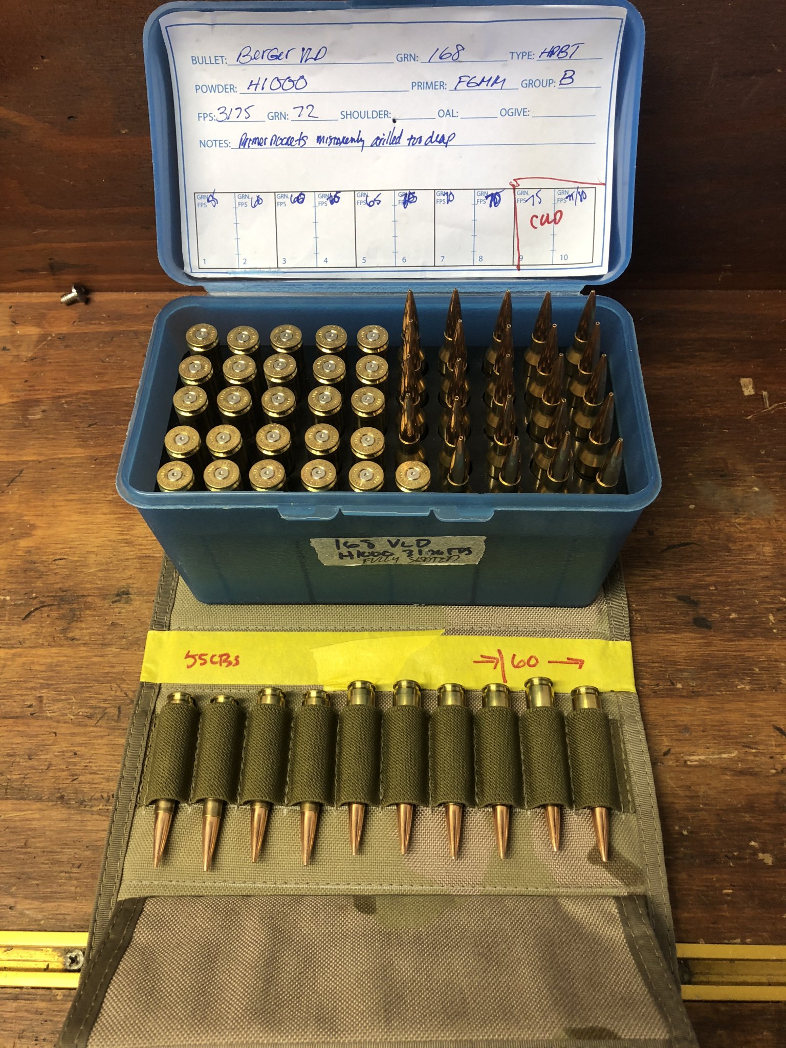

Here is a quick example - of how I use them for daily sorting of seating pressure. Not that this same brass un manged will range from 20lbs to well over 120lbs and that swing is almost impossible to feel in a press like a rock chucker.
I track the annealing to keep these particular loads around 65 lbs give it take 5 and then use the outliers for whatever.
For match positional I am not as worried, just cull the wild ones and store light to firm
