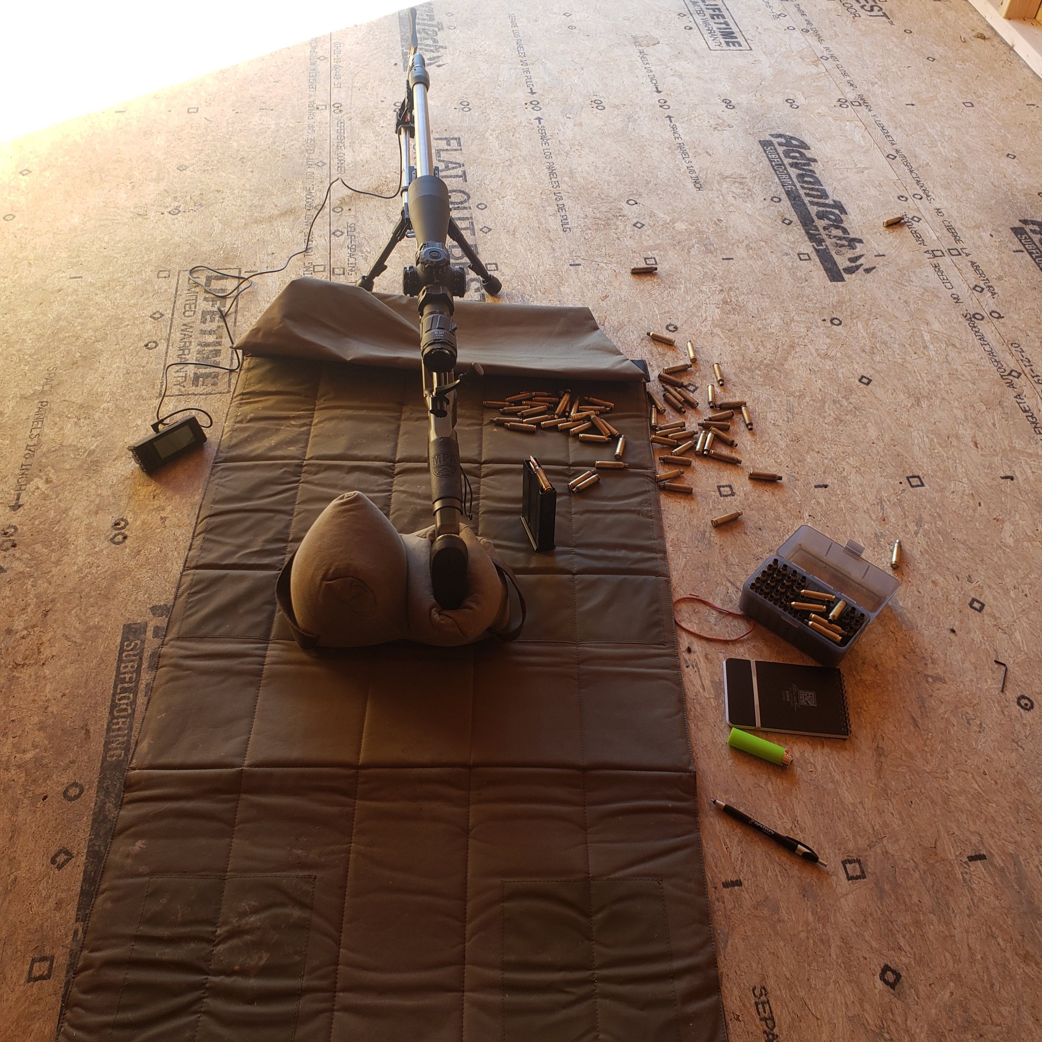

I would get a chronograph that you shoot over. IMO, anything that you put on the barrel affects harmonics and group size. When I do load development I do it one time exactly the way I will shooting the rifle. Why shoot the loads twice?
Mount it to the stock or chassis
