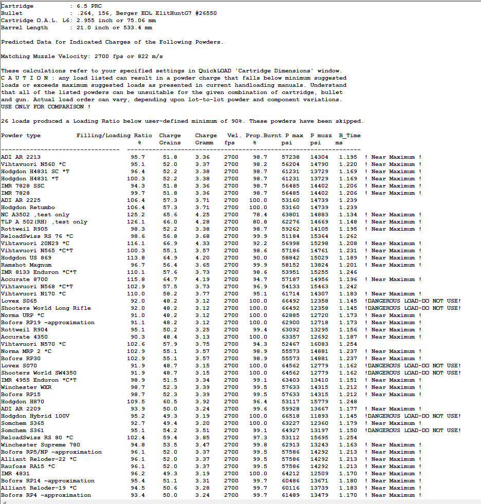

Wanted to see if anyone has recommendations on powders or even just feasibility of this.
Wanting to get a double duty rifle I can shoot NRLH comps with but also take backpack Elk hunting.
Any chance I can run the 156 or 153.5’s down around 2700 from a 22” barrel and have good accuracy and SD? Main worry I think is case fill.
I have a 21” 6.5 PRC right now that I’m going to try some test loads out of. I have H4831SC, H4350, H1000, N565, N570, and Retumbo.

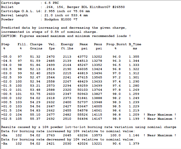

This is what Quickload is perfect for. Here I've set the cartridge, bullet and 21" barrel, then asked it "give me a list of powders that get this combo to 2700 fps"
Lots of options there for you. In situations like this, let Case Fill % & Propellent Burn % help drive your decision.

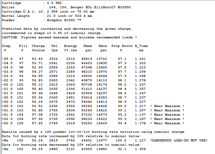

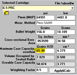

Understood. It might have something to do with the brass; I’m using ADG brass with a H2O volume of 68.3, other brass might have less volume. But when I first started out with the 6.5 PRC, I tried Retumbo in some loads and got less velocity than with H1000, so that was part of why it seemed odd to me.
Maybe...here's the default case capacity QL uses for 6.5PRC
So if I plug your value into QL and run it for H1000...

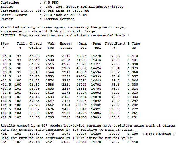

...and Retumbo
Notice that when they're both at 100% case capacity, H1000 still gives you a bit more velocity
O.k., that looks more like what I would have expected.
Back to the OP‘s question, looks like 4831sc or H1000 might work (depending on brass capacity), and for the shorter barrel I would probably try the 4831sc first. Not sure about the VV powders, I don’t have much experience with them.

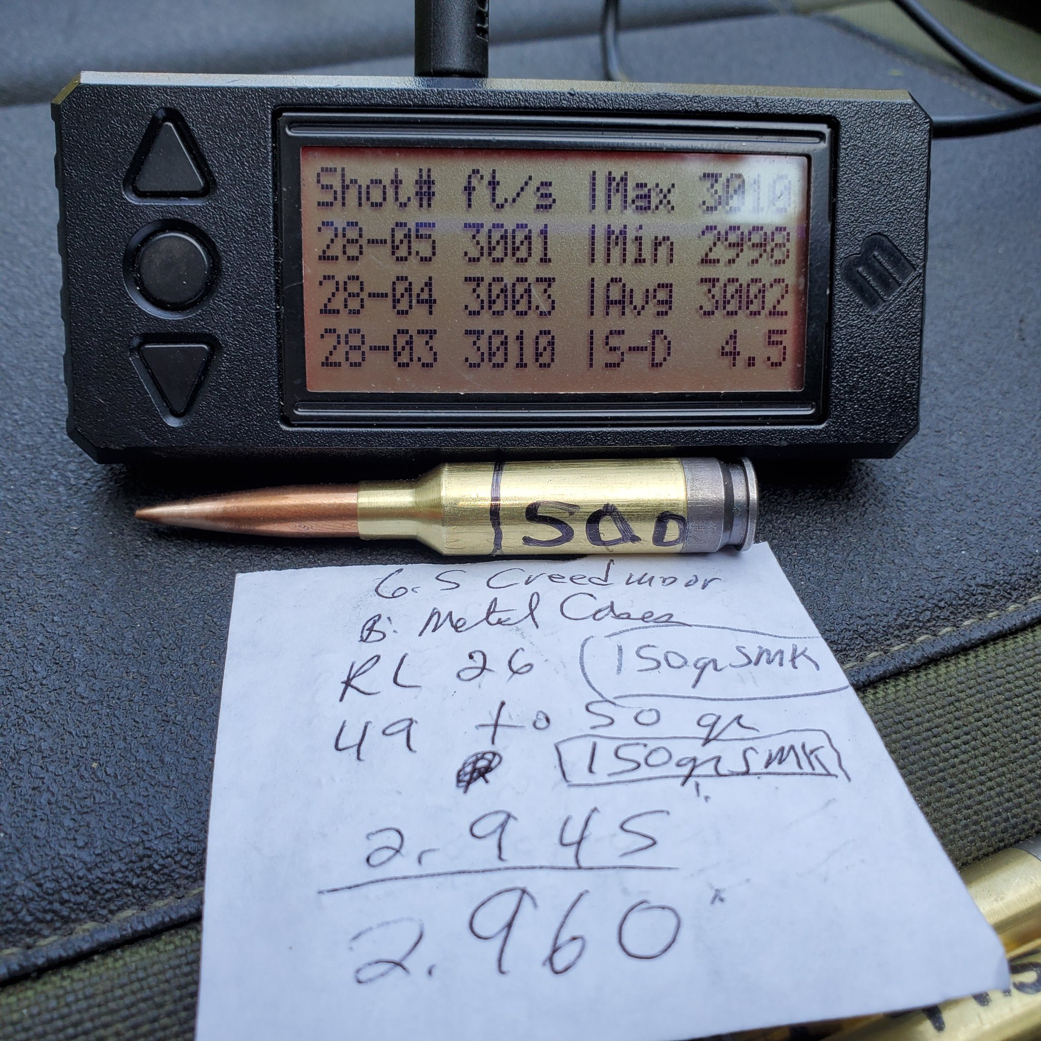

Your Sarcasm in a reloading forum may not be noticed by a new reloader…and therefore could be quite dangerous?
Sarcasm?...Some are pushing the 6.5 CM to 3000 fps with 150 gr SMK in factory 24" barrels, with excellent accuracy...but Not in brass cases.
That would be dangerous.
  • Wow
Reactions: kthomas
I know, I’ve read about your experiments. It’s also quite dangerous for you to publish them imo.
One of these days a rifle may blow up on you.
You pretend that you can judge the real pressures without any pressure test barrel, that’s all I need to know.
Do your thing, I have nothing against it but what is the point of promoting it?
Ever thought about that there maybe a reason the components, especially the cases you use have been disassembled again?
Again, completely your freedom to do this. But your posts create copycats despite your warnings….
And I thought my 140 load going 2830 fps out of a 24" barrel may be a tad too close to pressure.
150's at 3000 fps is madness. Or a typical load on the Long Range Hunting forum.
For people trying to download a PRC... I had some very terrible SDs/ESs downloading with H1000 in a 25"bbl
153.5 Hybrids, 210M, H1000, unfired Lapua, 10 shots each
53.40gr 2685fps SD12.6 ES48
54.08gr 2720fps SD19.8 ES50
Charges above 56gr tightened up, SDs in the 4-8fps range

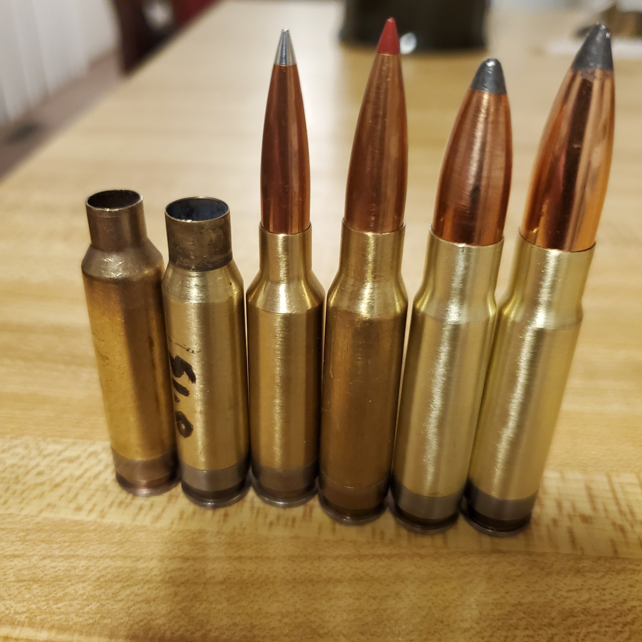

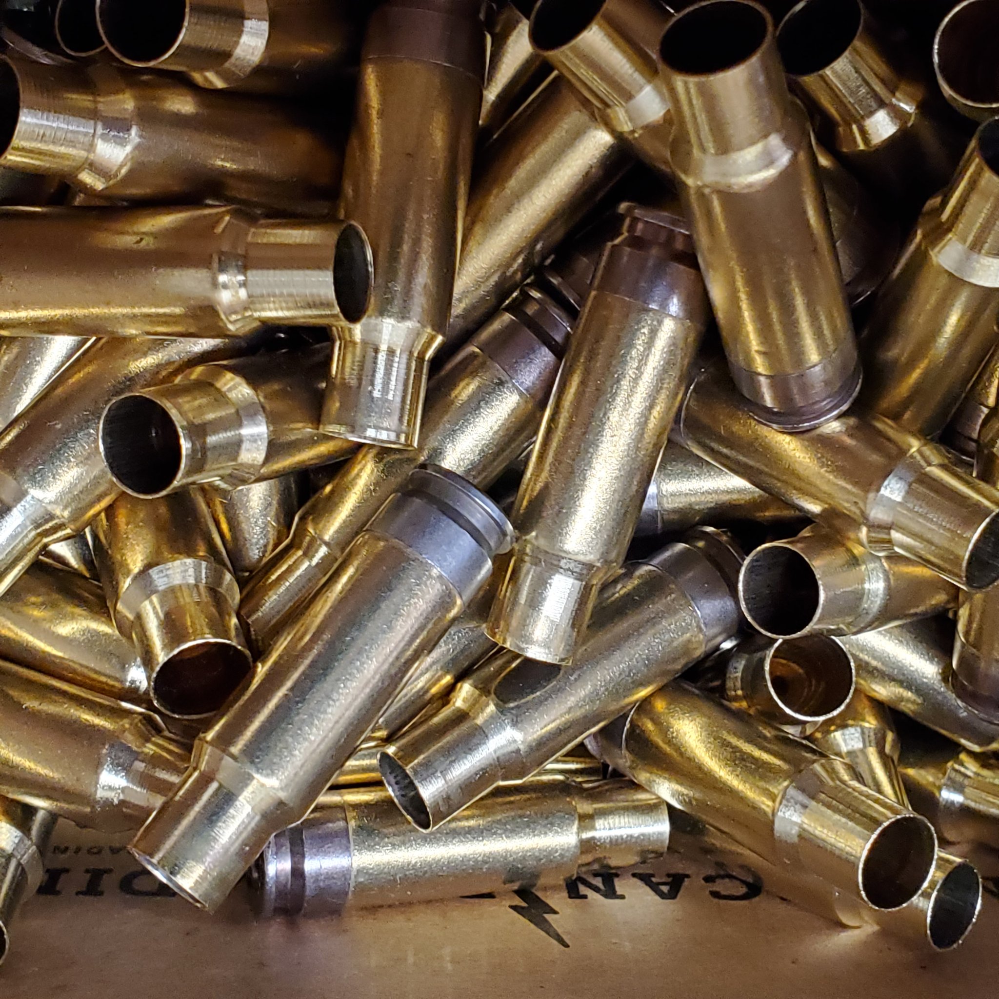

It's not for the novice, that's why I said it's dangerous, with brass.
But correctly sized and neck turned brass hybrid cases it works and is an option for many who care to go there...and quite a few do.
I have several thousand hybrid cases, and from them into 6 5 CM, 308 Win, 8.6 Blackout bolt gun, 358 Win.
Besides the US military who uses them in machinguns, at full 80,000 psi, for several years, but rumor has it bumped back to 70,000 psi to 75,000 psi preserve barrel life, on full auto.
There is Bruce Thorm at Bat Machine and the maker of Alpha brass running super high pressures on Ultimate Reloader "308 W to 300 WM velocities do not try this at home," on video look it up for entertainment purposes.
They were pushing over 100,000 psi in the Bat action.
I don't do that,.. but they are with this new Alpha brass and Bat actions.
The hybrid cases are rated for operating at 80,000 psi, but mine are limited to 70,000 75, 000 psi max, according to QL the gestimate software.
The majority are held at 65,000 psi in 8.6 blkout 6.5 twist...not the 3 twist ...it builds pressure for a 3 grains lower max on those roughly rifled 3 twist barrels. I do not recommend the 3 twist barrel.
There are alot of new developments and cartridges, some can be greatly improved upon without going to magnum cases...although that's the easy button for most.
I run AR 10s at 62,000 to 65,000 psi max.
A standard load is 2853 to 2865 for 150 SMK 24" AR 10 6.5 CM with Lapua brass
There are alot of options, for those who want less performance or those who want more performance. Never go where you are uncomfortable, and always work up to loads printed anywhere.
I work on a fair of wildcat cases where little or no data is available. Like the 510 whisper...how much powder are you going to put behind that 750 gr bullet for a sub or super load? I now have lots of data on it from just shooting it, and working with QL.
Same with the 8.6 Blackout 6.5 twist, making the 8.6 versitle, as well as accurate, and not dangerous to shoot at supersonic velocities showing a better way to go, than those with the poor quality 3 twist Faxon barrels.

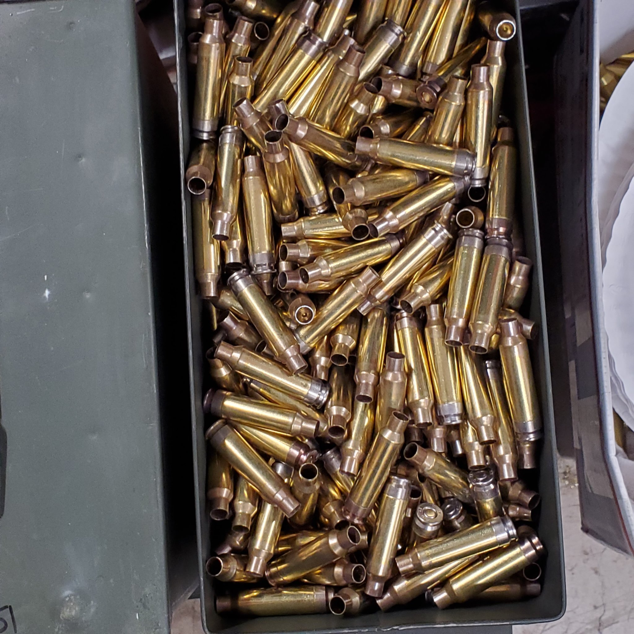

How does one get into this hybrid case, 80k psi, reloading game? Write up for dummies somewhere??
It's already been "wrote up" on this site...I have explained it and re explained many times to individuals.
I have posted and helped guys with obtaining cases, sizing techniques, neck turning, and annealing.
American Reloading has been getting some fairly large batches in but they run out of stock from time to time...but are usually on sale, ...fairly cheap. Alot of guys seem to using these cases.
Used sensibly they are capable of improving standard caliber short 308 sized case heads cartridge performance.
An individual choice as to whether or not its for you.
But if you already shoot hot max brass loads, one can utilize hybrid cases for extra safety, at the lower pressures of your top hot brass loads, as the SS hybrid case heads will easily take that pressure.
