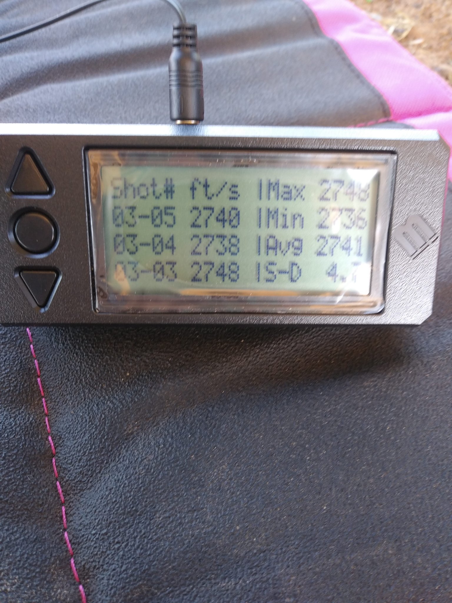

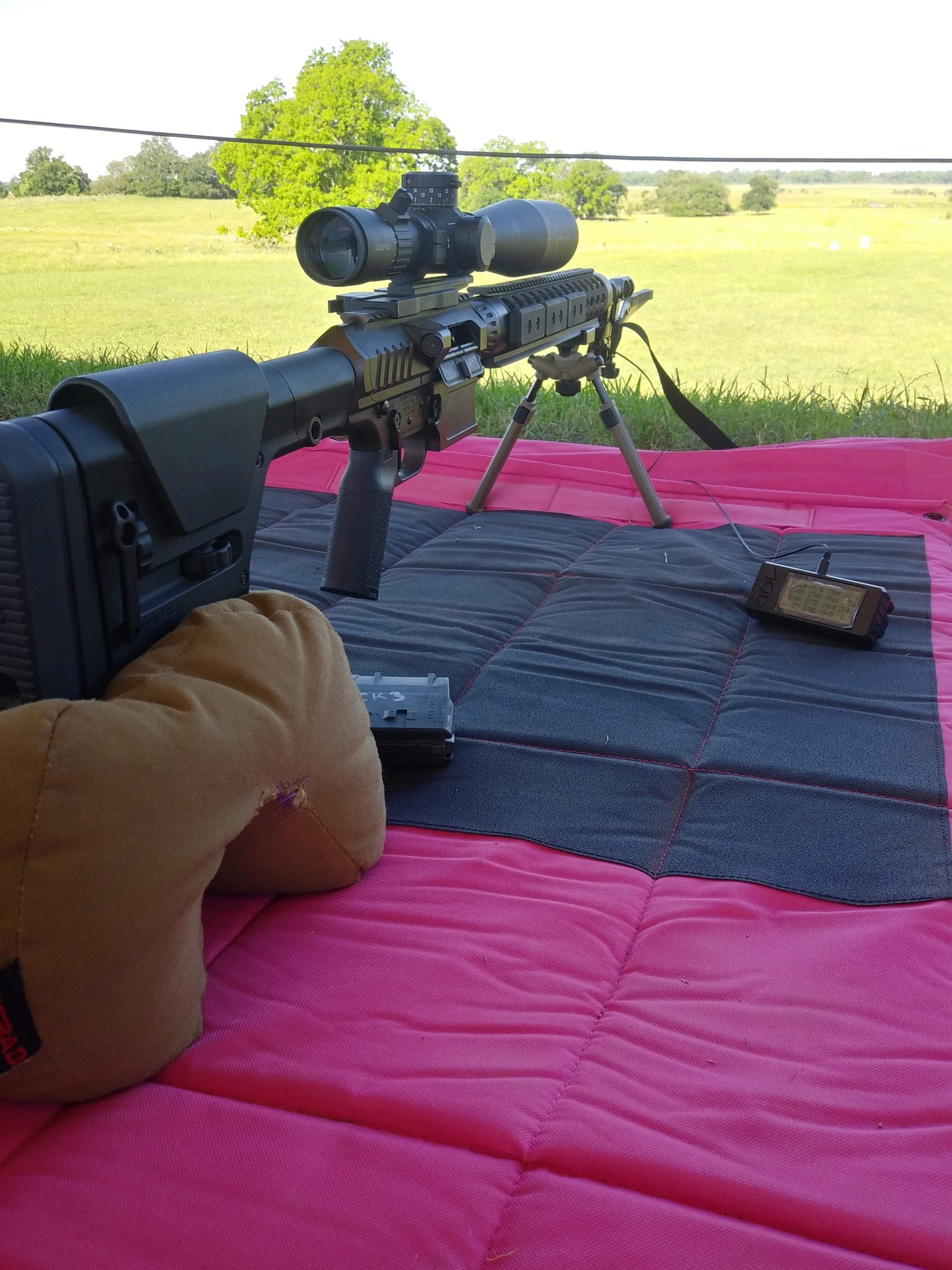

I run a pair of JP LRP-07's. This load should run super without having to touch your gas block and it should also be reliable no matter how dirty it gets. Likely wont matter what carrier you have either.
My favorite load:
144 Berger Hybrid
41.5 grains H4350
CCI#200 Primer
Federal Brass
COAL 2.800" to fit in PMAG
Trim to length (1.920" iirc)
Chamfer/Deburr
Annealed in AMP Aztec Code 141
Should be about 2740-50 fps.
Congrats on the rifle! Let us know how it works out :)
