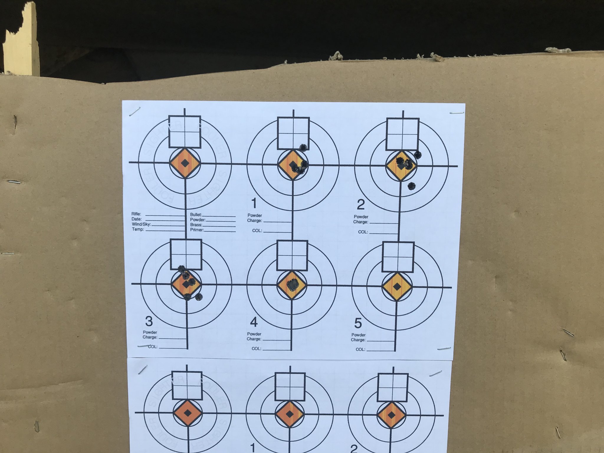

First time loading Reloader 16 . Berger 140g hybrids.
all loaded with 41 g just to try different seating depths.
The hybrids don't seem to be too picky at all.
Brux was right.
The shorter lengths seem to feed a hair smoother. I think
The 4.160" length is with the measuring device on my caliper , that equates to a 2.800" oal.
Next I'll try charge weights , thinking I'll load 10 total rounds, each round jump .2 grain increments see if i find a spot where velocity is pretty close.
I did that with H4350 seemed to work pretty good.
Anyone have other Ideas or does this seem like a good plan?
Brux was right.

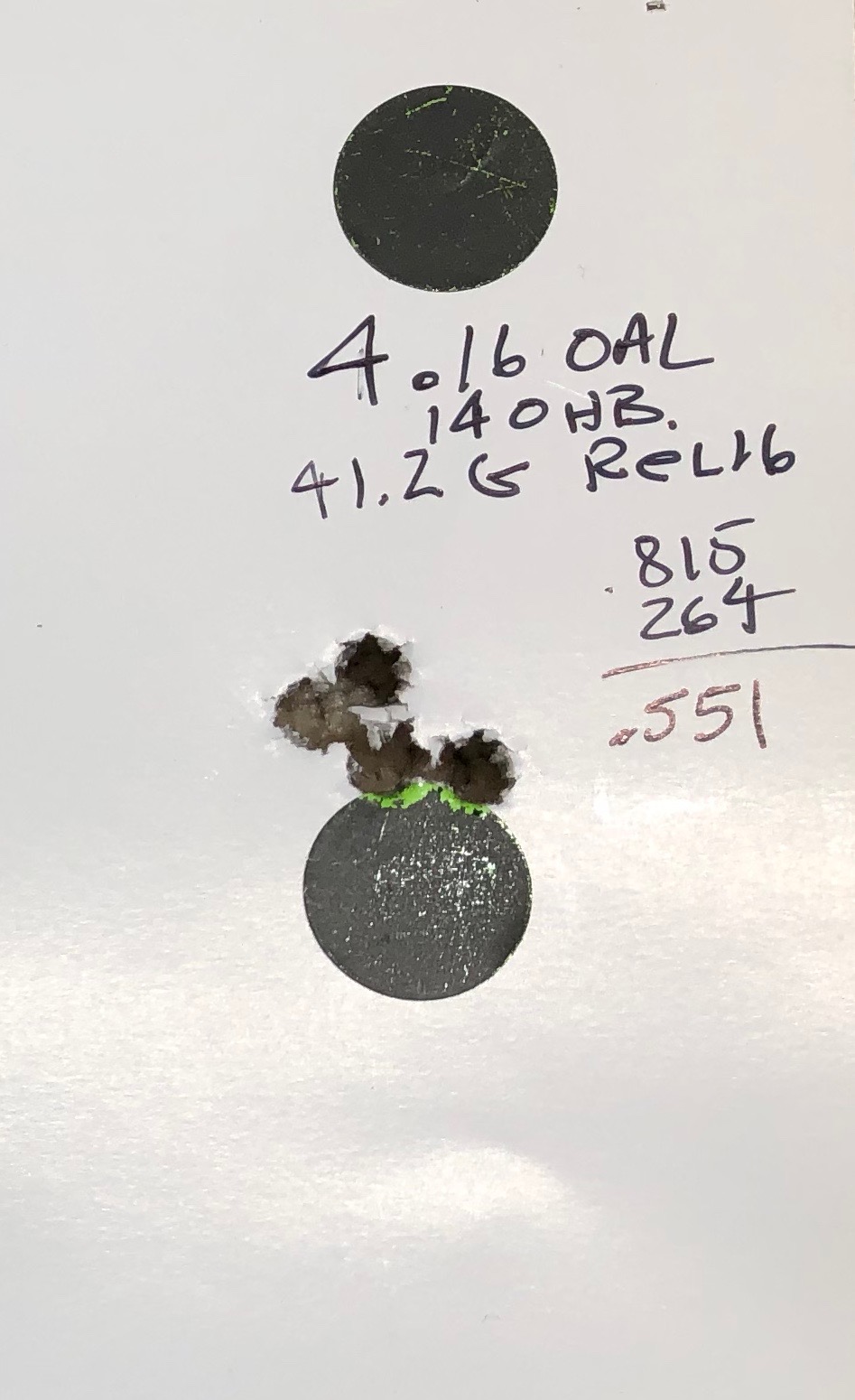

I’ve been using R16 for the past 8-10 months and grew to trust the powders consistency. The only noticeable difference over the past 2300 rounds fired this year between the H4350 and R16 was the speed. H4350 is noticeably faster than the R16, even with less powder. It’s definitely my go to now when H4350 is scarce. What load data did you end up with for the 140 hybrids?
Krieger 26" barrel
Berger 6.5mm 140g Hybrid
2.800"oal
CCI 450
41.2 grains Reloader 16
Lapua brass new
2794 FPS
2770
2793
2787
2775
______________
2783 FPS average
Total spread 24 FPS
The hybrids are supposed to be jump tolerant as i understand. You can measure a bullet base to ogive before seating and compare it to the OAL to see the difference in the 2 bullets. Check out the precision rifle blog they just did a great series of write ups on bullet jump.
I read Cal Zant’s article on bullet jump, and looked at all the data Mark Gordon has collected over the years on the subject and decided I really didn’t want to chase my lands all that much as my throat erodes. Did a seating depth test and found a good node from .08”-.105” off. Loaded on the long side so I’ll have .025” of throat erosion tolerance before I have to adjust my seating depth.
I could be giving up some precision, but it also just shot the best two groups I’ve ever shot in my life...
