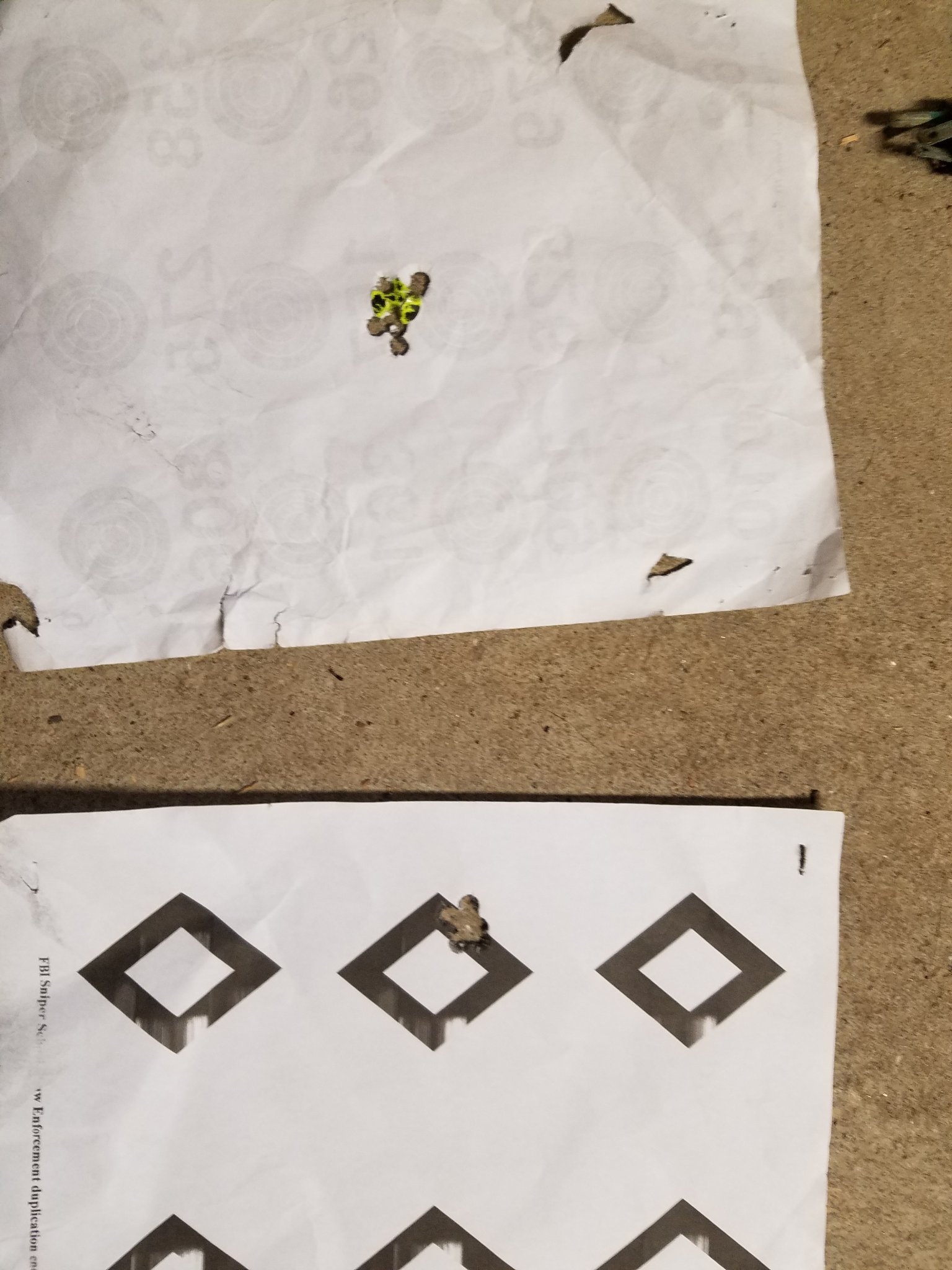

I ran danzac coated 147's in Peterson brass with a 215m with coals @ 2.855 2853fps es 6 over 10 shots. This was my first sweet spot. 300rds in I dropped down .8 and backed off my coal to 2.840. My es (9)still was single digit but shot better with less carbon build up on the crown. I would see issues at >700yds after 80 rounds in a match with a hot barrel. with the original load I tried.
In Peterson brass with naked bullets anything above 45.5 of RL26 in fireformed brass is above where you should be. In Hornady or WInchester brass you have more capacity so many of the "Internet loads" won't blow a primer, however much higher than 46.0 in Peterson brass with the 147 will destroy the brass in short order with speeds in faster barrels getting upwards of high 2800's to low 2900's At 2.855 both of these are compressed even using a 2' drop tube. You'd be halfway up the neck without some form of compressing the powder before seating the bullet.
Now not because it is optimum but I'm running Rl19 with coated 147s between 2765 and as of Saturday 2810fps in 70 degrees vs 25. My es creeped up to 14 and the group opened to 1/2 moa 10 shot group @ 200 yds in 12-15mph winds.
I choose RL19 because I have over 30 pounds and this is the stock barrel. Load development consisted of reading the Serria data for the 150 smk using Win brass vs starline (more volume) using a cci primer loading 1 grain less and seating the 147 to whatever the seater was set up at. This produced a coal of 2.830 and has shot very very well. In the colder weather at distance it has shown very good vertical. Below is 10 from the creed on the left centered up and 10 from my 308 both at 200yds. Bth rifles had .2 right dialed and I held another .2 with the 308. I didn't with the creed.
