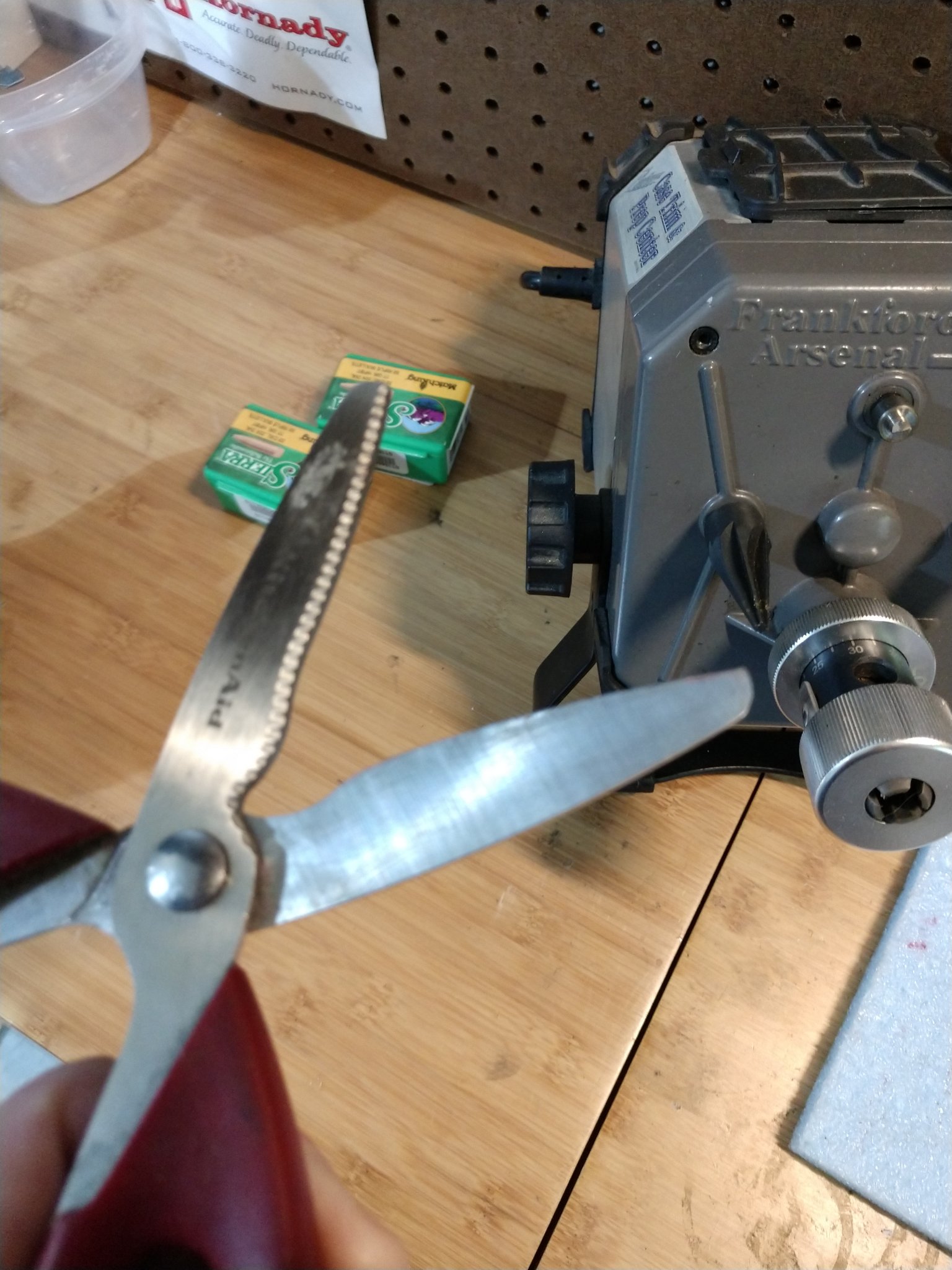

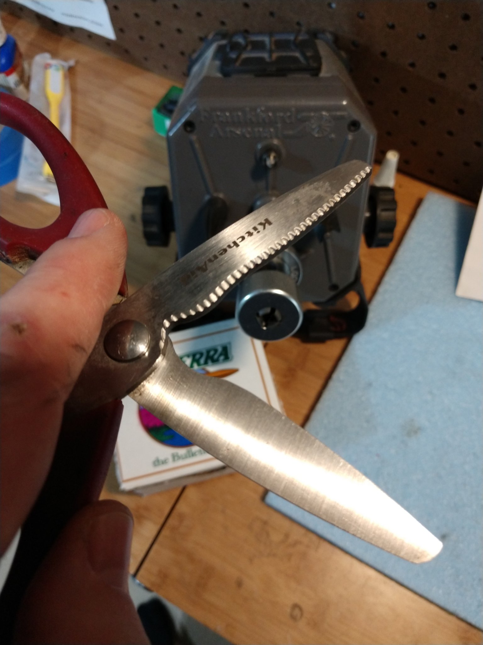

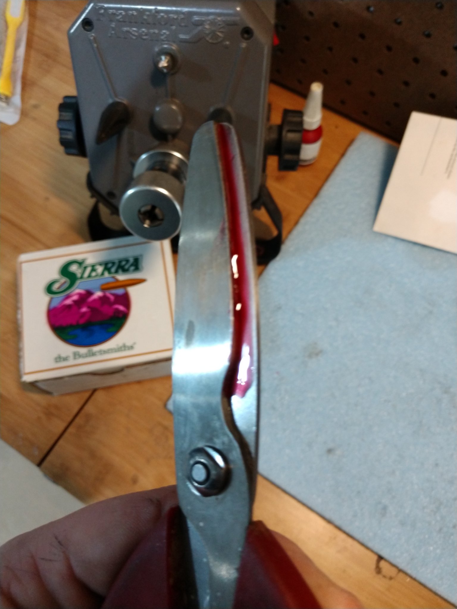

Just for fun I'm going to do a little experiment for you all. I seen a few post on here from other members that are concerned about removing the residual loctite when replacing the new Barrel.

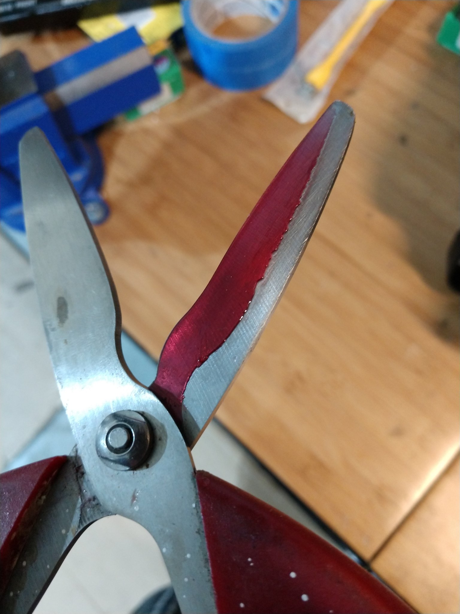

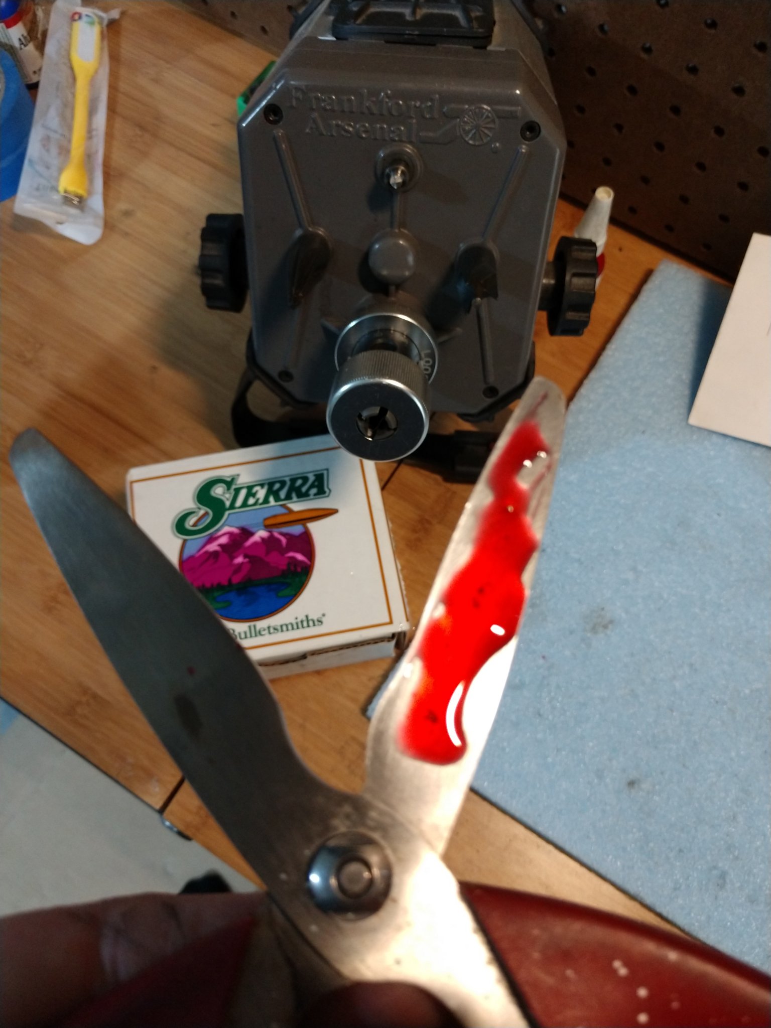

Using Red 271 on a pair of scissors to simulate the loctite process. On the first blade it has been cleaned with a wire brush and as a very thin coat of oil to simulate the barrel extension. The second blade has been wirebrushed and roughed up with some Emery cloth and cleaned with carburetor cleaner to make sure that the loctite adheres to that side simulating the receiver.
I will let it sit overnight and tomorrow I will try various methods to remove the loctite, from chemical epoxy remover plastic scraper.

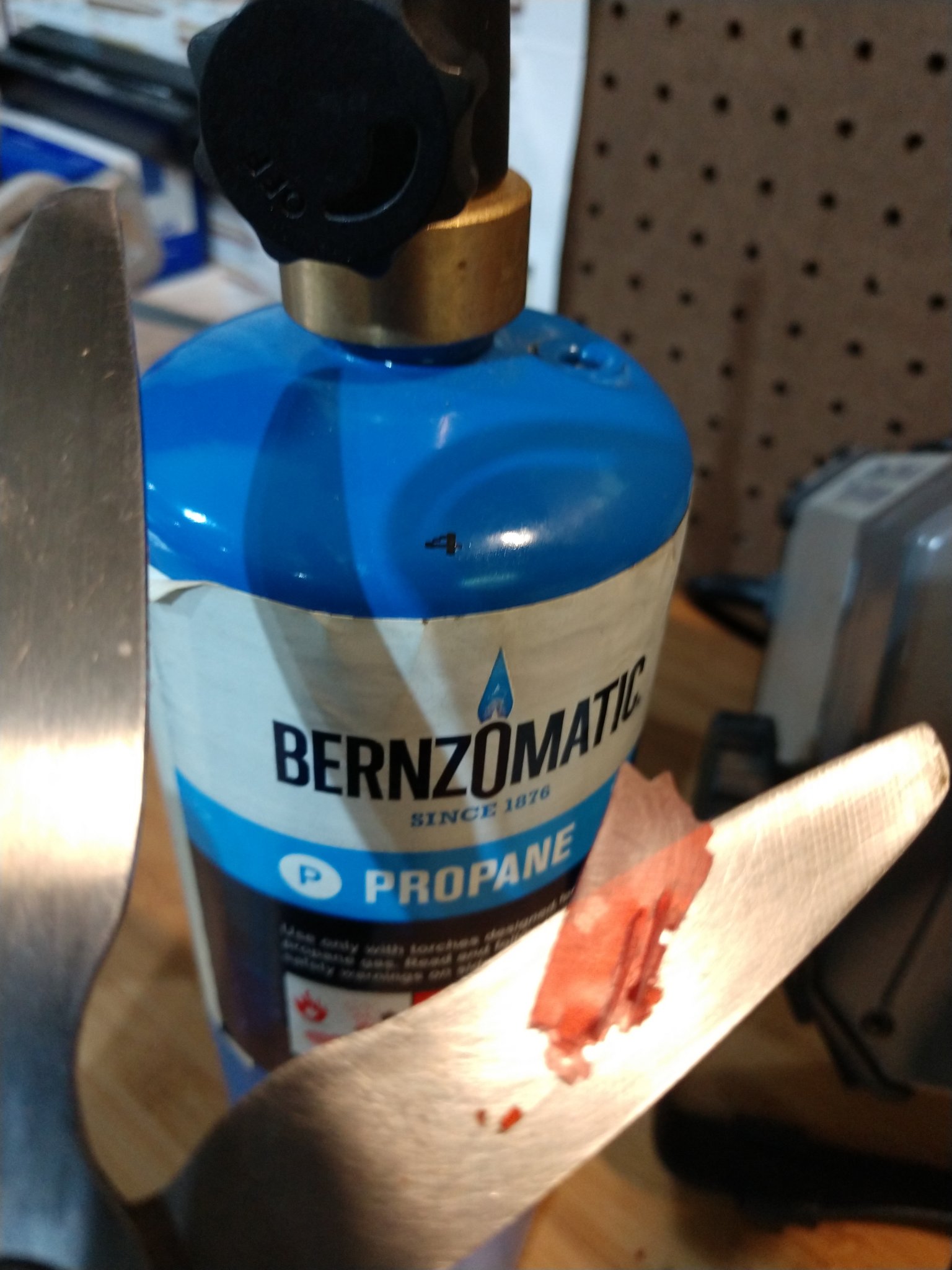

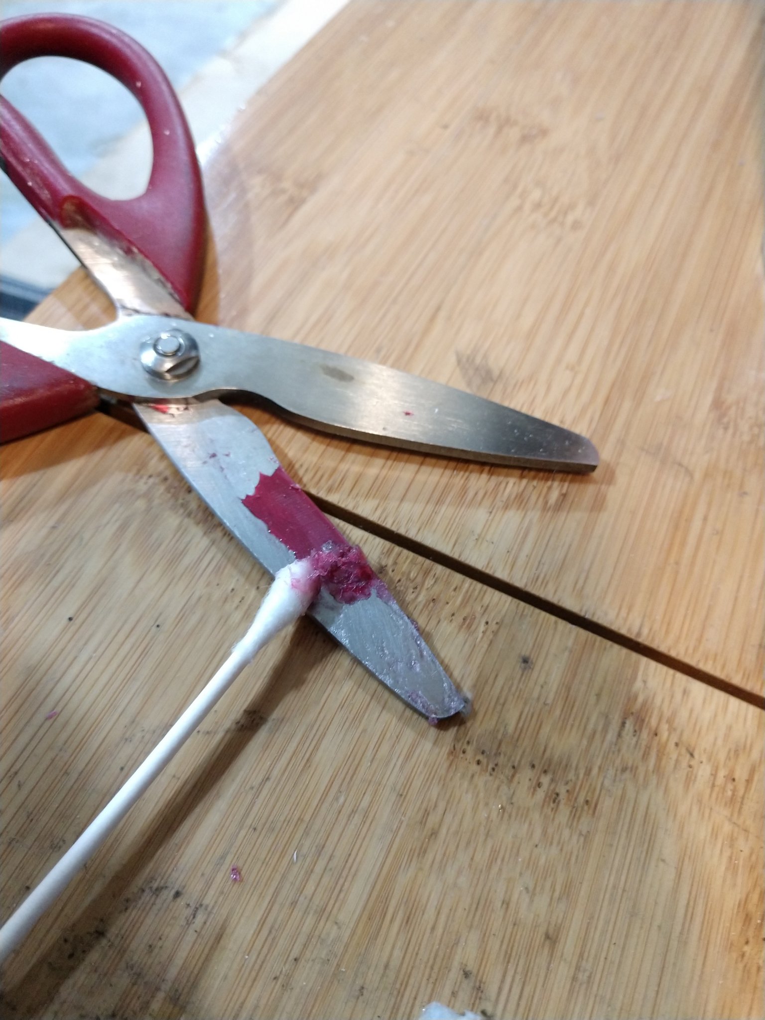

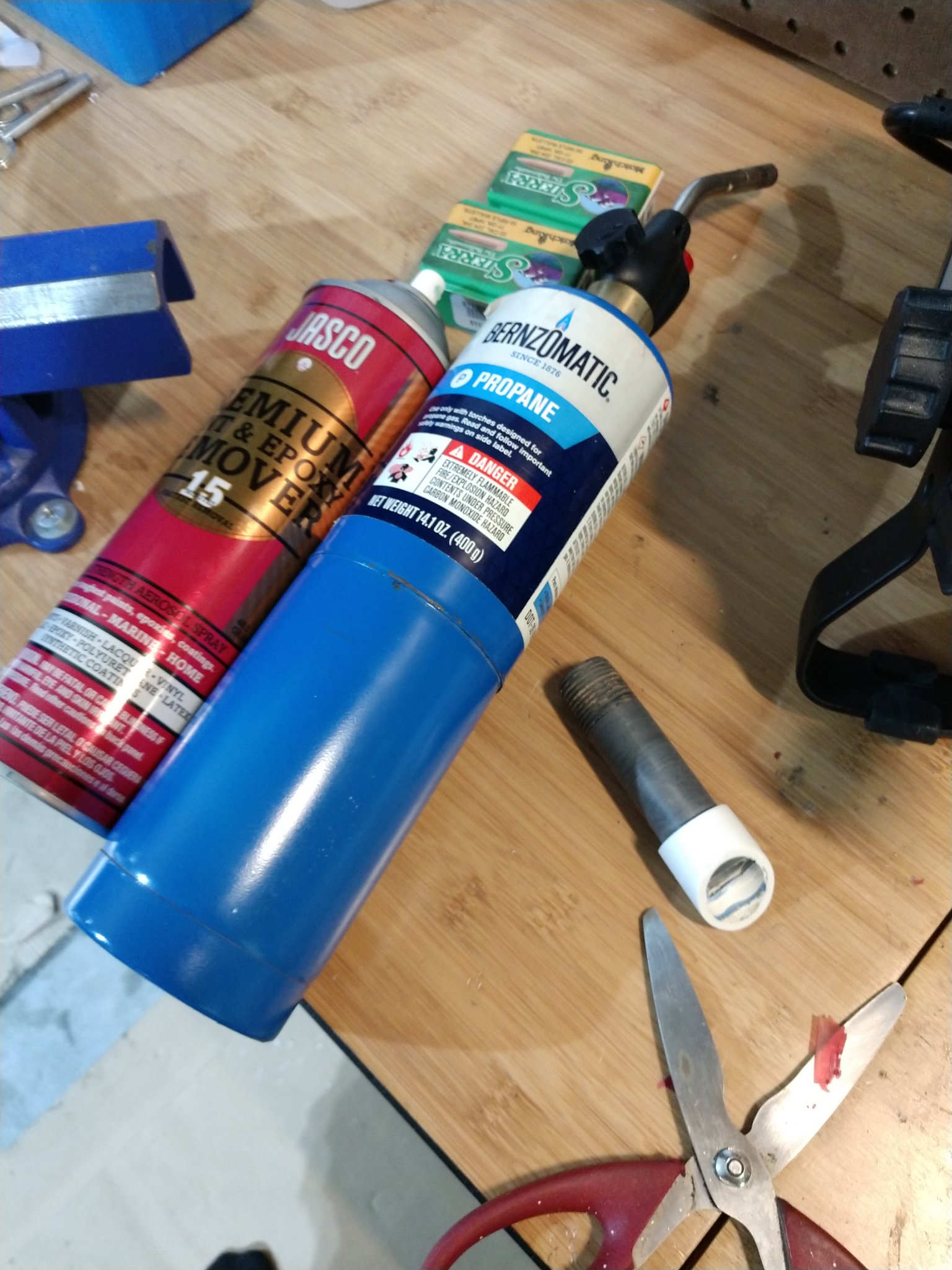

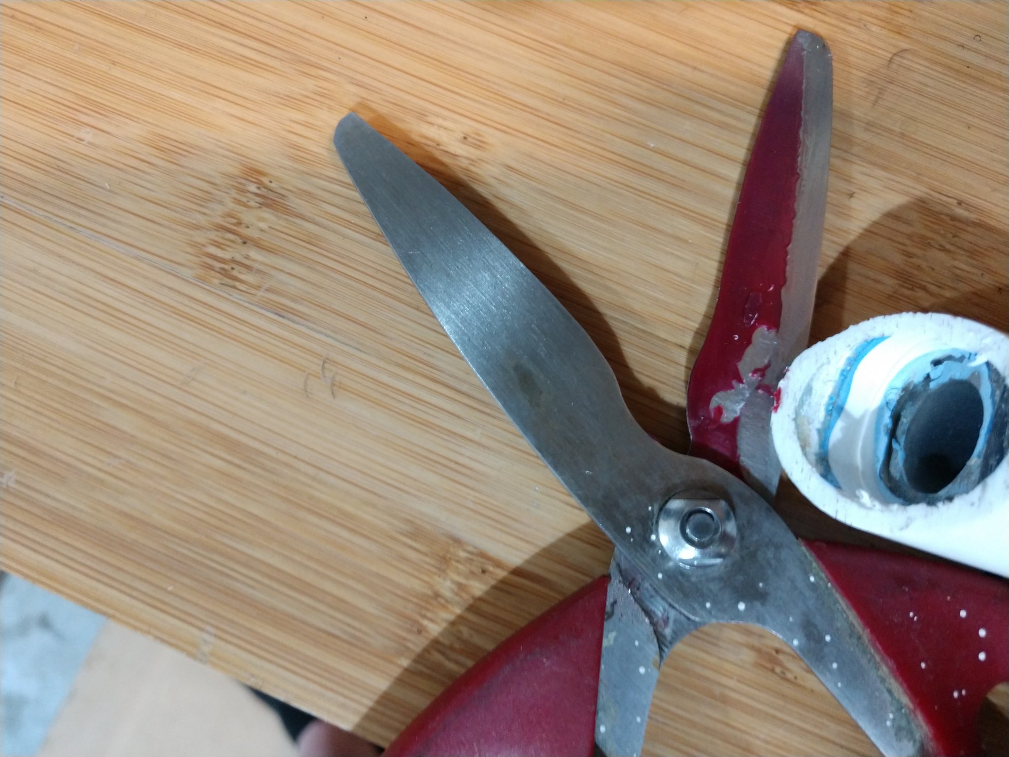

The results are in with the loctite removal. Applied three different methods scraping, chemical and heat
Scraping as I mentioned above is a efficient an easy method that won't harm your receiver.
chemical method was also extremely effective and I believe would work well on the any Loctite including 680, only disadvantage is it will take some of the anodizing off of the inside of the barrel extension channel of your upper receiver, so apply carefully with a Q-tip and nobody can see the inside of that channel anyway so you should be good to go.
And lastly a bit of heat, waved the flame over it for about a second and the last chunk just scraped off with my fingernail.
So there you have it three easy methods that will not physically harm any of your rifles components.
