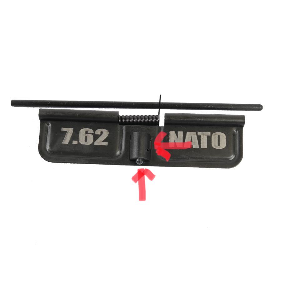

If it opens when you drop the bolt, more then likely the bcg is creating wedge with the dust cover. If this is the case, I would add dykem in the marked areas and test it from a closed bolt position.
I would take a thin file and creat a small grove in the detent to easy it’s function. If this is not enough I would then remove some material from the other area that I marked. removing the material will give the carrier a little more travel and stop the parts from wedging together.
