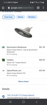

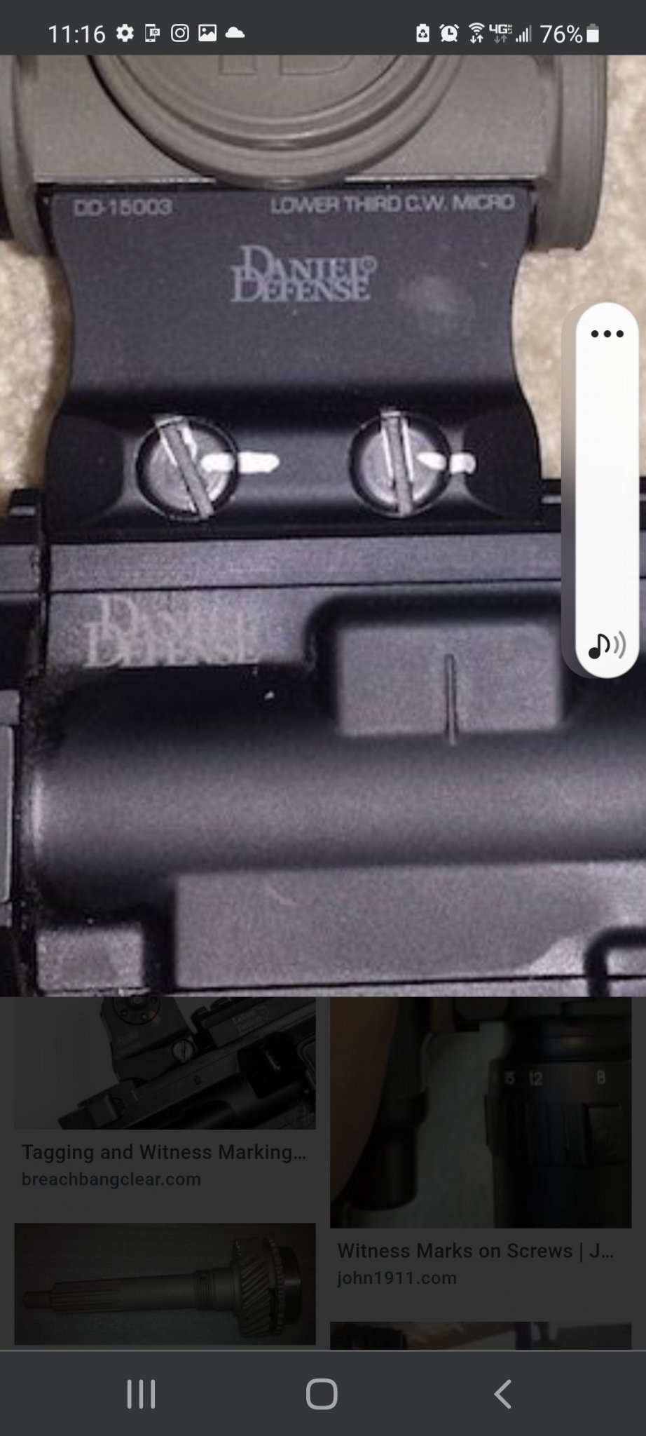

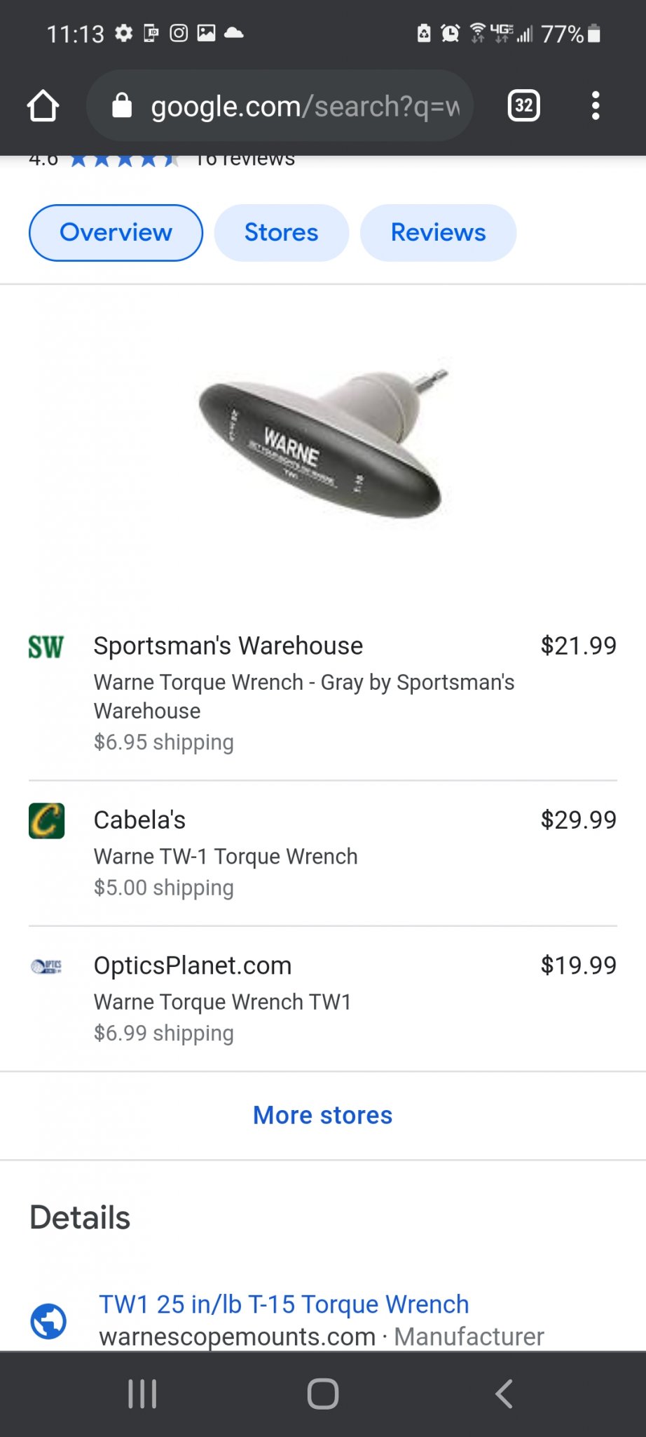

Proper torque, witness marks and periodically check them. I have a small Warne wrench that I check them with nearly everytime the rifle is out of the drag bag.

All my issued guns we put witness marks and tie wire so even if it did rattle loose it would just fall off and flop there.
All my personal guns I've always used a Warne wrench and torqued to that spec. Then added white witness marks.
