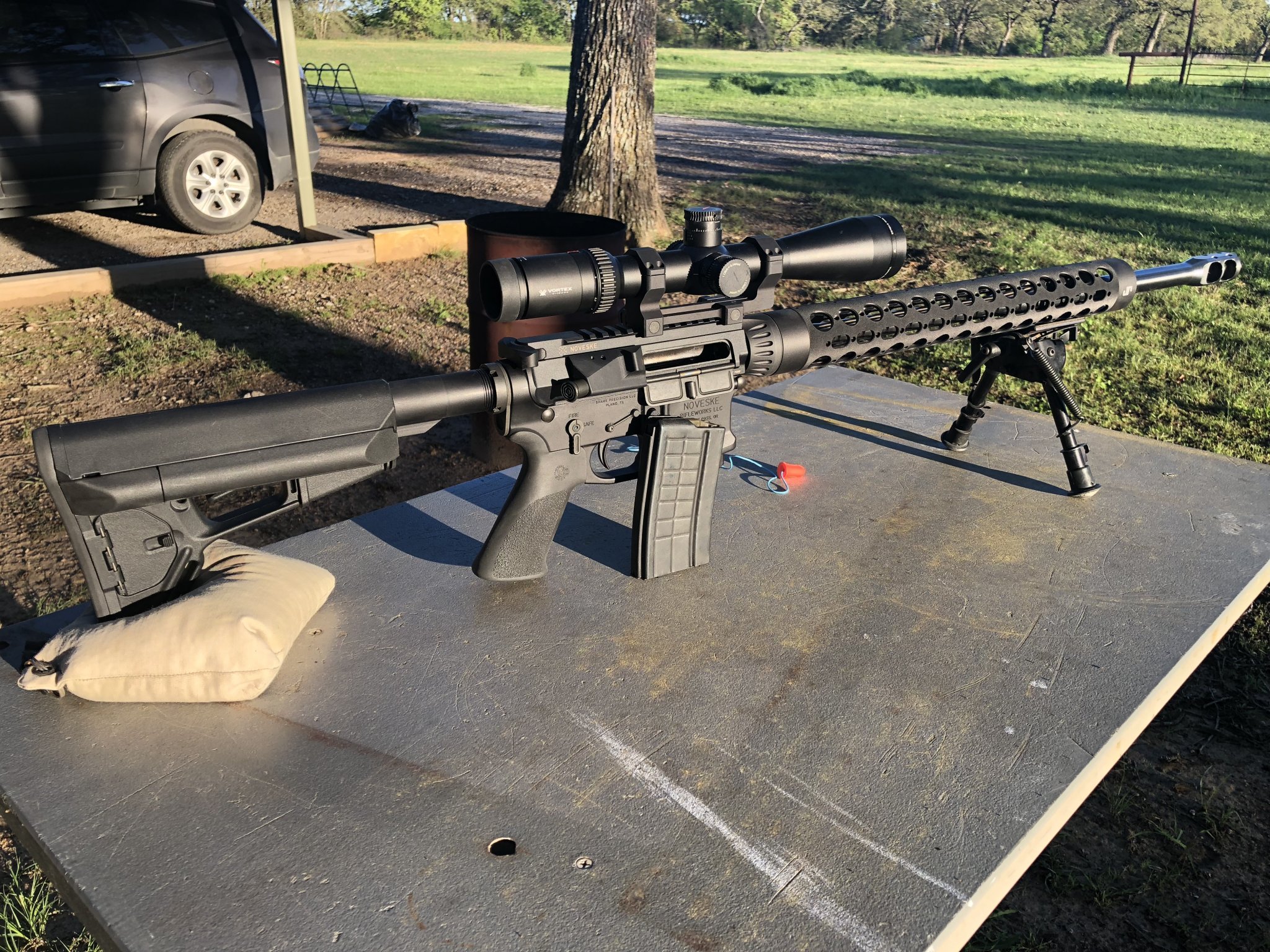

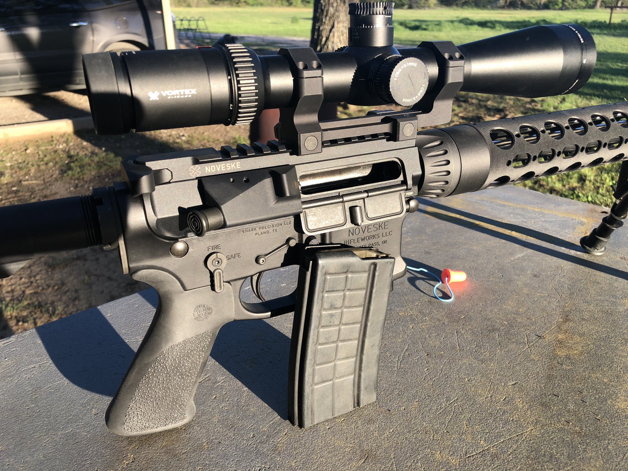

This is a 22” +2 gas 6.5 Creedmoor with 17.25” JP Rapid Configuration. I have three of these on large frame ARs and one on a 22” 6.5 Grendel.

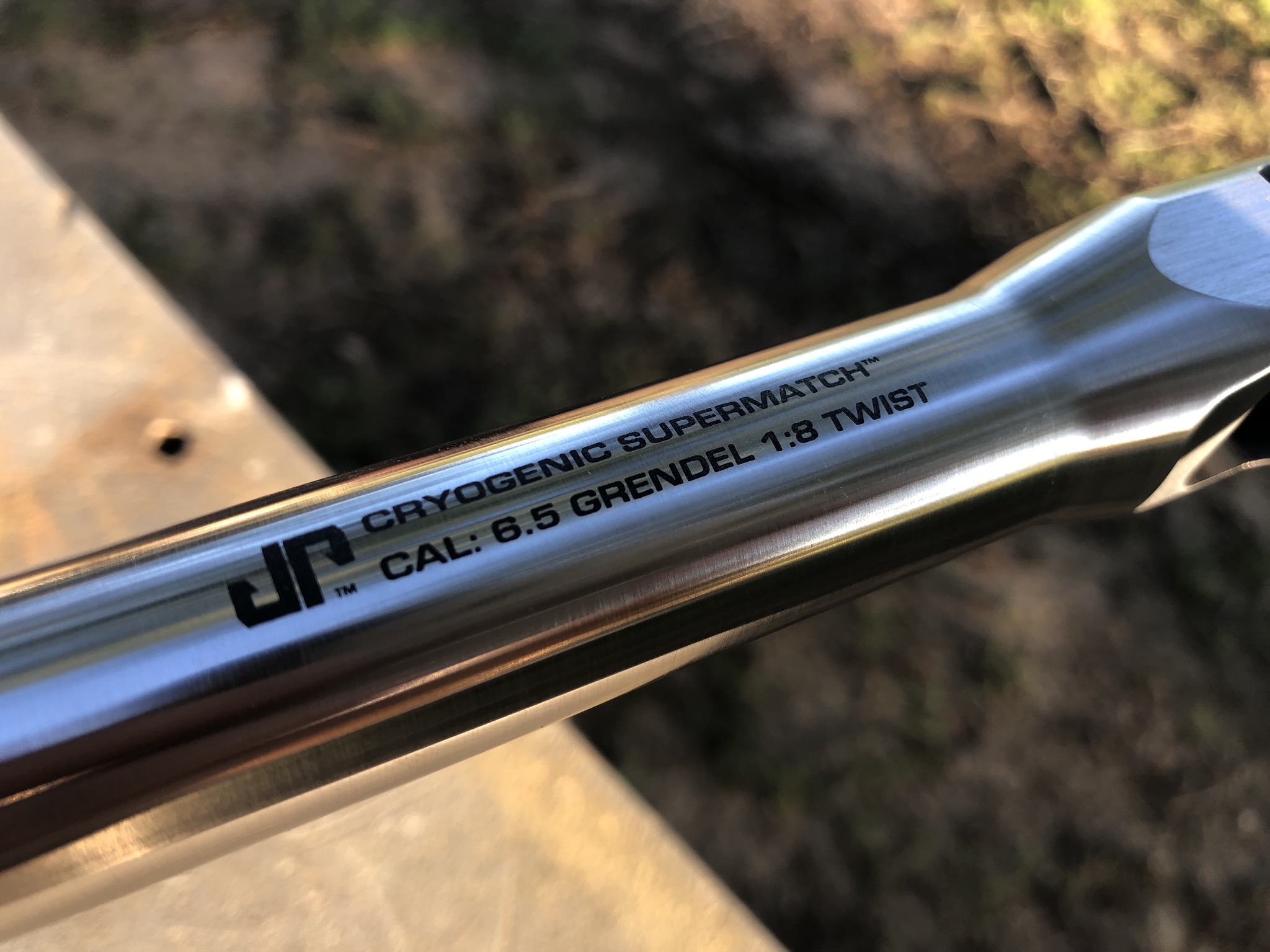

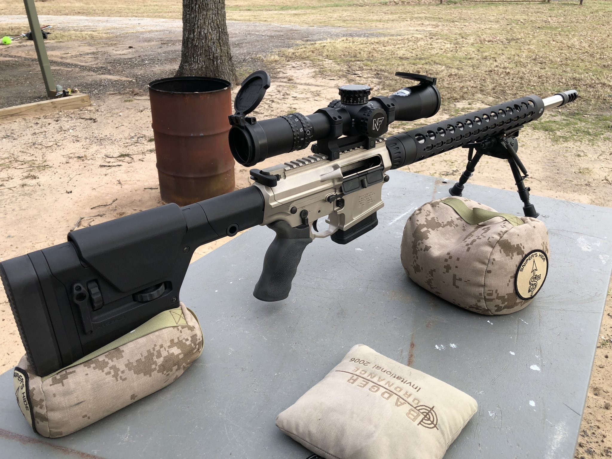

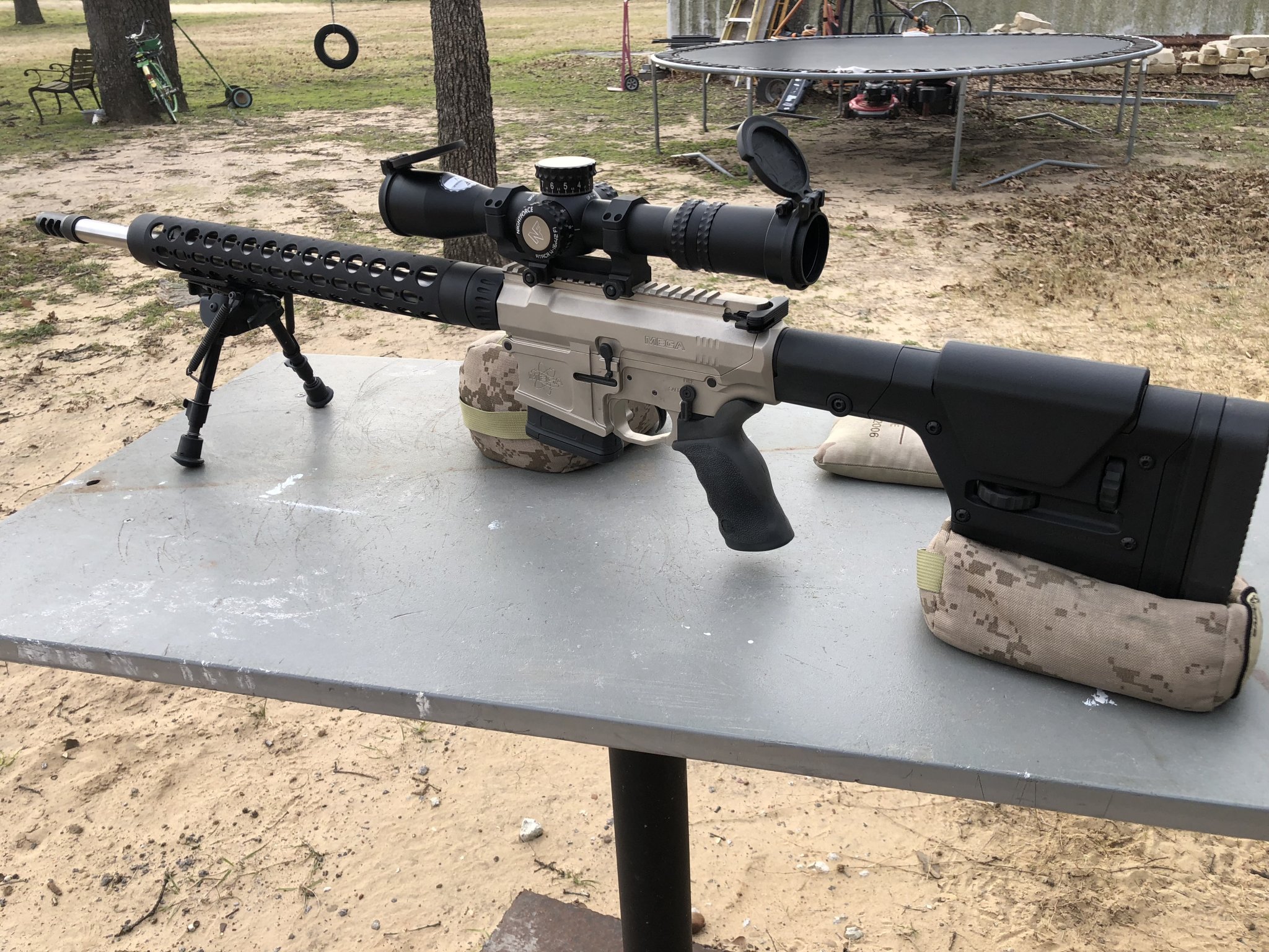

Here’s the 22” Grendel. I chose the JP Rapid Configuration again because JPs adjustable gas block is fairly large in diameter.
